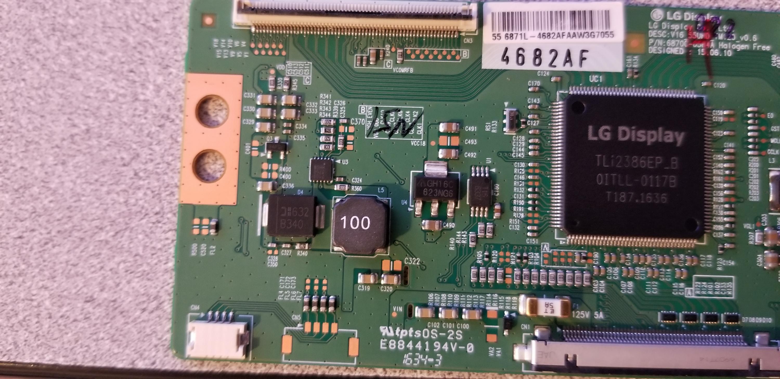

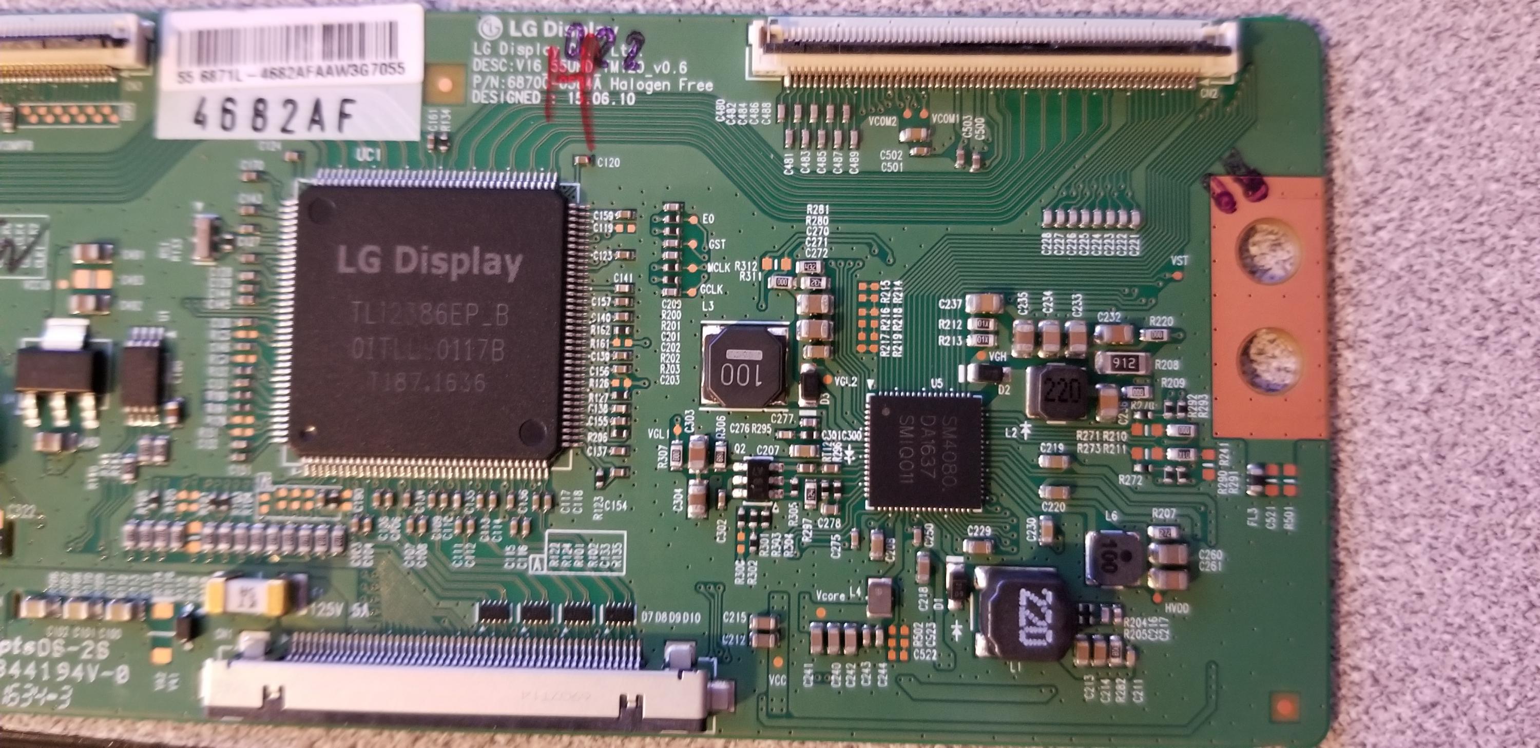

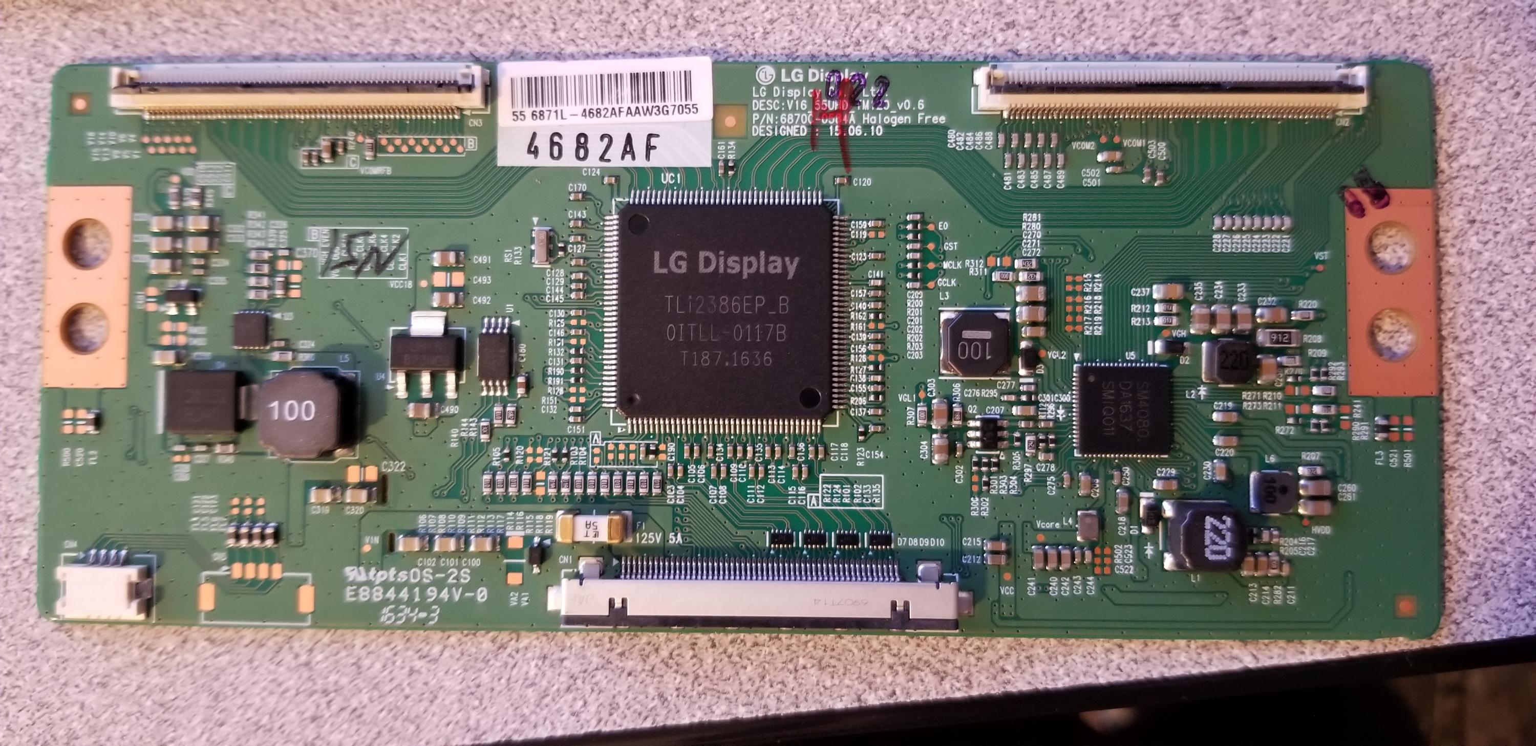

      Re: Philips 55PFL5601/F7 only shows white or very little color
      You can measure the resistance of the resistor to confirm but it doesn't look burnt.
      I think your issue is possibly a gamma issue related to the tcon. Or perhaps an issue with a component on the panel driver board.
      Can we get a decent photo of the tcon. If you click "Go Advanced" Then the paper clip, you can attach photos directly here.

        Heres a few pictures of the front of the tcon, my camera seems to blur around the edges of the picture so I took a couple towards the edges too.
