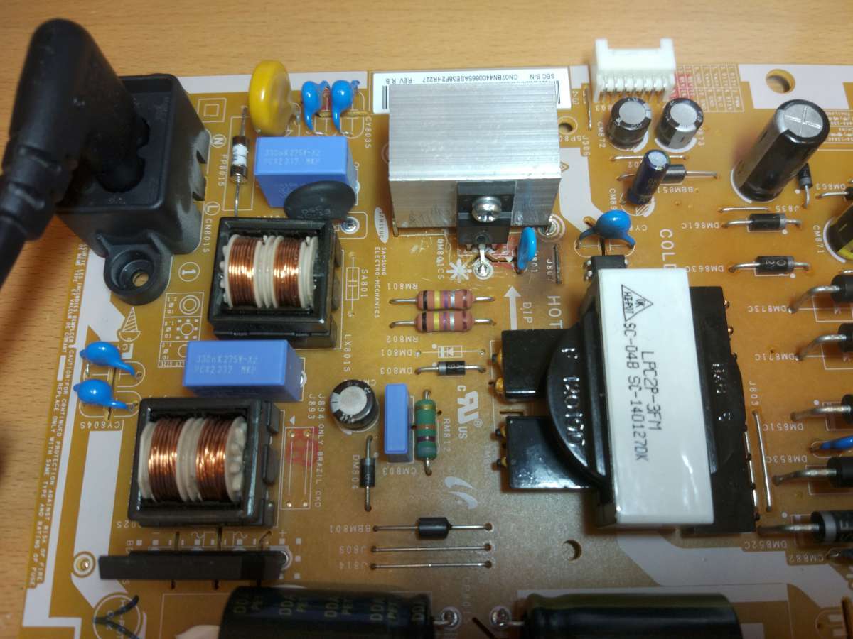

    This TV suffered a mains overvoltage during a storm and the power board died.
    I found the fuse and one ceramic capacitor burned.
    The board is bn44-00665a. I could not find the schematics diagram.
    https://assets.shopjimmy.com/media/c...00665a-top.jpg
    https://assets.shopjimmy.com/media/c...65a-bottom.jpg
    I replaced the capacitor and the fuse, I also replaced the MOSFET MMF60R750P.
    The TV is still dead, no standby or backlight.
    All voltages on CNM803 are zero except A5V which is 2.8V.
    On CNL802 I have D+=96V, S-=S+=82V, D-=87V.
    If I take out mainboard cable, I have on D+=79V, S-=S+=0, D-=72V
    On CNM803 all 13V pins have a voltage varying from 4.5V to 6.2V in a loop.
    And the 5V pins varies between 0.9V-1.6V.
    Can you help me with a diagram of this board or any other advice? Thanks.

    Check RM817, DM804, CM806 cap and J805 [000] resistor, Check what the voltage is across CM806
    It is possible the drive ic was damaged.

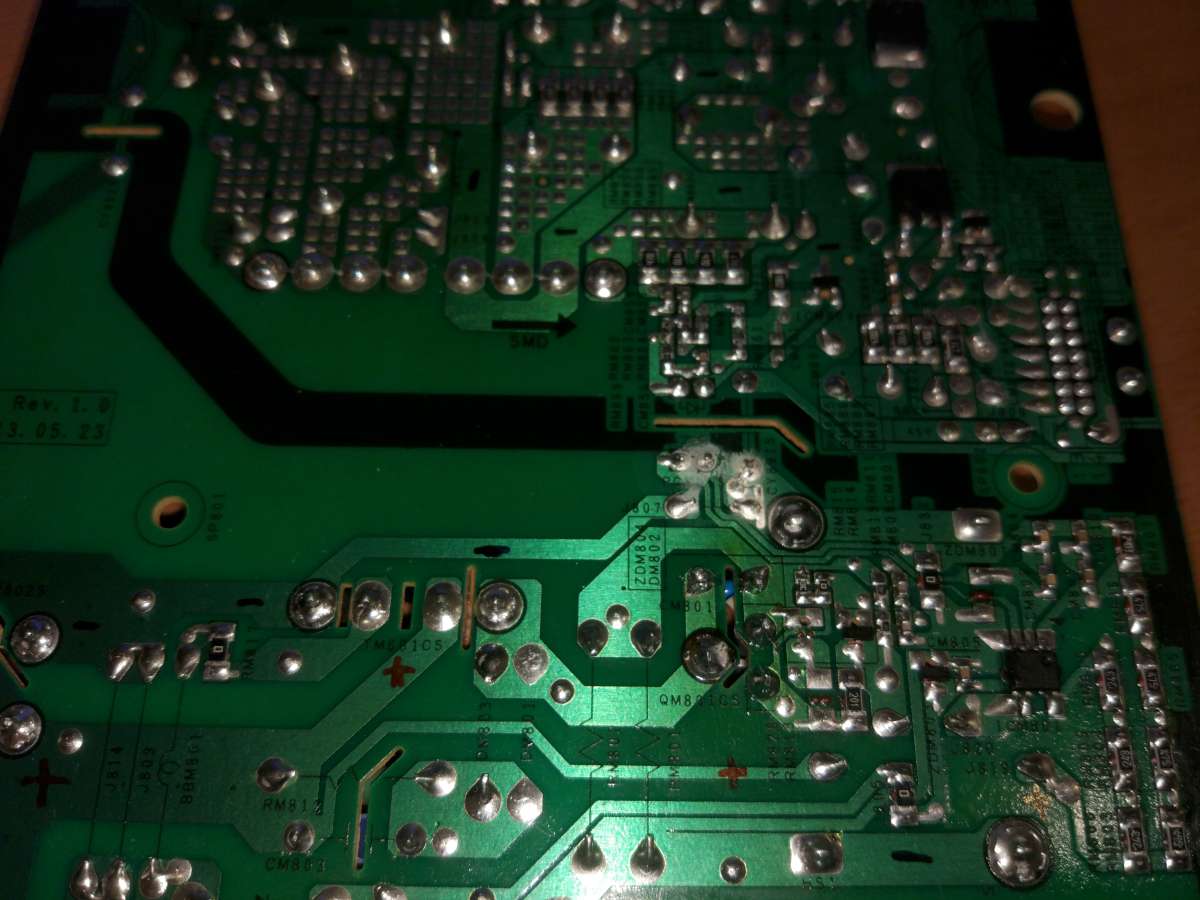

        p.s. CM801 was the capacitor I found burnt and with legs melted.
        On the back side looks strange the area around PC801S

          That voltage on CM806 should be the VCC for the ic, Is ICM801 a SEM3330? if it is I don't have a datasheet but 11v seems low and is likely being produced by the ic's startup cell only. You can test this by disconnecting one end of DM804 and rechecking the voltage on CM806, if it is the same 11v then the transformer is not producing the run voltage which should be closer to +20v.
          There is also a zener diode, ZDM803 which could be bad and zenering at too low a voltage.

                    I replaced ICM801 with a 6755W.
                    I replaced PC801S (optocoupler) with a PC817.
                    Now, with the board disconnected I have on CNL802 D+=48V and D-=43V
                    On CNM803 there is only 1.7V on pin 12 (A5V), nothing on the other pins.
                    On CM806 voltage varying between 9V and 14V.
                    Diodes seems ok, resistors ok ...
