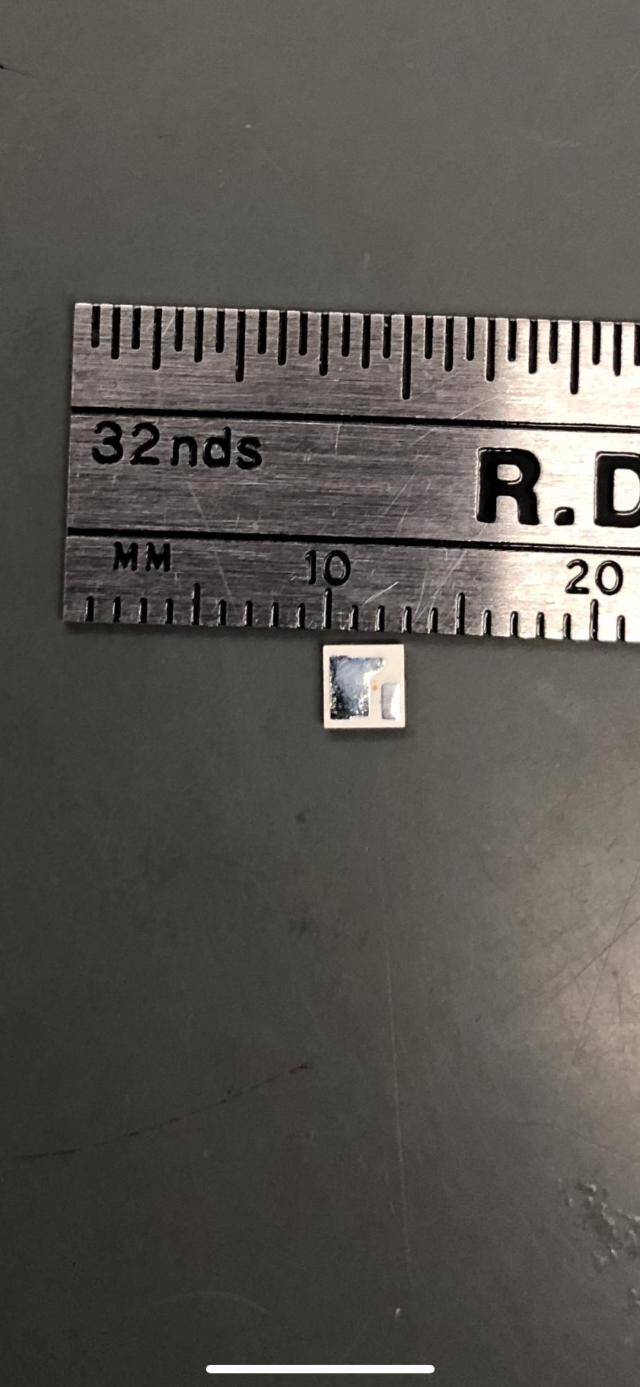

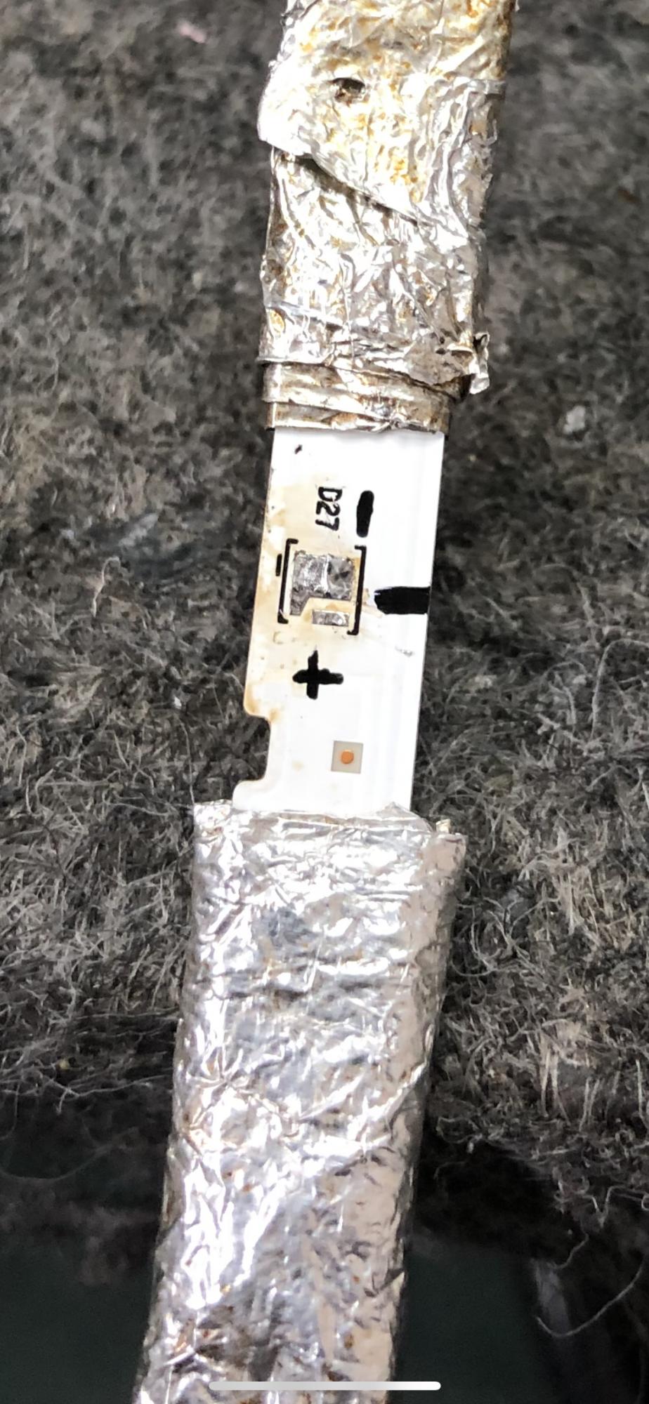

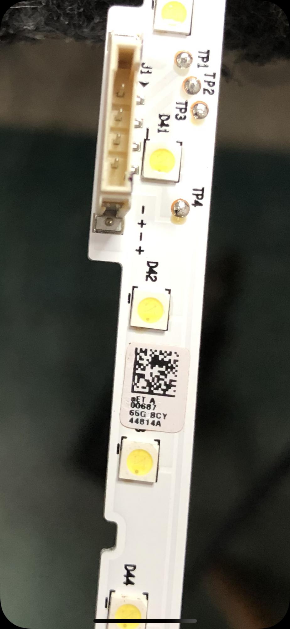

    I am working on a Samsung UN65MU6290V that has bad led backlights. I am trying to replace the LEDS on the strips, but they have a strange shape on the bottom. Can anyone tell me what type led and maybe a part number.Large pad is negative and Small pad is positive. Also runs at 5.2v. strip part number is BN96-44814A.

    measure the size of it... in mm

      Re: Need help to identify LED type
      Also 3mm x 3mm size.
        then 3030 6V.
          Everything I find with that number has square pads on the bottom. This one has a strange shape that is why I am looking for help from this forum. Please look at photos in first post.
            3030 on aliexpress. pads passed on
              here you go
              LINK
