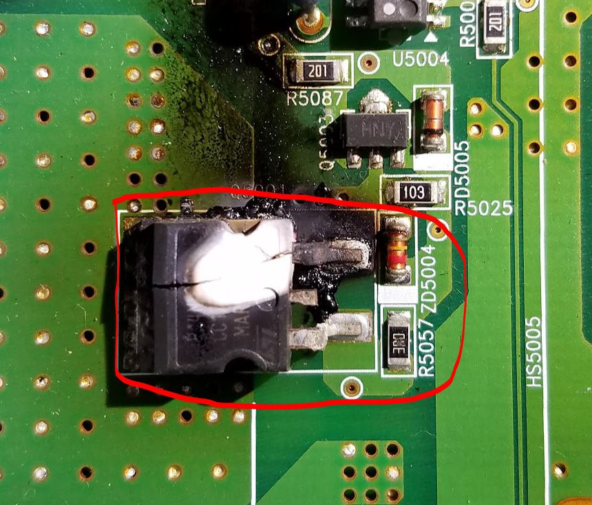

    Please help identify burned components on a samsung pn50a550 Y-SUS board
    see circled
    the blown FET is I beleive B14NK60Z because there is another one sitting close
    Zener diode is short and resistor is open

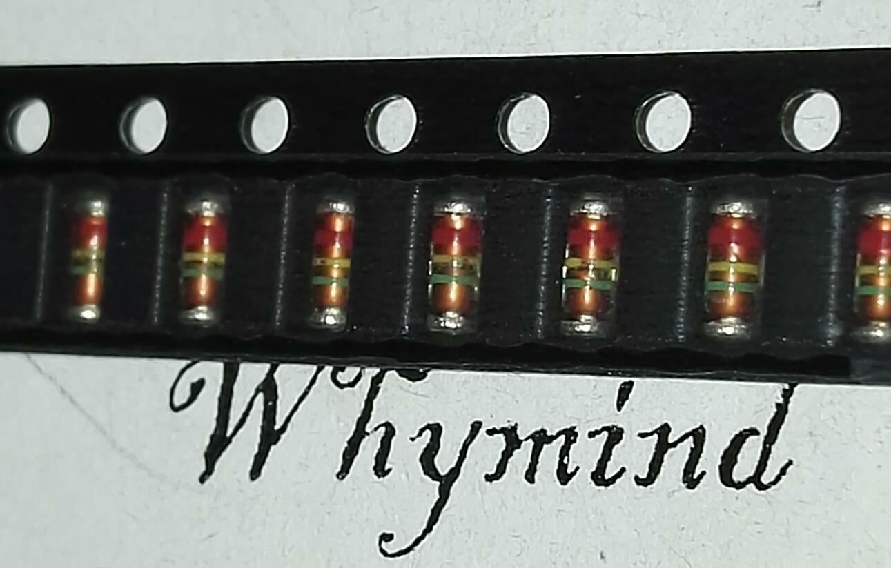

    Color stripes on the diode are red, brown (gold?) and green.

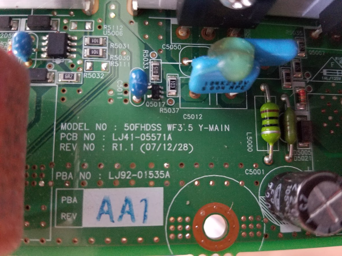

    Re: Please help identify burned components on a samsung pn50a550 Y-SUS board
    Post the board number BN**-xxxx . there are different y-sus used in this model
    Could the zener colors be RED, YELLOW, GREEN ? if yes it could be RLZ18B
      There is no BN** number on this board
      PCB no LJ41-05571A
      Rev 1.1
      PBA no LJ92-01535A
        The zener diode is there for protection so should be something below 30v which is maximum GS voltage for the FET. 18v will work I guess.
        What about Resistor? I can read 0 and E but not the middle symbol, 0 Ohm?
          The resistor could be 300 which would be 30Ω or 3R0 which would be 3Ω I will se what I can find
          Does the other fet have similar parts on its gate?
          To me it looks like a 3R0
          Maybe someone else has a board to check, I believe BN96-07132A is the same, You can't see the value on any pictures due to the heatsink covering the part.
          • zape
            • Jul 2017
            • 176
            3R0 makes sense. Thanks!
              I also see C5008 is bad, so hopefully there is not too much else wrong.

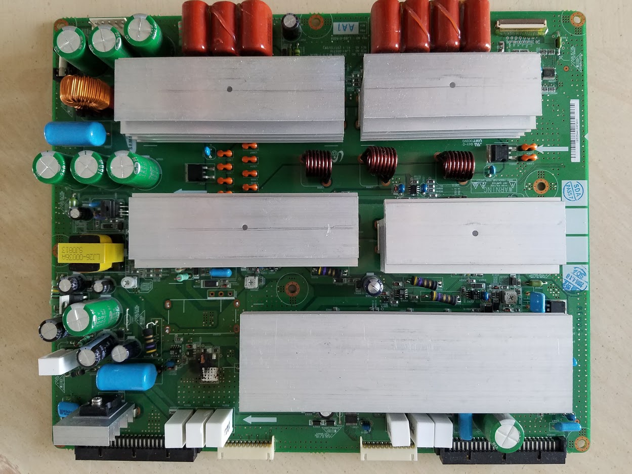

                      Hello fellow Missourian!
                      I disassembled one of these yesterday with that PBA number. Busted panel but was working.
                      Both upper and lower Y-bufs checked OK, no shorted IC's.
                      I'll see about pulling my Y-sus board and taking pix for you in the AM.
                      Just confirmed in my inventory spreadsheet....I do have this Y-sus
