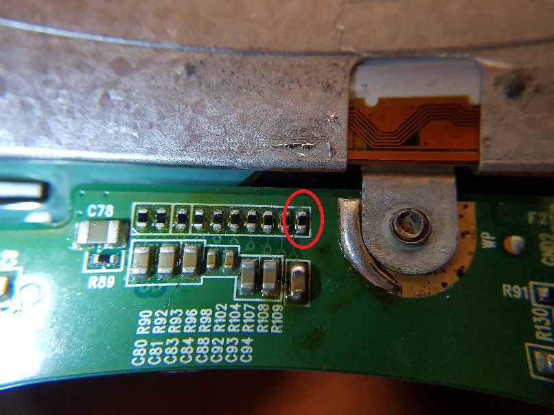

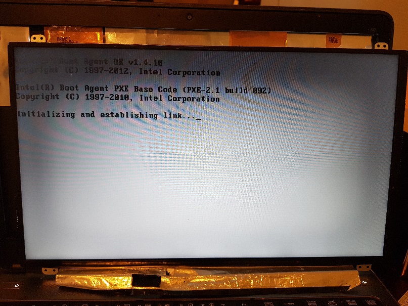

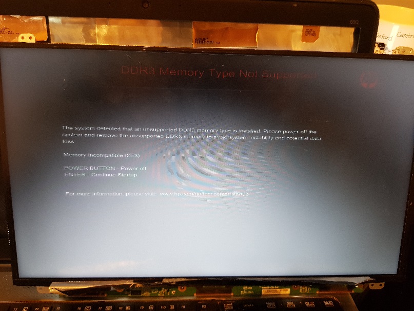

          I've played around with it and found a cap that was shorted by a resistor to ground however I have no idea what it's value is so I had put another resistor on from a cracked donor panel and I now get dim inverted colors, I had opted to look at getting a new panel rather than continuing as I have other projects I'm working on, but here is some pics of what it looks like atm.
