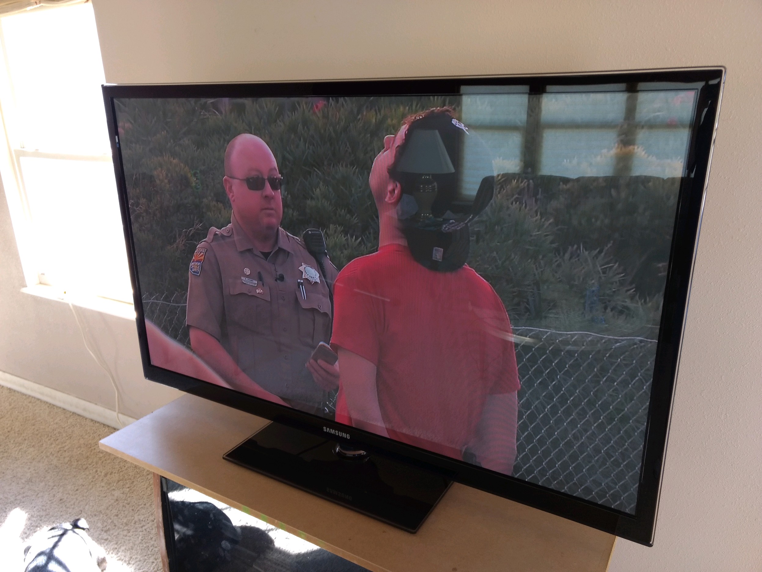

        Fixed!
        After replacing both the X and Y sustain boards the TV is working great! It still has a gorgeous picture and after clean-up it looks like new! My only regret was not being able to troubleshoot the original boards through to a finished repair.
