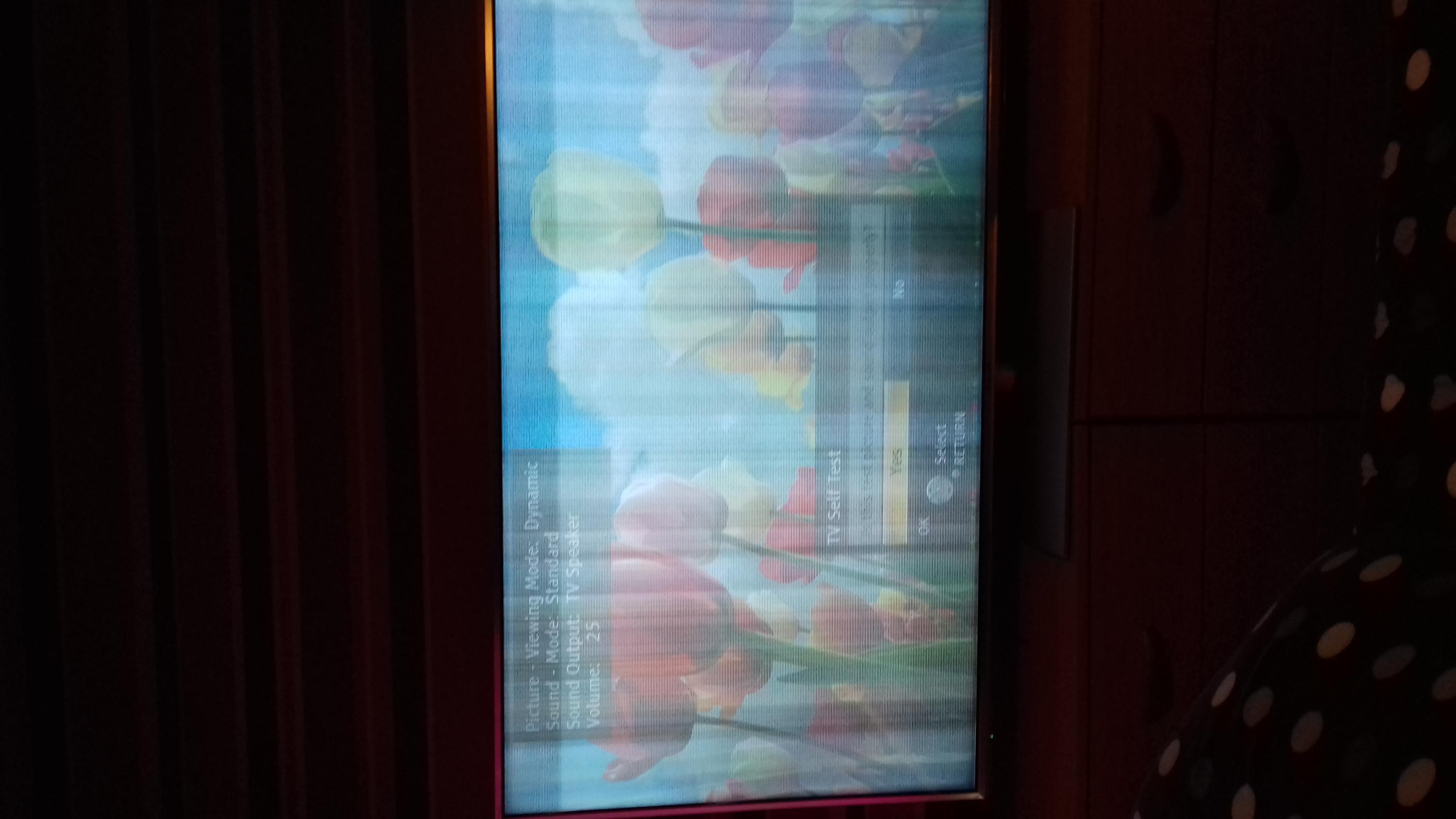

hi can any one help could you tell me is this a T-CON board fault or a panel fault
Panasonic TX-L55ET60B
Re: Panasonic TX-L55ET60B
Originally posted by snopy44 View Postso is there nothing can be done to repair the panelPlease do not PM me with questions! Questions via PM will not be answered. Post on the forums instead!
that method works where there is a bonded tab problem and pressing on a troubled tab can change the result. Your problem is probably worse than that. Further, the second picture that you posted is rather unusual as it shows a white half that has "wave" on the side. That looks like someone disassembled the set to fix an issue with backlighting and then during re-assembly, didn't put the diffusing material back properly. IF this is true, then based on how well (NOT) this panel was handled, it is unlikely that it can be saved.
