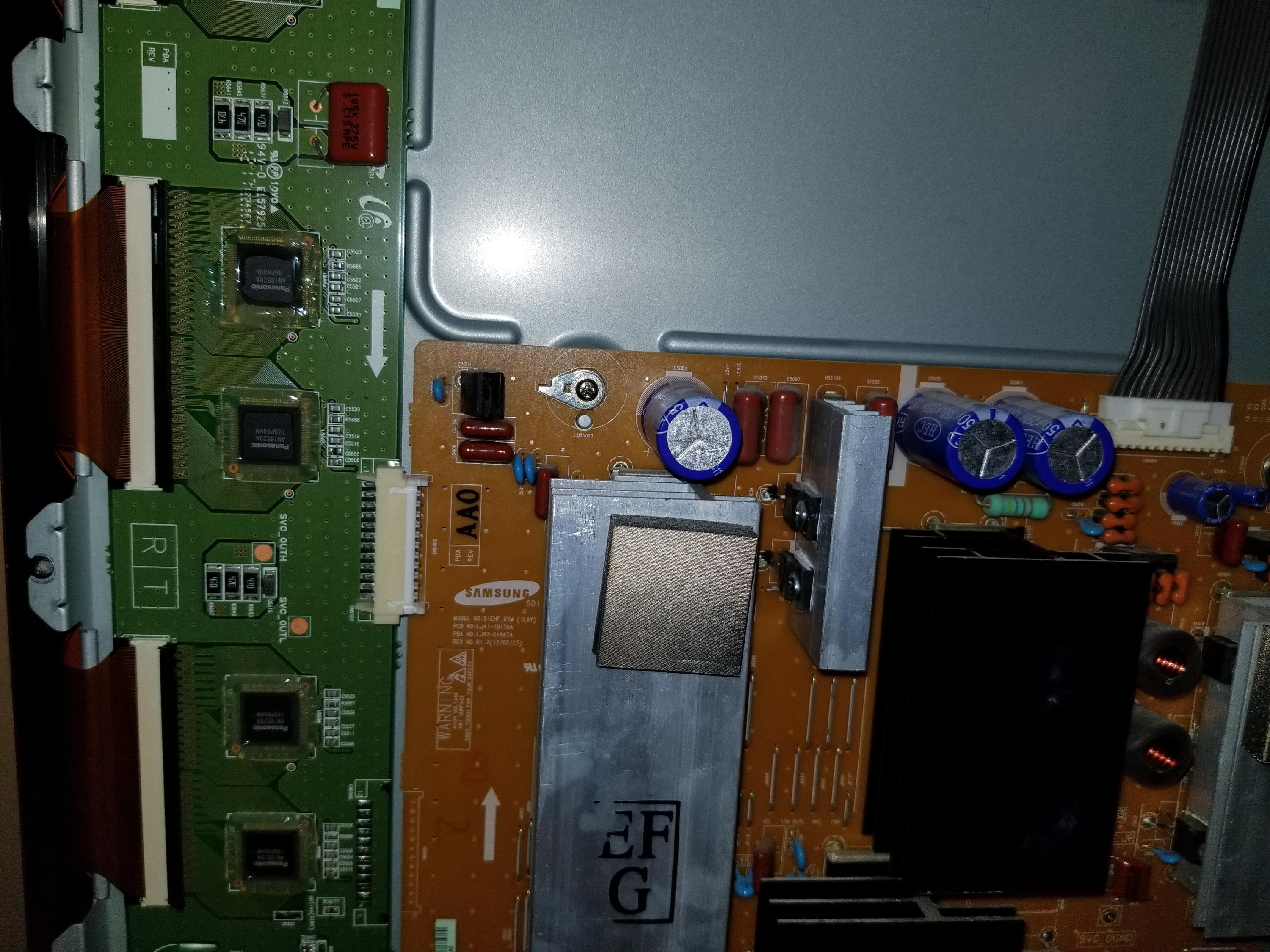

    Newly acquired project tv... pn51e550df1.
    Starts up fine, regular heartbeat. But top half of tv is black, you can slightly notice three varied shades of black for the top. Tried testing the IC on buffer for shorts on top, no luck.
    I'm thinking it's maybe the y sustain board. Can I test the output to the buffers or something? The top pin for the buffer seems to have continuity between all pins which seems incorrect.
    Anyone have any thoughts? Cheers!!

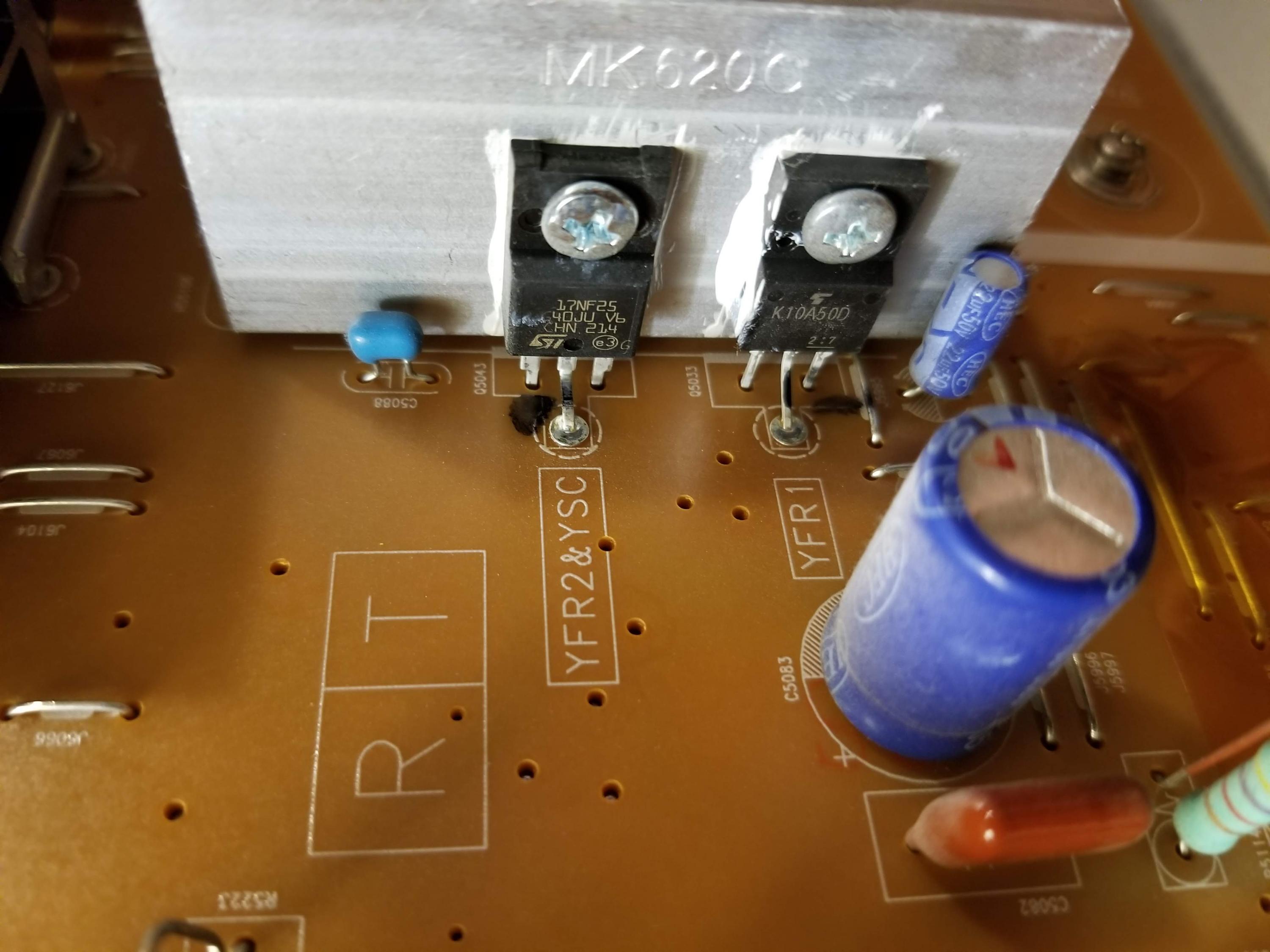

      check ysc on top buffer

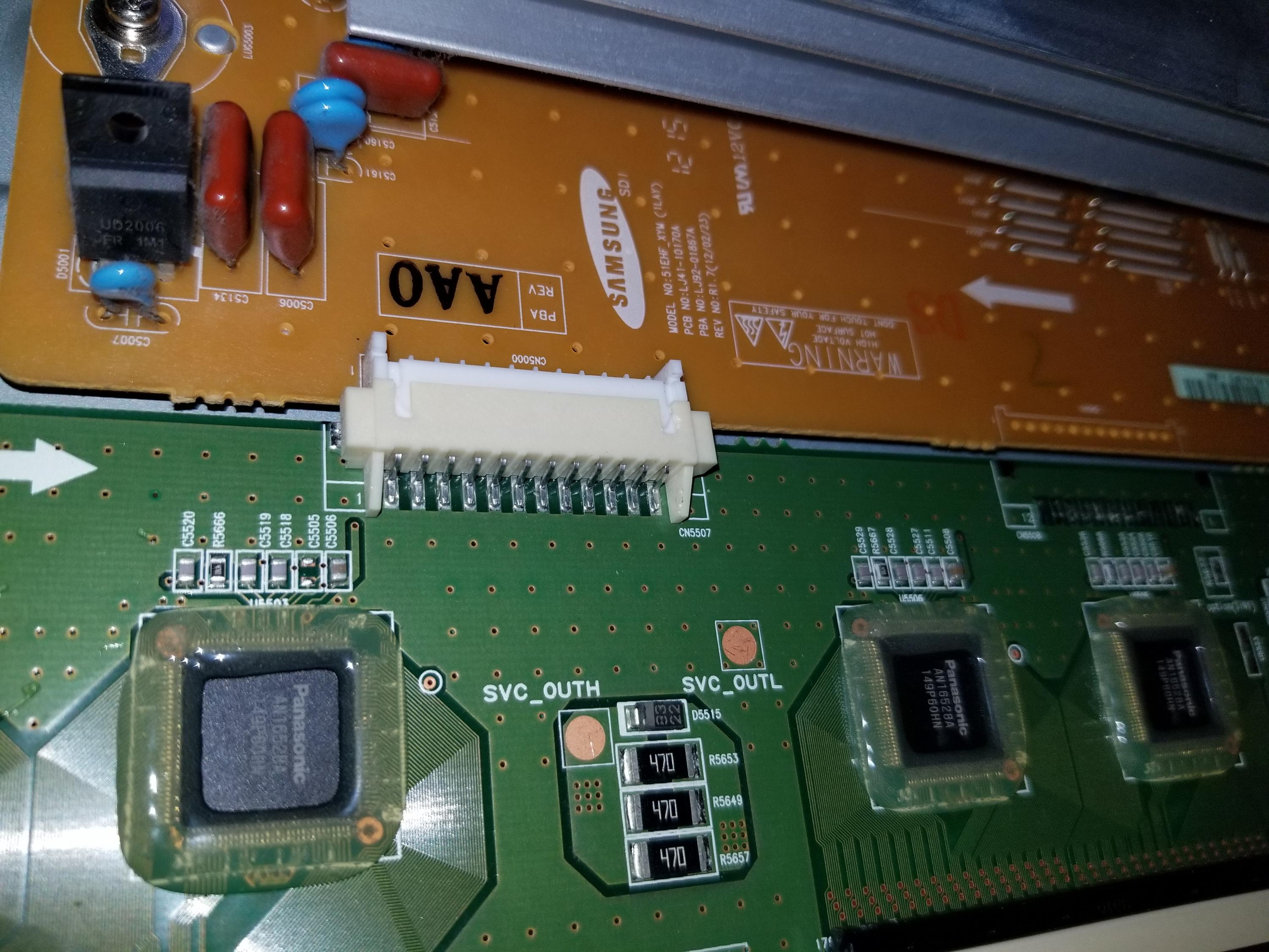

        Just took these quick videos... one just shows whats going on (half black screen), the other is me using a continuity tester on part of the buffer board... seems maybe failed?

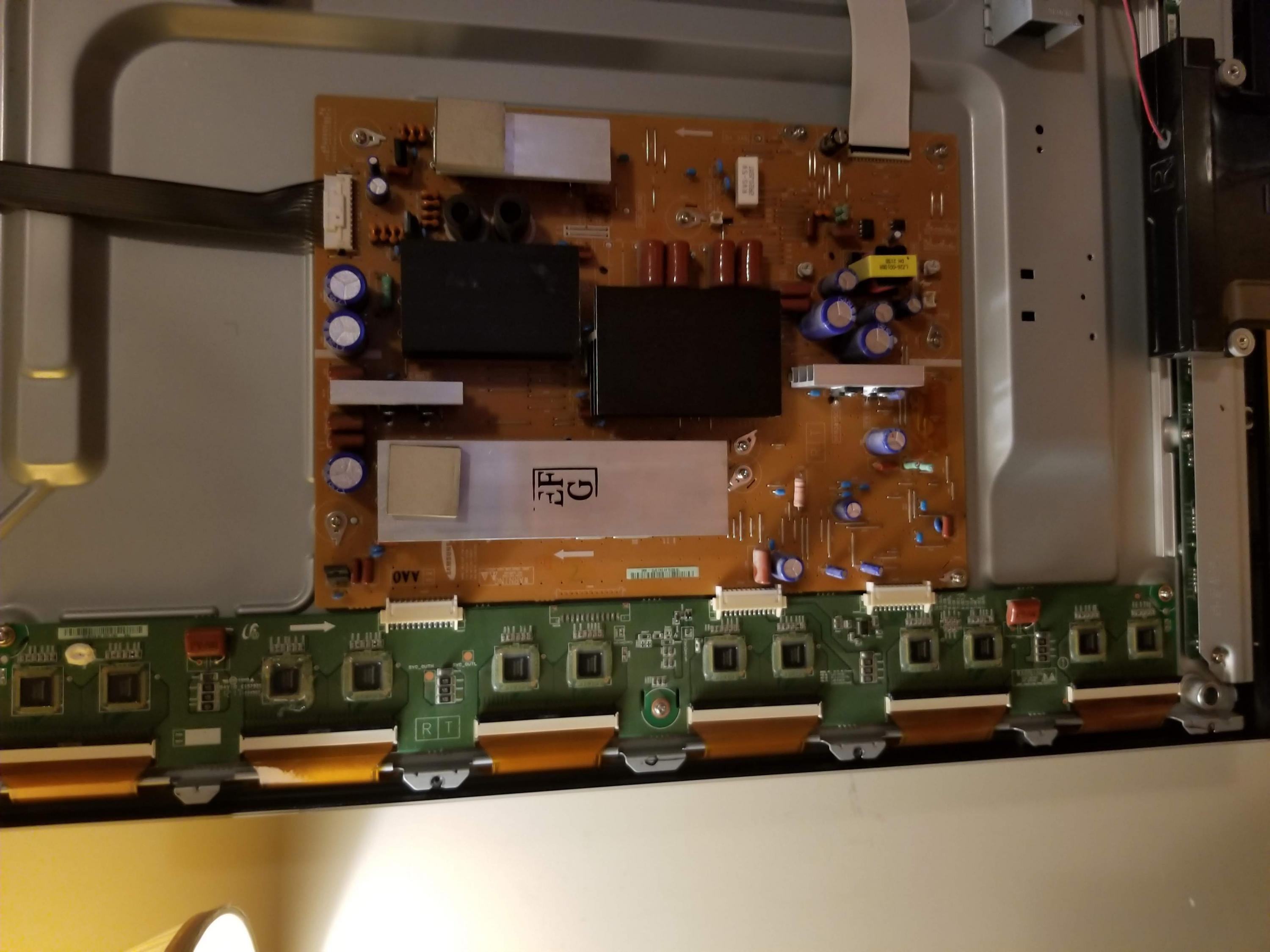

        Took some pics of things that said ysc - not sure what to test, there is a ysc and ysc con coming from the mainboard ribbon cable and then a resistor or something attached to a heatsink later on in the board.

          Originally posted by chrismurphy
          replace upper buffer

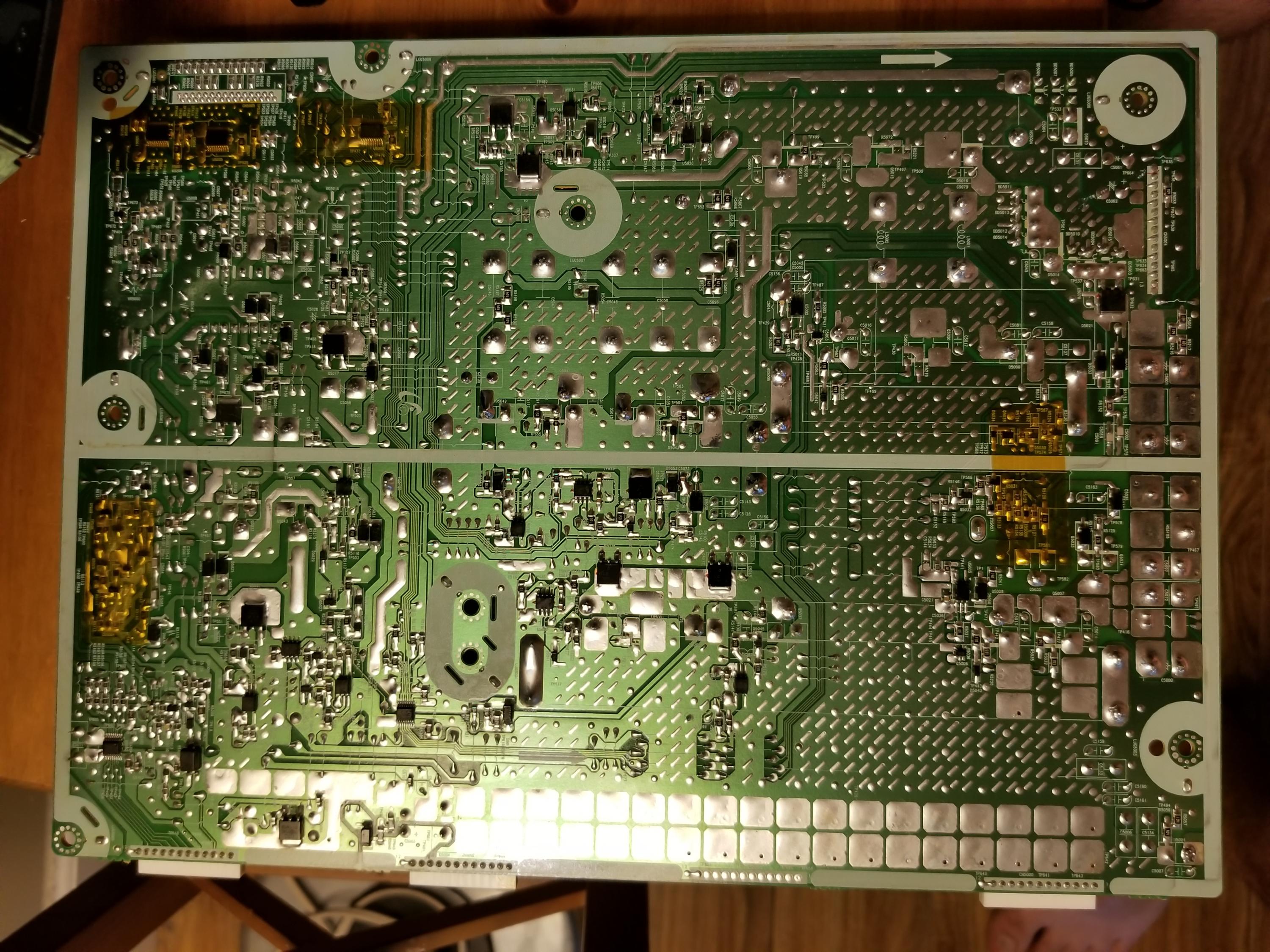

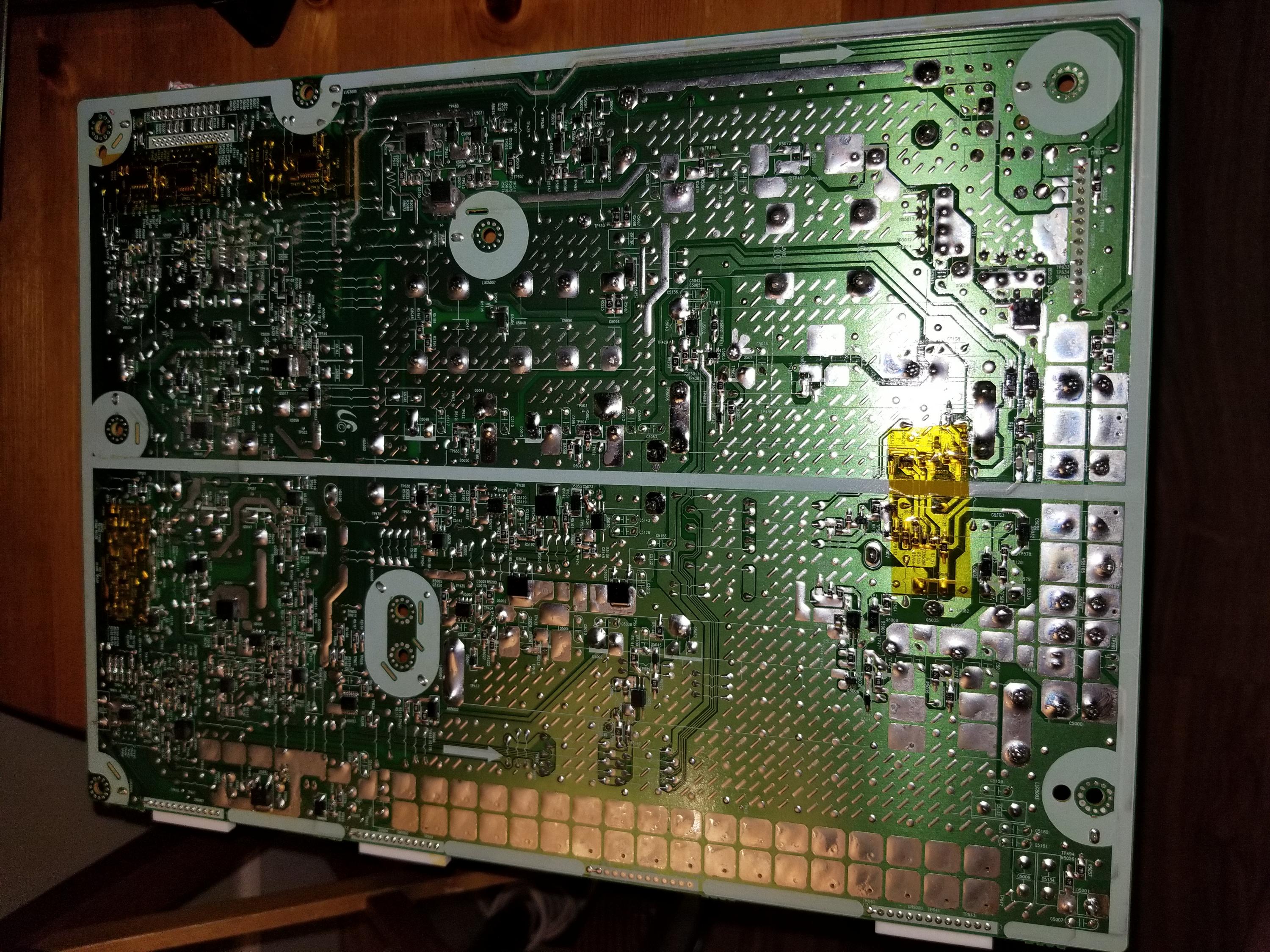

          Here's some pics...?

                LJ92-01871A is the buffer board.

                  your testing on the buffer for shorts is wrong

                    check all the group of 470 ohm resistors on your top buffer

                      Ok! Should I be testing for a short? I'm super novice... I see the 470 chips though.
                      I did test the buffer chips by putting black to the svc_outl spot, then ran the red down both sides of the ribbon socket thing. No shorts were found there.

                        Well, I've got a y drive board on order... Wondering if I should have picked up the y main also to cover my bases... Wish me luck.

                          Re: 2012 Samsung plasma, top half is black pn51e550df1
                          Go for the Y-Driver Bd. first. Though it has been said in some quarters to replace the Y-Main and Y-Driver Bds together.

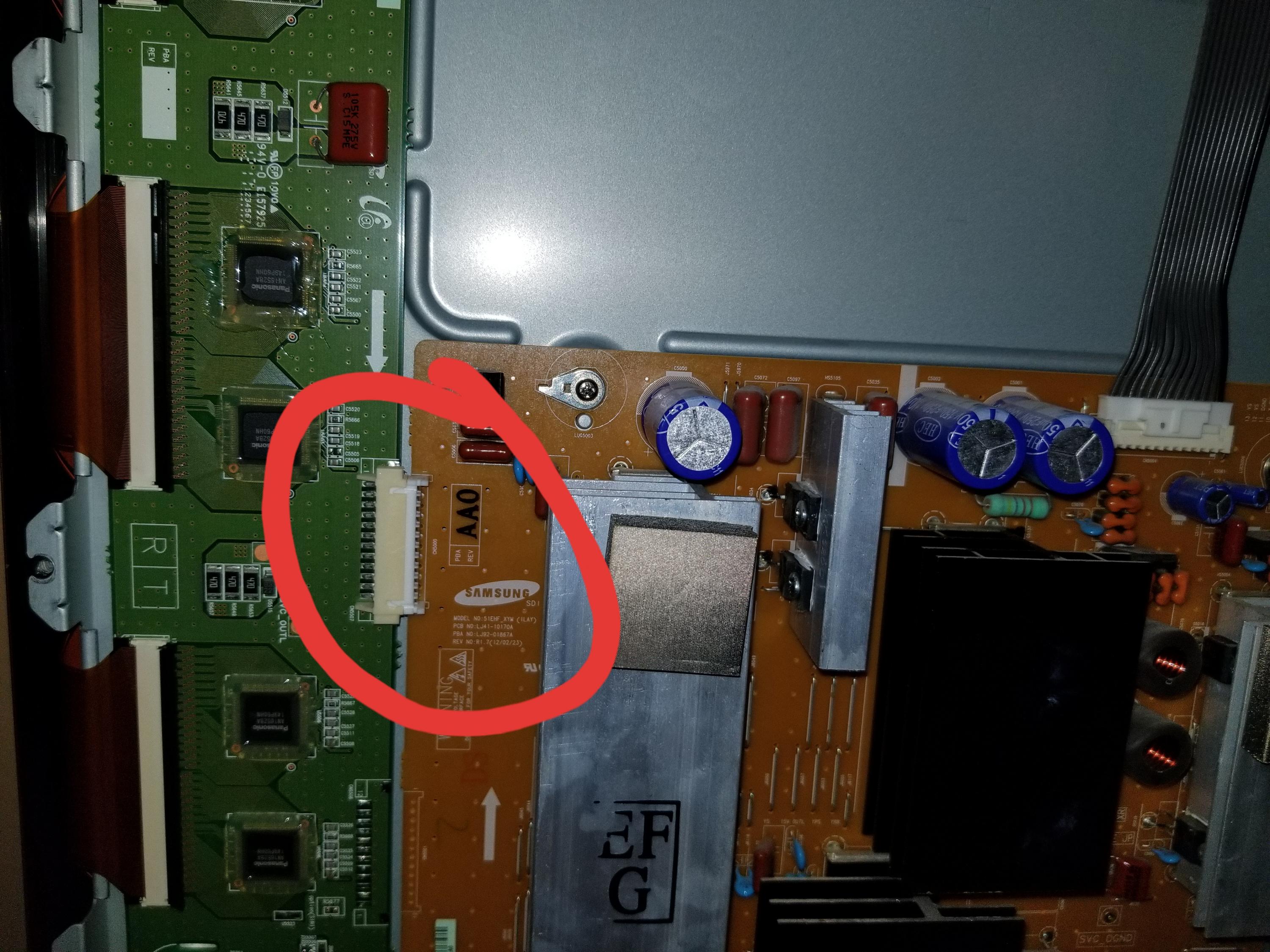

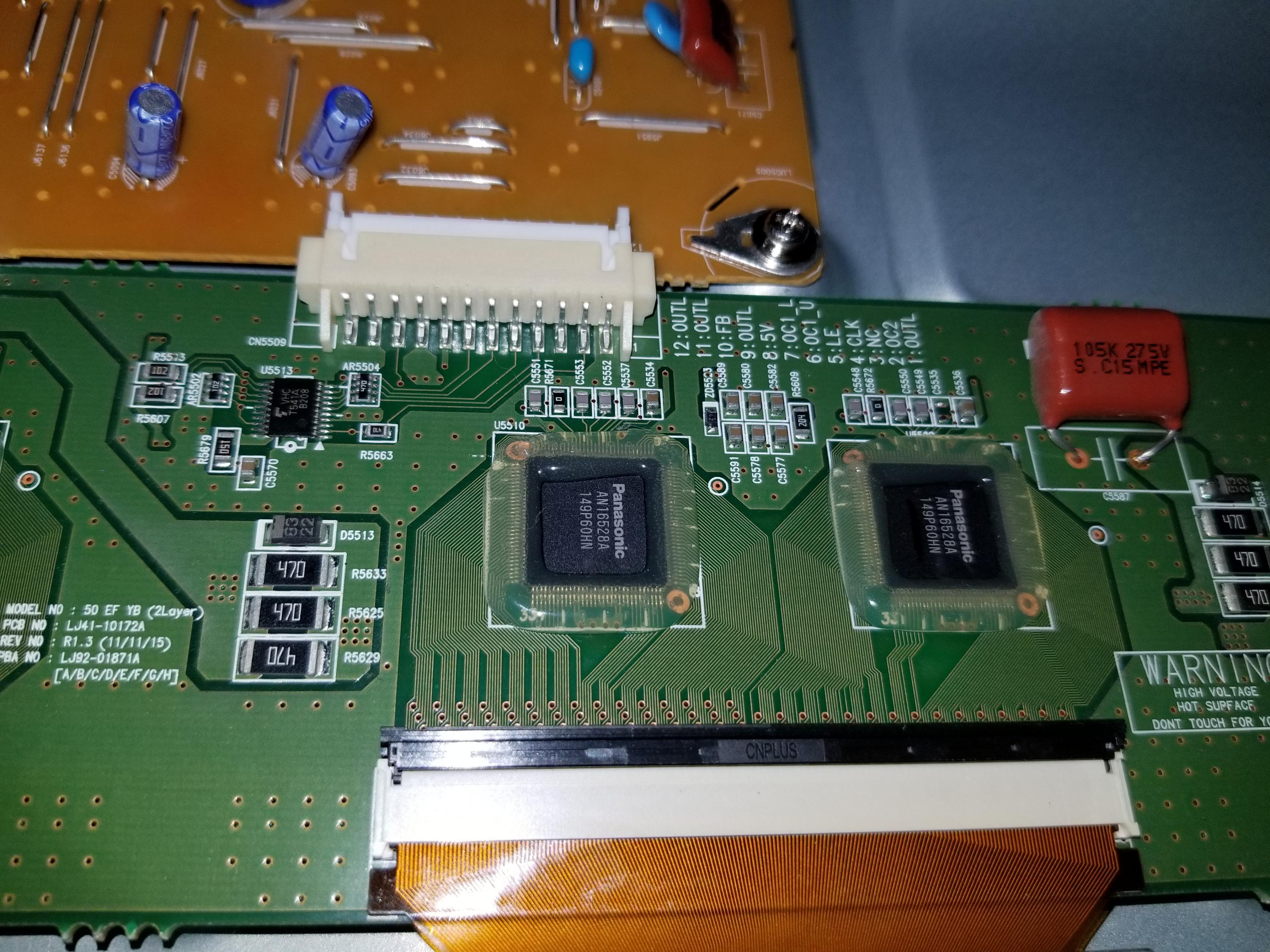

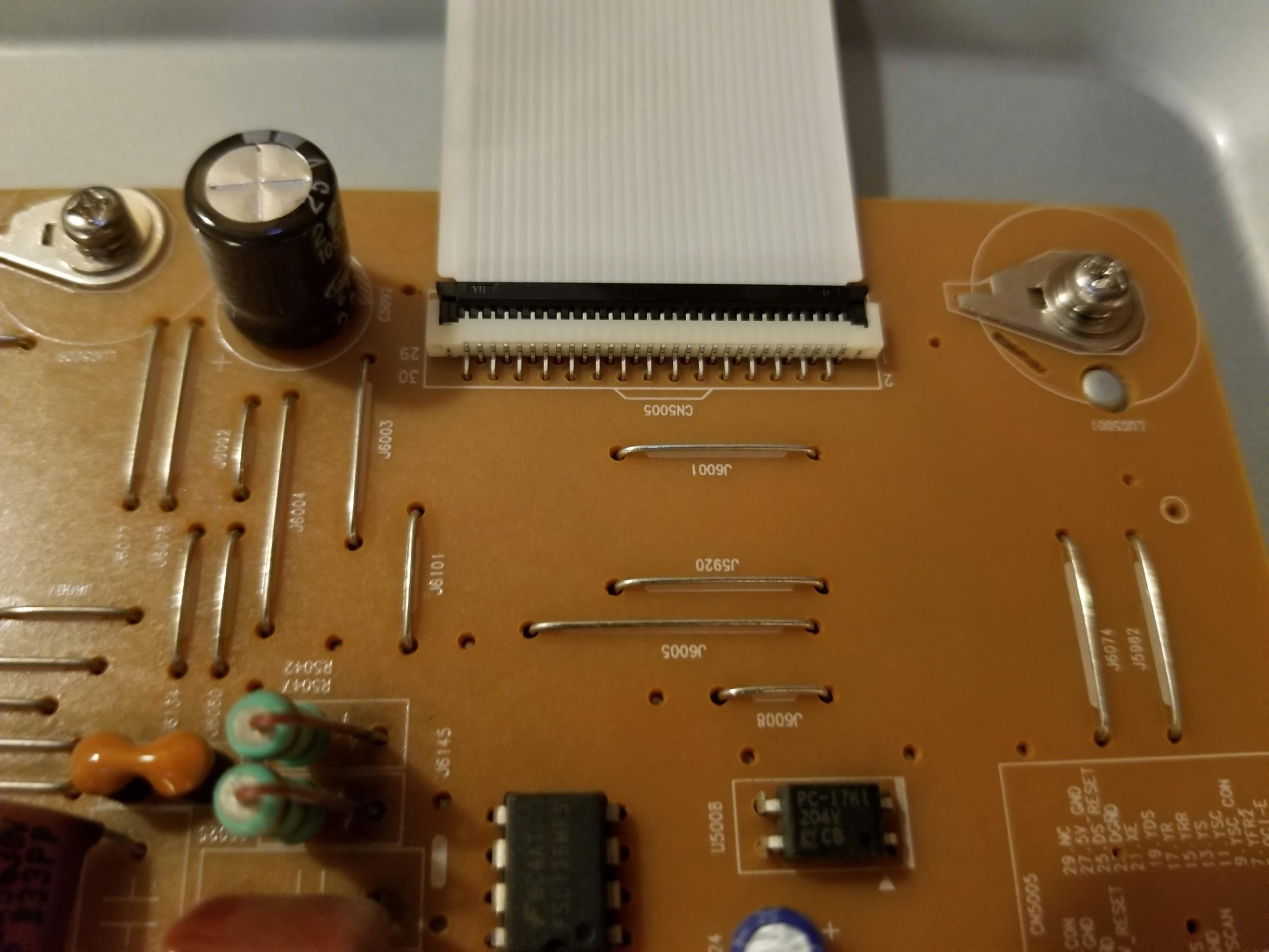

                            Some more pics...
                            It's weird that everything seems shorted on the plug highlighted in red. Not sure what that means exactly, does that mean the short extends to the y sustain also?
                            • Andrew F. Ali
                              • Jan 2014
                              • 2450
                              • Trinidad & Tobago
                              Yes...
                              • attainteddragon
                                • Apr 2013
                                • 764
                                • australia
                                that entire connector appears to be ground plane, that is why it appears shorted.
                                      first thing that i think that you need to do is remove the upper buffer board completely from the chassis.
                                      in diode mode, place your red probe on that connector that you have just discussed, then rake your black probe down the pins that where the panel plugs into the buffer.
                                      a beep is bad.
                                      once you know which chips on the buffer are bad, you will be able to test the new one prior to installation.
                                      it seemed to me that you were unsure of how to test them properly. let us know how you go.

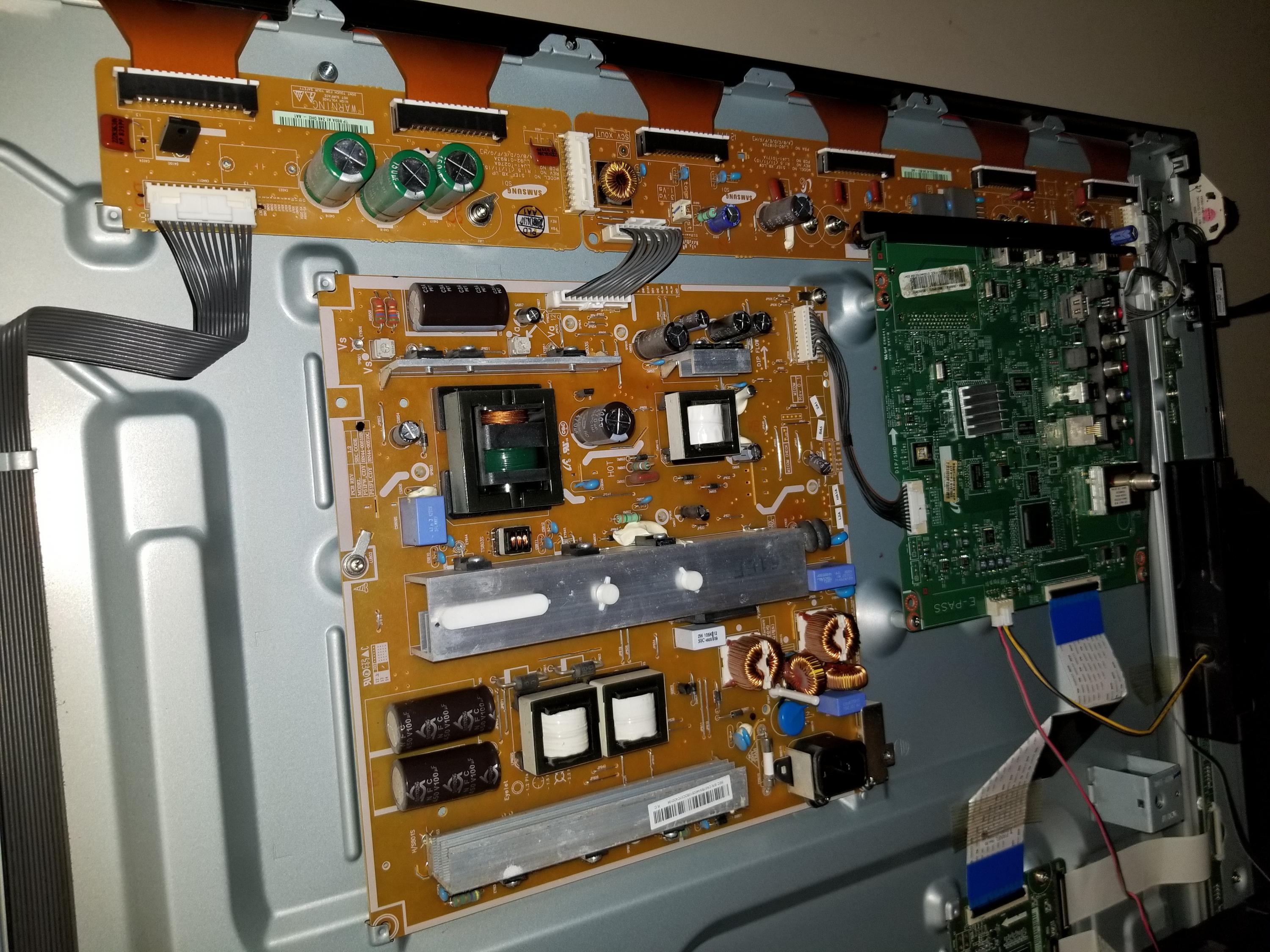

                                        • 87

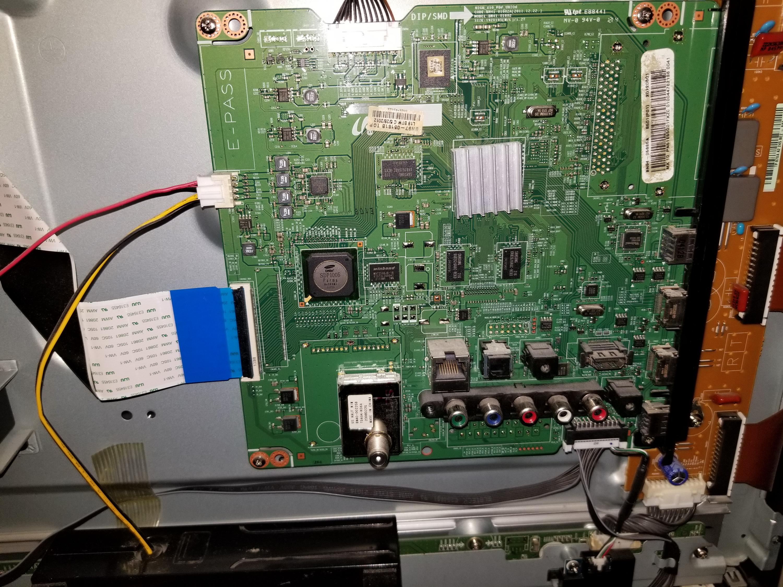

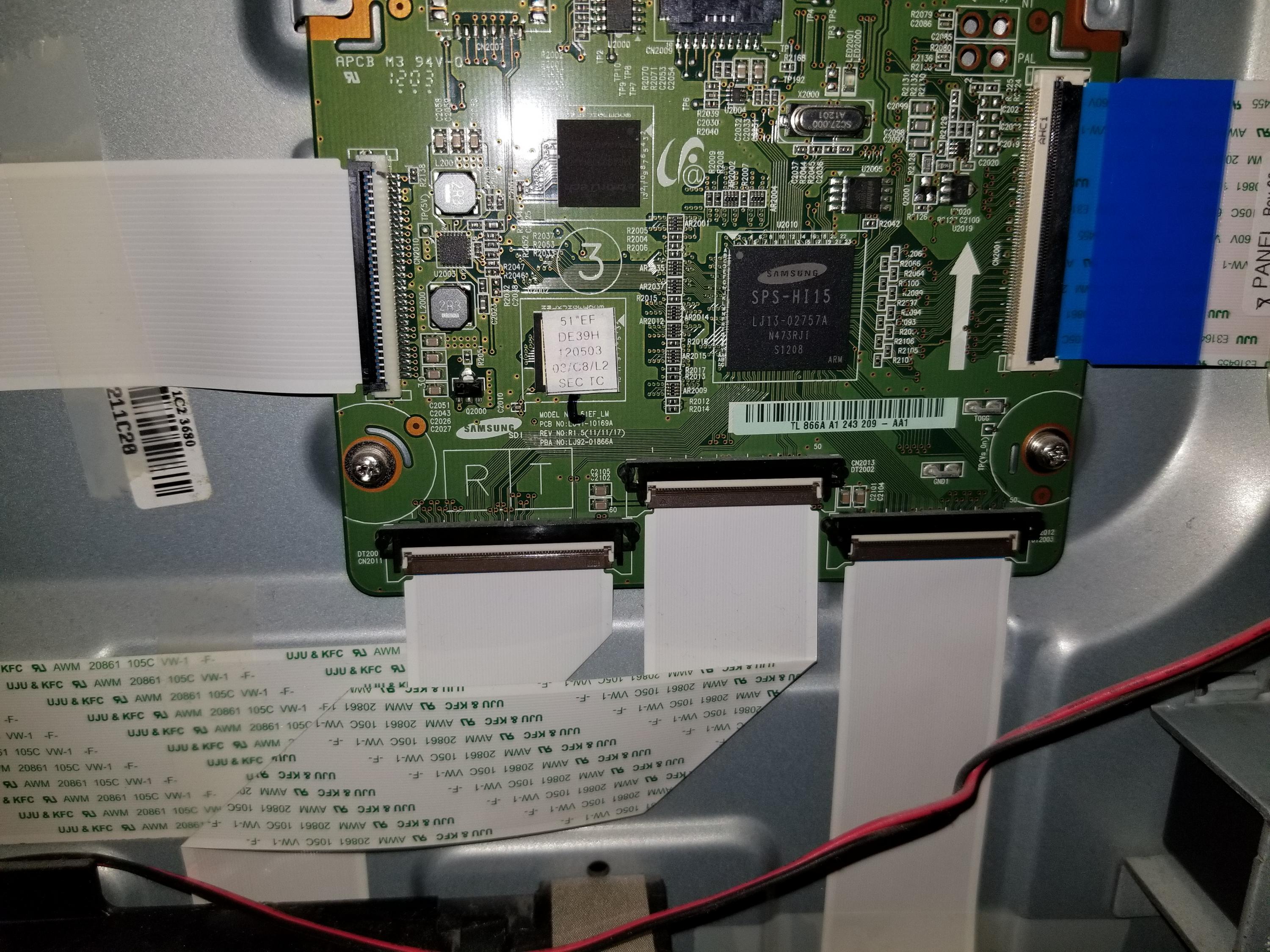

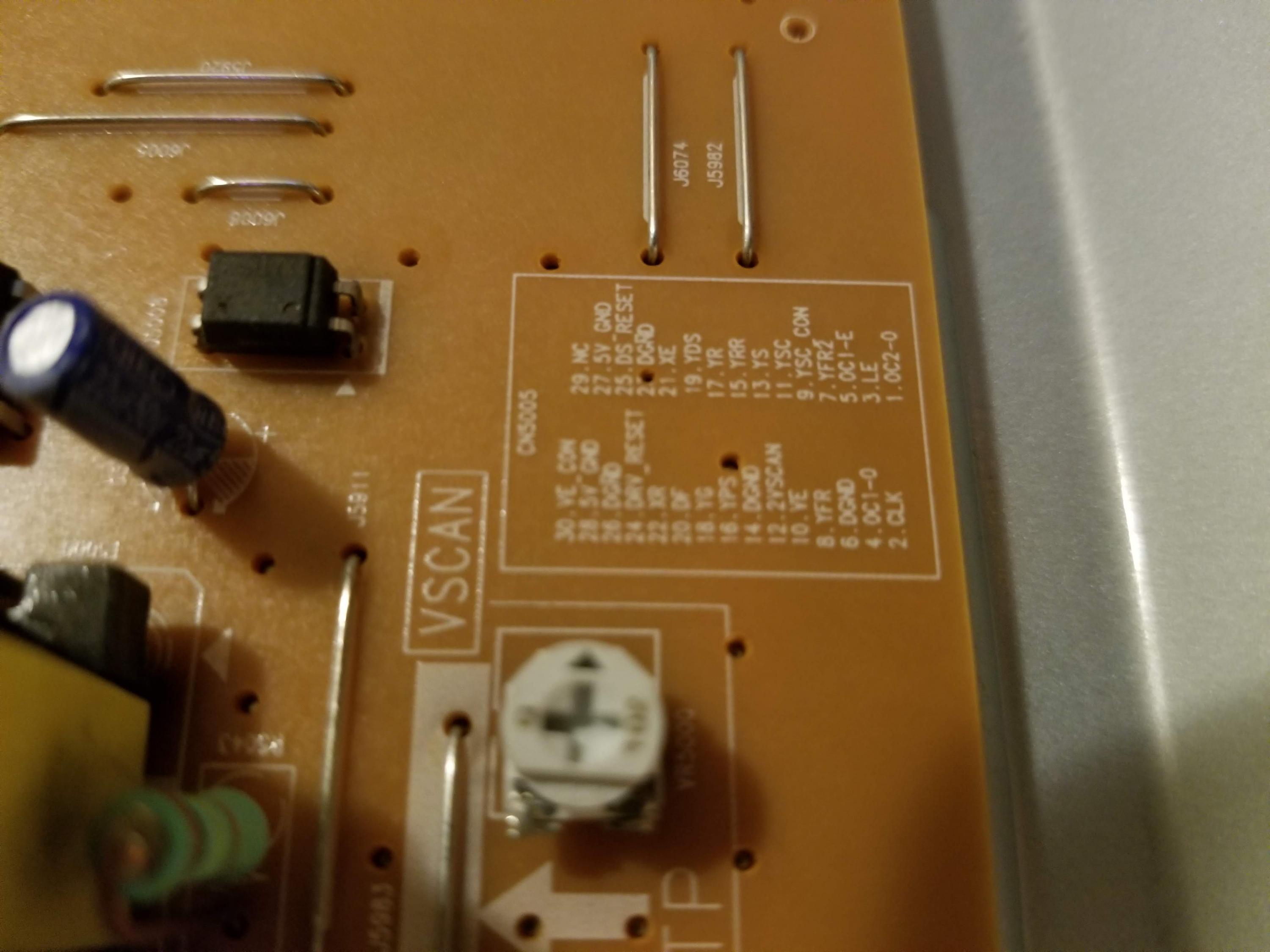

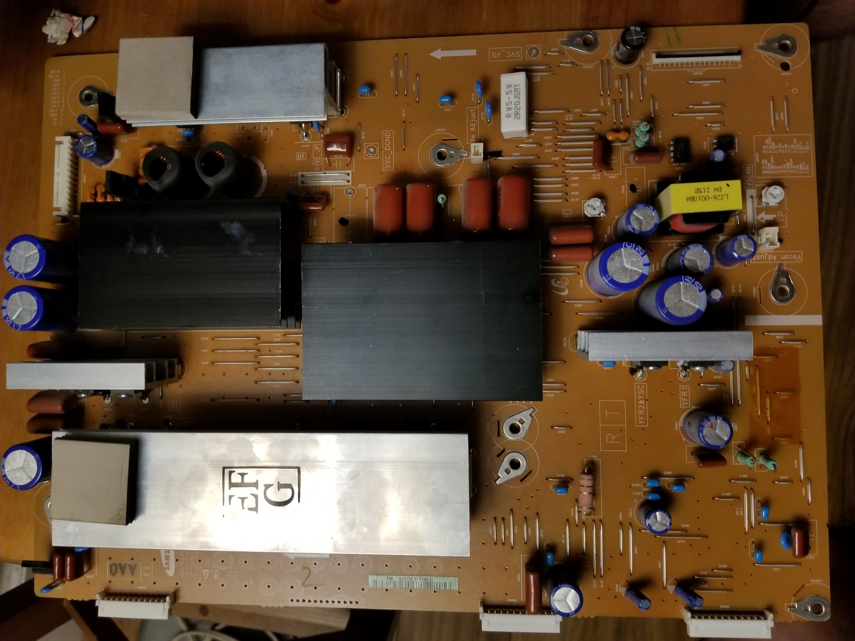

                                        Yes, I've done the test a few times now. Didn't realize the top connection was just ground essentially. There are no beeps... Makes me worried the fault is in sustain board.
                                        Attaching some more pics of the sustain board, anything I should check before I plug a new y drive board in?
