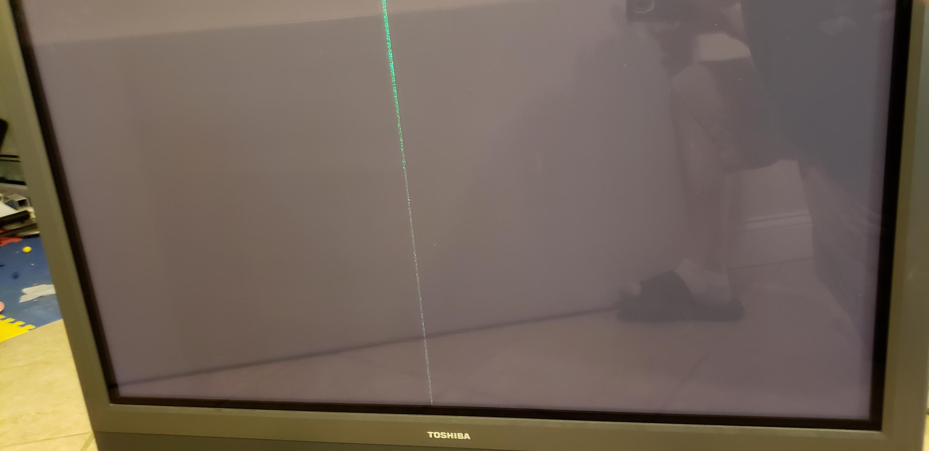

    Toshiba 50 hp16
    Green vertical line in center of screen all else is fine. Any suggestions? Thanks
  • attainteddragon
    • Apr 2013
    • 764
    • australia
    Re: Toshiba 50 hp16
    appears to be a panel fault to me. shimming around the associated panels ribbon cable, or (if this panel has removable driver boards) reseating the ribbon cable connector in that spot "may" relieve the fault. this is not a permanent patch, only temporary.
