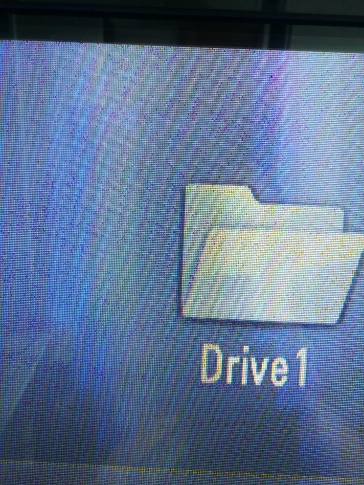

    Hi
    Excuse my poor English, I'm French.
    A friend gave me his TV A Lg 60PZ550_UA .
    This one had an image with holes.
    Here is one of the flaws
    https://img110.xooimage.com/views/0/...9-54825ca.jpg/
    By activating the test pattern here is what I found
    https://vimeo.com/271719070
    I managed to really improve the image by setting Vy to +8v.
    But there are still several shortcomings
    https://youtu.be/Ockpf6fJa2I
    This defect is clearly visible on the whites
    https://img110.xooimage.com/views/7/...9-549f0b0.jpg/
    On the black background I also notice a swarm of green and white dots.
    These defects are almost absent on the TV antenna but very visible on a video via USB.
    When I run a white clean the image is perfect during this test
    I also rewelded the induction coils without any more success, and changed the ctrl card .
    I don't know what to do anymore.

                  The defect on the video indeed resembles what I had initially before modifying Vy
                  Here's what I have now:
                  almost only with usb port
                  https://zupimages.net/up/18/24/awwa.jpg
                  And on all black backgrounds the video was taken near the screen to better visualize the defect.

                      the defect of pink points is increased on all the sources except the tuner

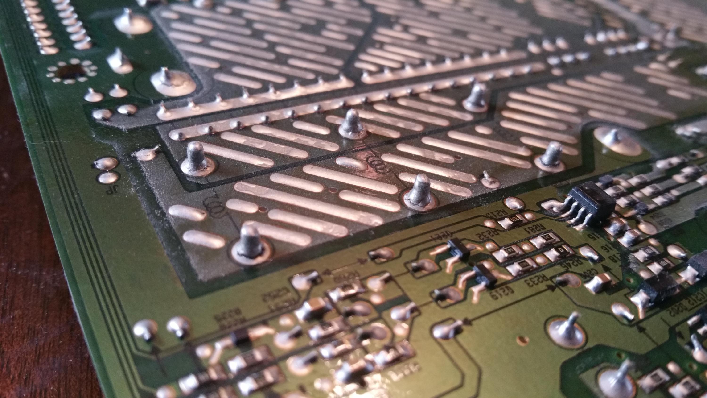

                                      Have u tried re-flowing the coil solder joints on the zsus ?
                                      Checked the buffers for shorts on the ysus ?
                                      • tvtimmy
                                        • Mar 2015
                                        • 1160
                                        • usa
                                        Re: artefacts Lg60PZ550
                                        If they look like this, on the ysus or zsus, they are bad.
