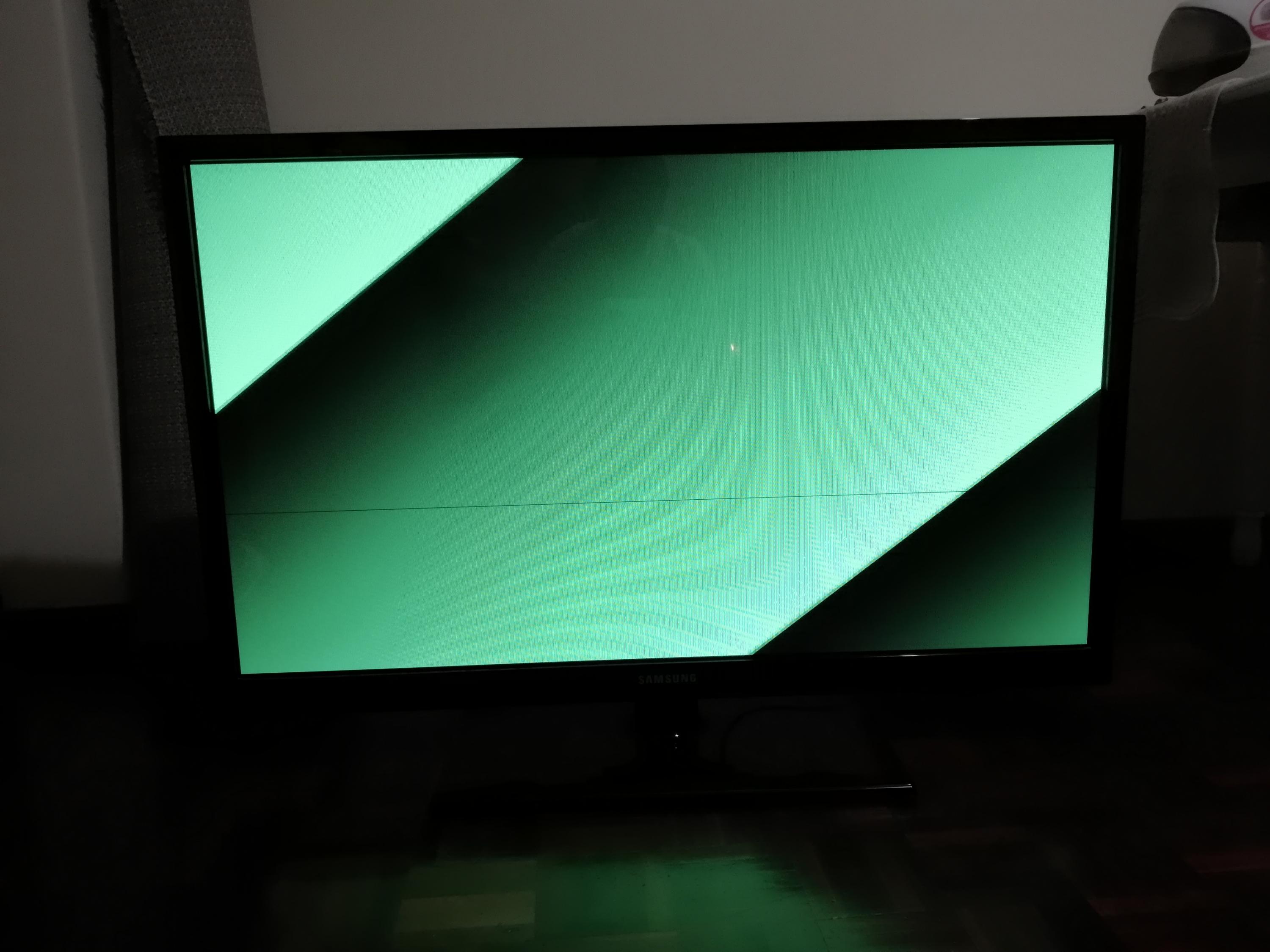

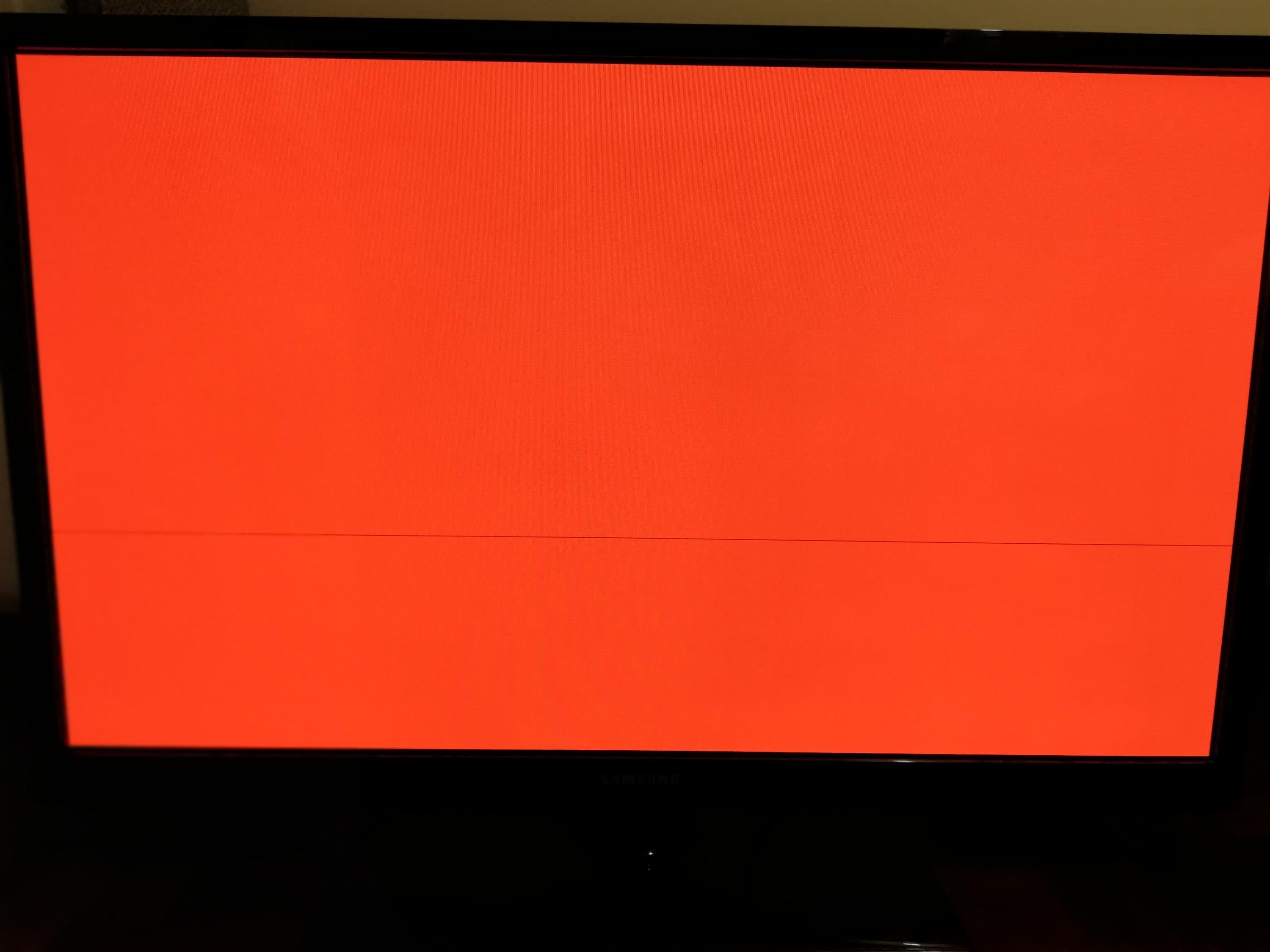

              Re: Samsung PS43D450 plasma TV that does not turn on

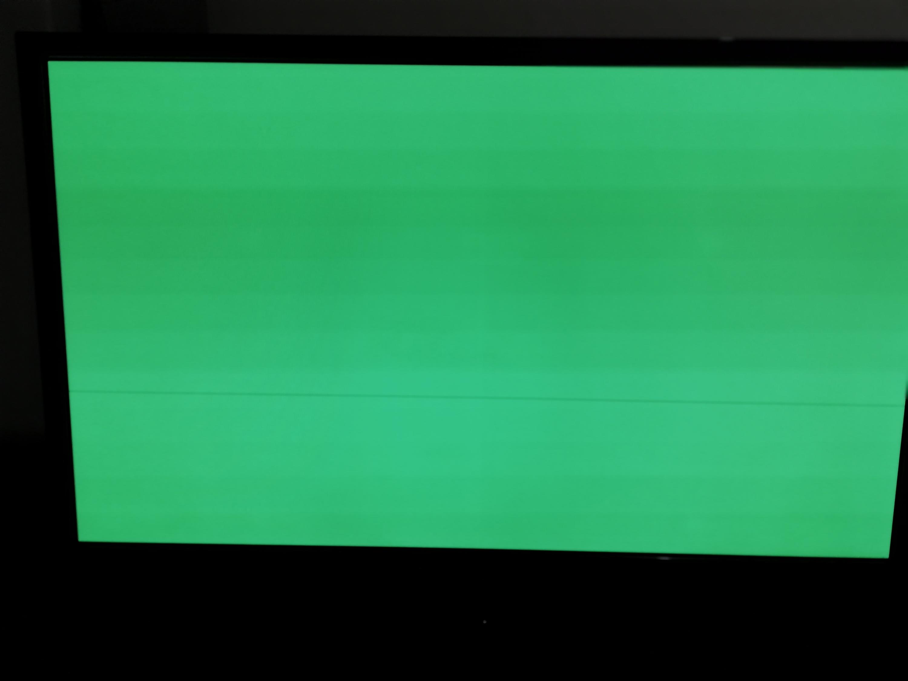

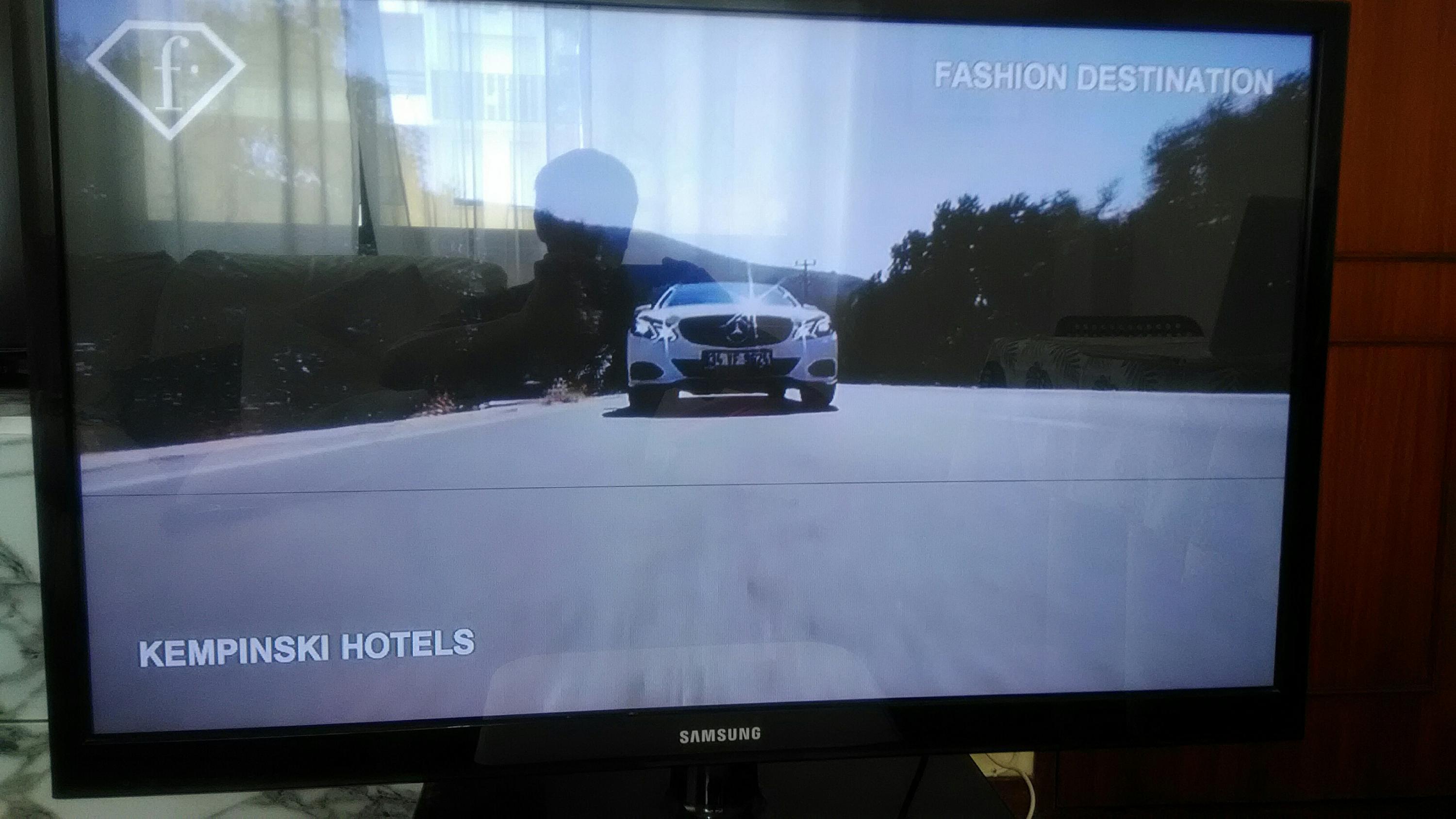

              I check the upper board with dmm and has no shorts, now I look closer and its only one line of pixels (points) with 1 mm in all the screen I will put images here.
                Clean also the X-Main Bd FFC to the Panel. Be very gentle and careful. Look again at the Main cables and see if any damage to the FFCs

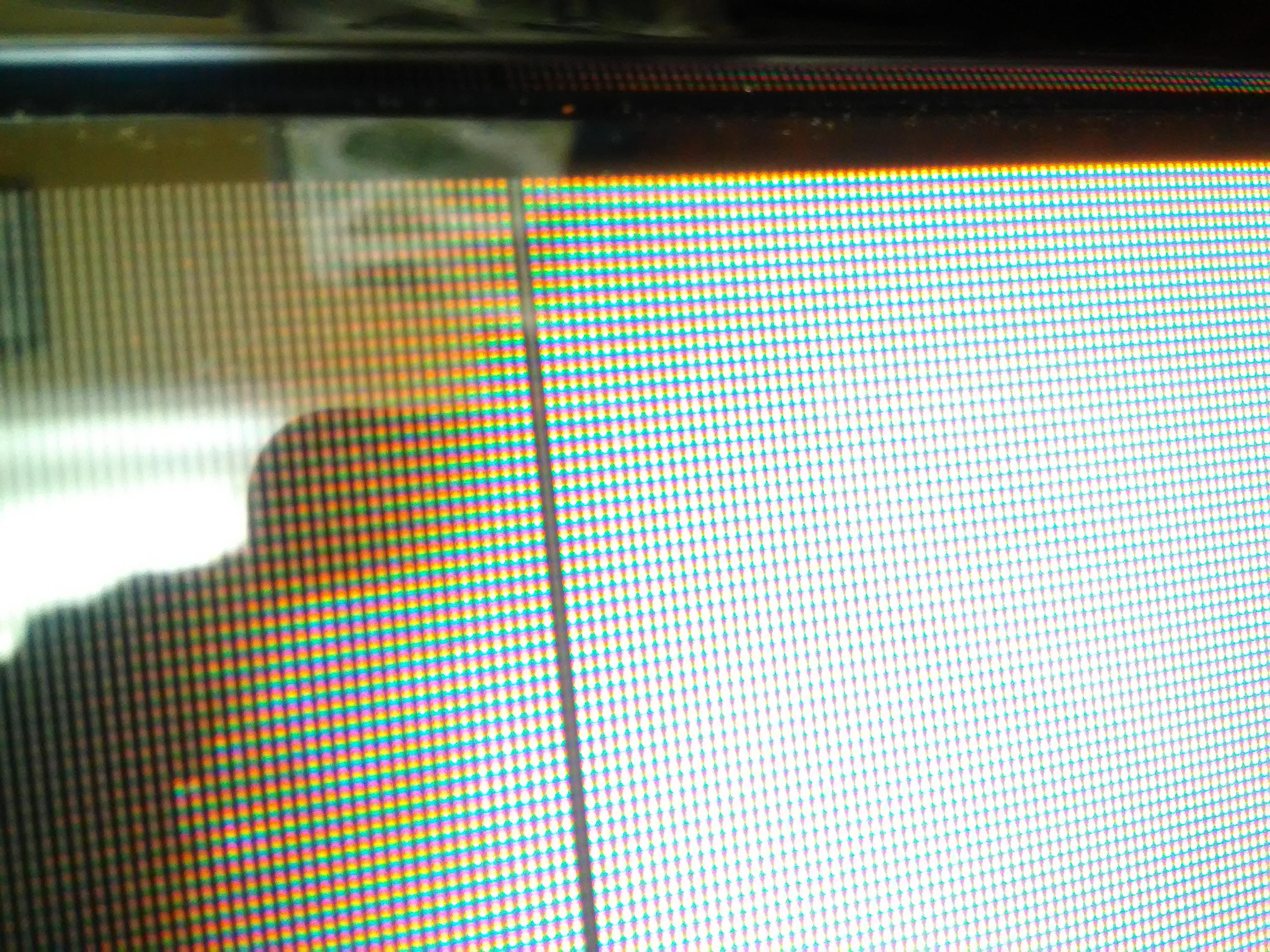

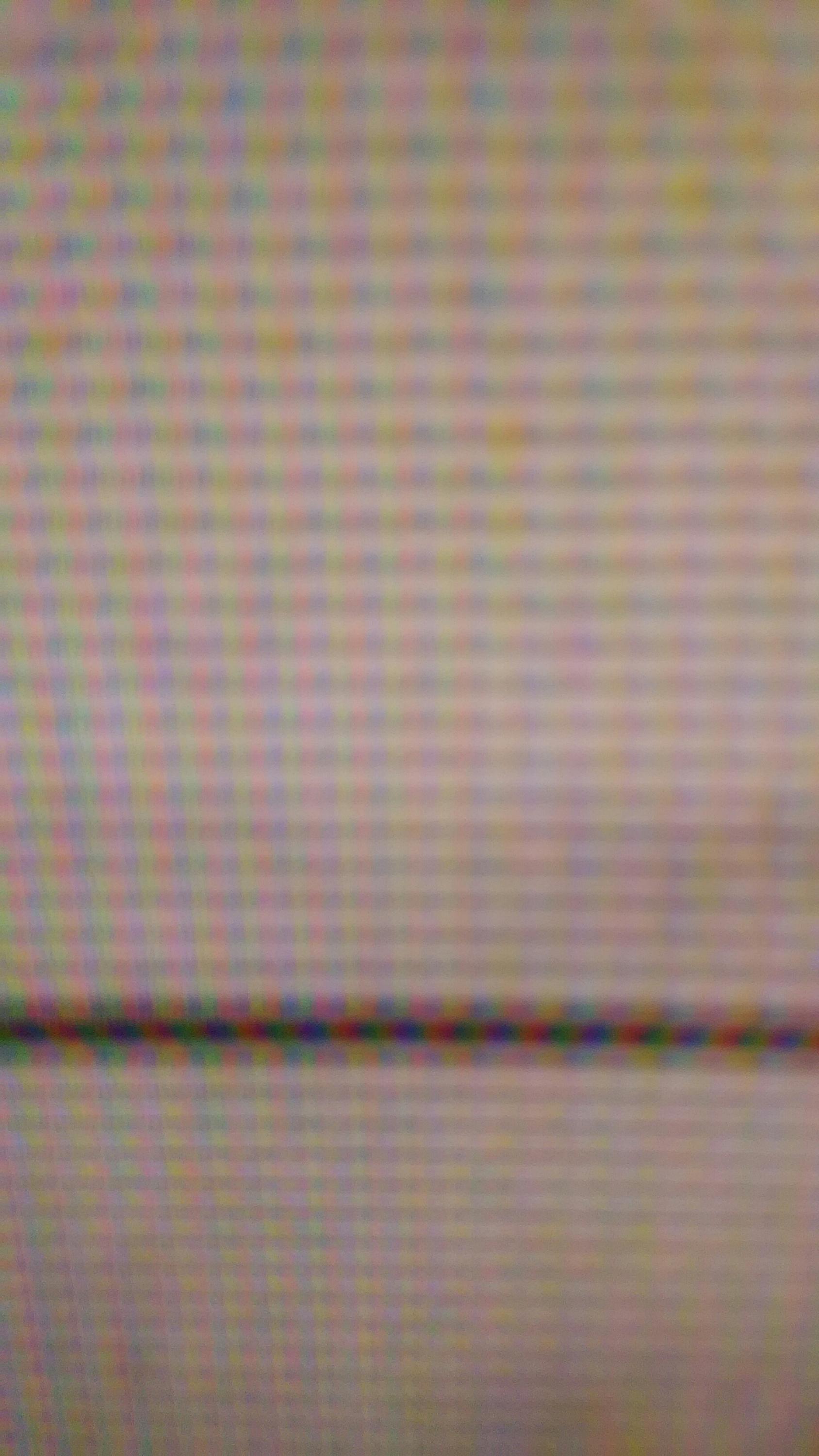

                  Ok thanks I will do that, heres another picture more specific.
                    Looks fatter than the one in post #7. Inspect particularly the little gold fingers for deformation or breaks and gum.

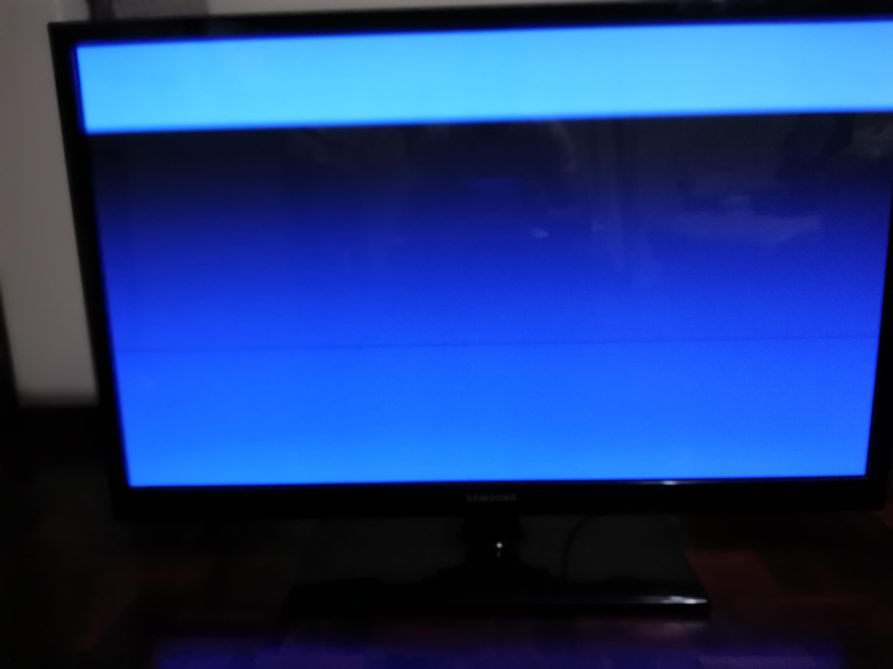

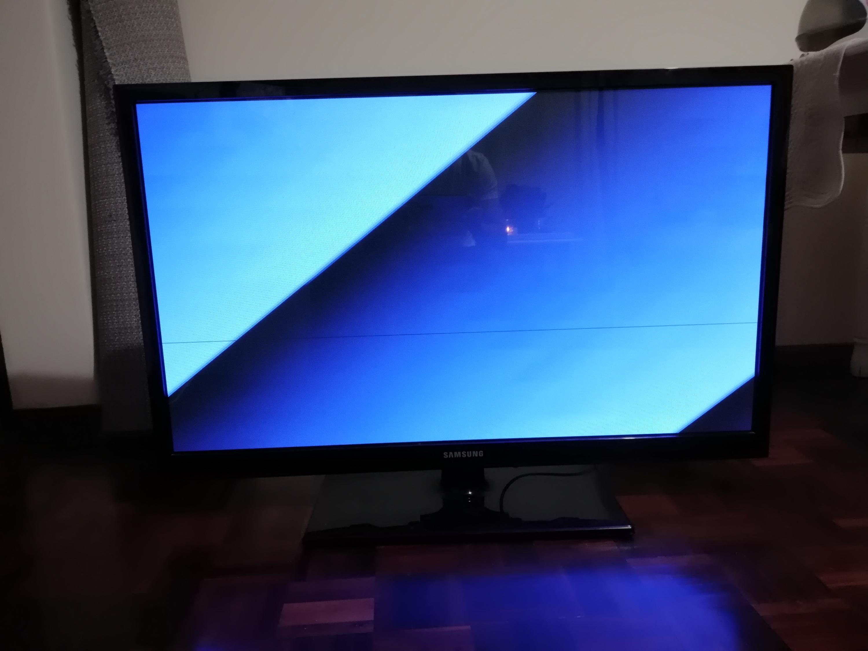

                      After cleaning all cables and buffer boards doesnt solved the problem of the line, I did a test pattern and the line still there as I will show on this pictures:
                        You need as the others have suggested to ensure that the cable end is clean and that the gold contacts at the end have not lifted or been damaged in any way and carefully reseat the ribbon. Sometimes people have to do this operation several times.

                          Thank you, I had researched and got the idea that if the line appeared during the test pattern that the panel would be faulty.
                          Now I will persist in the ribbons again.
                          • gentleman
                            • Apr 2018
                            • 19
                            • Portugal
                            Thank you
                            Finally I did, the horizontal line no longer appears.
                            I clean all the cables and boards with contact cleaner spray and put all the cables accurately and resolved.
