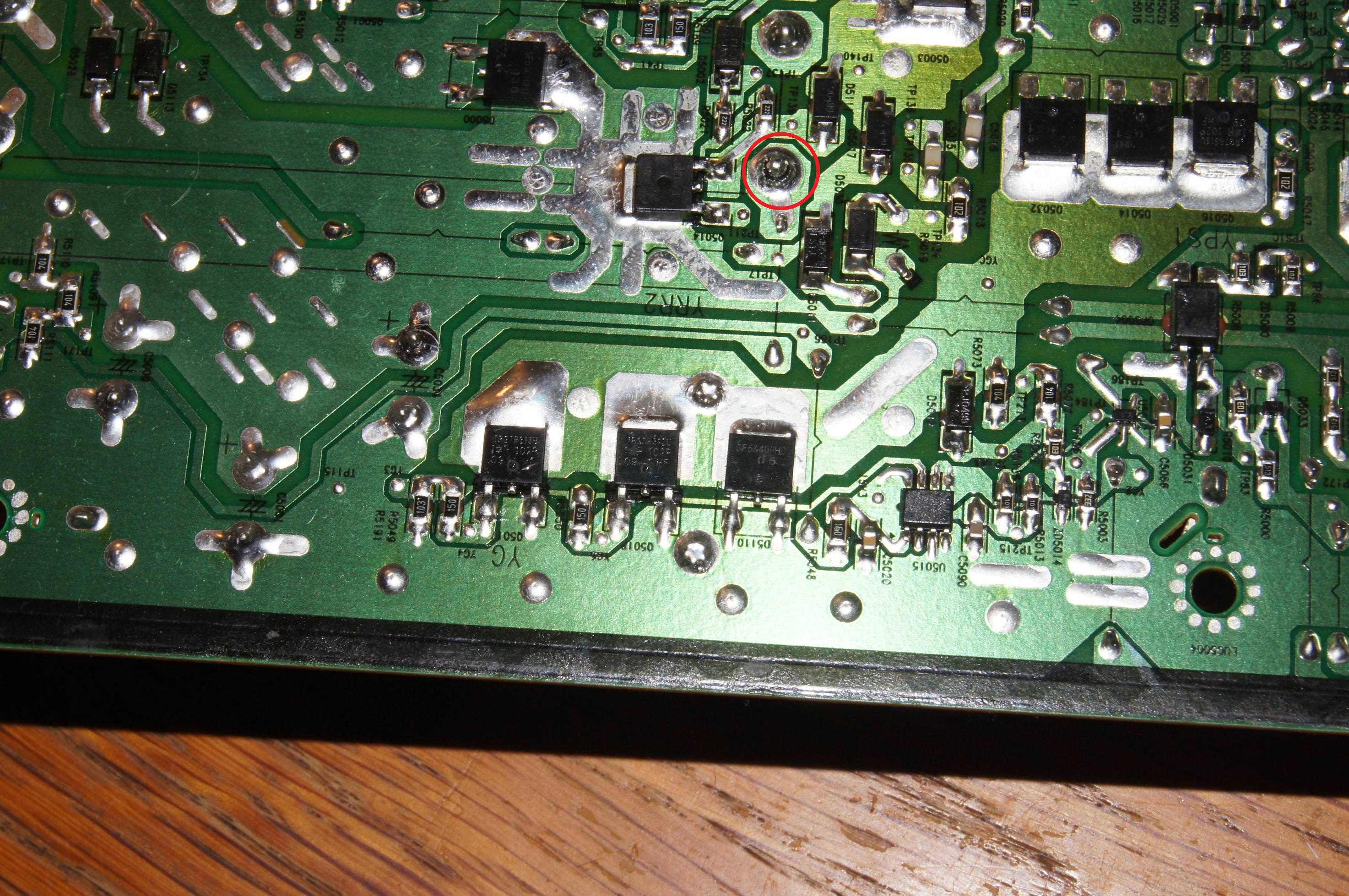

    Hi everyone,
    Fixing this Samsung PS43D450 for a friend, died with a loud bang while he was watching it.
    All the boards seem okay, except for the Y-SUS (model: 42DH YM). Top layer has a shorted through hole RJP63K2 and snubber capacitor (hole blown in side). Bottom layer has some shorted surface mount SF5A400HD and IRG7R313U.
    Is this a known issue with this model? The circuit is quite confusing, the ERC (energy recovery circuit) makes it complicated. Anyone have a schematic? Any tips?

    Re: Samsung PS43D450 / 642AX-YB11 Dead
    Do you have a cracked solder joint or is it just the lighting?
        It looks suspect, but I don't think it's actually cracked, just doesn't have enough solder. Hard to tell from the photo but it's one of the legs from the heatsink.
        Some of the shorted SMD transistors on the bottom side also looked suspect, looked like there were hairline fractures on some of the tabs, but would need microscope to confirm.
        Replace all the screws on the Xsus & Ysus before running up the set.
        Yep will do.

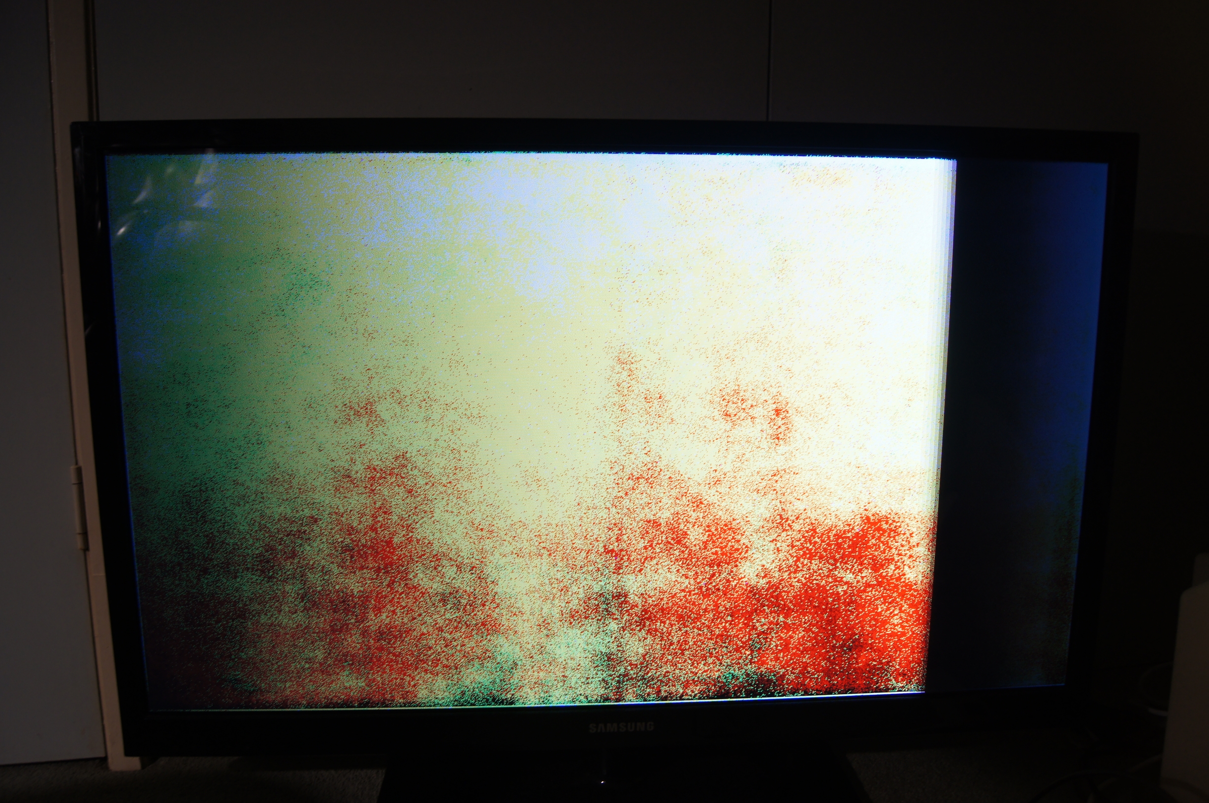

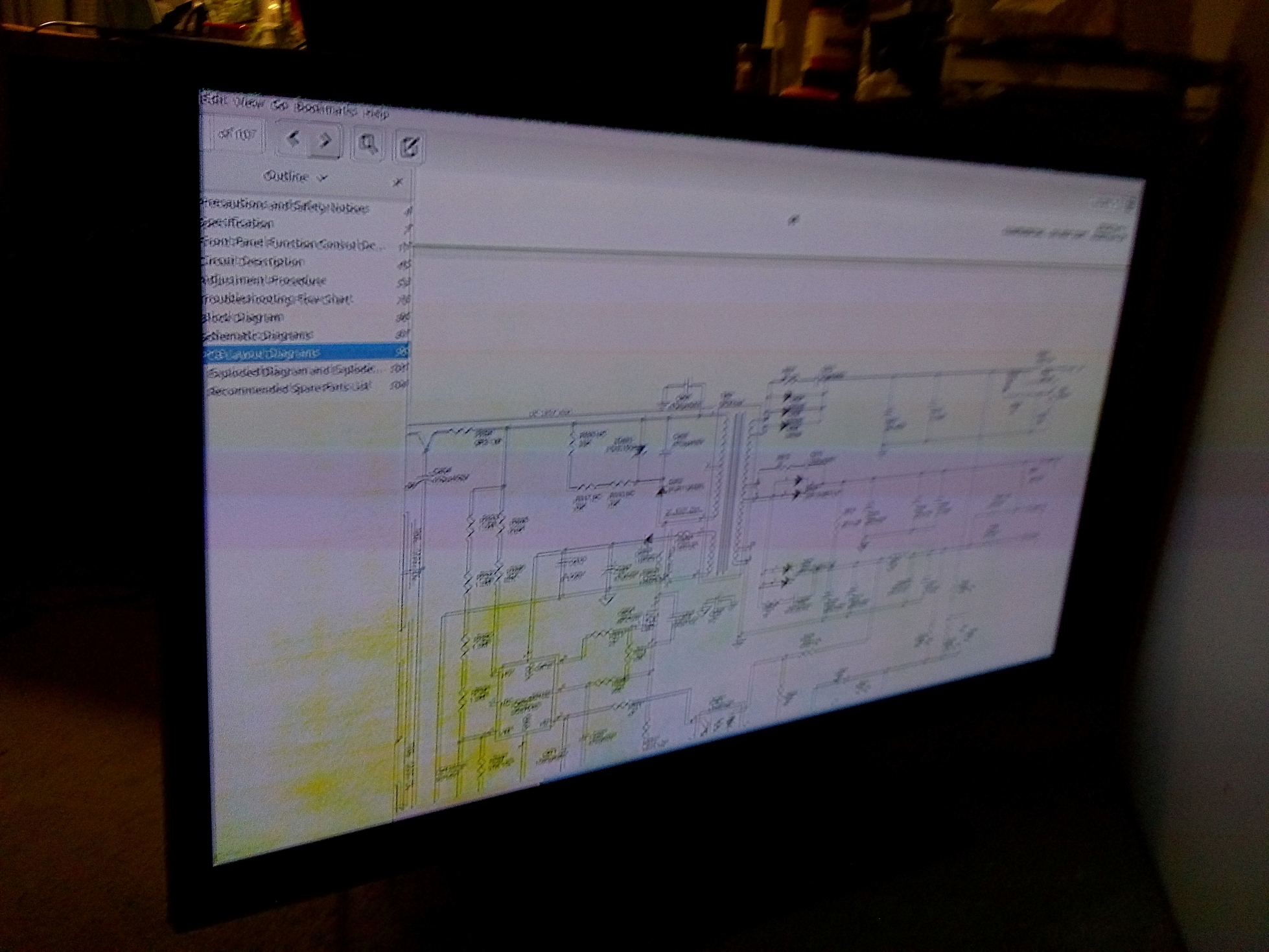

          Hi all, I've just replaced all the components mentioned in my previous post.
          Now it turns on, but there is yellow dots all over the bottom left of the screen, green dots along the top and has some random noise all over the picture. It seems to get worse the longer the TV is on.
          I've checked Va (+58V), Vsc (-185V) and Vs (+207V) which all match the sticker on the panel.
          Any ideas?
          (Please note the purple bar across the screen in one of the pics is just from the camera)

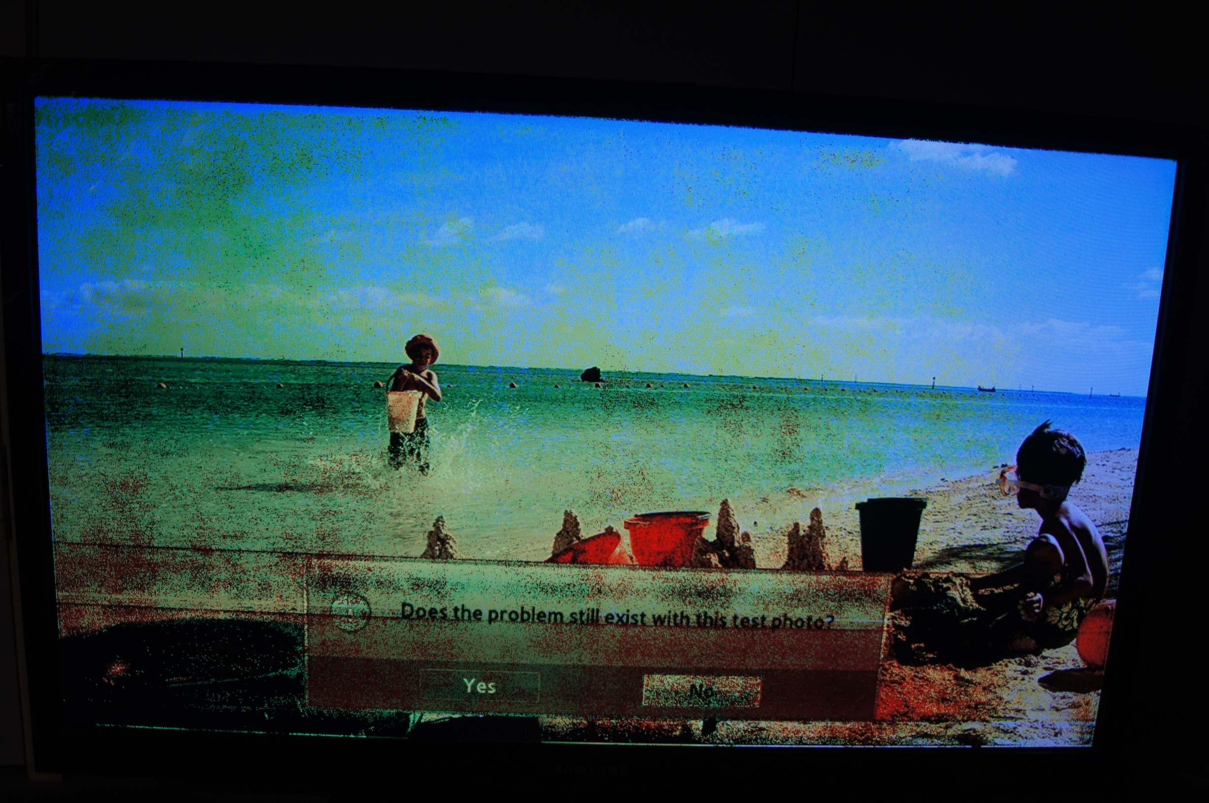

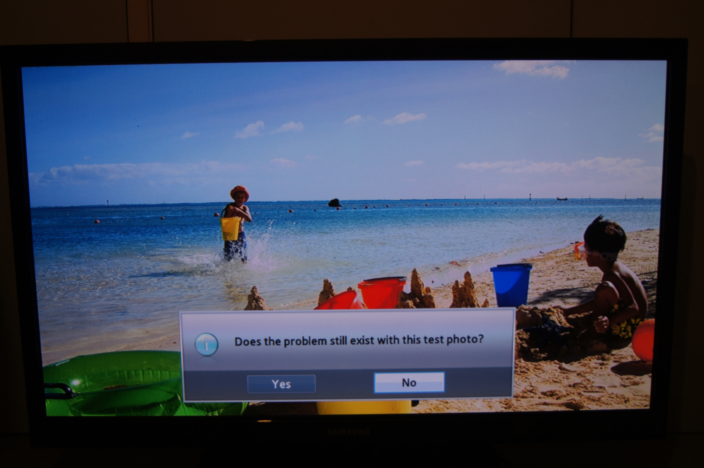

            Another update, I discovered the test picture option in the menu, it ldoesn't looks so good! It seems to have made the image even worse, as it now has red, green and yellow dots since I viewed the test picture! lol
            The second pic is of the scrolling bar (designed to fix burn in) but this didn't seem to help...

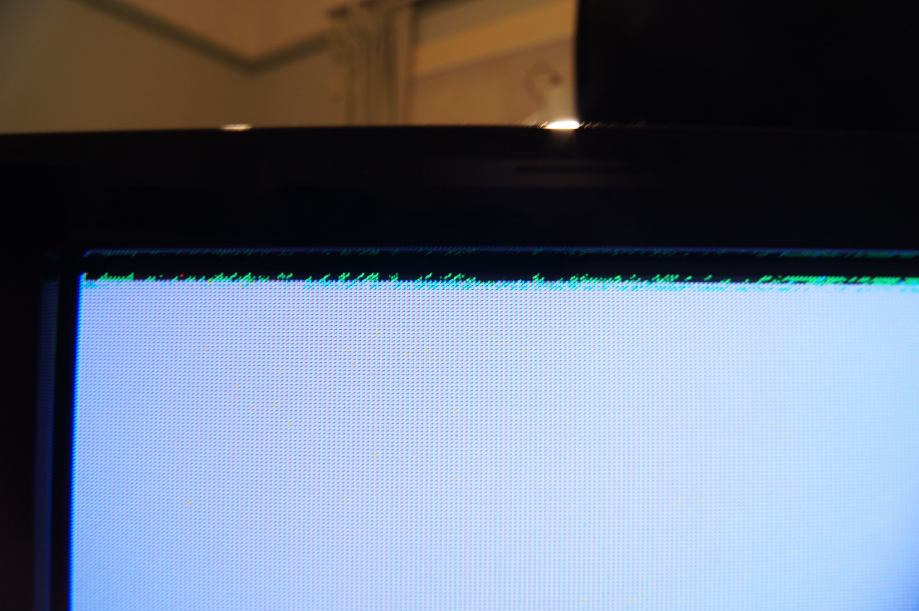

                  Good news! I managed to replace the USB port and upgrade the firmware from 1006 to 1029 and it's helped a lot! Only some strange pixels at the very top left of the test image now. I'm going to leave it on for a few hours to see how it goes...
                  Should I try to turn Vs and Vsc back down? Which one is more important to be lower?

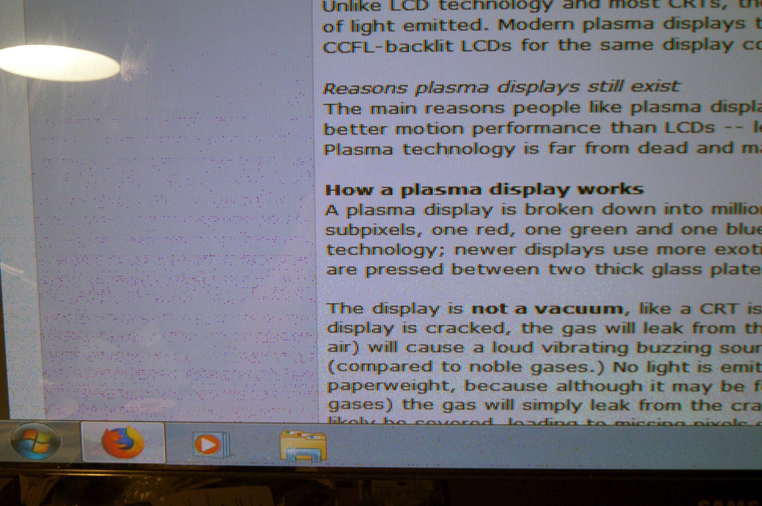

                    It works pretty well now, I left Vs = 215V and Vsc = -200V and I changed the 'Picture Mode' to 'Entertain' which bumps up the contrast and cell light, this helped a bit too.
                    But it's still not 100%, the image is still noisy and has some weird pixels, mostly when there is a border of a light and dark area... it causes some faint lines of strange coloured pixels.
                    Any ideas? Is it safe to turn Vs and Vsc up higher?
                    edit: Managed to get a pic, turns out that the problem is particularly noticeable with the colour scheme of this forum.
