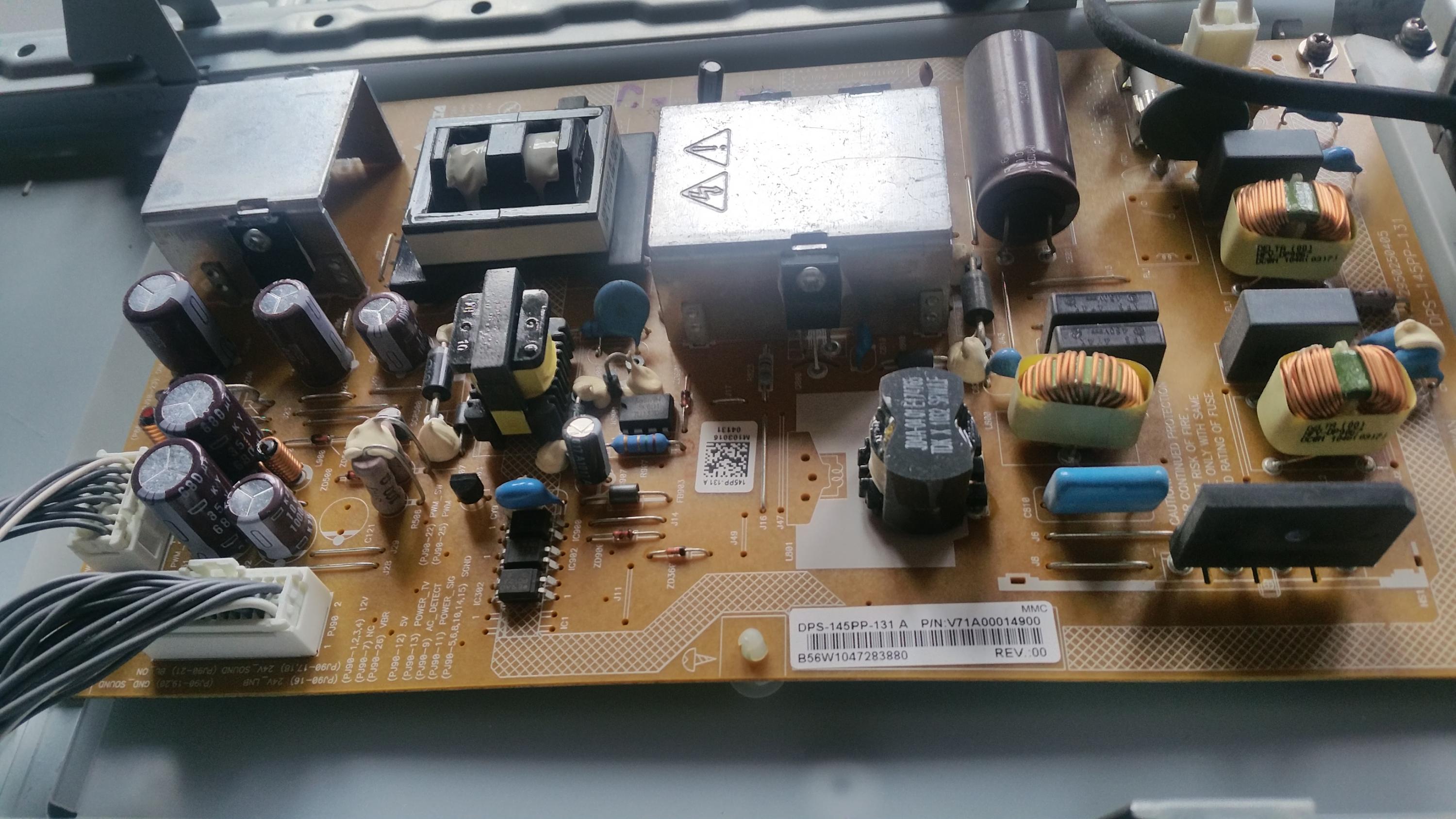

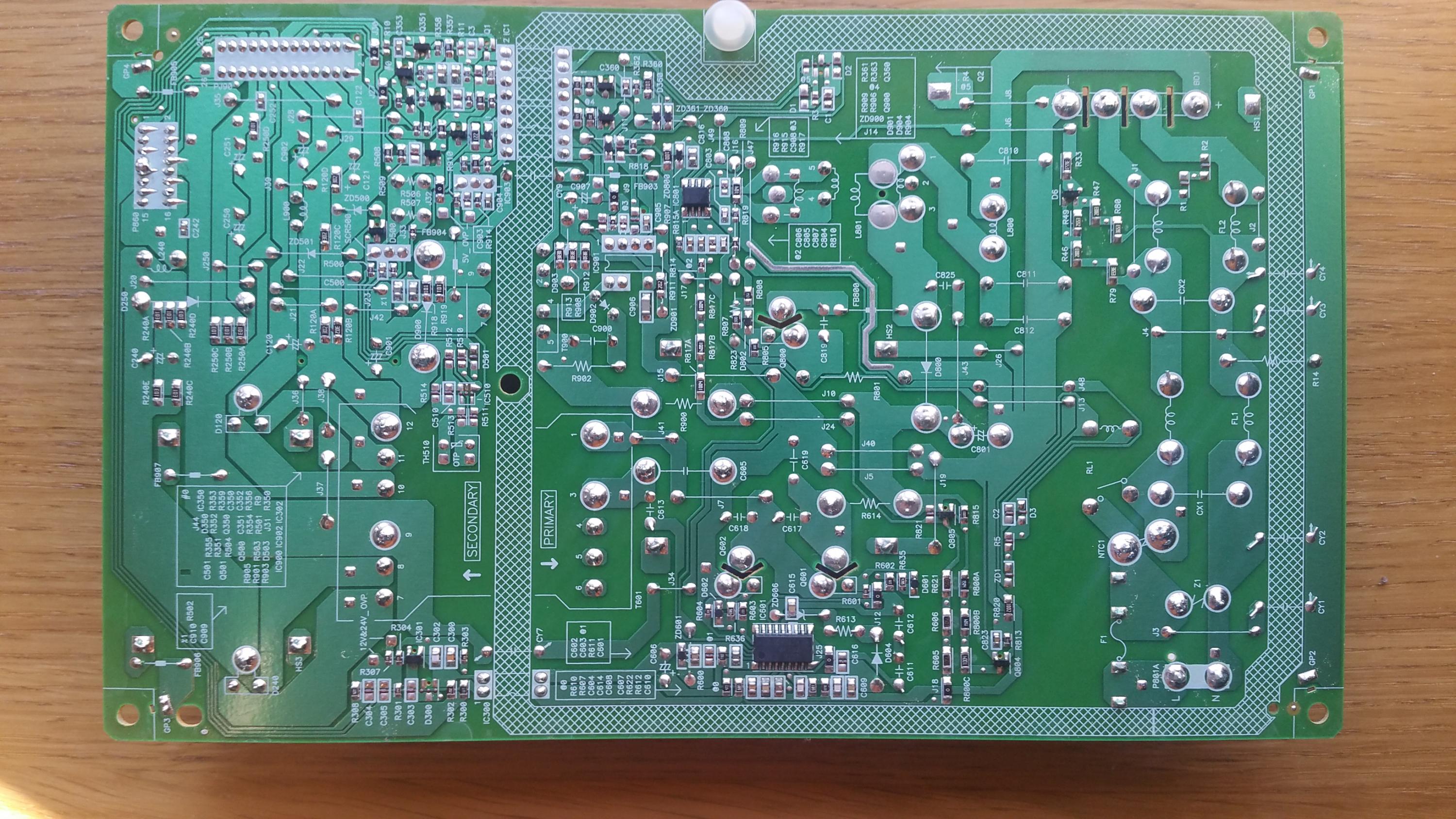

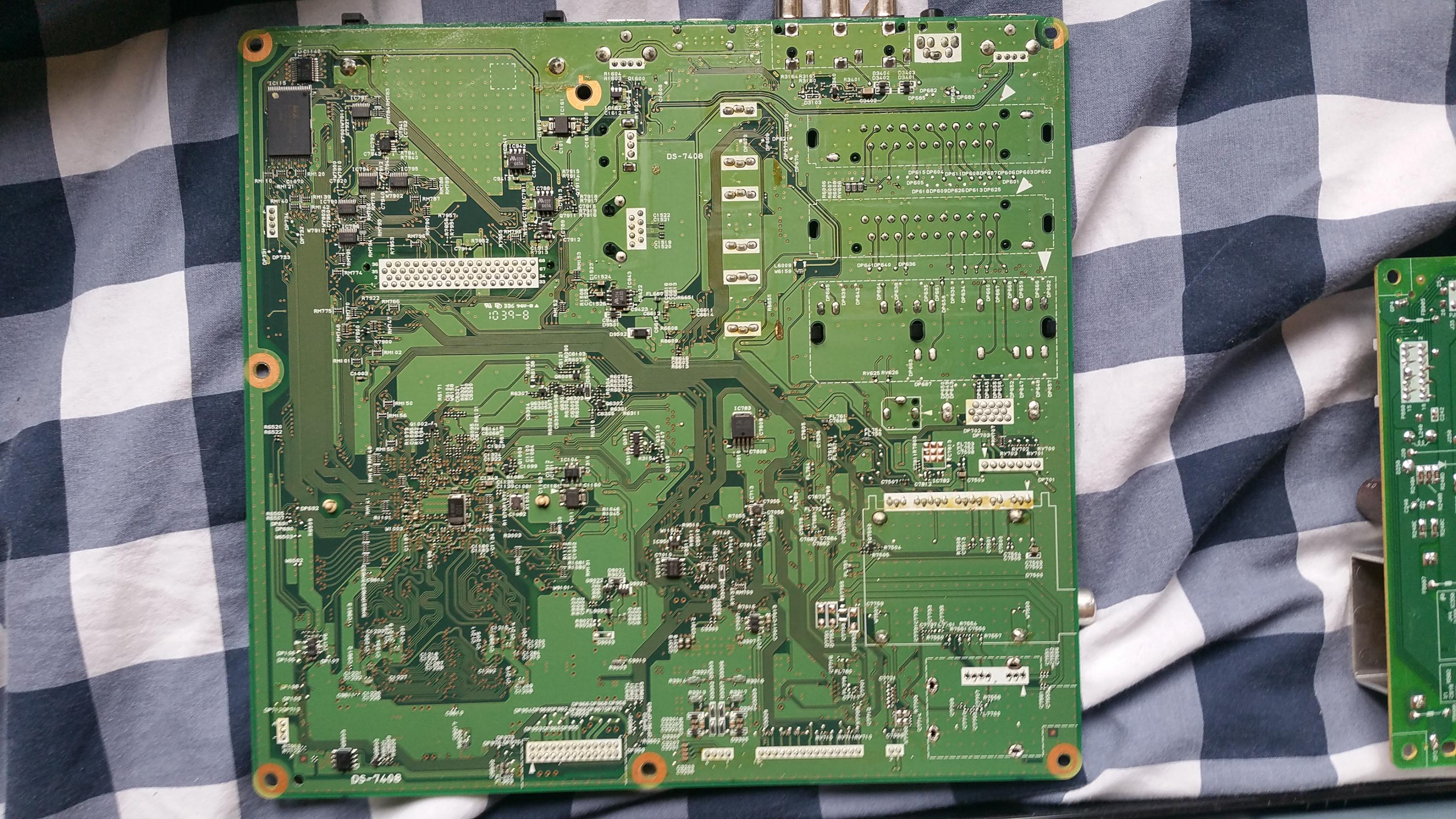

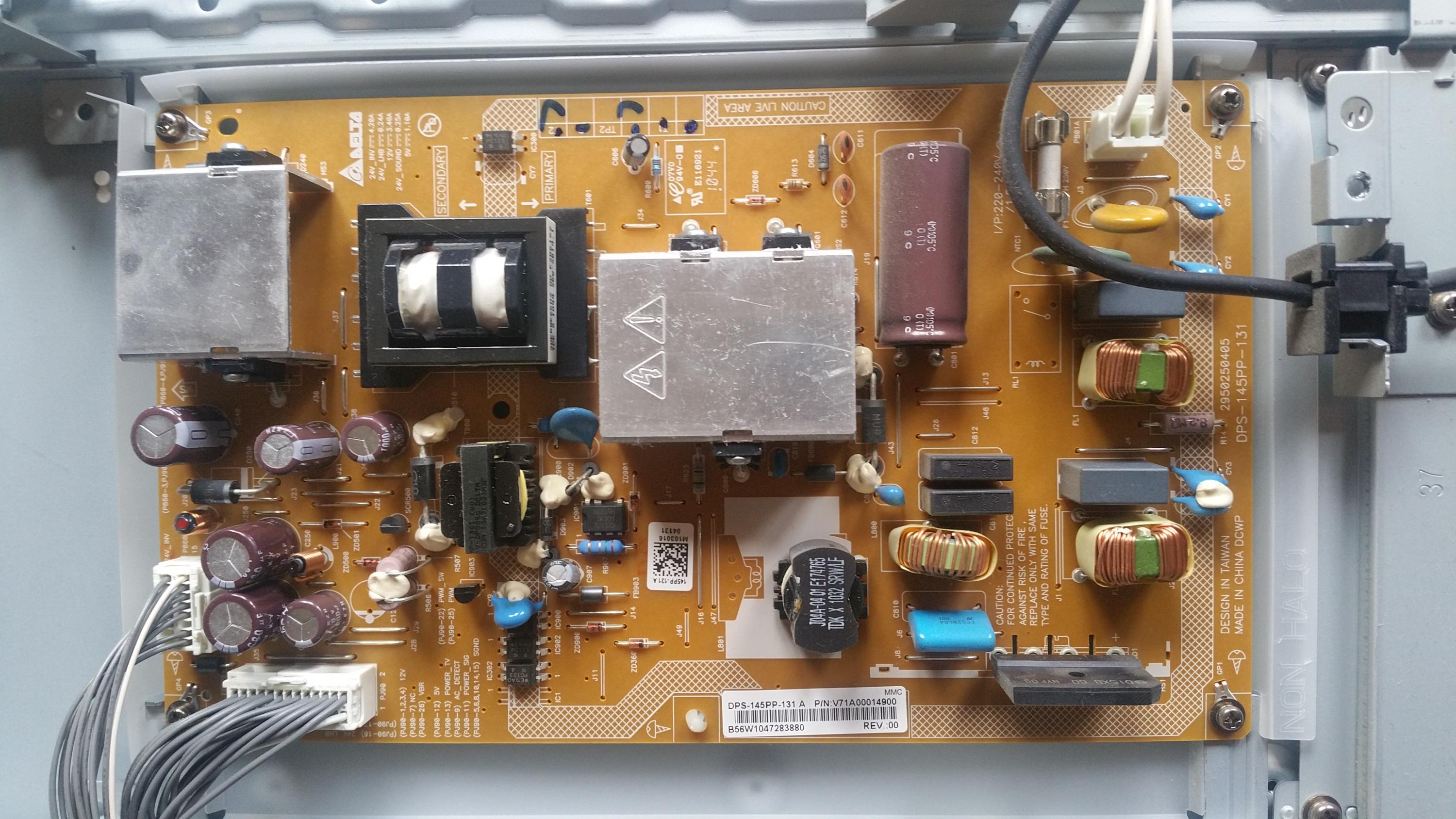

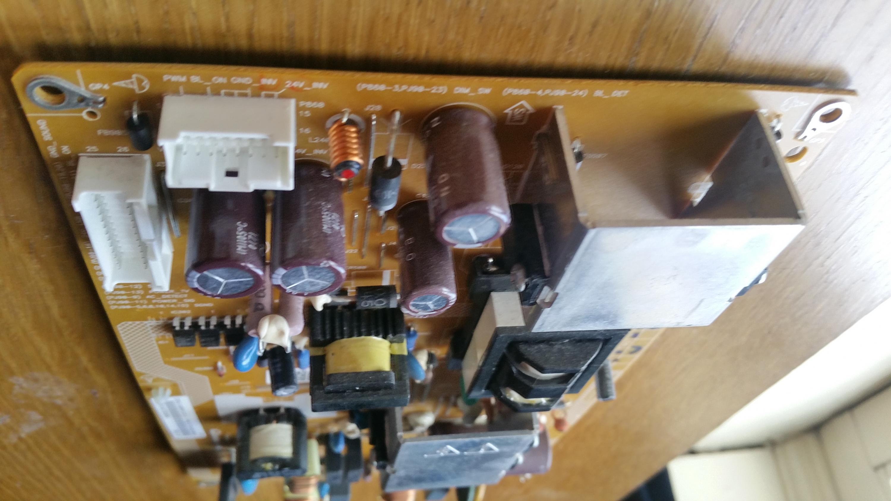

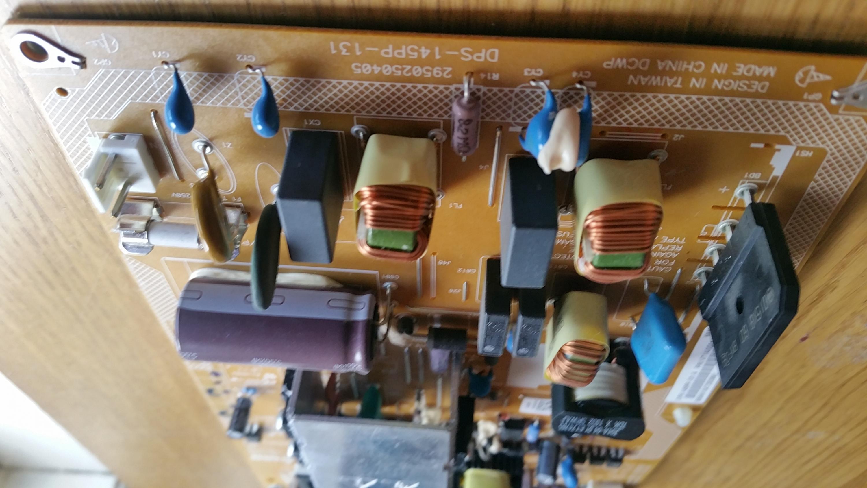

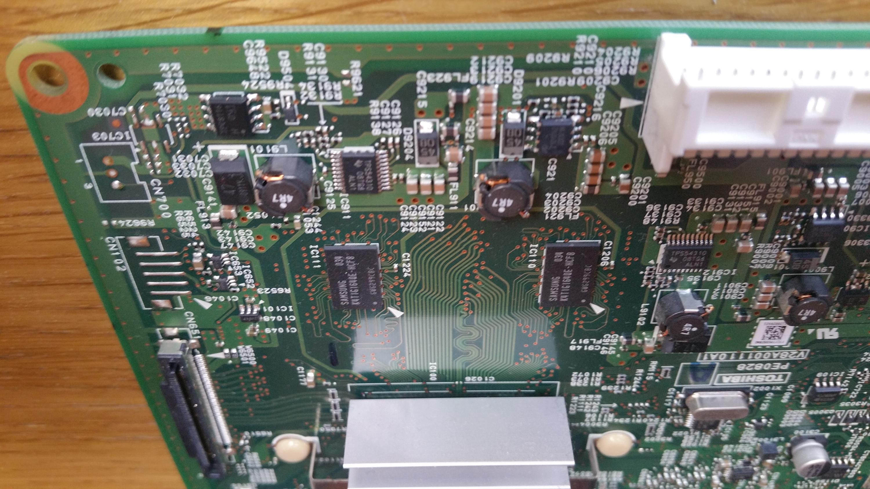

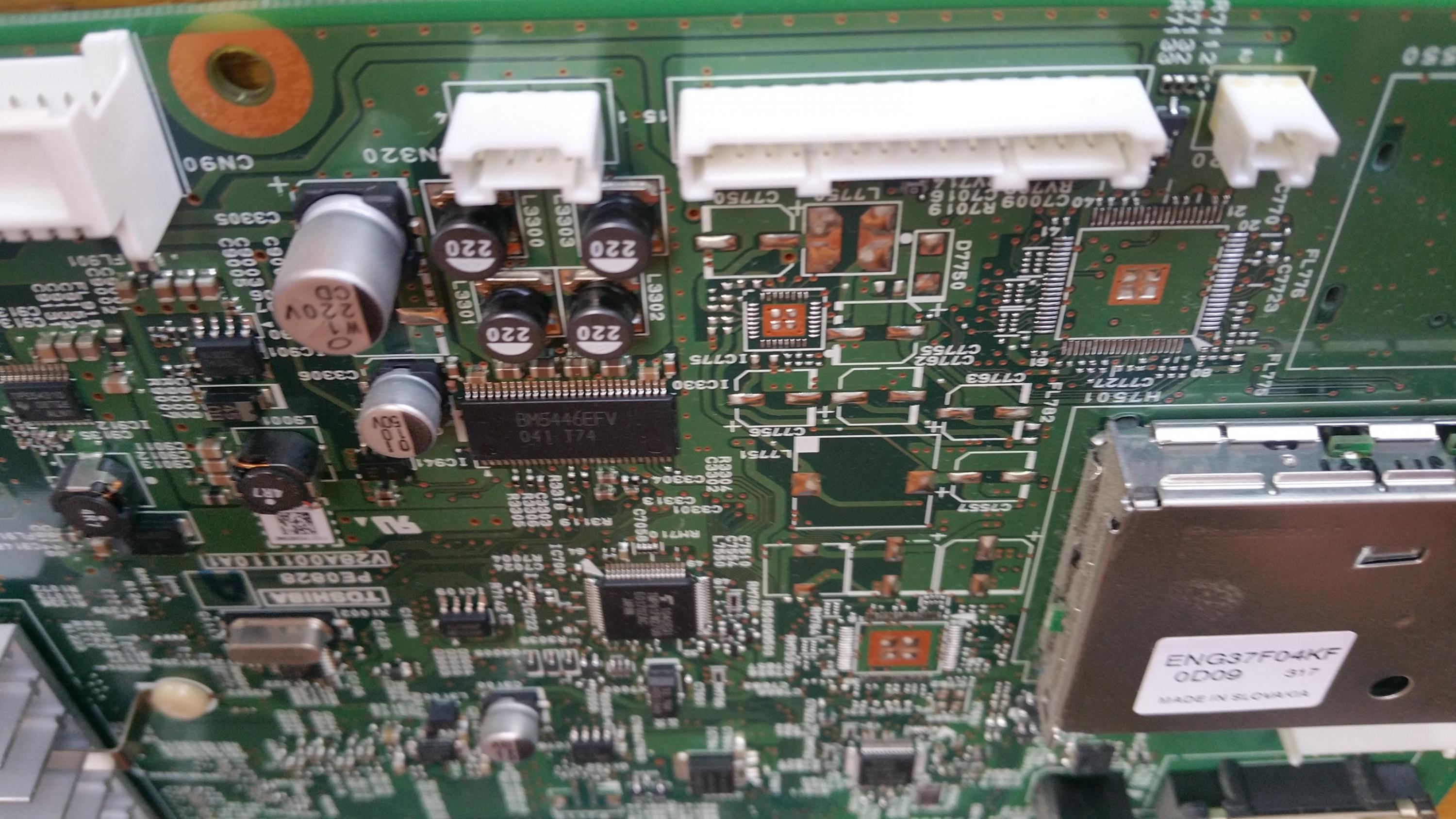

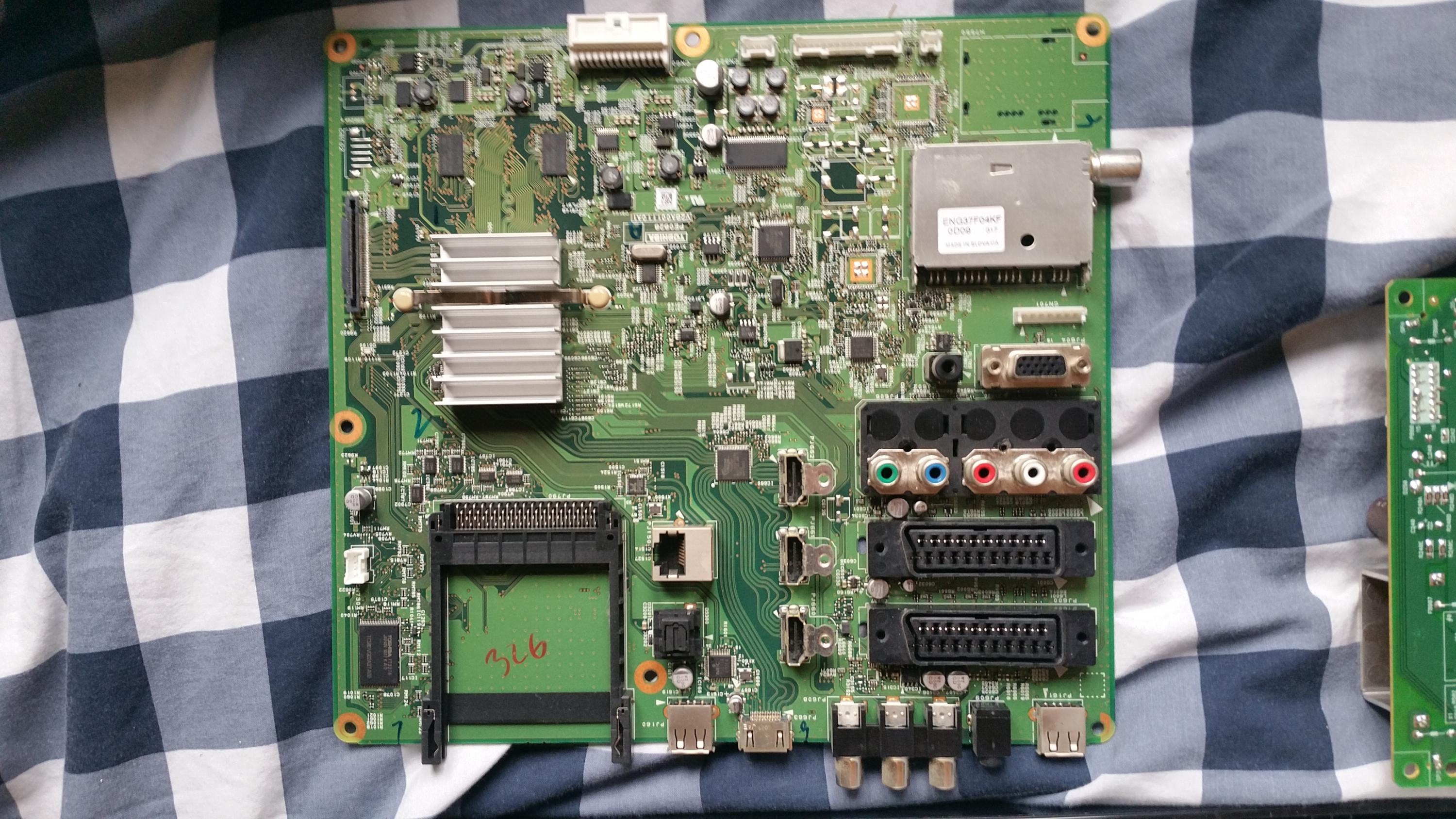

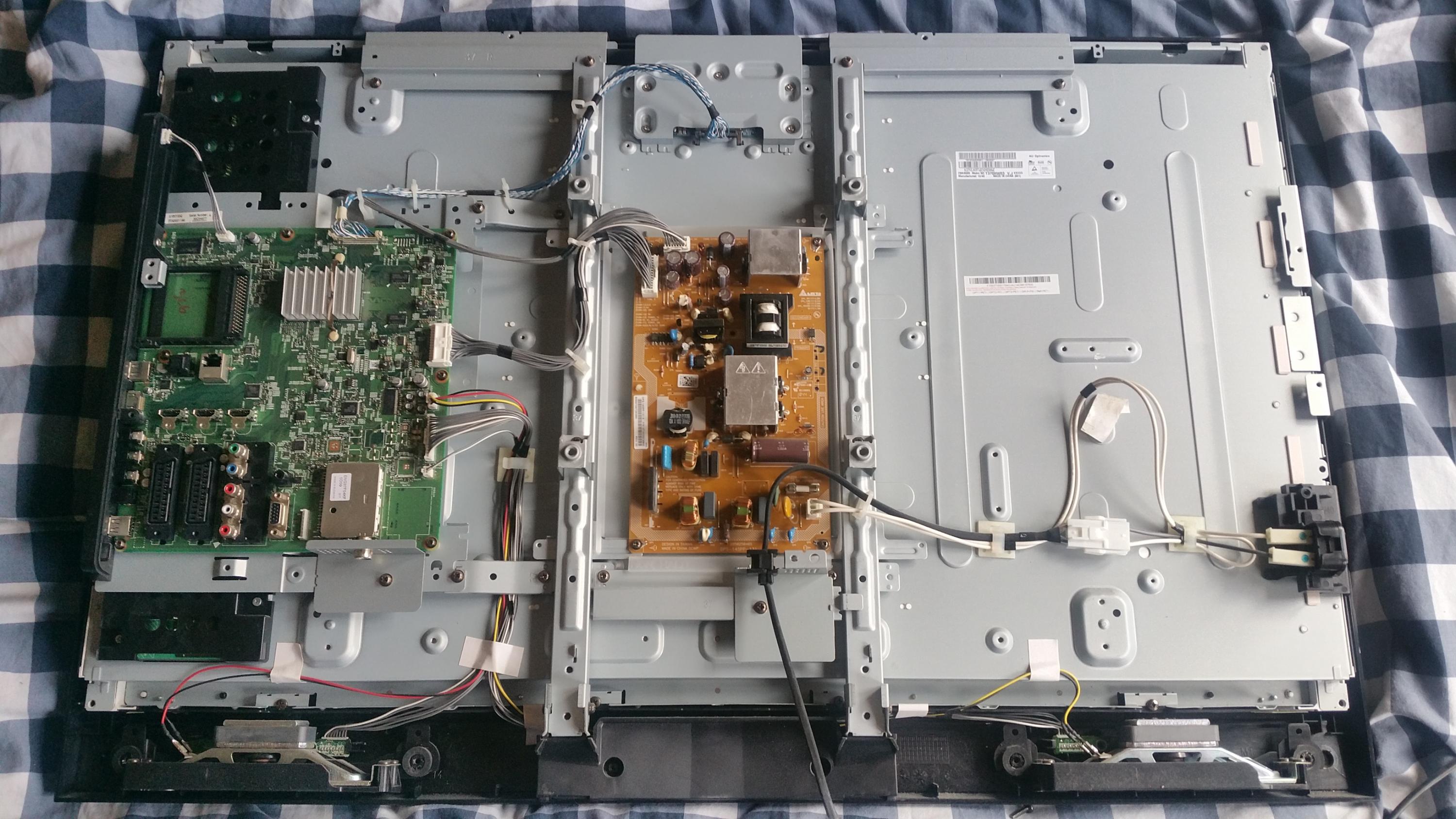

    Hey guys and gals,
    my tv goes on, but just for a second then it turns itself off i guess (screen goes black) and the led light starts to blinking (still green) and the tv doesn't react to anyhting other then the manual power switch on the side. I don't have any experience in fixing a tv, but i hope this problem is something i can repair with the help of you guys. I have looked at the capacitator but they don't seem bulged to me. And looking at the board i couldn't find any brown spots or broken things. If you guys need anything just let me know, i tried to make decent pictures to help locate the problem but i can make more if needed ofcourse. Thanks in advance.
    Greetings Groen

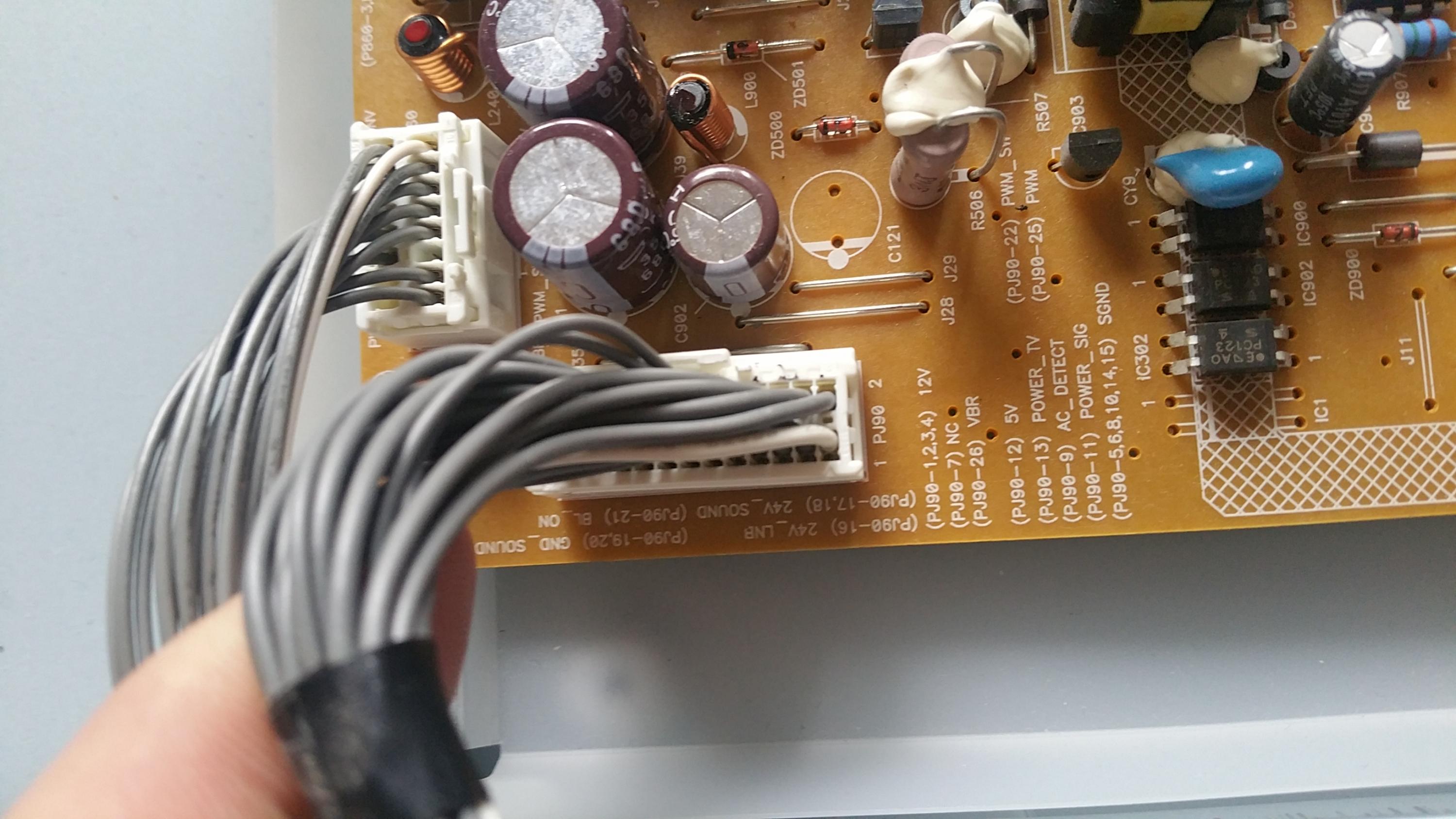

    Re: Toshiba LCD 37RV733 only goes on for a second

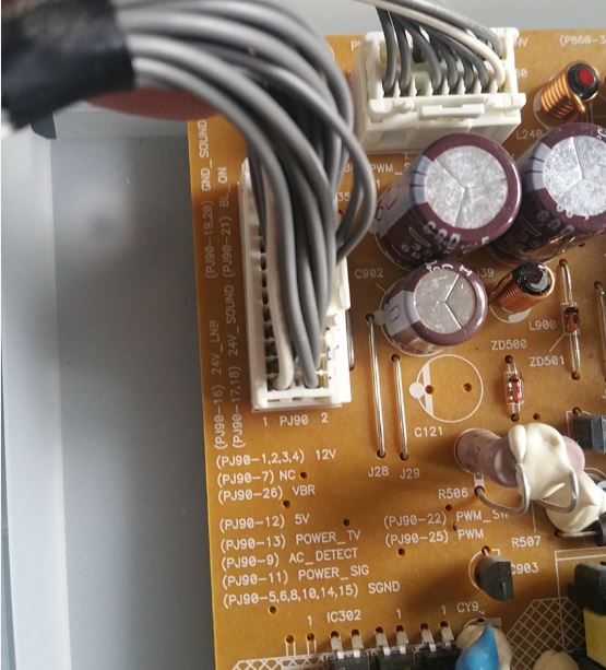

    A good starting point will be to measure the DC voltages of the pins of the two white connectors giving the corresponding pin names that are given alongside.

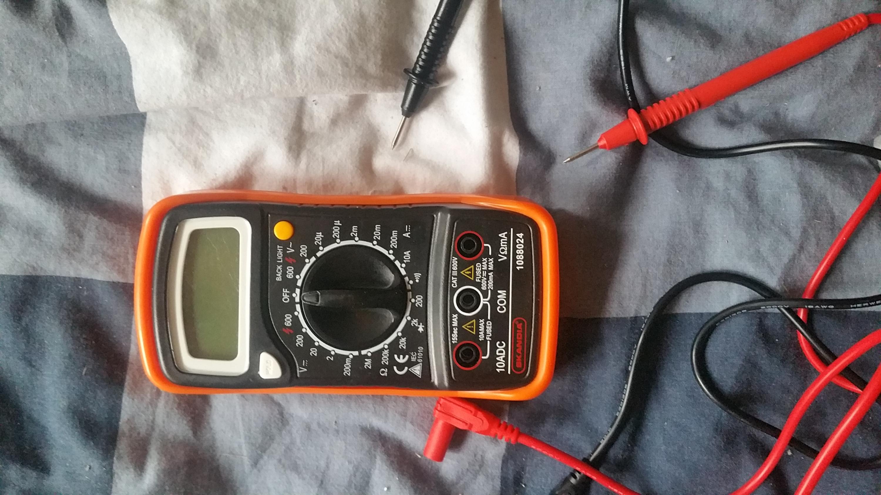

          Ok sorry for the long wait, something else needed my complete attention. Finally i got everything setup, but i don't get a reading, i'm probably doing something wrong. I do have to disconnect the two white connectors because otherwise i can't reach it with the multimeter. I tried the negative (black) on a grounding screw on the chassis and the positive (red) on the disired pin. I've added a photo of the mulimeter i got. Maybe i'm using the wrong settings or something like that. Really sorry about my lack of knowledge.
            Set the meter dial to 20V DC (10 O'clock position) and use the right-hand and middle sockets for your meter leads.
            Black lead on the chassis is fine and use the red lead to measure the voltage at the connectors.
            Switch the TV on. You can use a pin or needle attached to the red meter lead probe using tape to secure it so that you can insert it into the top of the connector where each wire enters so as to get a reading.

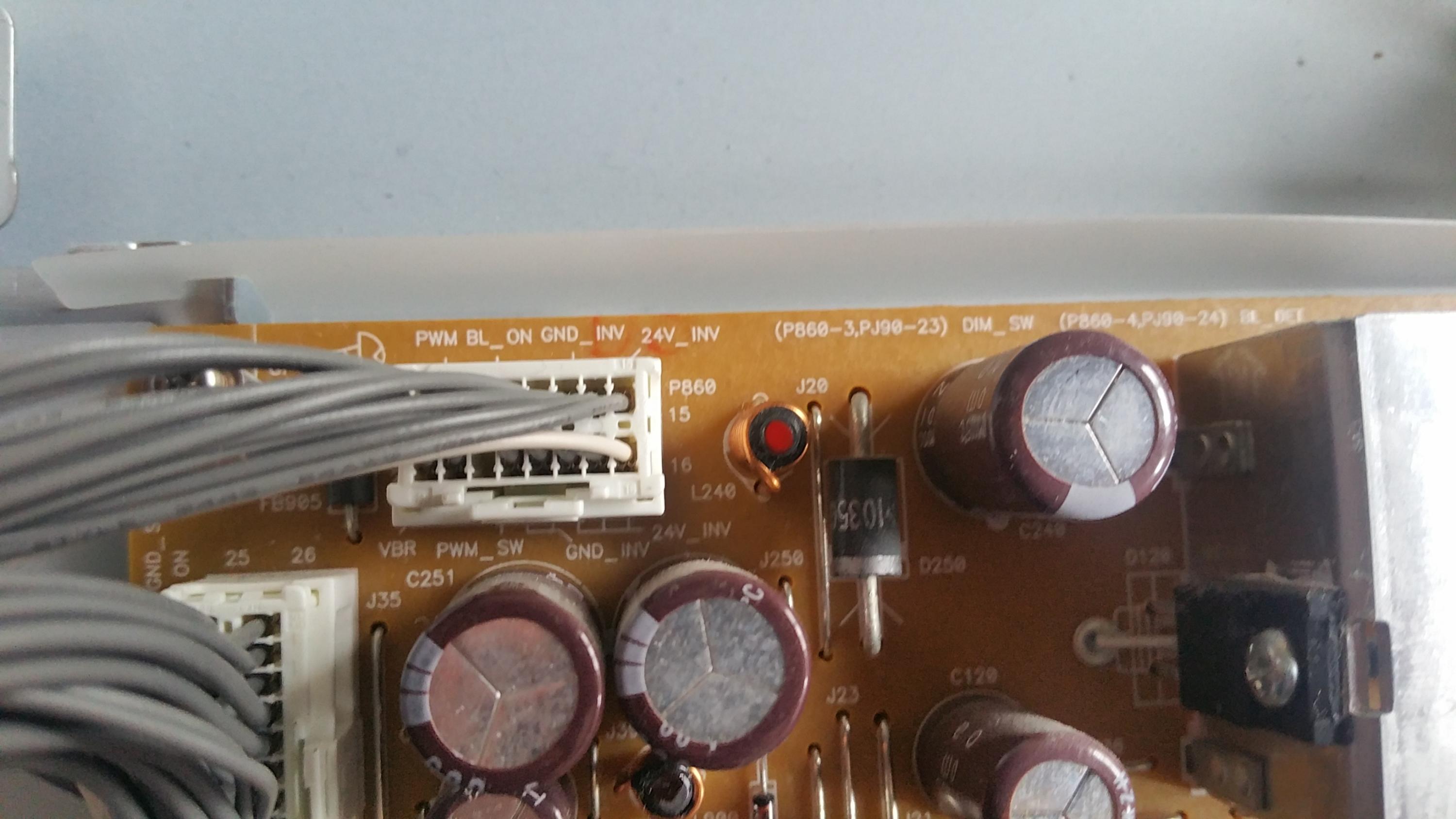

              Ok I meassured the two white wires from the two connectors and they gave 11.87V for the left one and 24V for the top one. Should i do all the wires?

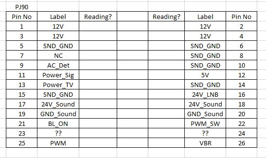

                Meassured the other wires aswell and added two pictures for better clarity of what each should do, hope this helps. The colors in the excel file rerpresents the color of the wires and black means there isn't one.
                  The two connectors have pin numbers at one end and run 1,3,5,7,9 etc along the length of that connector. The other side of the connector marked 2 will be pins 2,4,6,8 etc along that side.
                  If you could give the voltages of the two connectors PJ90 and P860
                  I think the reading given in the excel file are in reverse, ie pin 1 is pin 25, pin 2 is 26 etc.
                    Thanks for all the help so far! as you said the readings were in reverse, now properly done, i hope.
                      Most of the supply voltages are up and running. Even though there's no picture do you have sound?
                      Do the 3 leds on the front of the TV, match any of the flash sequences shown on page 22 of the manual?
                      What is the label name of pin 24 of PJ90?
                      Edit
                      Does the set have a fan and does it run when you power up?
                      Pin 24 is BL_DET (Backlight Detect)
                      I think you may well have an inverter fault.
