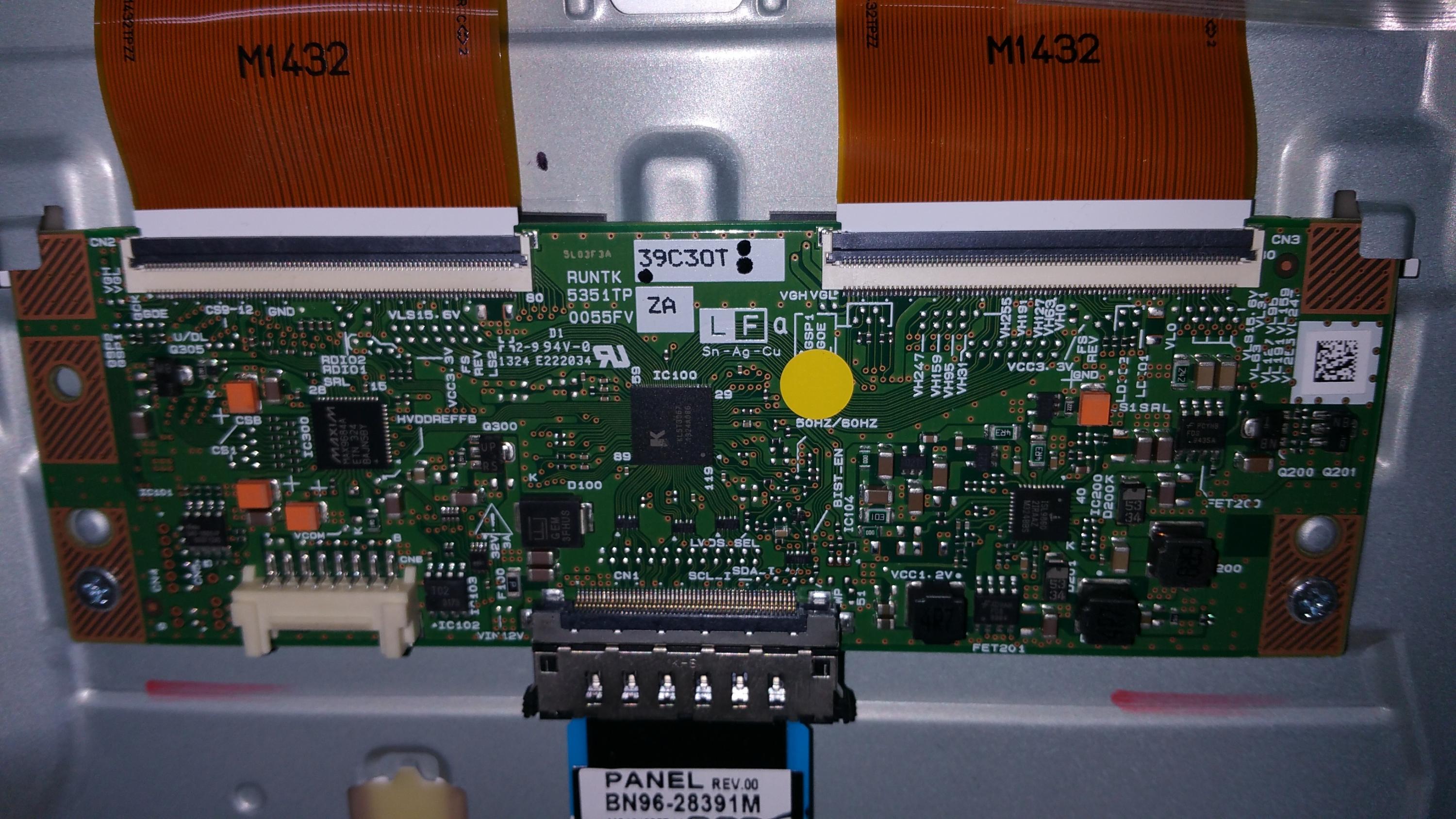

    Hello, I have a samsung LCD TV model UE32F5000AW with the symptoms described, the leds turn on and it has sound. Everything points to a damaged TCON board.
    I checked the TCON F100 fuse and is shorted and has 12v on his output. In the rest of the test points i get 0 volts. From what I read in the forum, the problem must be on the chip ISL98602IRAAZ https://www.badcaps.net/forum/showth...ghlight=5351tp
    I have read somewhere that the RUNTK5246TP board that is used in the 40 " models is equivalent and better thant the 5351TP. Both boards are available on ebay (used) and aliexpress (supposedly new).
    Will these aliexpress board be genuine and of good quality? Maybe someone had experiences with them.
    On the other hand I found boards similar to mine but in the white box appears ZZ instead of ZA. Does anyone know what those letters mean? Could i 've compatibility problems?
    Thank you very much for the help in advance.

    You want to make sure the t-con you get is compatible with your panel number, usually found on the back of the metal frame of tv.
