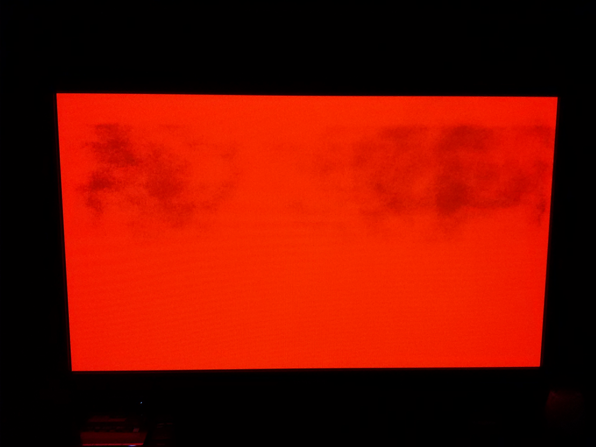

    Re: Samsung plasma PN51D550 "red mist" pixels
    I realize that this is an old post but I have used this thread as a help in repairing my TV (PN51D550 with about 7000hrs) with the same issue. I replaced the X-Main board (The initial issue was "no power on"...)but it turned out to be a worse board than the original so I replaced the shorted components (mainly MosFETs) on the original X-Main board , but was left with the Red Sparkles issue. In the end I also raised the Vs voltage from the specified 203 V to 207 V. So far so good.

                  Red mist Samsung plasma PN42C450 series
                  Thank you for this thread!
                  I raised the Vs from 207 to 209 volts and the red mist disappeared.
                  Coming from ancient of times when purity had to be set on a CRT, I was happy to see the red, blue and green purity were perfect.
                  However, on a white test screen the raster looked like a rainbow!
                  When watching the TV, everything looks great, including white backgrounds.
