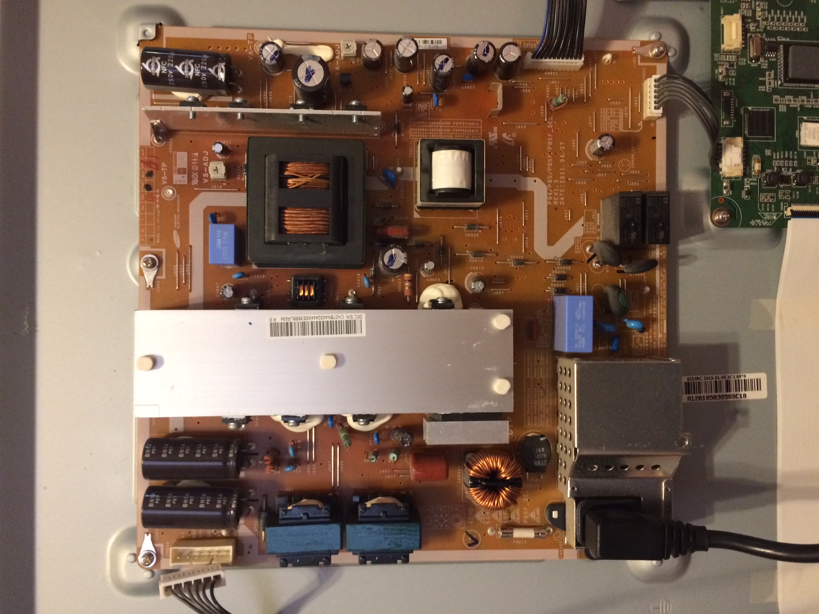

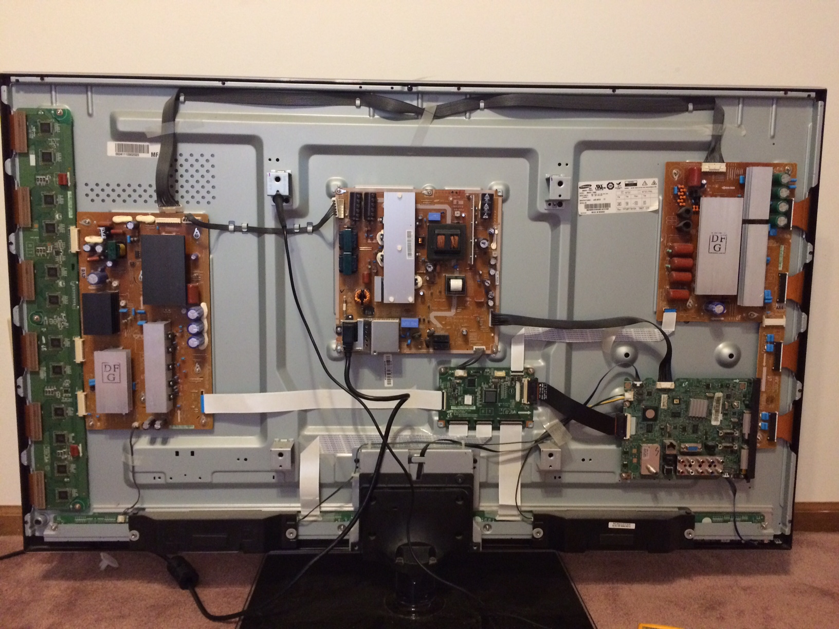

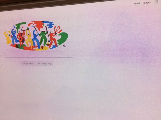

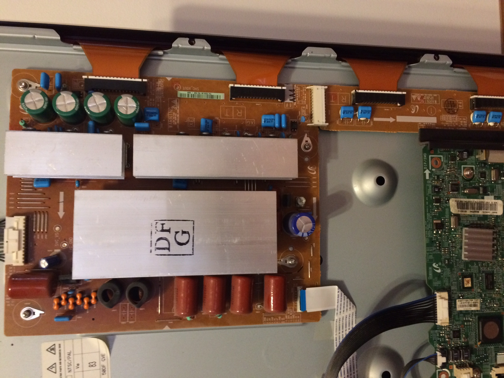

    Alright. I've been trying to chase one thing after the other, combing the forums for some clues, but I'm over my head (which isn't difficult to achieve, sorry to say).
    I acquired a Samsung PN51D550 that did the usual 6 blinks, no turn on. I didn't hear startup audio, as once I fixed it, found the previous owner had disabled the internal speakers. I would get Vs and Va ramp up and drop on turn on, with the slow LED blink.
    I disconnected the Y-sus from SMPS (and associated cables to the X-main as well), and was able to get stable voltages on the SMPS, and a "normal" pulse from the Logic LED. A quick check of the X-main IC's found the usual compliment of shorts (on ALL the transistors), so I found a replacement and ordered it. While waiting, I checked the Y-sus for shorts and didn't see anything too far out of the ordinary, so I kept it. I don't want to throw lots of $$ at the tv, as I'm repairing this for a young friend w/out lots of $$.
    So, new X-main is in, the tv powers on and shows a picture. I was able to set the following:
    Vs- 203 Vdc (spec)
    Va- 58 Vdc (spec, but found later could only maintain after running for a bit)
    Vsc - -193 Vdc (spec)
    Ve - 84.3Vdc (lowest I could get it, spec is 83)

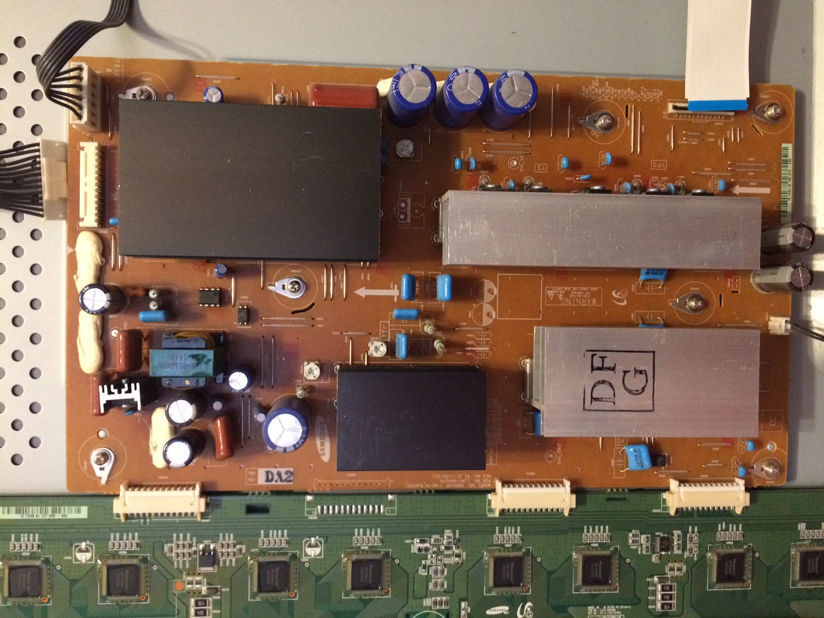

    I noticed Ve was too high, and since the Ve voltage is supplied by the Y-sus, someone asked me to measure that. Y-sus is supplying 105.3Vdc over to the X-main. On top of this, I'm getting red pixilation on mainly white/light screens, and am not sure if it is associated with the increased Ve voltage.
    Other forums said to work with contrast/brightness and other color adjustments, but it didn't seem to make much difference unless I brought the values so low as to make watching difficult. I tried to increase the Vs a bit (to 205Vdc) just to see if it would clear up the spots, but it didn't do much, and I've read enough to know that it's not good for the set to leave it like that for too long. I also read a post mentioning to raise the Vsc to see if it would help, and it didn't.
    My questions are whether anyone knows what would make the Ve run on the high side (and is it a problem)? Would it be a possible cause of the "Red mist" (as I'm calling it) on white screens? And if not, where should I start looking to fix the patches of red pixels?
    I've attached pictures of the back of the set, along with what will hopefully show the red patches I'm trying to describe! Even if someone could point me to a previous post I may have overlooked, I'd be appreciative!

          Re: Samsung plasma PN51D550 "red mist" pixels
          Ve is an unregulated supply, generated off the transformer that makes Vsc. Not much you can do to adjust it. However it will not substantially affect the lifespan of the X-main, because it is only used by the Ve bias part of the circuit, not the main sustain panel current drive (considerably less current than it).
          You can try increasing -Vsc to around -210V to see if that helps resolve the issue.
          If there are Yfr or Yrr pots on the board then you may be able to adjust those as well.

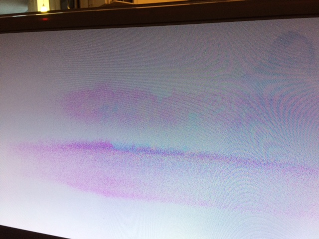

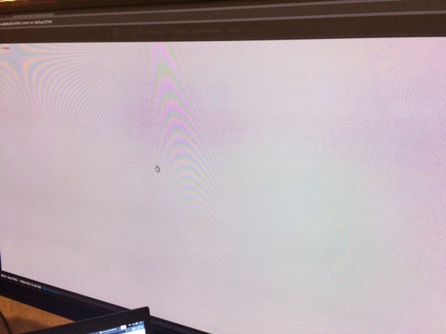

            I turned up the Vsc as high as it would go and max'd out at 206.6v. I've attached pictures from a SVC menu test pattern scrolling across the screen. I still get the haze, but it moves with the white (or whatever that range is on the screen, so it seems to be a firing issue and not a screen issue?) I also notice some green dots on the black scene, like the good 'ol green/red sparkle days!
            Speaking of which, I do have an adjustment for Yfr, but thought I needed an oscilloscope to adjust this (unless I do the "turn a bit and hope for the best" adjustment, lol!)?
            On a related note, while in the SVC menu, noticed the tv does have 14.5k hours on it, so I'm guessing it's a wee bit tired...
            EDIT: 1st and 3rd pics are the scrolling red mist lines, second pic was me trying to capture the static green dots on the black portion
            EDIT: Could the "new" x-main be the issue (and if it's a possibility, what would I test?)?
              Follow Up: Went through ALL the factory service test patterns, and the "red misting" doesn't show on anything but a white screen that stretched fully horizontal. It didn't how at all with the slow vertical white band sweep from left to right or any of the other colors.
              I also did find the Yrr, so I'm going to find the thread on how to best adjust them without a scope and report back later!

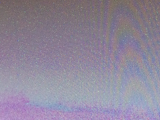

                                        So I decided to simply go ahead and try tweaking the yrr and yfr by getting a factory test pattern up that showed some red misting on the white and green pixelization on the black.
                                        Going by Tom66's recommendation, started with yrr and made small increments either way (after marking the pot first). I noticed no discernible change in picture quality, but found the pot to already be in the full clockwise position. I'm not sure if that's low or high voltage without looking at a scope, but it's something I noticed.
                                        I then tried to adjust the yfr, and again didn't see any great change as I slowly moved the adjustment.
                                        Out of curiostiy, since I ONLY noticed the red mist/green dots on two of the 25 test patterns (only the black to white gradient screens), I decided to again test a normal signal through the tv. First test was a stand up comedian on stage... lots of black in the background. No green dots. Next I ran a show with lots of brightness and whites, and again, no "red mist" is showing on the screen! I'm still running the Vs about 5v higher thn specified, but everything else is on spec (aside from the still-too-high Ve on the x-main)
                                        I'm not sure why I'm now only seeing the issue on a couple of test patterns, but I'm thrilled that its working!
                                        If anyone has any thoughts as to why this might be the case, I'd love to hear them!!
