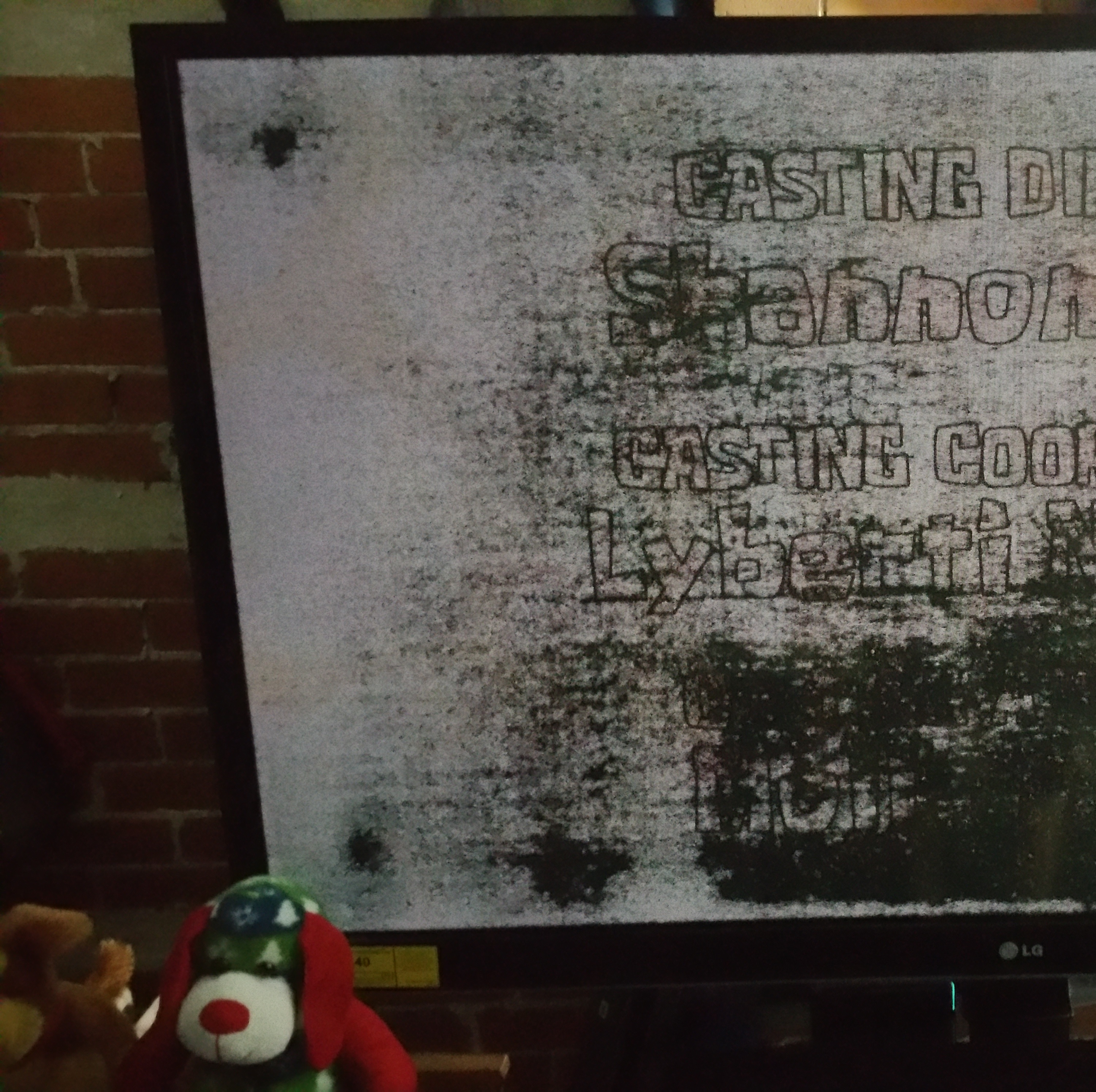

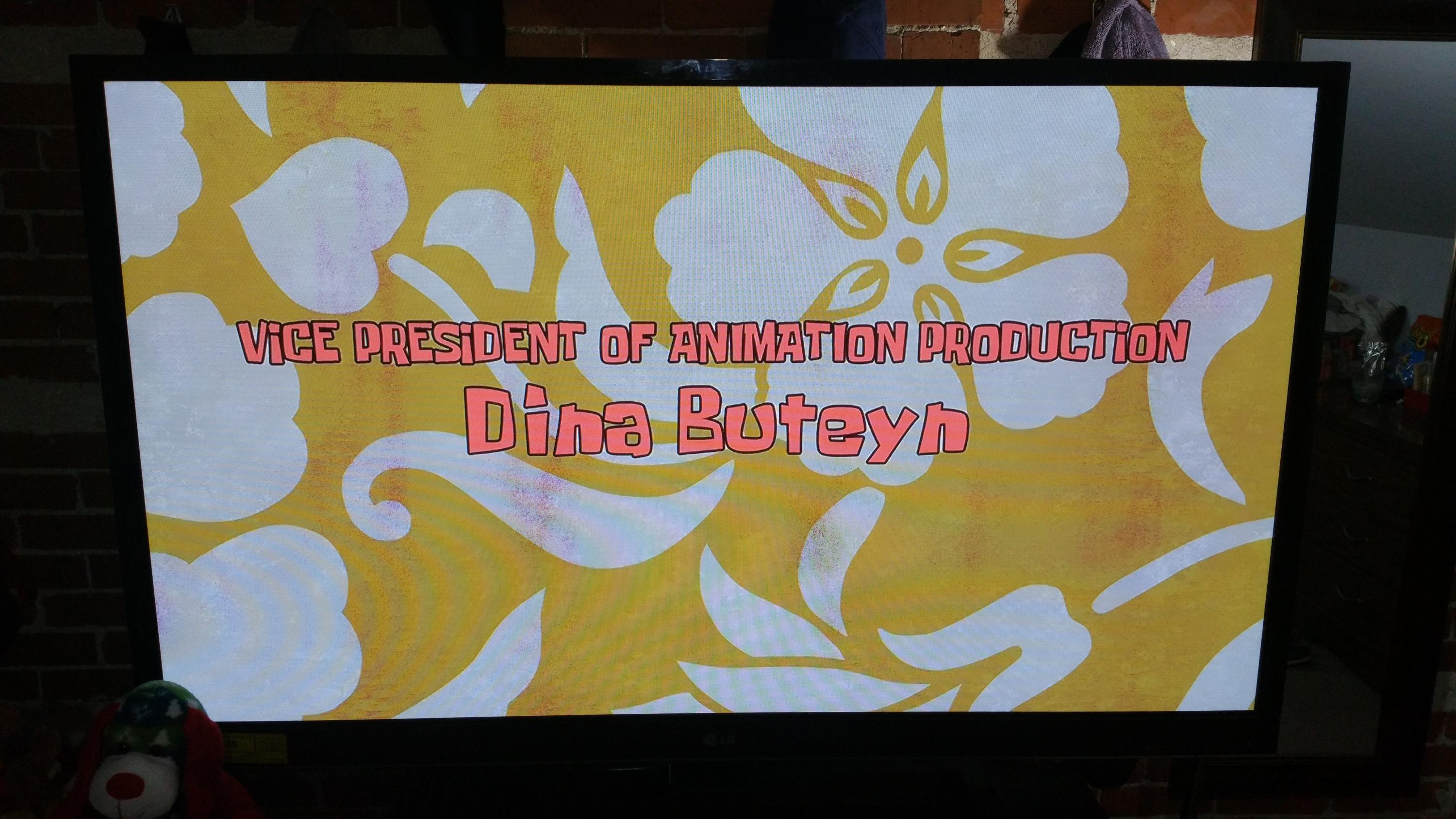

    I have read much of information about plasma T.V.s over the past few weeks. I have also searched endlessly for a service manual for this model LG T.V., to no avail. I have found some things that are useful but I can't seem to stop this issue from happening. I have checked all my Voltages pre and post Mal and they match the sticker.
    I have included pictures of the symptoms. The one that is in color is the precursor to the black one. 2-5 seconds before my screen loses all color I get that ghosting / color splash. Then I lose all color and get that gray-scale image. Before the set warms up the picture is beautiful and everything functions great.

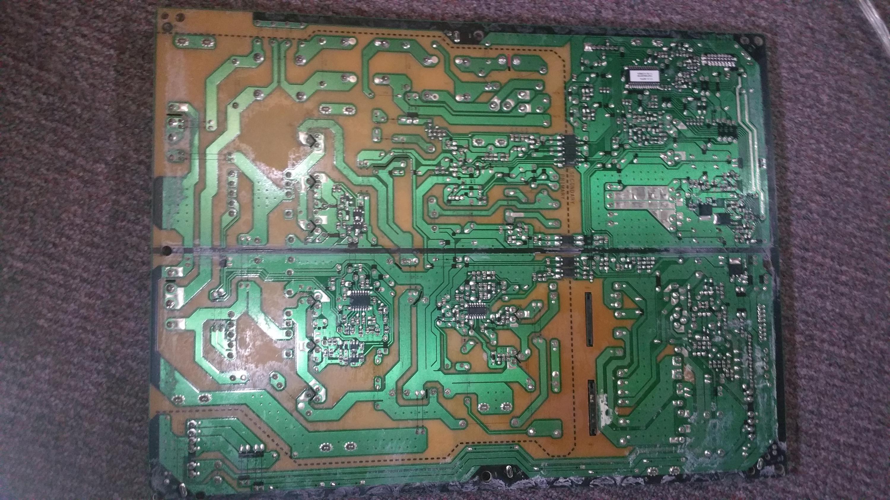

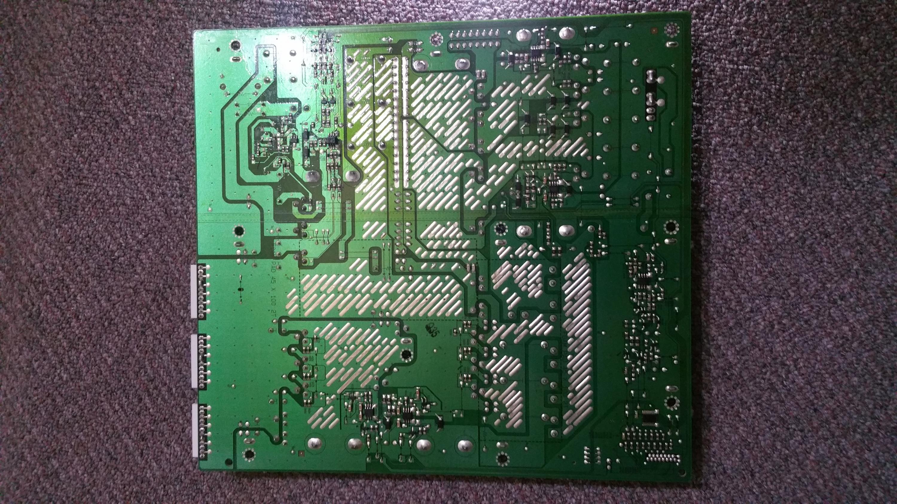

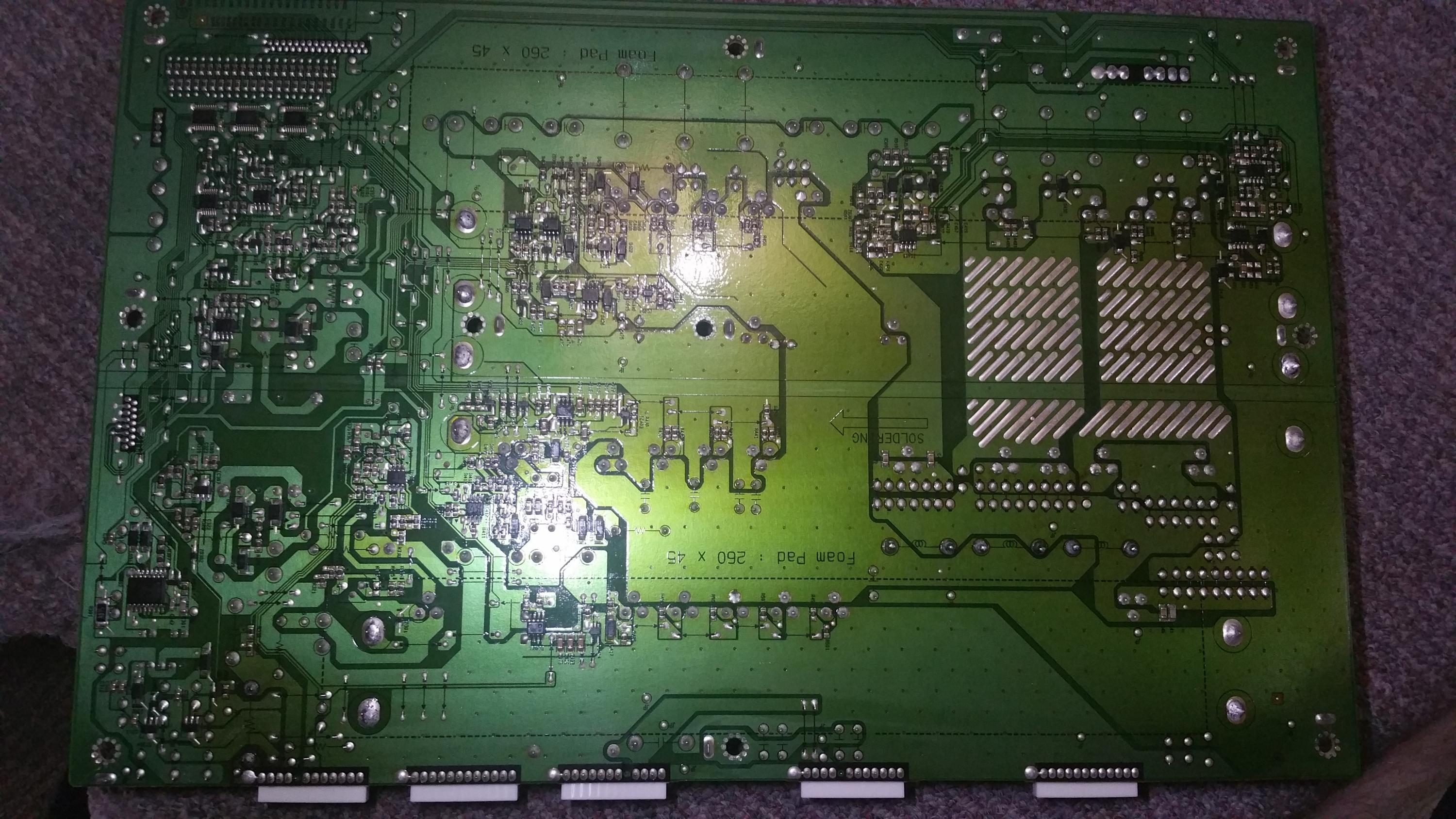

    I have taken out the Z and Y sus boards and re-flowed the joints even though they looked fine, I have also done the same to the power board. Besides some slight discoloring and lots of dust, the boards all looked fine.I have included images of the reverse of the Zsus, Ysus, and power.

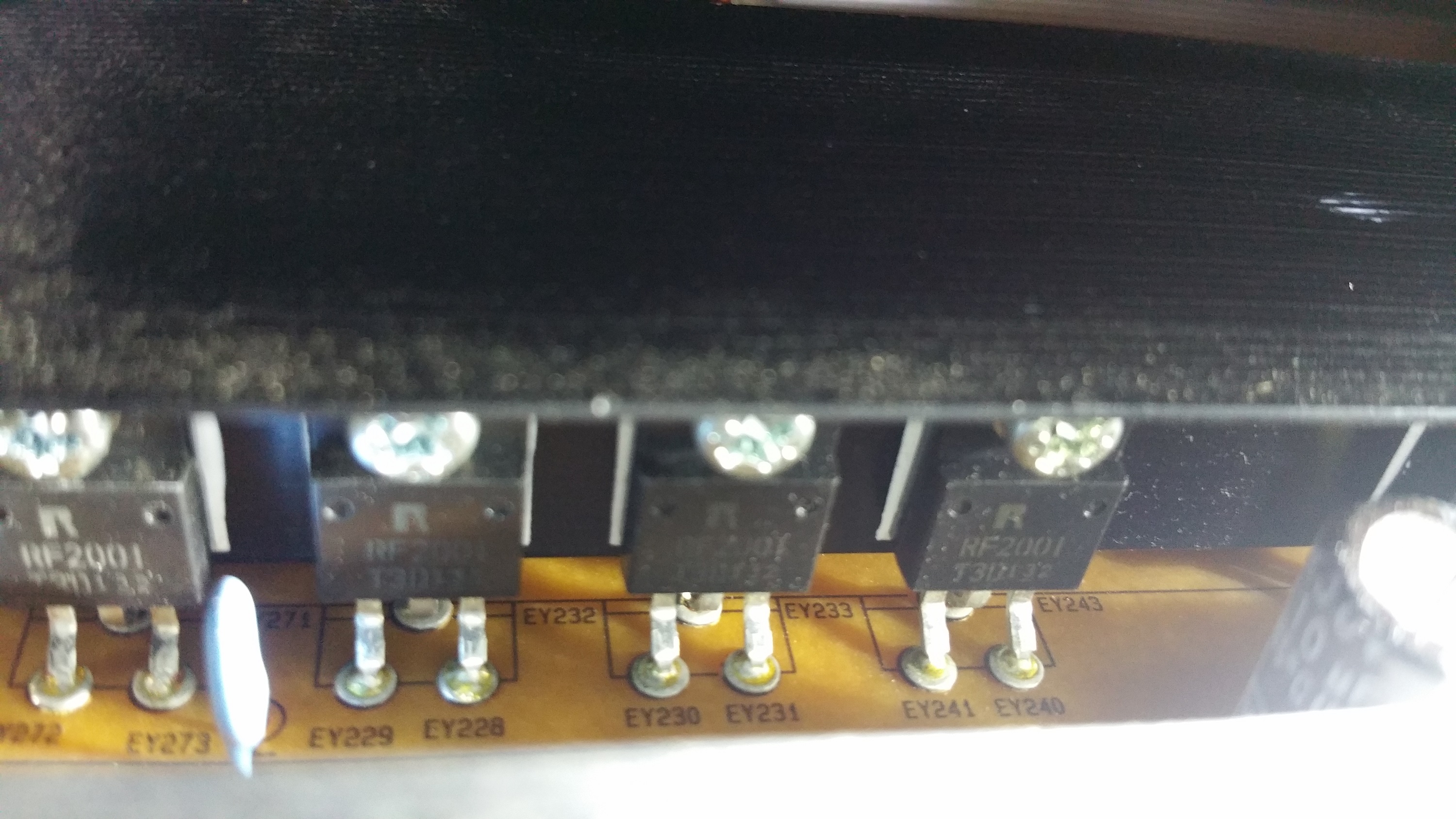

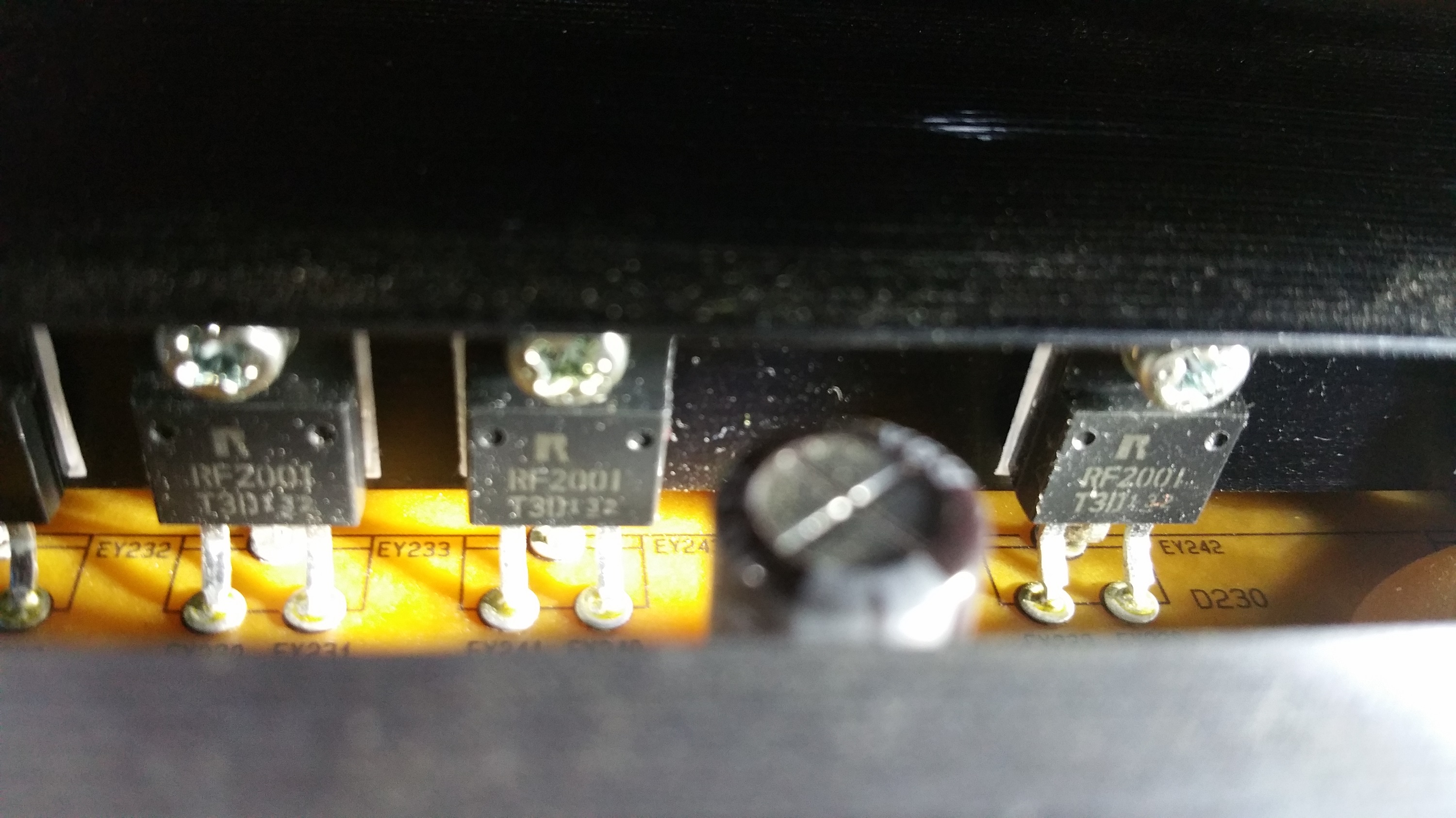

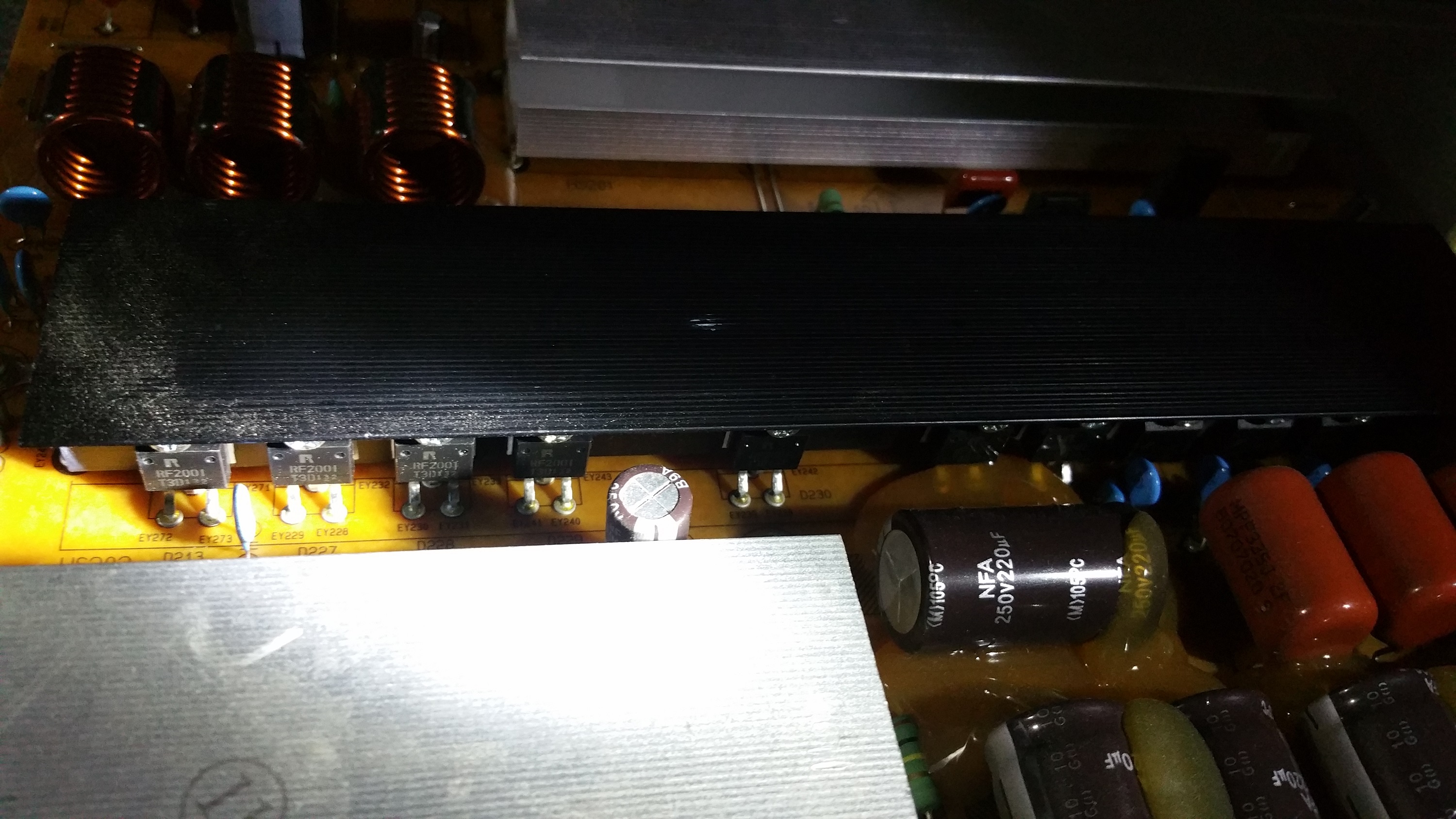

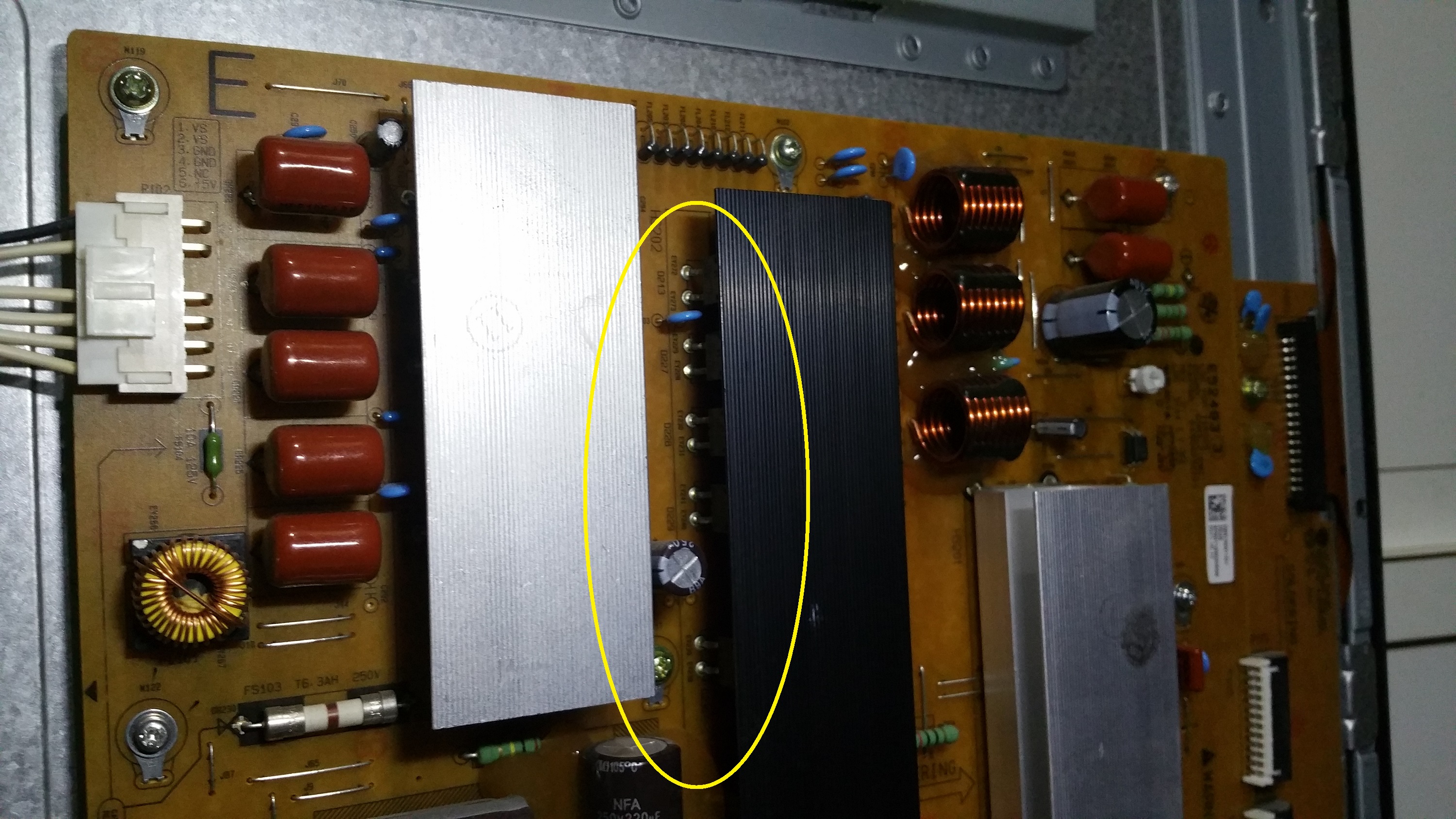

              Re: 60PV250-UB Mal Discharge after warm-up / 30 minutes.
              I used a hair dryer to pin point this location on my Z-sus board. If I heat this area I lose picture. If I then cool this area and restart the T.V. I get the picture to come back.
              • mmartell
                • Oct 2013
                • 3189
                Do the test again but with the straw attached to a can of compressed air. That way you can find the specific component that's causing the problem.
                      Interesting fault, might be an issue with the solder around some of those IGBTs, or possibly a failing IGBT.
                      The Vzb changing is very odd though. How specific is the heating? Do other areas cause the symptom to come but more slowly? or not at all?
                      Will await compressed air tests, may indicate exact part.

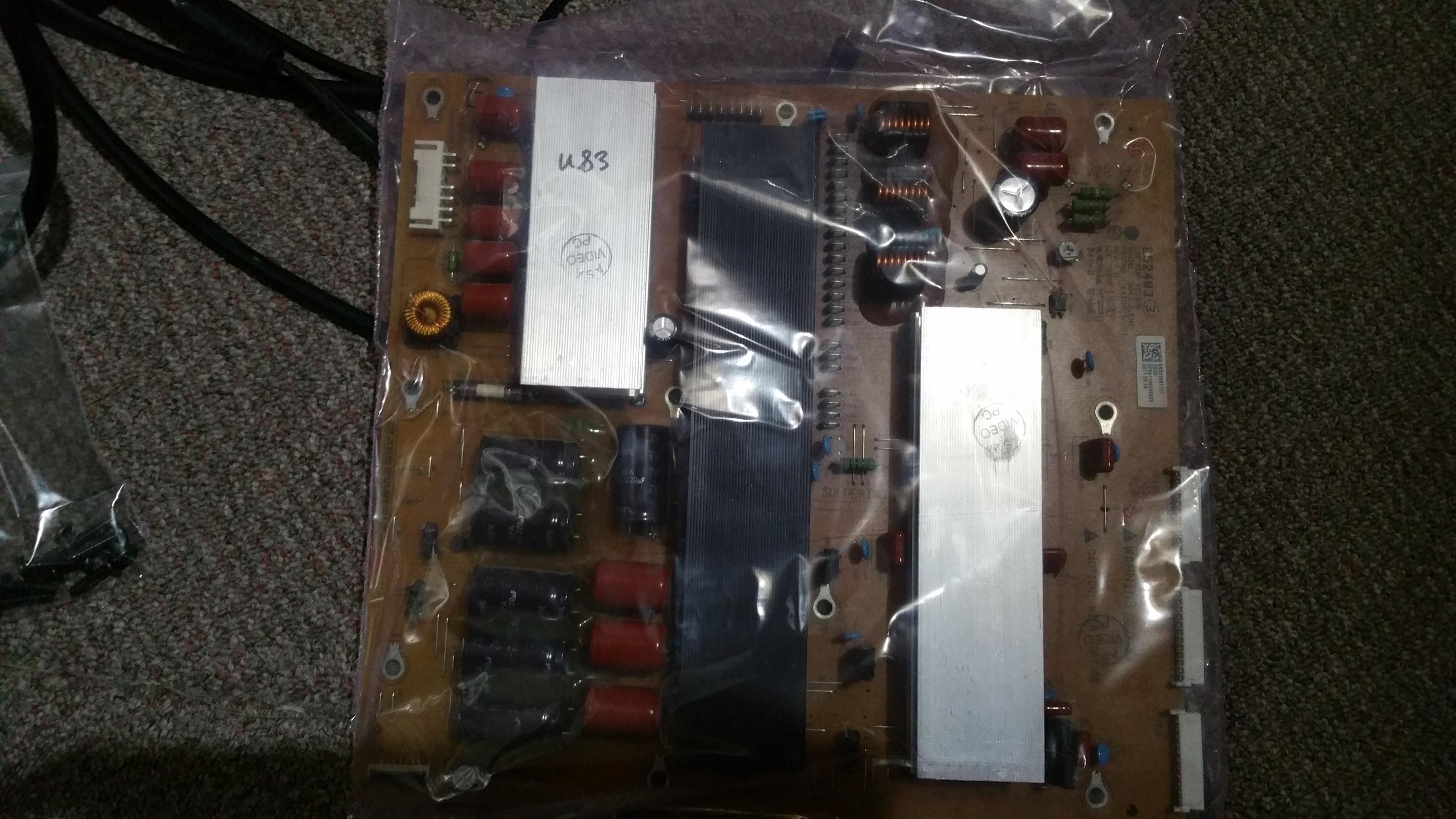

                          I purchased a can of canned air (Duster) to continue trouble shooting. In the meanwhile I received a rebuilt Zsus from Ebay. I have replaced the Zsus and have had no issues since. I have mosfets on order from China, so when they arrive I will continue the troubleshooting with the Duster and install them on the board. I will then post my results so as to complete everything at once.
