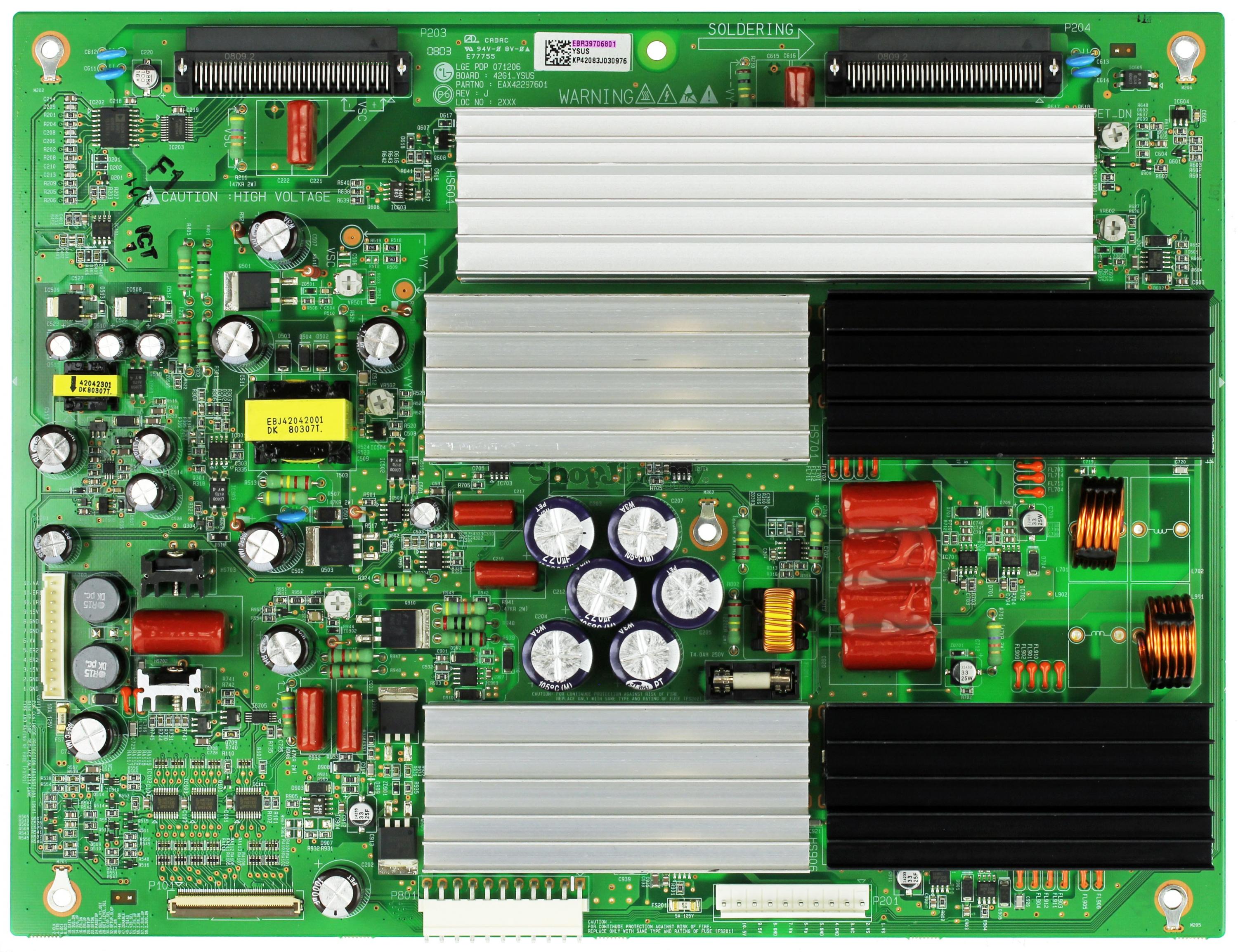

    Have lg 42pg20. When I got it the tv it would just click then turn off. Disconnected zsus and it would turn on and stay on. Replaced 4 blown fets on zsus now when I turn on it stays on but no panel glow or any thing.
    I have all correct voltages from psu to ysus but from ysus to zsus I have 188v for vs and 3v for zsus no changes when buffer disconnected. Can't find any shorts on ysus ethier. Not sure what to check on ysus or do I just get new ysus?

    Are those IPM modules under the heat syncs?

      No just gets attached this model doesn't have those ipm

        Do you have VSCAN on Ysus? And are there two buffer boards or just One?

          There is just one buffer board. There is no vscan voltage it's like 3 volt with or without buffer connected.

            So what you're saying is you are getting VS voltage to YSUS not ZSUS? What is VS voltage per panel label?

              Vs going to ysus and vs leaving ysus to zsus at 188v as per panel spec. Va is 59v as per panel spec.

                Ok. What are you measuring that only has 3v?

                  The vsc vsy points with and without buffer connected.

                    Did more testing replaced more shorted fets on zsus.
                    From connector ysus to zsus I have 188v on vs the 3 zsus labeled pins have 31v. When I put test pattern jumper on control board the zsus pins jump from 31v to 60v still no image on screen. The connection from zsus to control board I get 4.8v on 15v pins and nothing on the sus on or sus dn pins. I tested vsc and vsy on ysus with and without buffer jumps to 28v when control board in test pattern mode.
                    Any ideas where check

                      Was thinking I have bad ysus but cant find any shorts .
