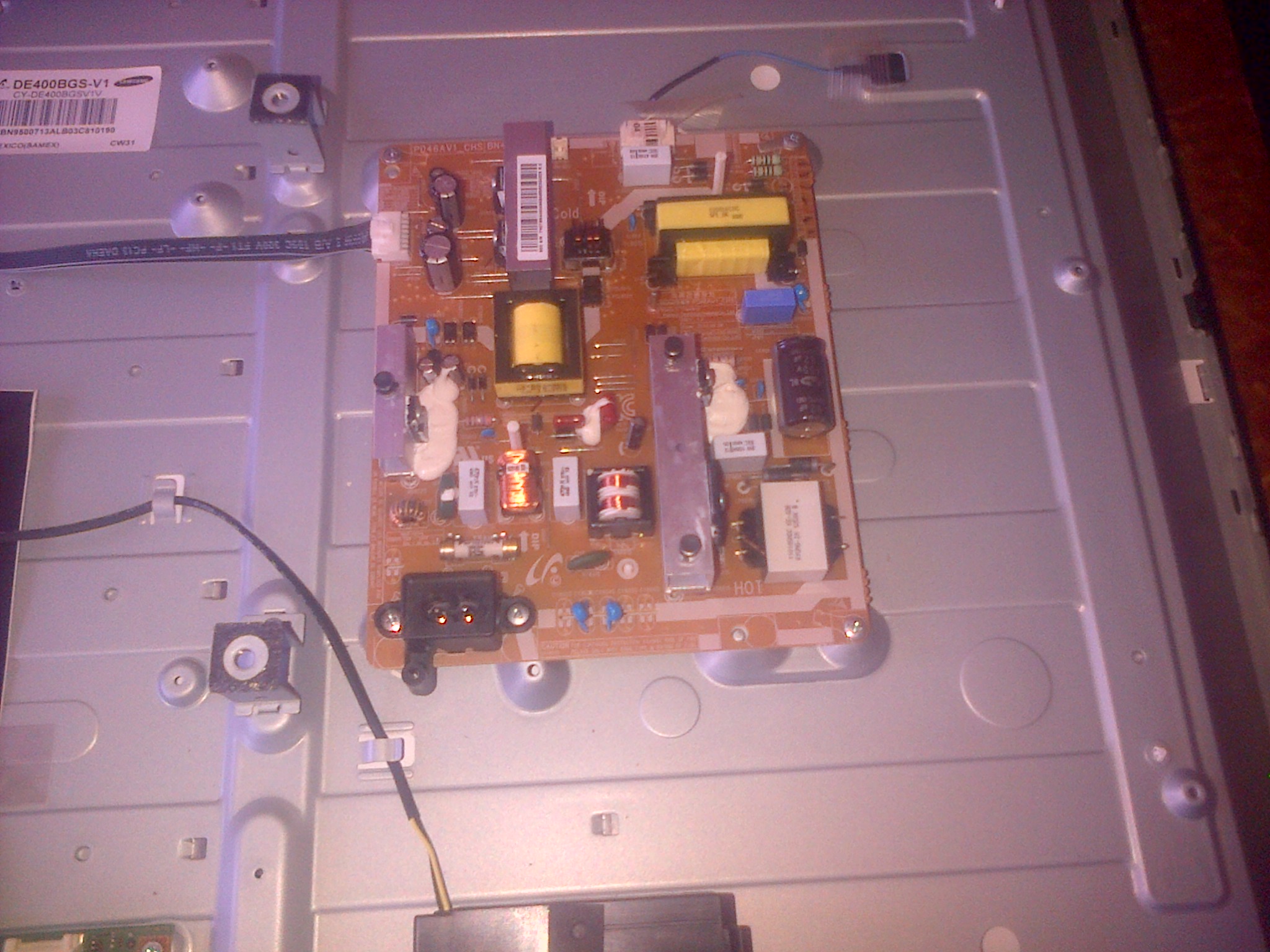

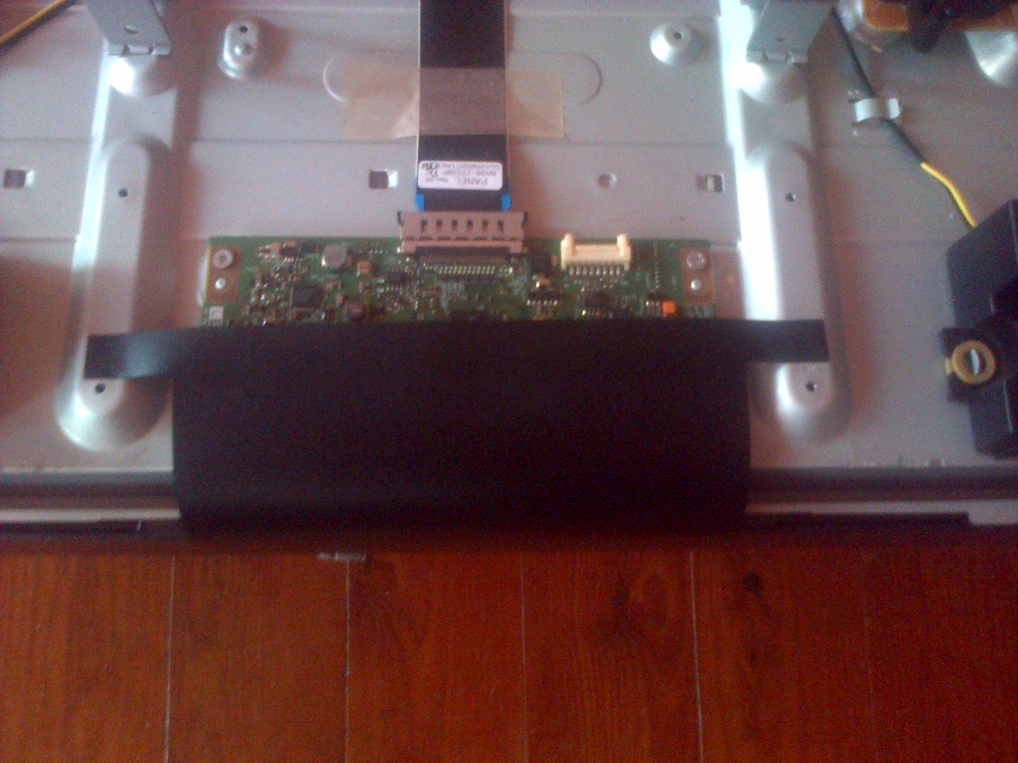

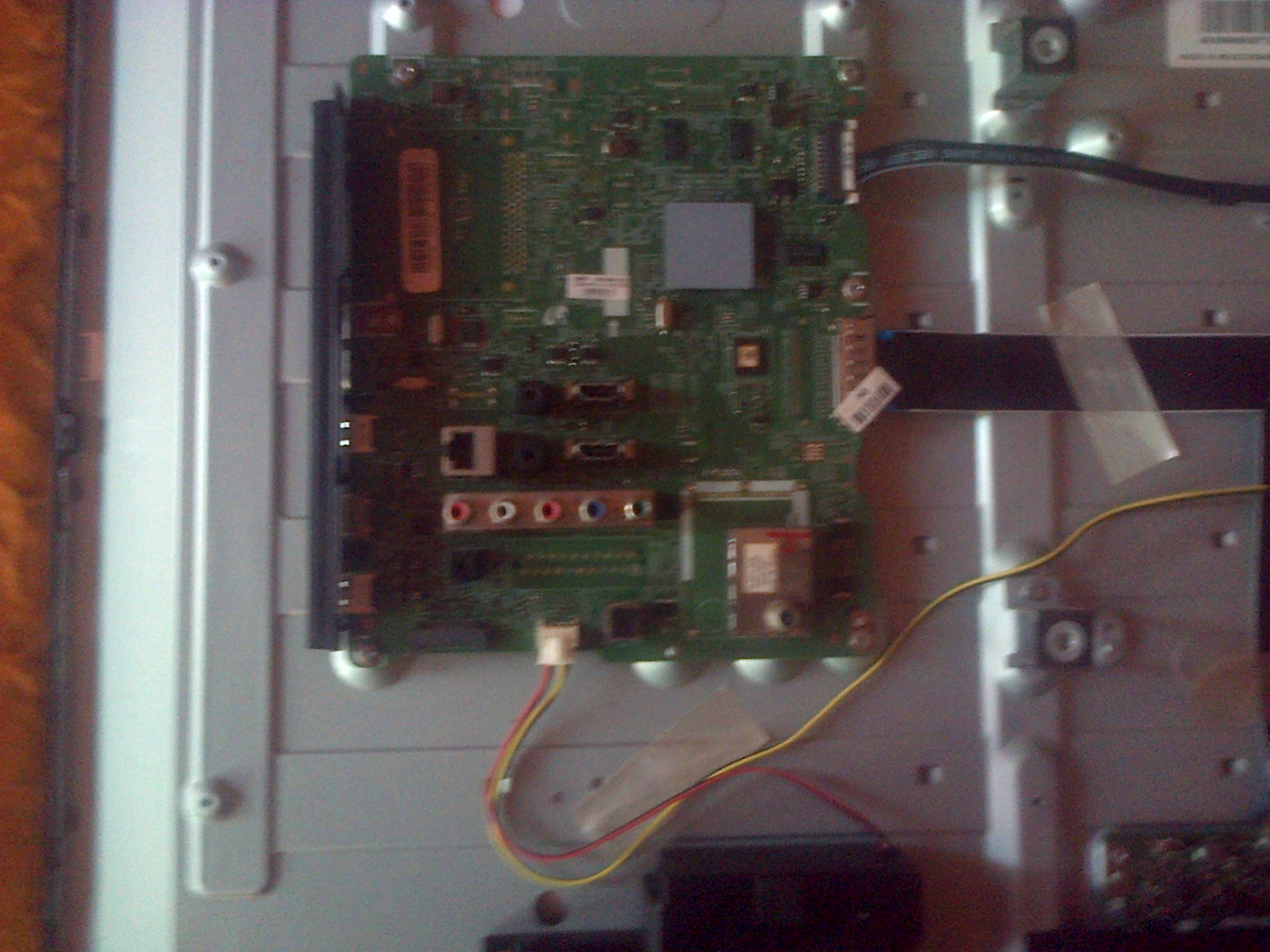

    Samsung UN 40EH5300
    I am servicing a Samsung UN40EH5300 which according to my brother was affected by a power surge.The fuse was blown and a coil damaged.The voltages to the main board are present but the television does not power on and there is no stand by light.When I unplug to power cable to the main board the back lights switch on, and I am of the opinion that the main board has been damaged.
