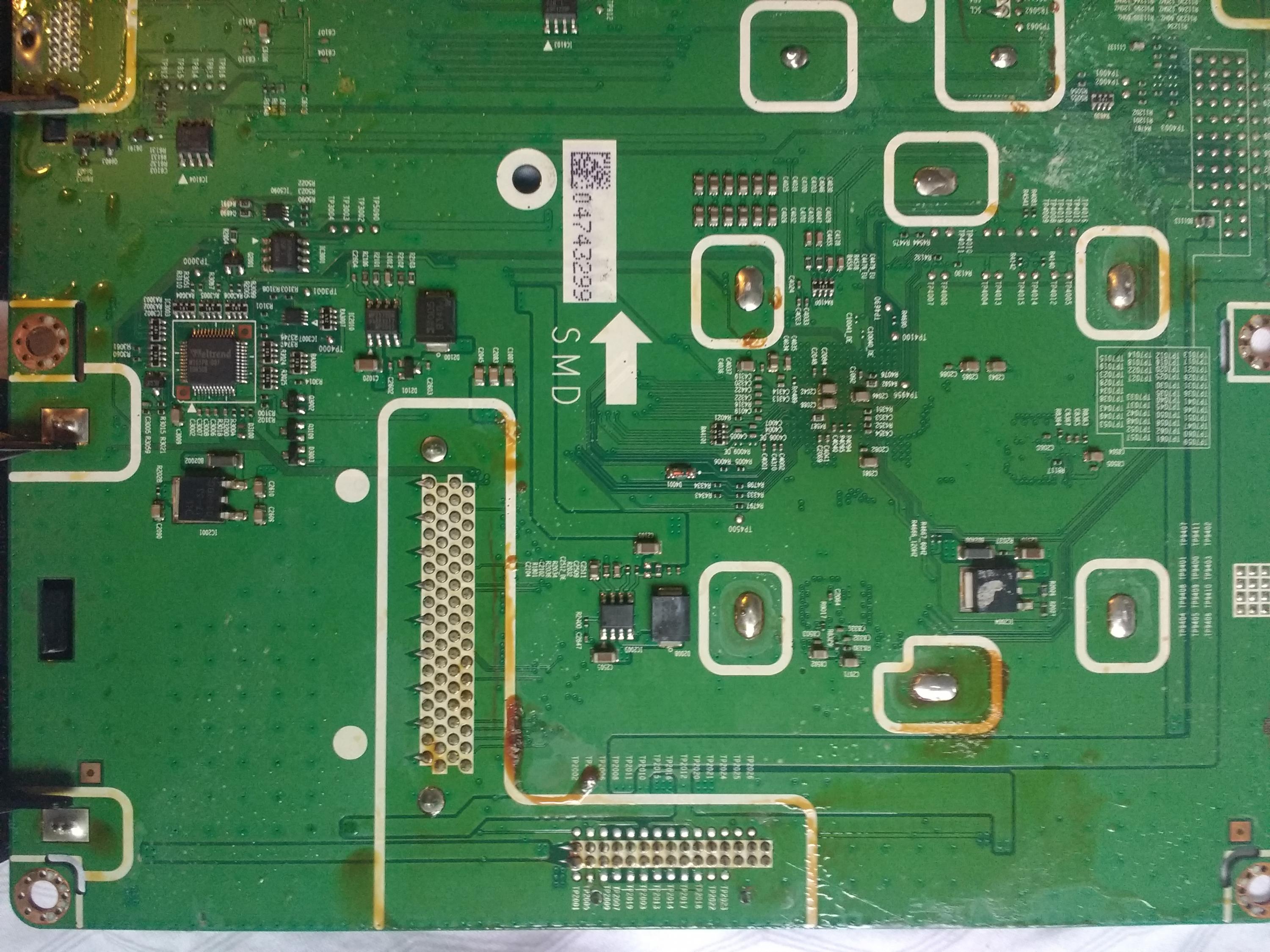

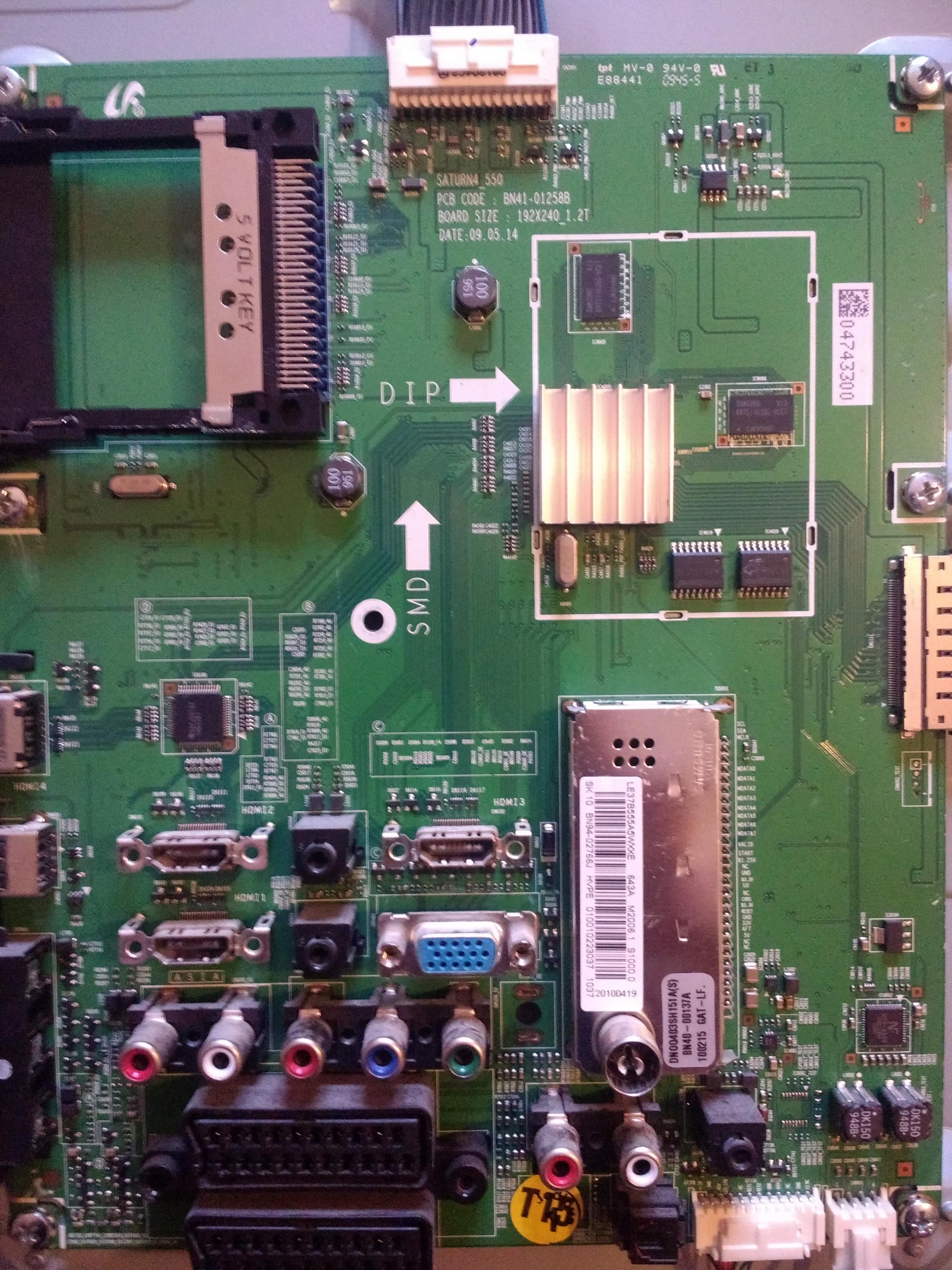

    I seem to have a very strange fault with this tv, most of the time it works fine but will occasionally turn off and on again it will sometimes make a nasty crackling noise through the speakers when it does this normally i leave it off for a while and will be ok when i turn it back on. The other thing about this fault is this never happens when using the tv to listen to the radio through the radio channels. also when watching tv sometimes the signal drops even tho we have good signal strength. not sure if there is a issue with some components overheating. thank for reading

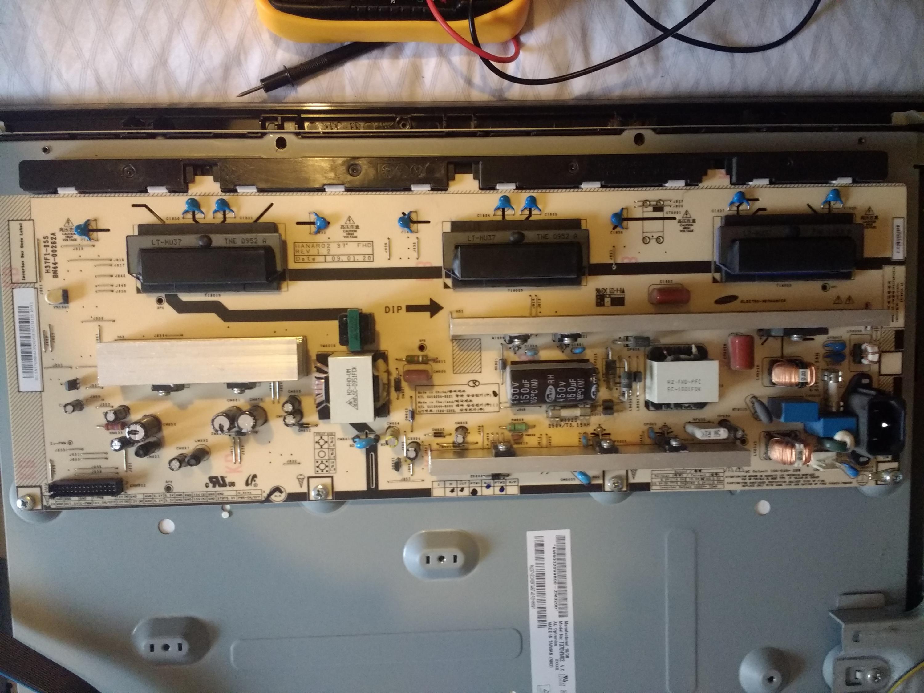

    Post some high resolution, straight shot pictures of the PSU and the main board. Maybe we can see something.

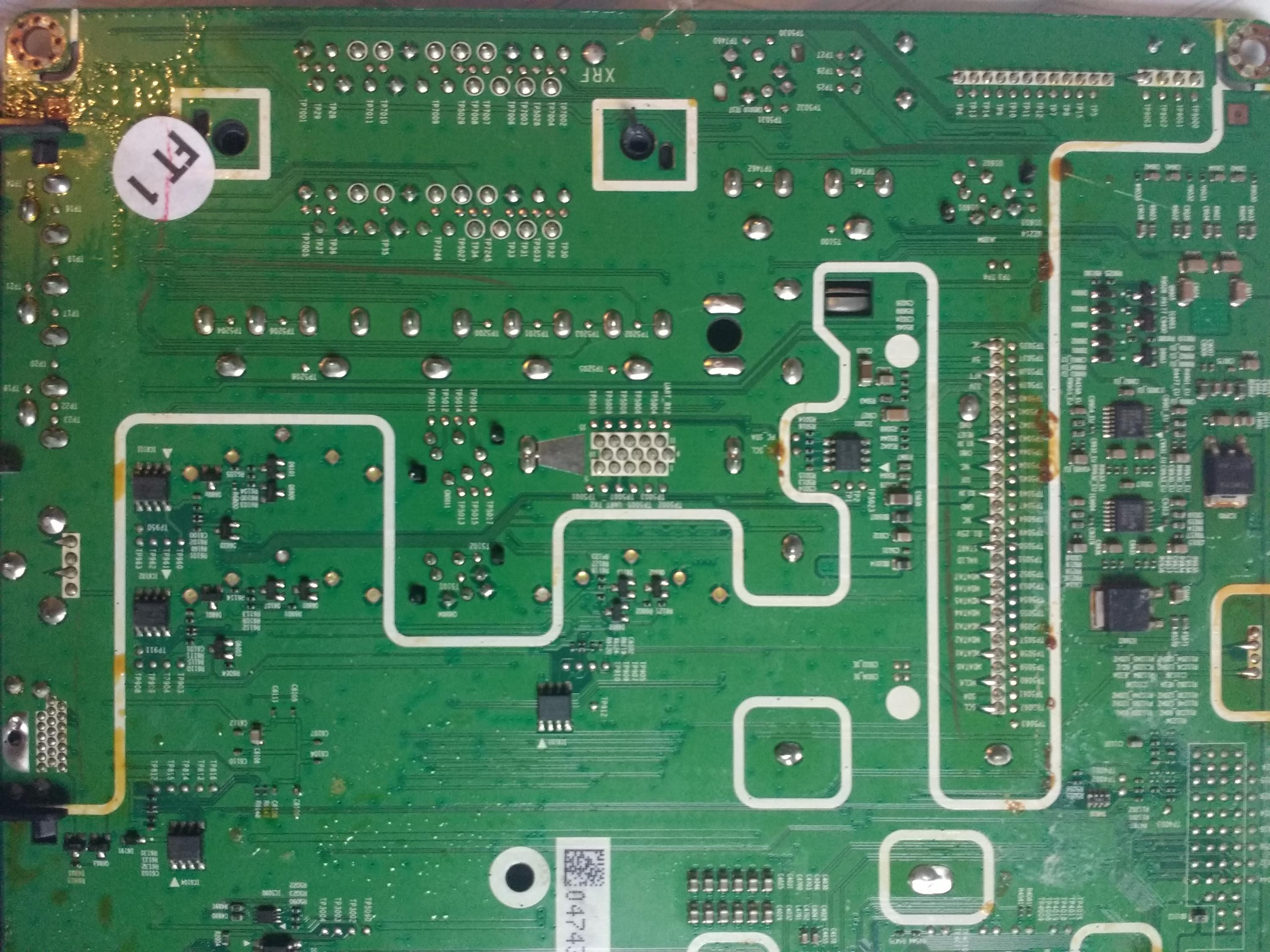

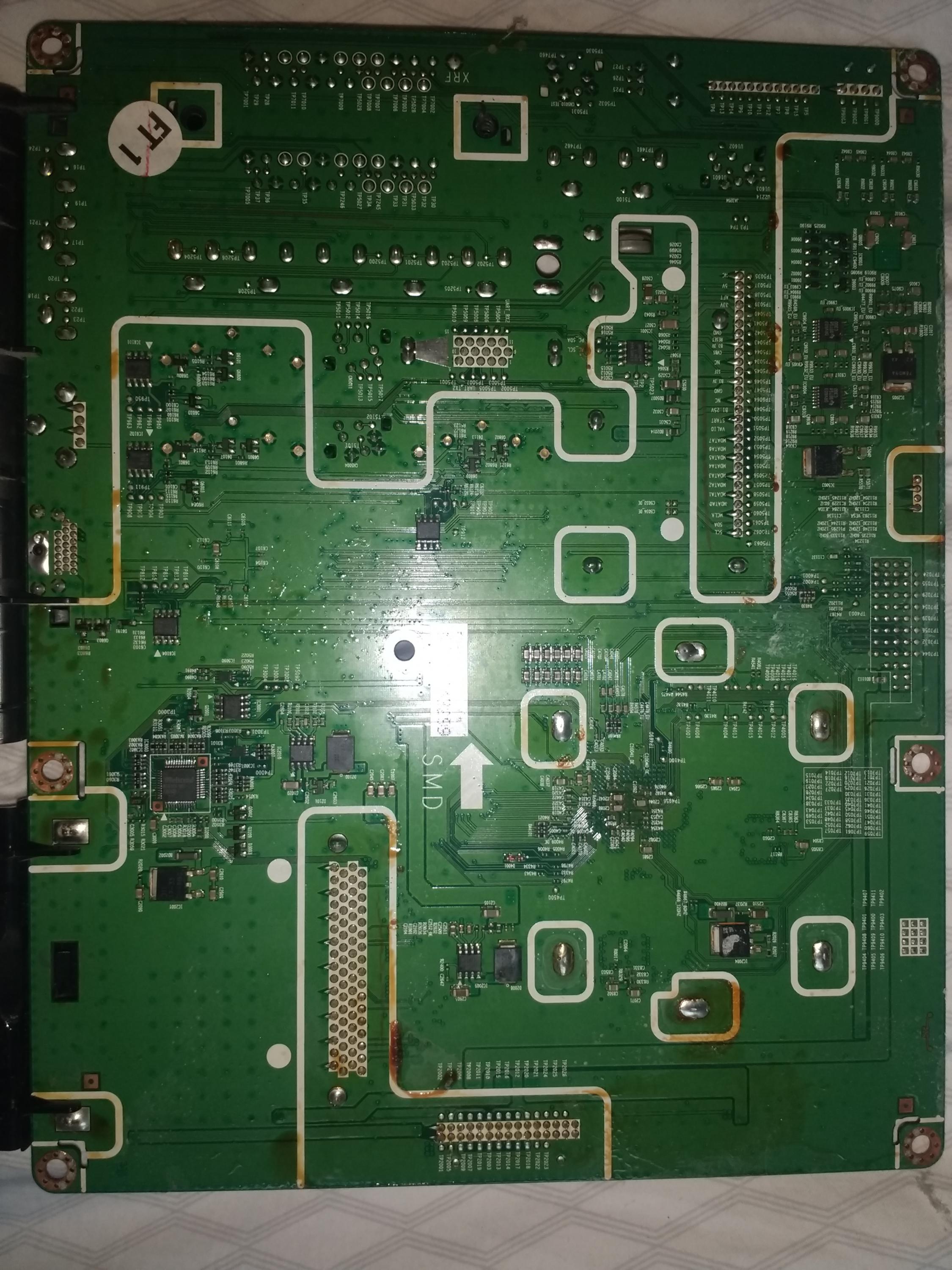

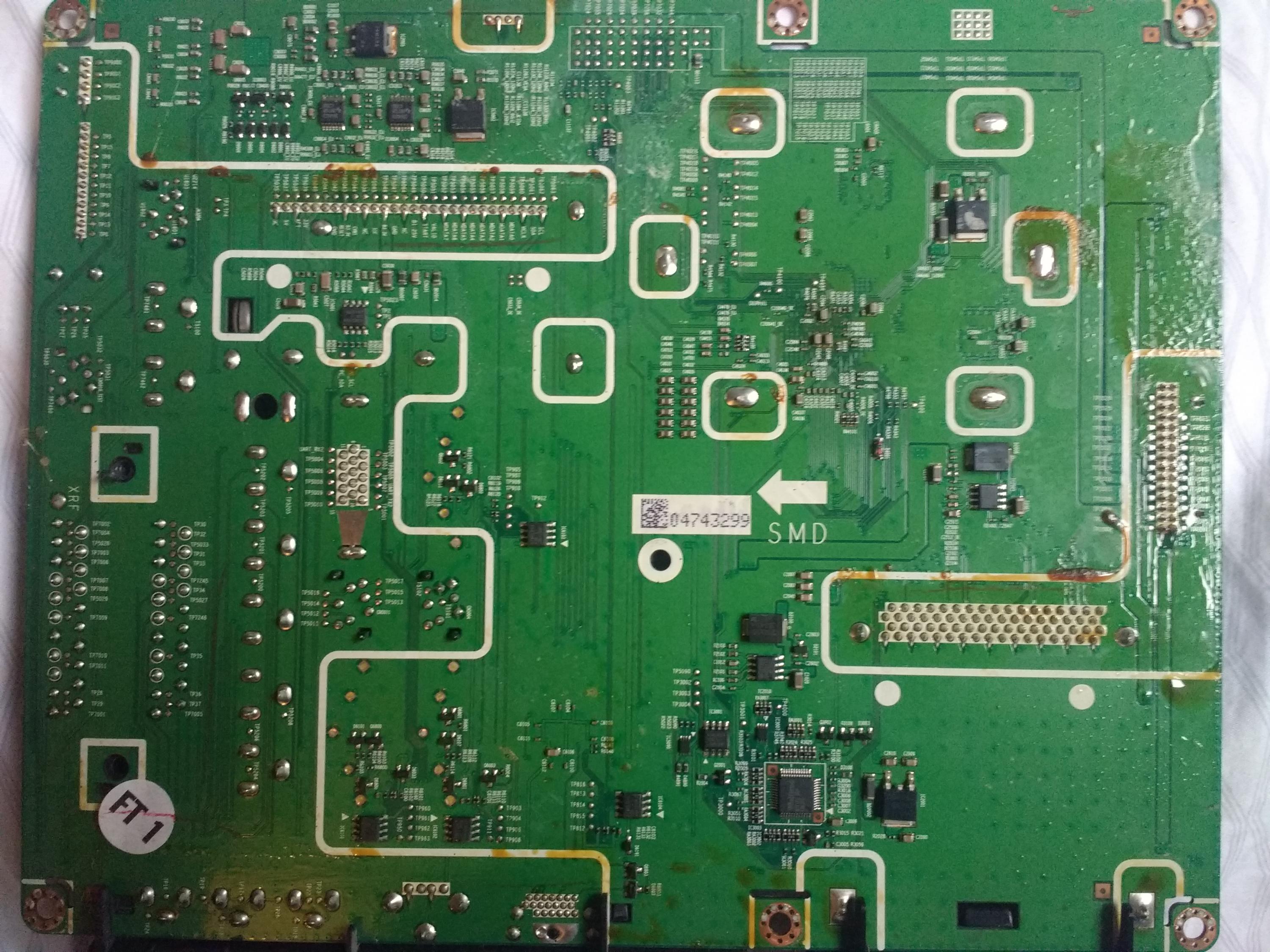

      Hopefully these pictures are ok, I took some extra pics of the main board as I noticed some kind of residue on it underneath. I think the power supply board maybe ok all output voltages seem ok the only one that is low is the second from the end I think pin 14 labeled (det) was 2.9 volts when is marked 5 volts. When I ran TV again I could not get it to fail (sods law) I even tryed to apply some heat to main board but would not fail! Let me know if you need anymore info cheers

        antenna socket looks a bit stretched on inner pin .
        have you tried using input to scart to rule out tuner section ? maybe sky box or vhs or something .

          Yer I see that too, I can sort that but TV did still power off when using scart and hdmi the only time it never failed with signal or turning off was when I used TV to listen to radio, I'll try having a look at cap under metal cover is it easy to remove? Do u mean u heated metal cover to make it fault?

                There isn't much you can do with this one. I'd clean it up with rubbing alcohol, put it back in and see what happens. If it does this again, I'd test is if it only does this while watching via the coaxial tuner, or if does this at the HDMI / SCART inputs as well. Go from there.

                        Just an update, as advised by in previous post I cleaned the main board with alcohol, nipped the pin together on the the aireal in port, and put TV back together had it on for about 4 days and had no problems at all on any inputs which is a good job as my son will be needing it to play his new X box on on Xmas day! I will probably be keeping this TV so if it fails again I will re post but thanks for the advice and replies merry Christmas!
