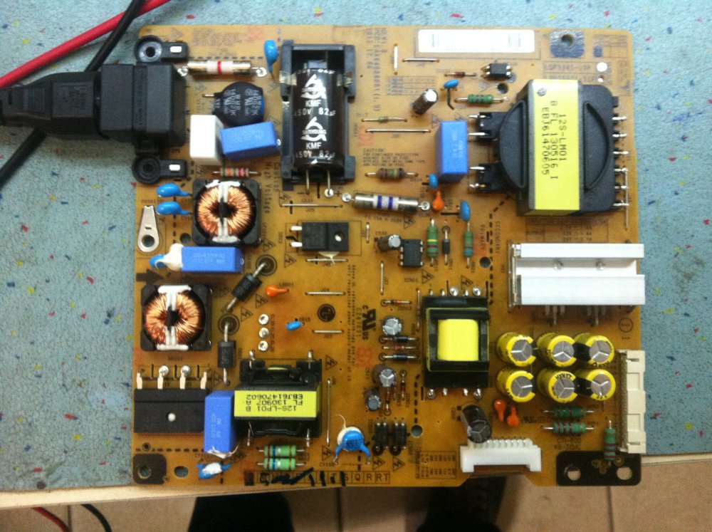

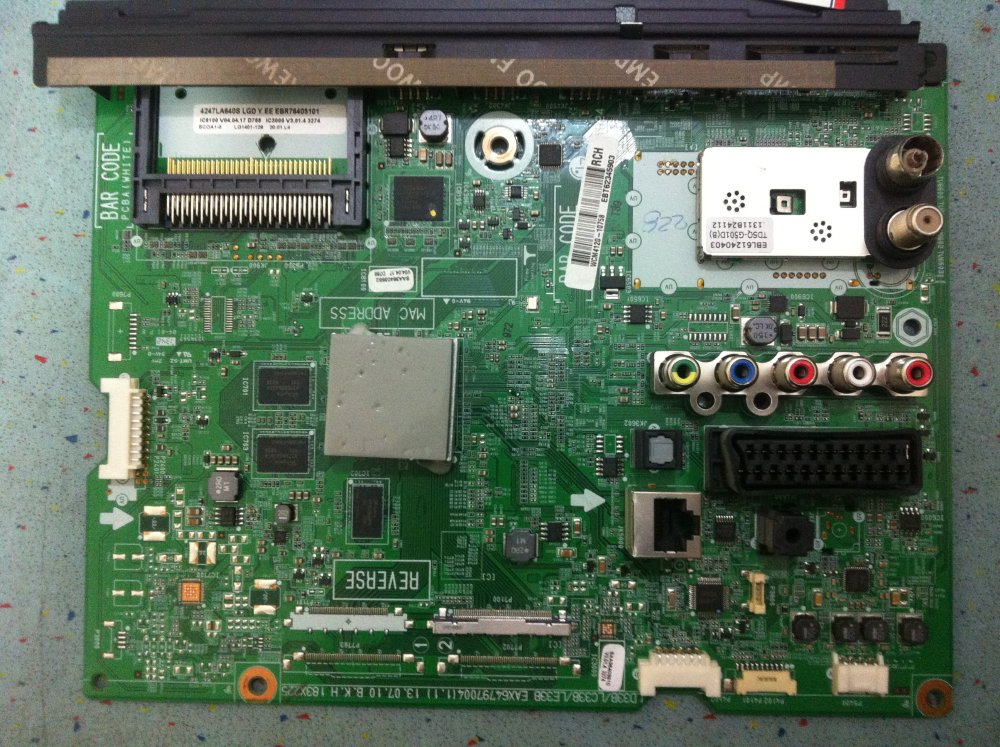

    LG 42LA640S:
    main: LD33B/LC33B/LE33B EAX64797003(1.2) EBR76405101
    EAX64908001(1.9) LGP3942-13P
    6870C-0444A LC470DUE-SFR1
    schema
    supply is not working properly 24 volts does not come
    24c256 dump and schema
    thanks

    Re: Lg 42la640s
    mainboard picture help

      Re: Lg 42la640s
      Do you have the 3.5V and 12V and what voltage do you have on D251 and D255
      • asliyucegsm
        • Jun 2011
        • 347
        • Turkiye
        Re: Lg 42la640s
        my friend
        3.5 volt yes
        12Volts and 24Volts shut down in 8 seconds
        • dick_barton
          • Aug 2015
          • 6642
          • Wales
          Re: Lg 42la640s
          Disconnect the mainboard from the power supply and on the power supply connect 3.5V to PWR_ON using a 1K ohm resistor and then check you have 12V and 24V
