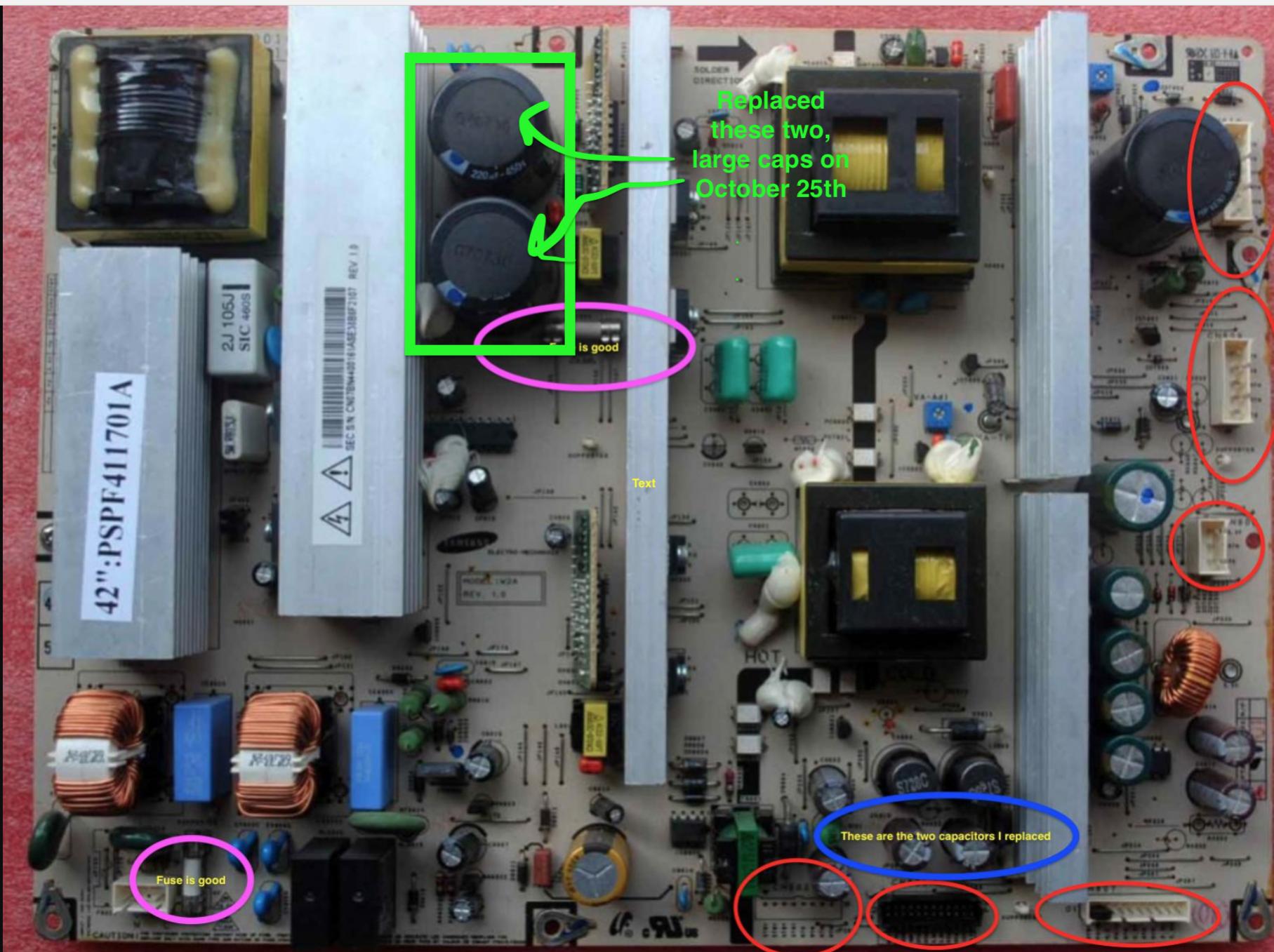

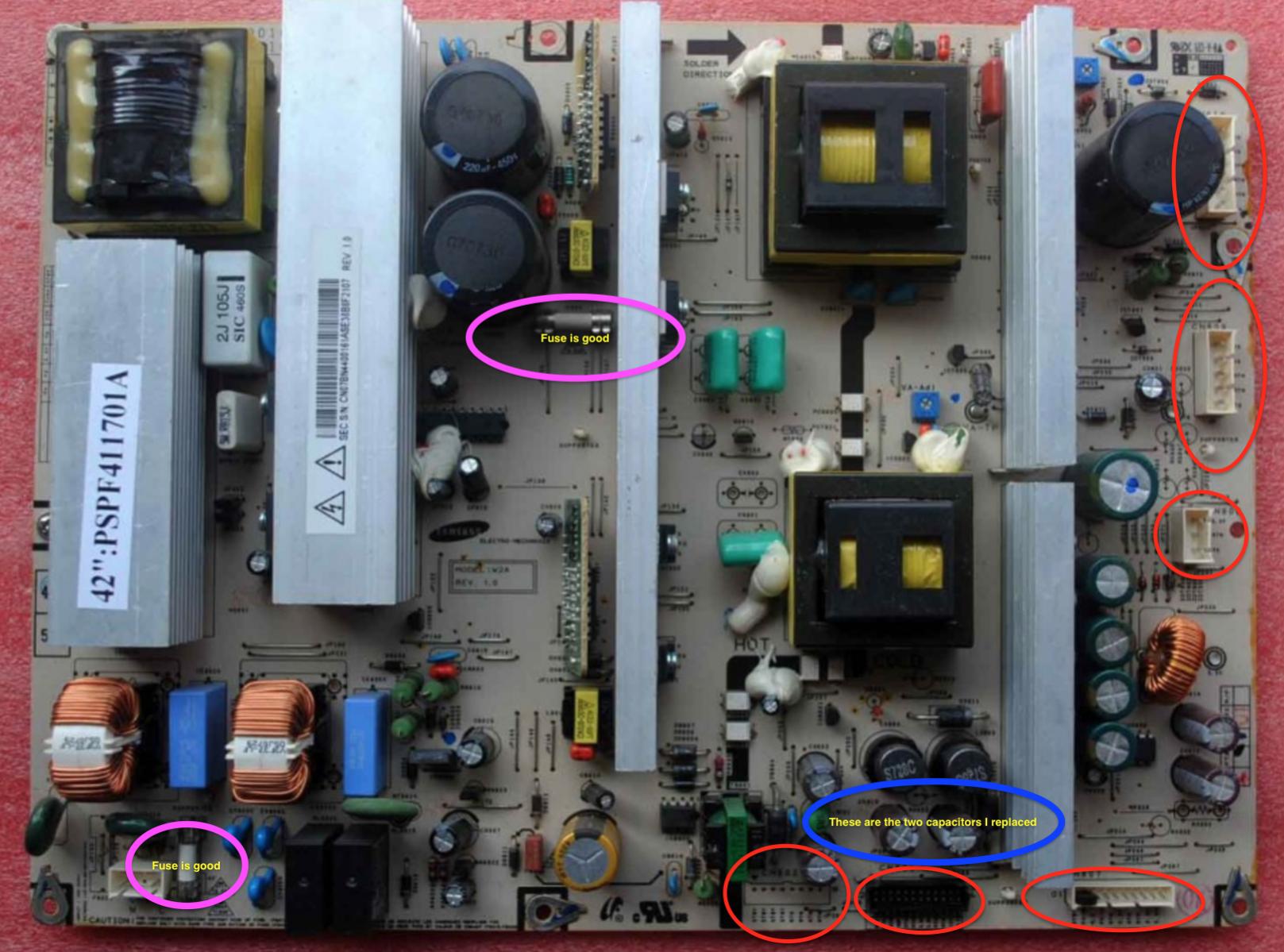

    Here is a photo I've marked up showing the six connectors I described in the post above (in red), along with the two capacitors I already replaced (in blue) and the two fuses which have always read as good (in pink).
    Please note that this photo is NOT my particular PSU. Rather, it is a generic one I took off the internet.
    I will take pics of my own tomorrow when I have a bit more time.

              First question is for tvtimmy. Can you please look at the picture I've attached and tell me if the caps I have outlined in YELLOW are the same, exact ones you described in your post above back on October 3rd?
              By the way, and importantly, just yesterday (10/25) I replaced the two 220uf 450v caps that sit in the upper middle of the board, right next to one another. The result was that there was no change at all. Same clicking on the same cycle. Still no picture, still no sound, and still no standby indicator lights on the front of the tv. Nothing changed for the better or for the worse..
              Please see the 2nd image below. The two 220uf 450v caps in question are marked in green.
              Note: I replaced them with 270uf 450v instead of 220uf because the store I go to only had the 270uf's. If that is a big problem, please let me know. I know it is slightly out of the 20% +/- range, but the folks at the store thought it would be okay to use these in this instance. If they need to be an exact match, I can go online and get the 220uf 450v caps if necessary.
              I did not yet replace the large 680uf 250v cap in the upper right-hand corner of the board because no one here on Badcaps was really pointing to that as a likely reason for this particular "clicking / cycling" type of fault.

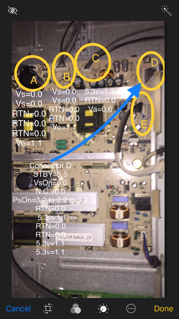

                I am also including a picture here of my actual board and the voltages I am getting. These all match what I wrote up above earlier this month. I just thought the visual might help someone out there to lend more advice.
                The "E" connector has the following readings (I just didn't have enough room in the photo to mark it up, as it has 24 pins ~ 2 rows of 12):
                0.0 = N.C / PS-ON = 3.2 down to 0.2 and back up to 3.2 (as I described above) Reads a steady 4.4 when the connector is removed

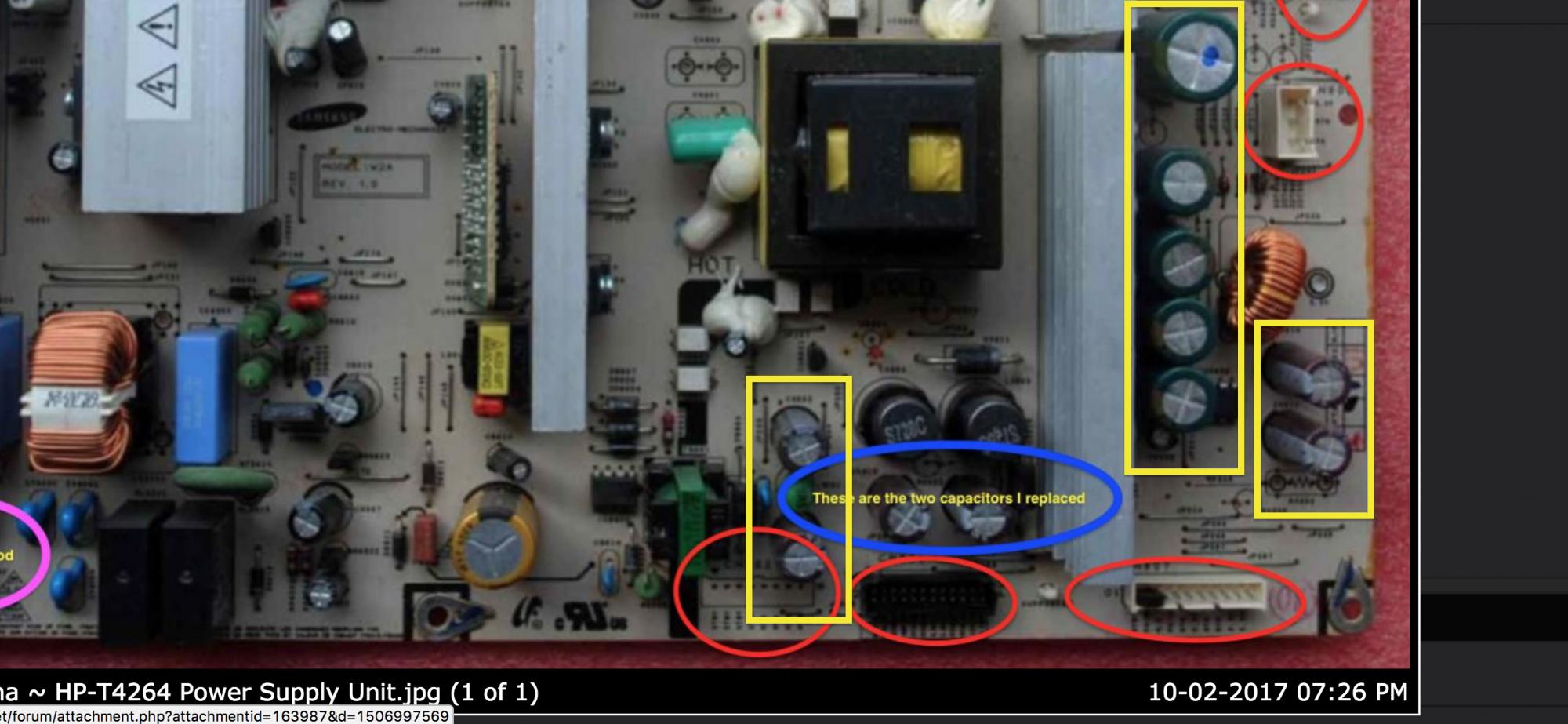

                                  replace the caps you marked in yellow.
                                  • kca
                                    • Feb 2016
                                    • 548
                                    Re: Samsung HP-T4264 ~ Clicking and no picture or sound
                                    Okay. I will get those caps today or tomorrow.
                                    The two brown ones on the left are: 470uf 35v
                                    The four green ones on the right of the heat sink are: 1000uf 35v
                                    And the two brown ones on the right of the heat sink are: 2200uf 10v
                                    But what is the lone green one? The one that sits above the 4 green ones. I cannot read the label. Looks like maybe 470uf 100v? Just can’t tell. Do you know or remember from your previous repairs?
                                    • tvtimmy
                                      • Mar 2015
                                      • 1160
                                      • usa
                                      I dont recall the specs of that cap, got a board at home, but Im away. Bump up the 10v caps to 25 or better yet 35 volts.
