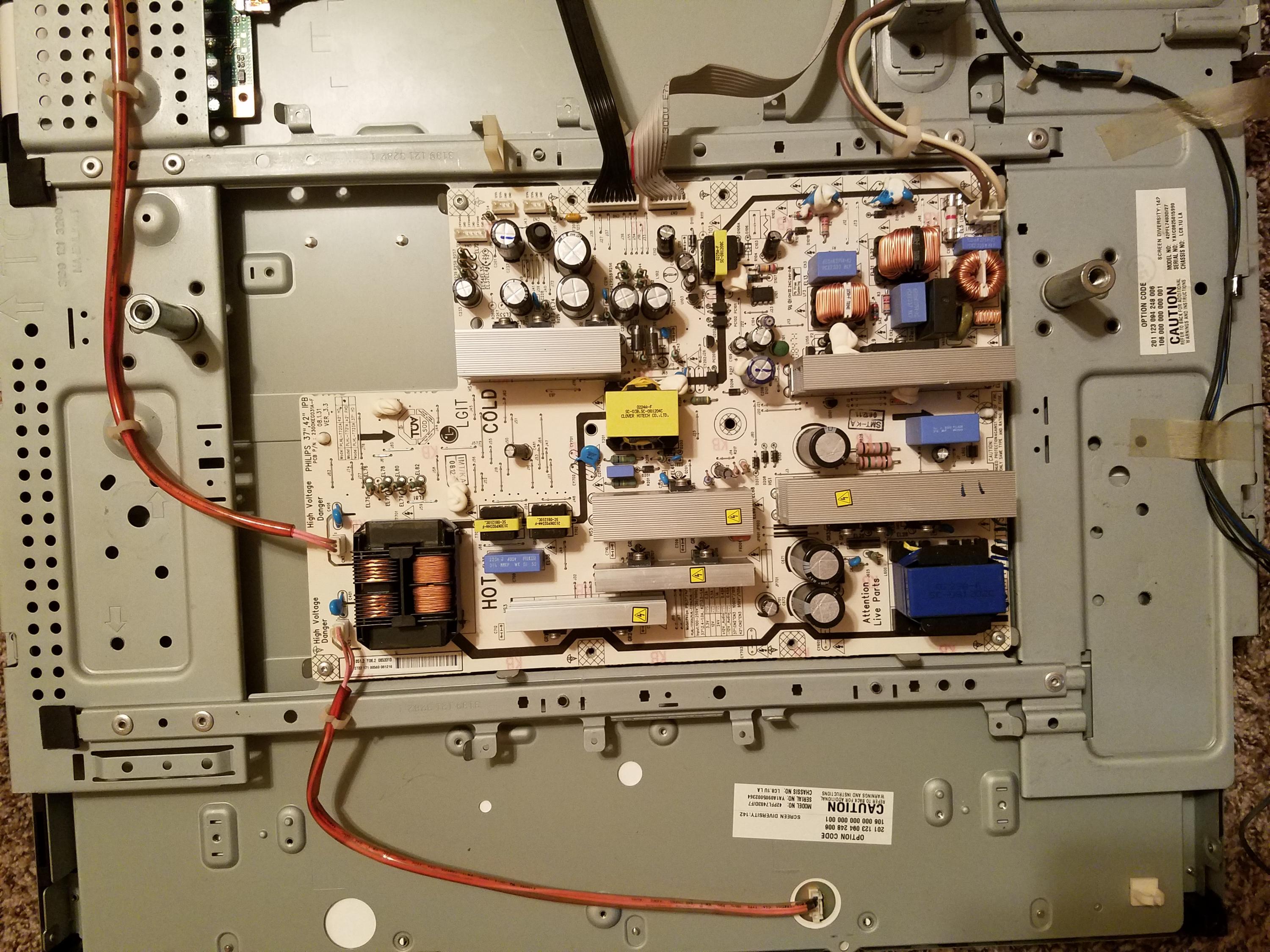

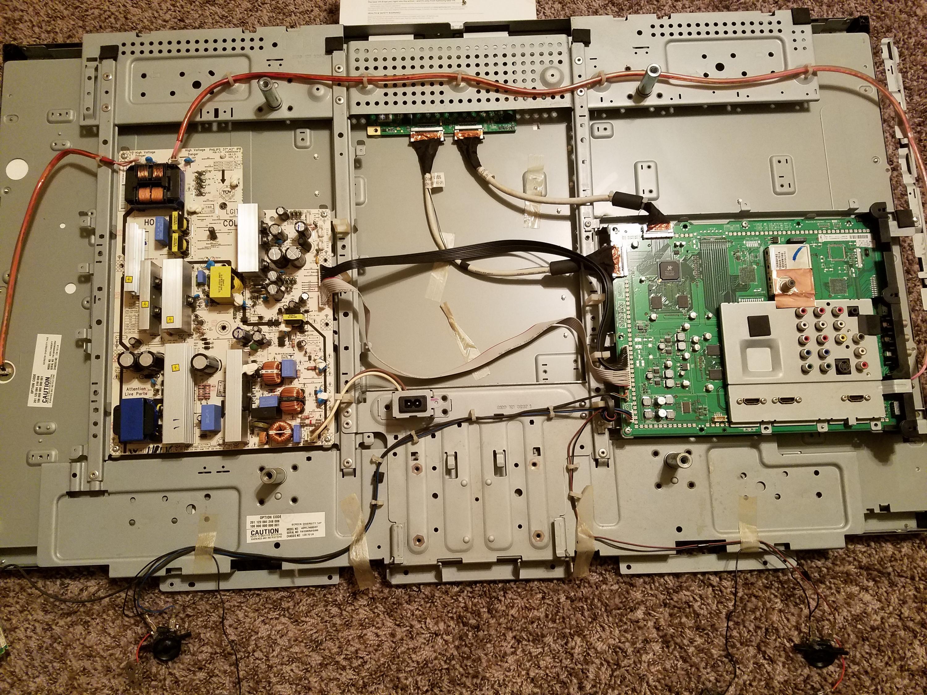

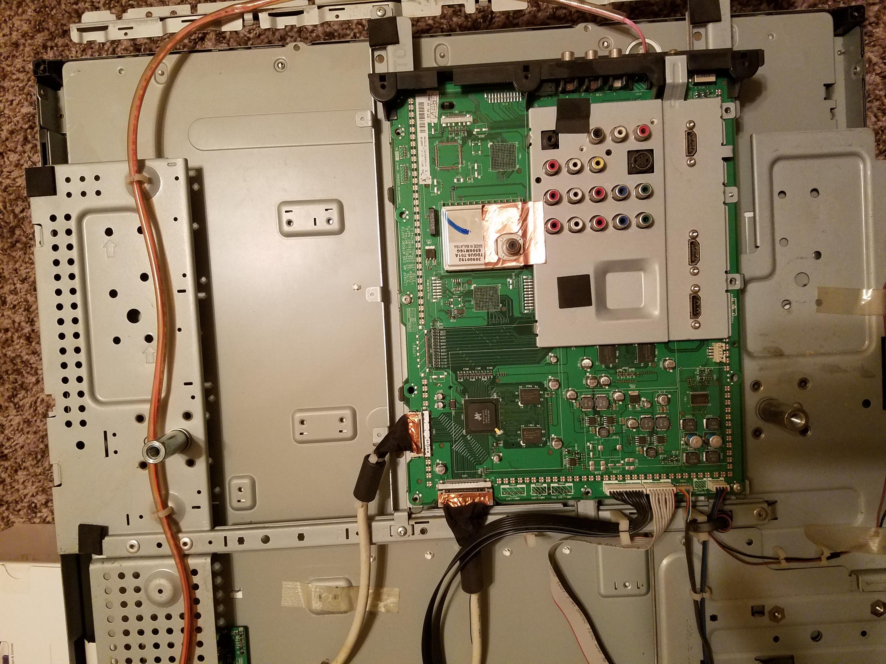

    Sorry, I completely forgot to take pictures last night before finishing up for the evening and just getting a few spare moments this evening to take a few and upload them.
    They aren't the greatest pictures, so if you need to see something specific, please let me know.
    Oh and I forgot to mention in the original post that the two green LEDs on the SSB come on and stay lit as well as the blue LED on the T-Con board comes on and stays lit. Checked the fuses on both the Power Supply and T-Con and they're good.
    I haven't got to deep into checking other board related measurements yet, so if you have any suggestions on where I should look/test, I'm all ears.

      Ok, finally got to look at this more.

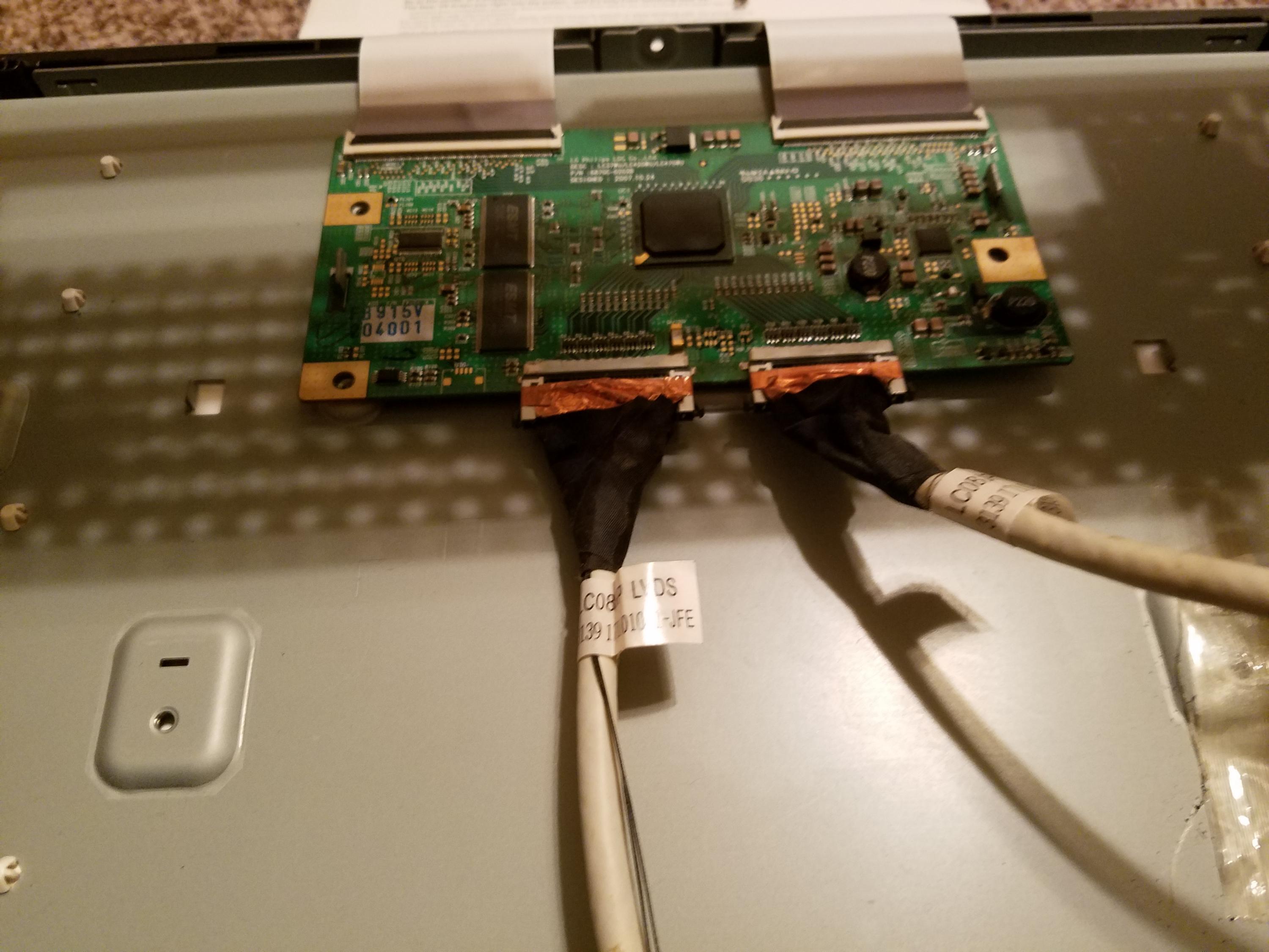

      Correction the previous post: the T-Con Blue LED comes on at power on and then goes out after what I perceive is the 'start-up' process.
      Checked the voltage measurements on the SSB from the Power Supply and everything looked good -- all 12v lines were between 11.88v and 13.3v and the 3v was @ 3v. Checked at the Gray cable and Black cable at the connection on the SSB.
      Also, after the hundredth plus time, I finally was able to get to diversity code (incorrectly stated option code earlier) entered and confirmation that it was set (TV Set turned off after entering the code). Apparently this all has to be done in (very) rapid succession -- not slowly entering the sequence. But still not picture.
      So unfortunately, I'm still not any closer to figuring out what is wrong... Any suggestions are welcome.

            Well, after everything I have read regarding troubleshooting the TV and others symptoms and resolutions... And everything testing out well... Finally getting the Diversity Code confirmation that it was entered, I figured the PSU and SSB were good...so decided to give another T-Con board a try...
            And now it works!
            If anyone has any recommendations on testing the T-Con board to see what could be wrong with them, I'd be interested in diving into them.
