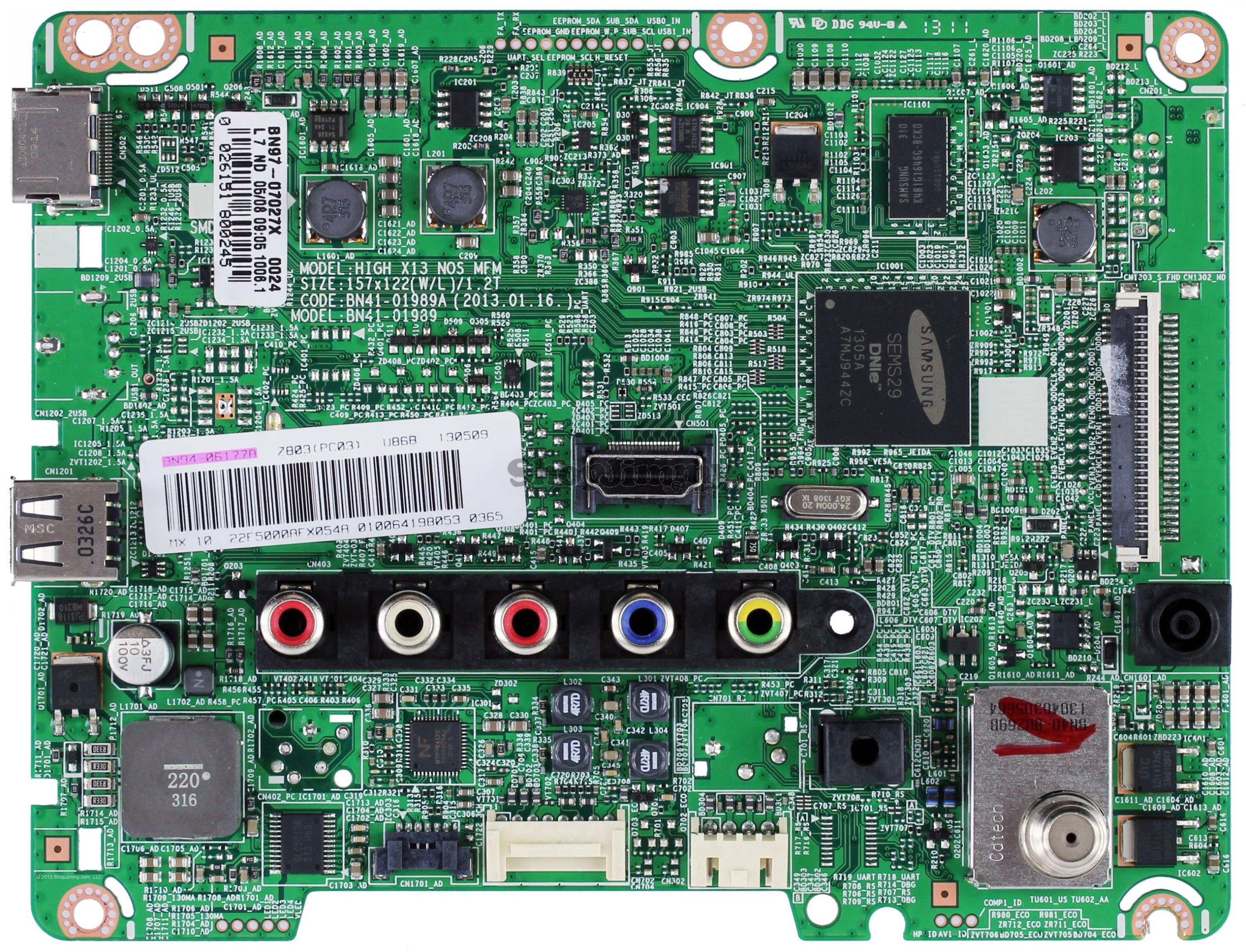

    Greetings All.
    Symptoms
    Set uses an external 14v dc power supply and it is working correctly, reads 14.26v. Red led is lit when plugged in and standby voltages are present. All voltages come up when turned on by remote or jog stick (EXCEPT no 13v panel voltage,no audio,no led backlight and set will not turn OFF by remote or jog. I have service manual (sans schematic,of course) I have repaired Vizio (standby light only) with eeprom replacement so I feel this might be in the same category.
    SOOooo! I;m looking for an eeprom bin file for above set with a Winbond 25Q128FVSG chip. Also can anyone definitely tell me if a firmware update will contain the default eeprom information.
    Any info on reading eeprom lines would be of GREAT help
    PHOTO by SHOPJIMMY.
