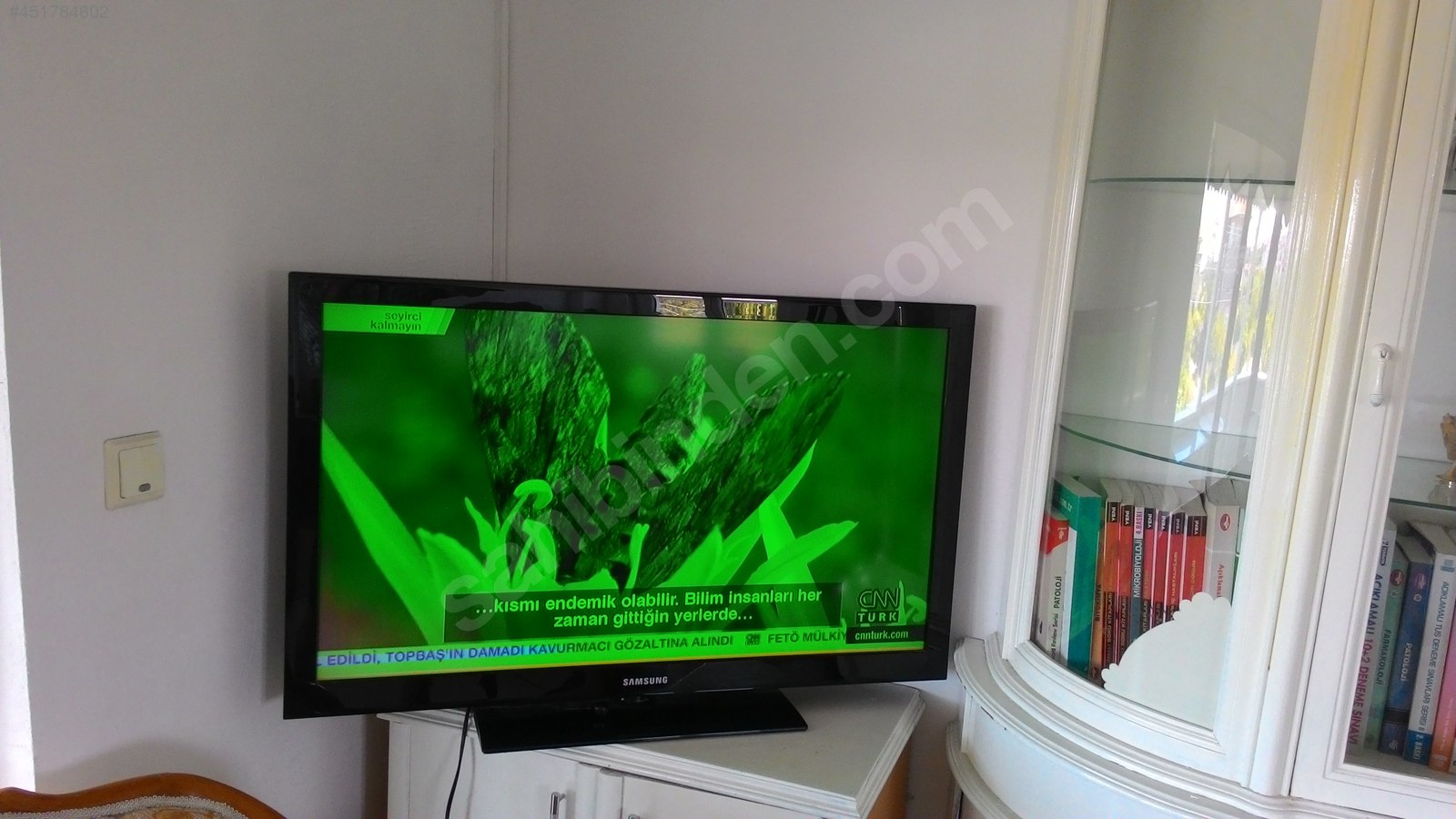

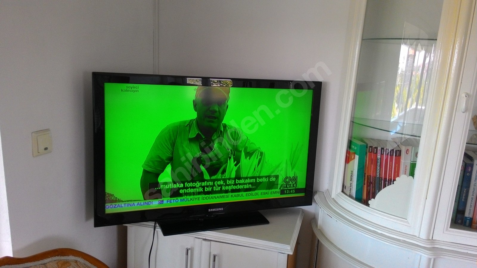

Green image problem of Samsung LCD TV
  • mikail13
    • Aug 2013
    • 93
    • Turkiye
    Selam everbody
    need your help.
    any idea?
  • Andrew F. Ali
    • Jan 2014
    • 2450
    • Trinidad & Tobago
    Re: Green image problem of Samsung LCD TV
    I had a some what similar issue once. It turned out to be a bad panel....I learnt this after changing both the T-CON and Main Bds without success.
    • R_J
      • Jun 2012
      • 9624
      The easiest thing to try would be re-seating the lvds cable between the main baord and t-con, you never know and it costs nothing to try
