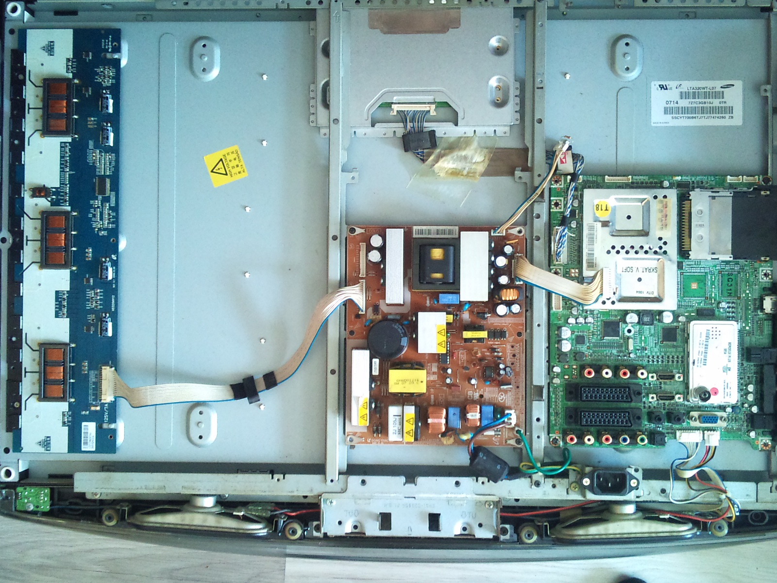

    Hi everyone,
    I'm sorry for my bad english
    This thread about a Samsung LE32R86BDX with a PSU BN44-00155A & an Inverter Board INV32N12A Drived by a SEM2006
    I recovered this LCD with severals problems.
    At first the TV was'nt turning on at all, no red light. I found the RM801 0.22 ohms resistor cut and after changing it
    the red light going on and the TV turning on when touching the front panel......but there is no backlight at all (no flash & I don't know at this time if there is picture).
    Measure on the PSU are the following :
    5v -> 5v
    12v -> 12v
    13V -> 12.1V (??)
    24v -> 24v
    Measure on the Inverter Board :
    Transformers Secondaries -> 1250/1275 ohms (expected 1250 ohms)
    Little transformer T3 Primary and Secondary -> 36 ohms (expected 40 ohms)
    Fuse F1 is OK (24v on the two pins)
    So for the following tests I disconnect the Main Board and forced the PS_on to 5v and the same thing for BL O/F

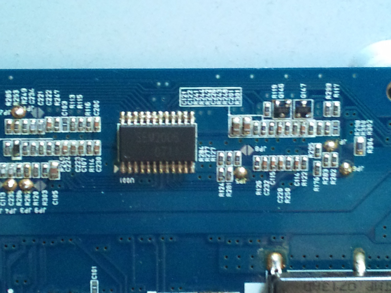

    I took the mesure on the pins of the SEM2006 IC:
    Pin / Symbol / Measure
    1 VREF 4.8v
    2 SDT 0v
    3 S/S 2.1v
    4 HF 1.1v
    5 DET 0v
    6 ARC_P 0v
    7 ARC_N 3.2v
    8 FB 3.5v
    9 ERO 0.5v
    10 OVP 0v
    11 PGND 0v
    12 N1 0v
    13 N2 0v
    14 VCC 24v
    15 UVLO 4.8v
    16 EN 3.5v
    17 FAIL 0.8v
    18 SGND 0v
    19 CT 2v
    20 RT 2v
    21 HRT 5v
    22 BRT 1.5v
    23 BCT 2v
    24 BDIM 0v
    When I was tooking measure around the pins 8 & 9 the Backlight start for a second, I thing I did a short circuit with my probe....
    So I need some help there because I don't know how to interprate my results, I just understand that the two Channel MOSFET Driver output pins (N1 & N2) are low but I don't know why.
    If you have and idea of what can I test know, it would be great

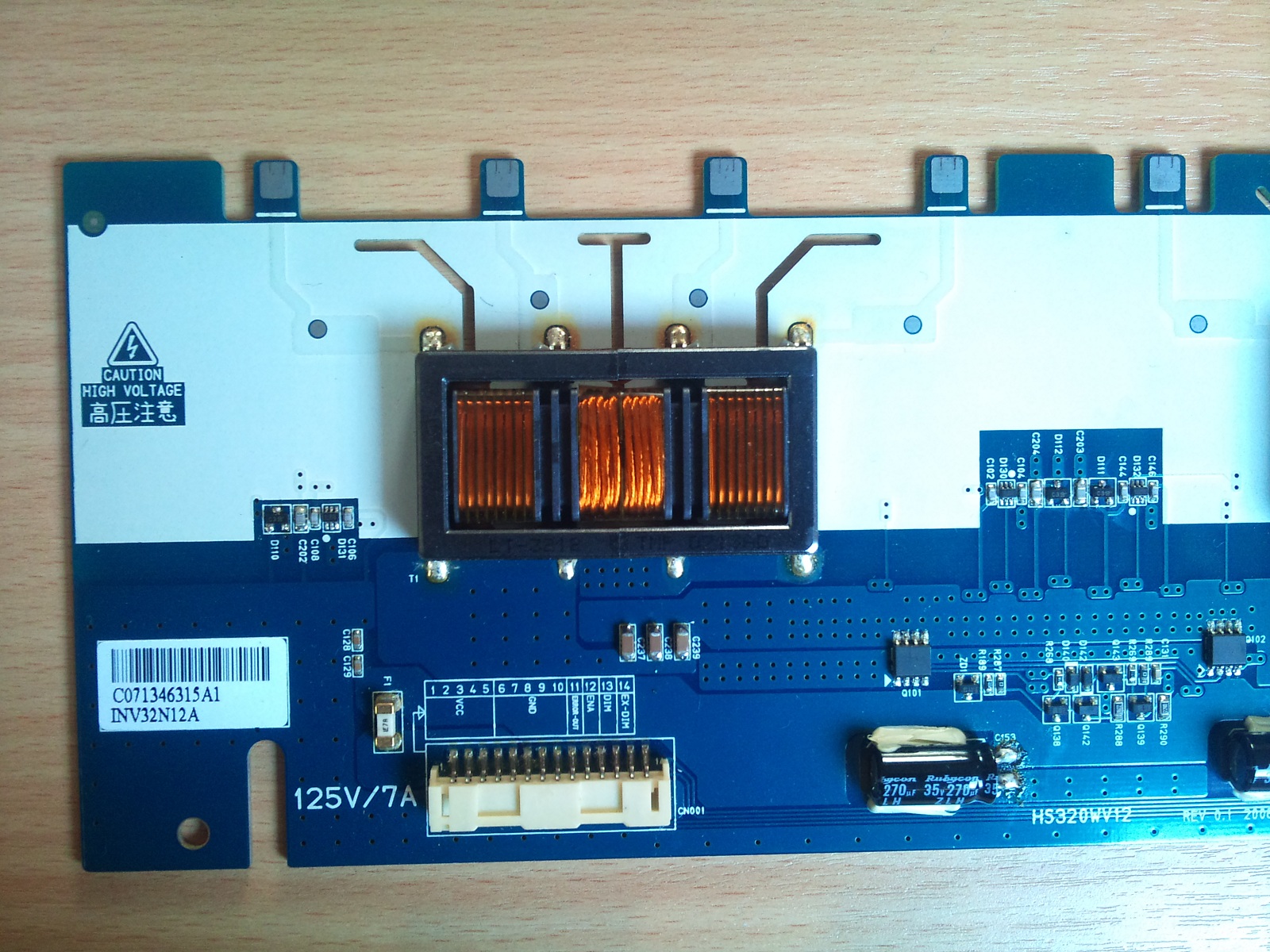

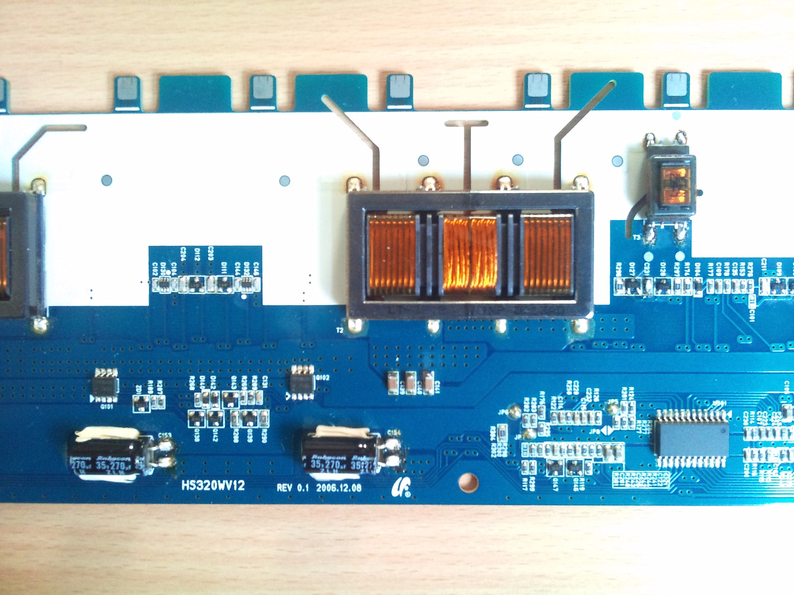

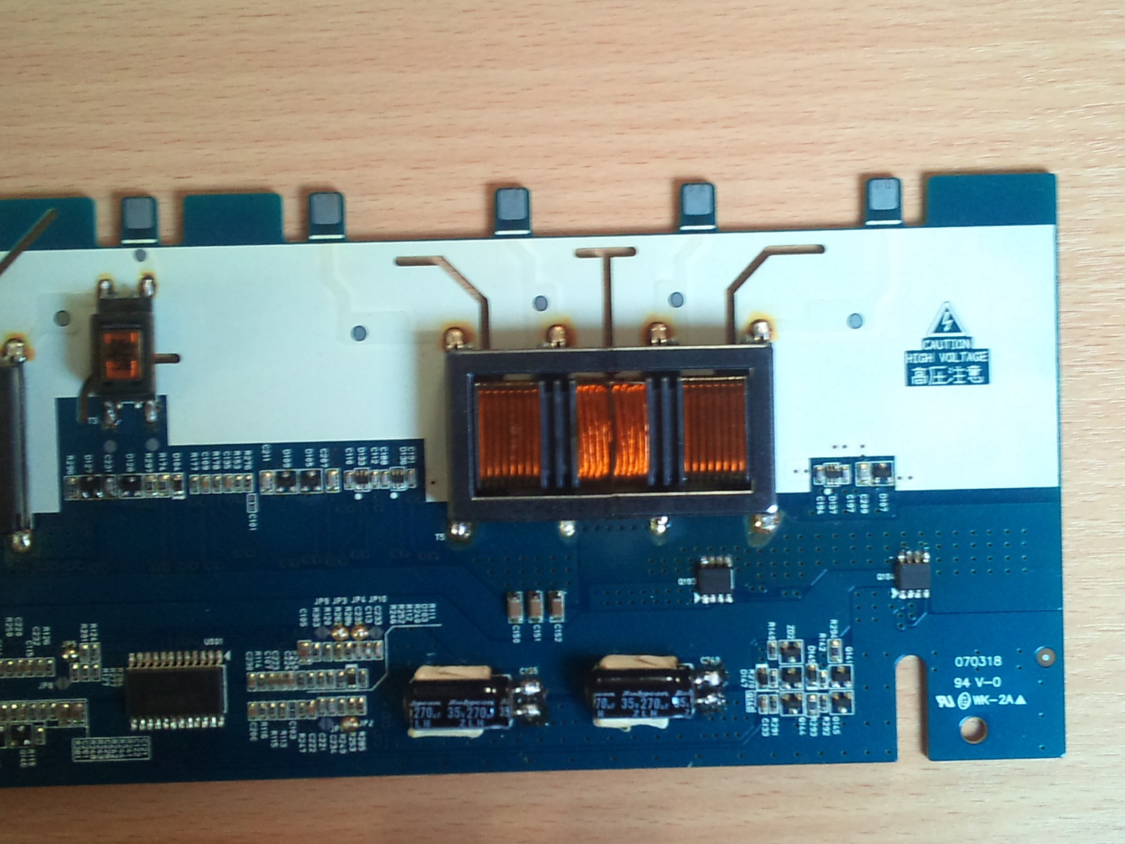

            Here some better pics of the inverter board INV32N12A - HS320WV12
            The transformers are LT-312 (TMP 0713AD), if someone know the value of primary for this kind of transformers.

              You can test and compare the primaries for each of the transformers. They should be pretty close. The secondaries for each of the transformers should be close also in DCR readings.
              • Electronic91
                • Jun 2017
                • 11
                • France/Algeria
                Re: Samsung LE32R86BDX No Backlight
                This is what I did and found around 0.5 ohm, so I was suspicious but it seems to be ok.
                For the secondaries I found the value in the SEM2006 Datasheet (1.25 Kohms) so every transformers is good according my measure.
