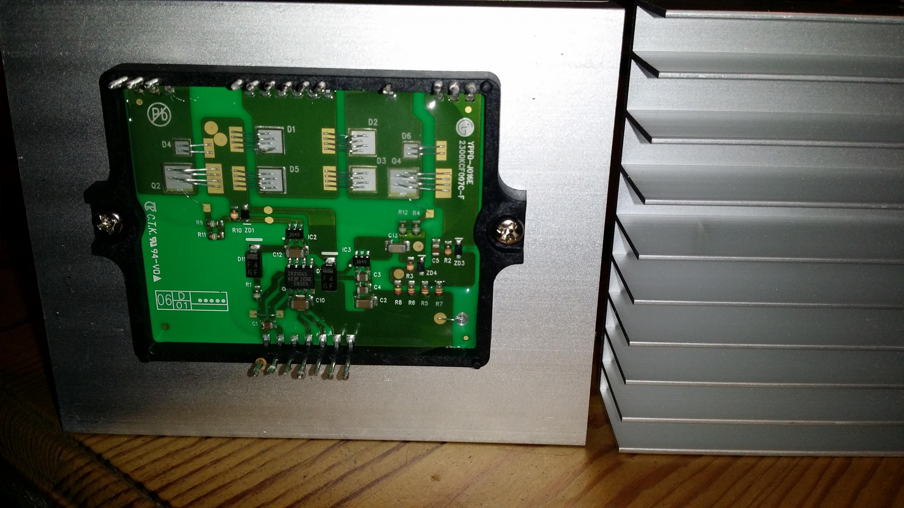

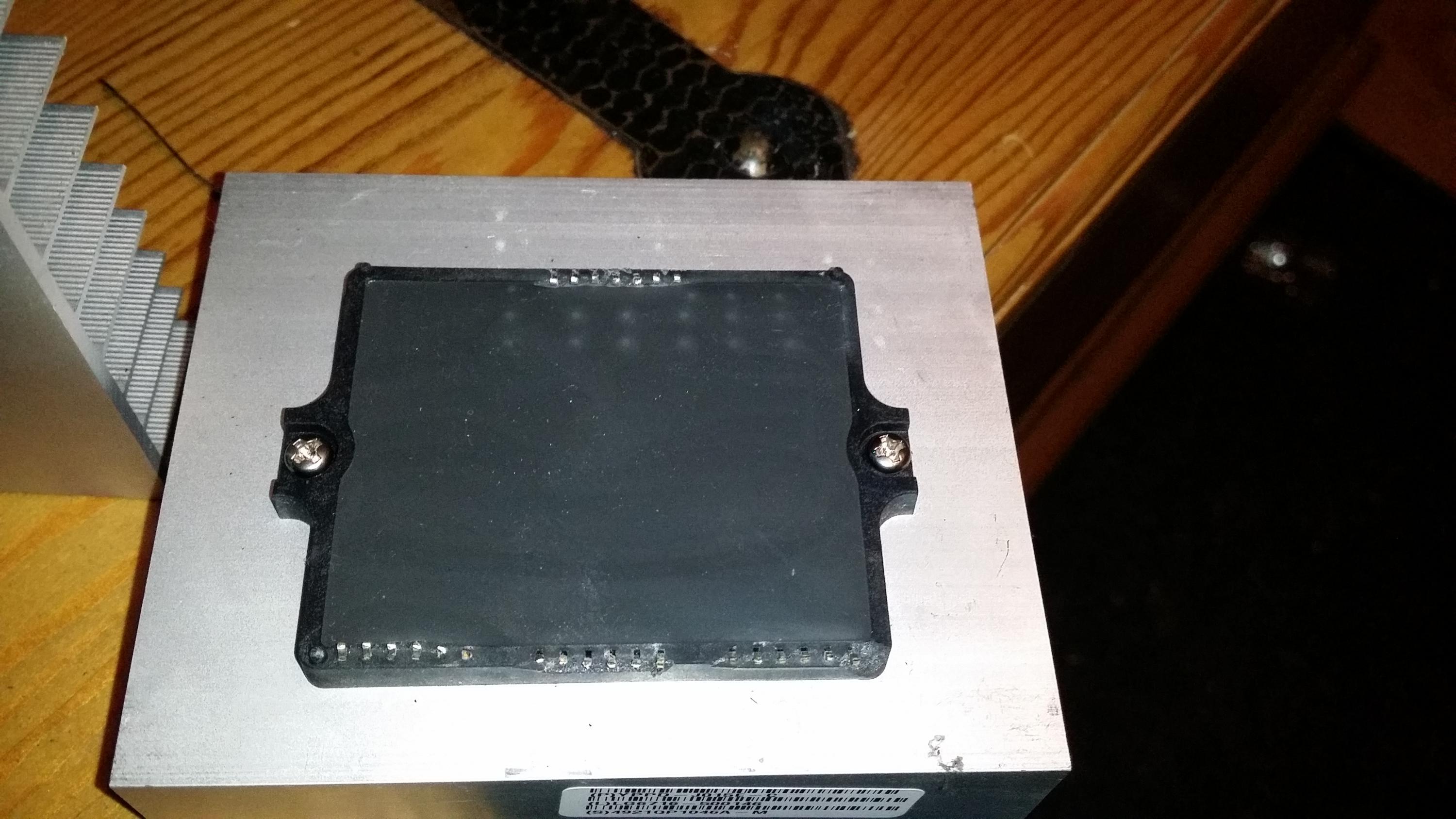

          So are we now talking about the two IPMs on the same board?
          YSUS? One is SUS IPM and one is ER IPM?????
          I have already desoldered them and I noticed that one had more legs then the other, and I do not see inside of the SUS IPM due to black silicone. but the ones I ordered had more legs, but they go to the sam place in the IPM.

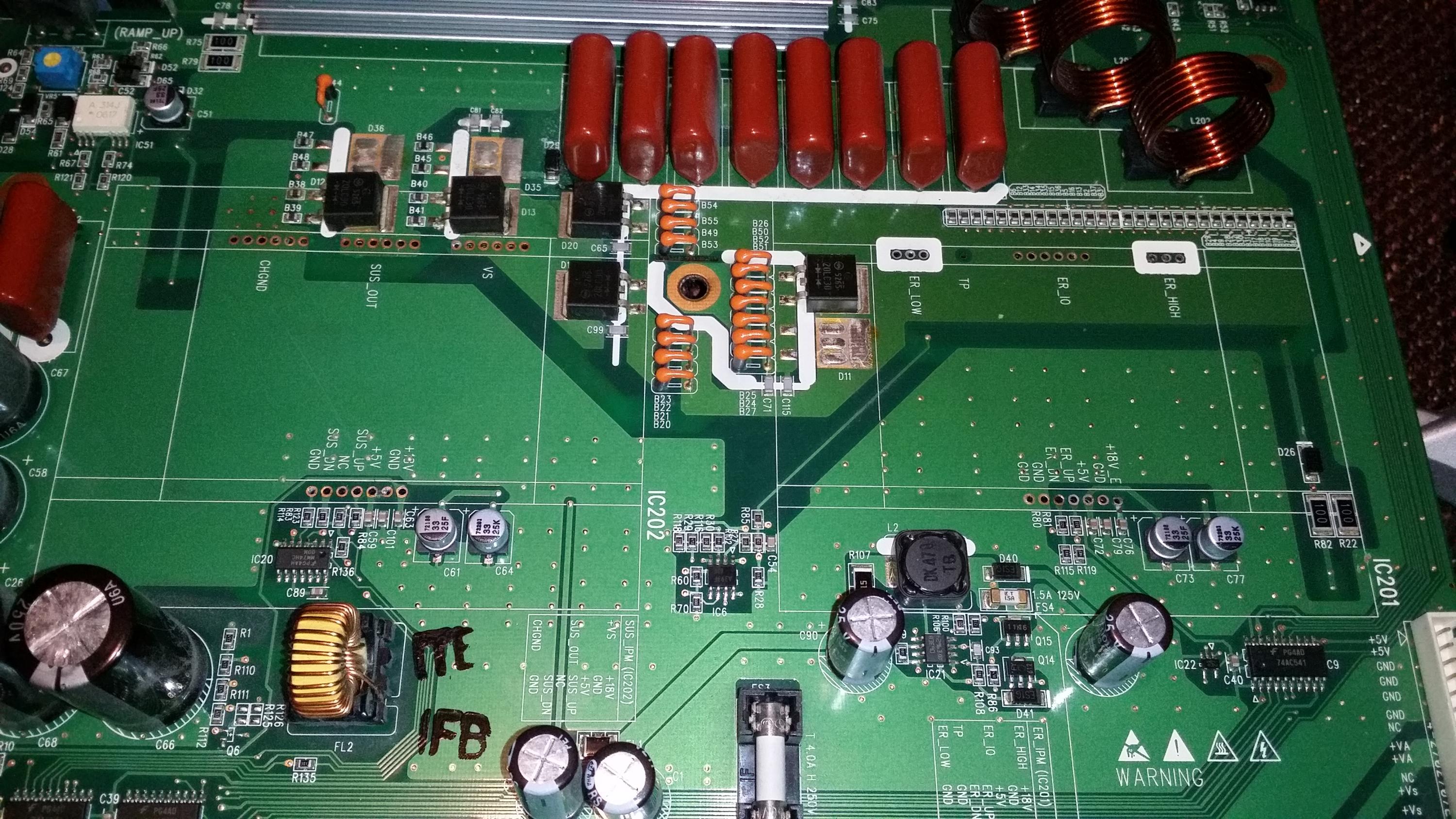

            ahhhh, this is what happens when we don't get pics. most sus boards have 1 ipm but a few do have 2 on each. i would change both that are on y-sus.

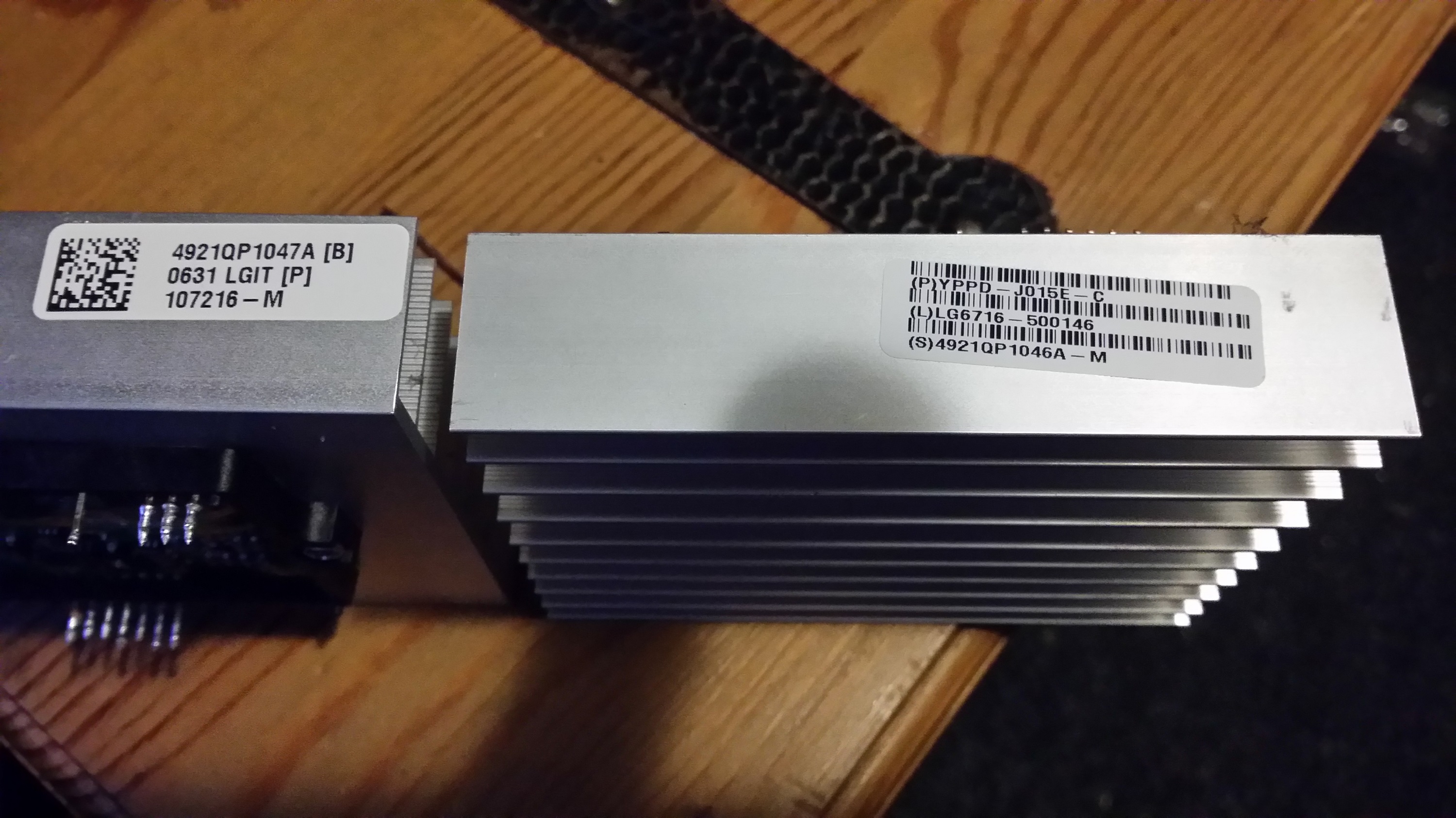

              Here are some photos.
              The left IPM is the one called ER_IPM and the right is the SUS_IPM
              It is black so I do not know if it has the same function.
              You can see the id-number on them
              the ones I bought is called YPPD-J016B and it looks the same as ER_IPM with number YPPD_J016E
                Re: LG 50pc1r-zh Flickering
                so you have the yppd-j016b but you still need the yppd-j015e.
                looks like you used the violent removal technique. :P
                https://www.utsource.net/ic-datashee...E-1756426.html
