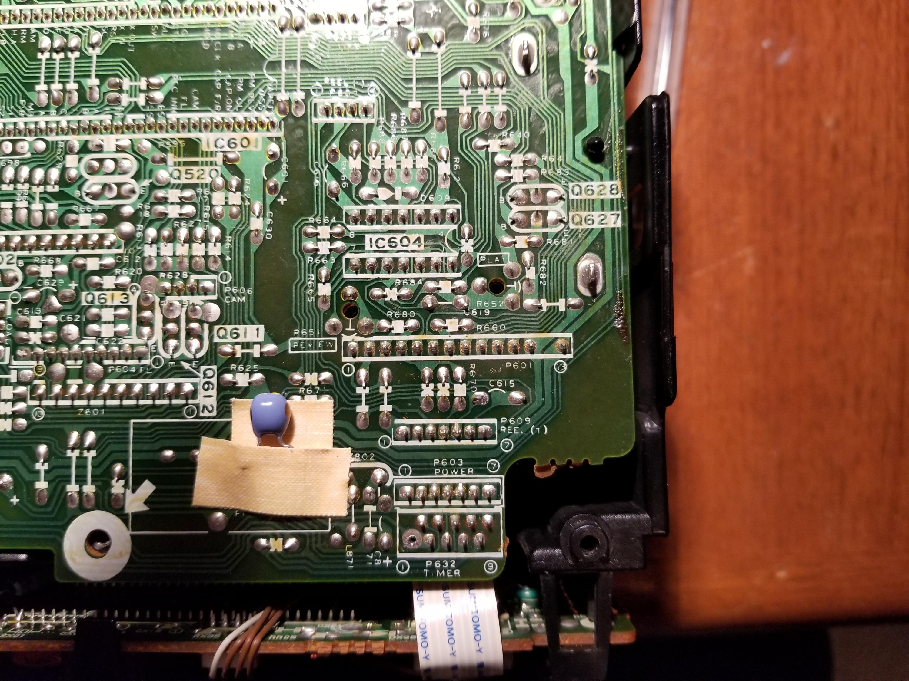

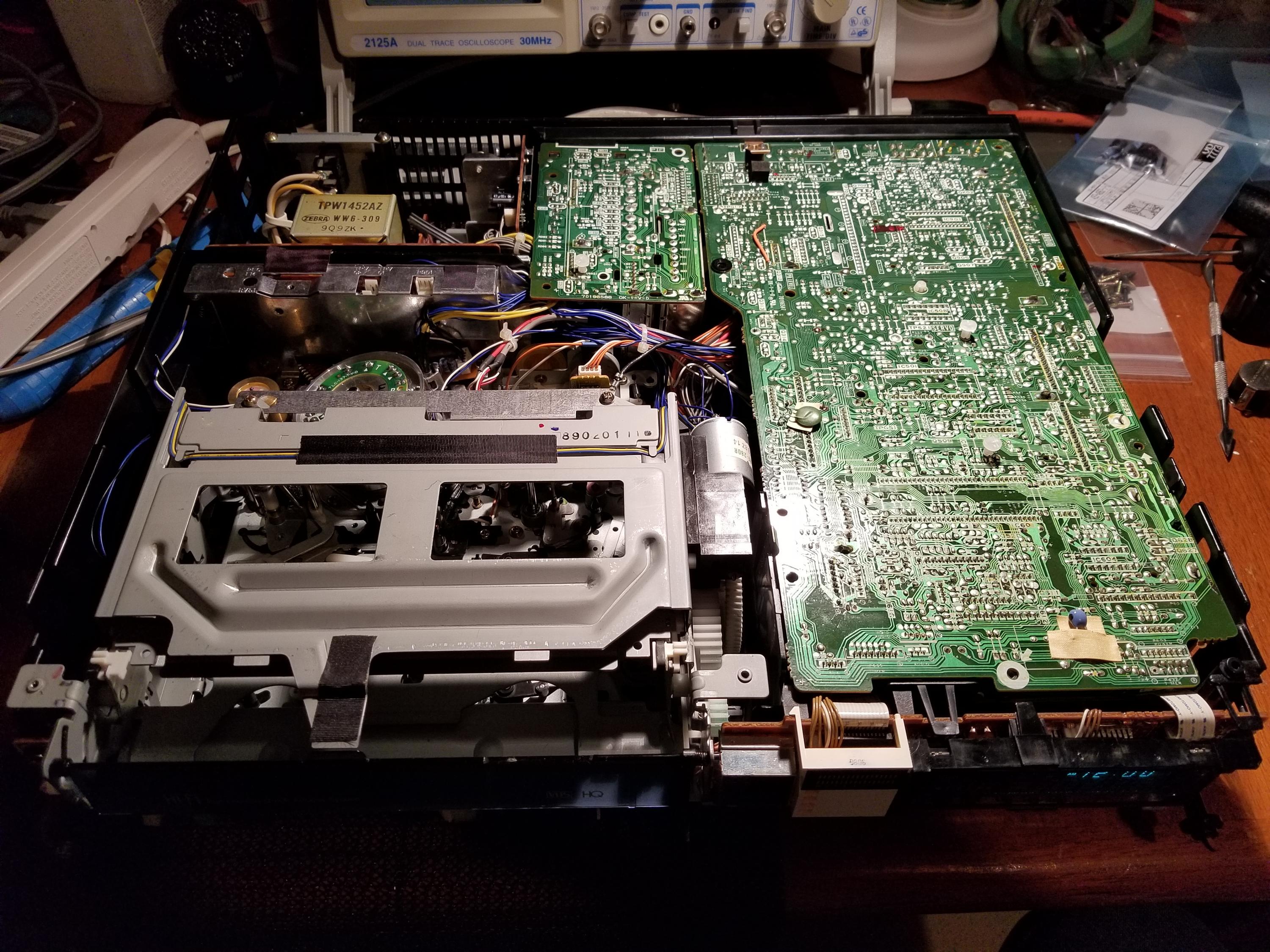

    Hi folks! This my second post on this fine forum. I've been working on an old VCR that was from my childhood. I've been working at it for 2 weeks now, replacing belts and caps.
    I got it to play, but I'm having what I think are some power supply issues. The vacuum fluorescent display is pulsing on the grids that are off. They are coming on and off. Also the picture is pretty bad with hum bars.

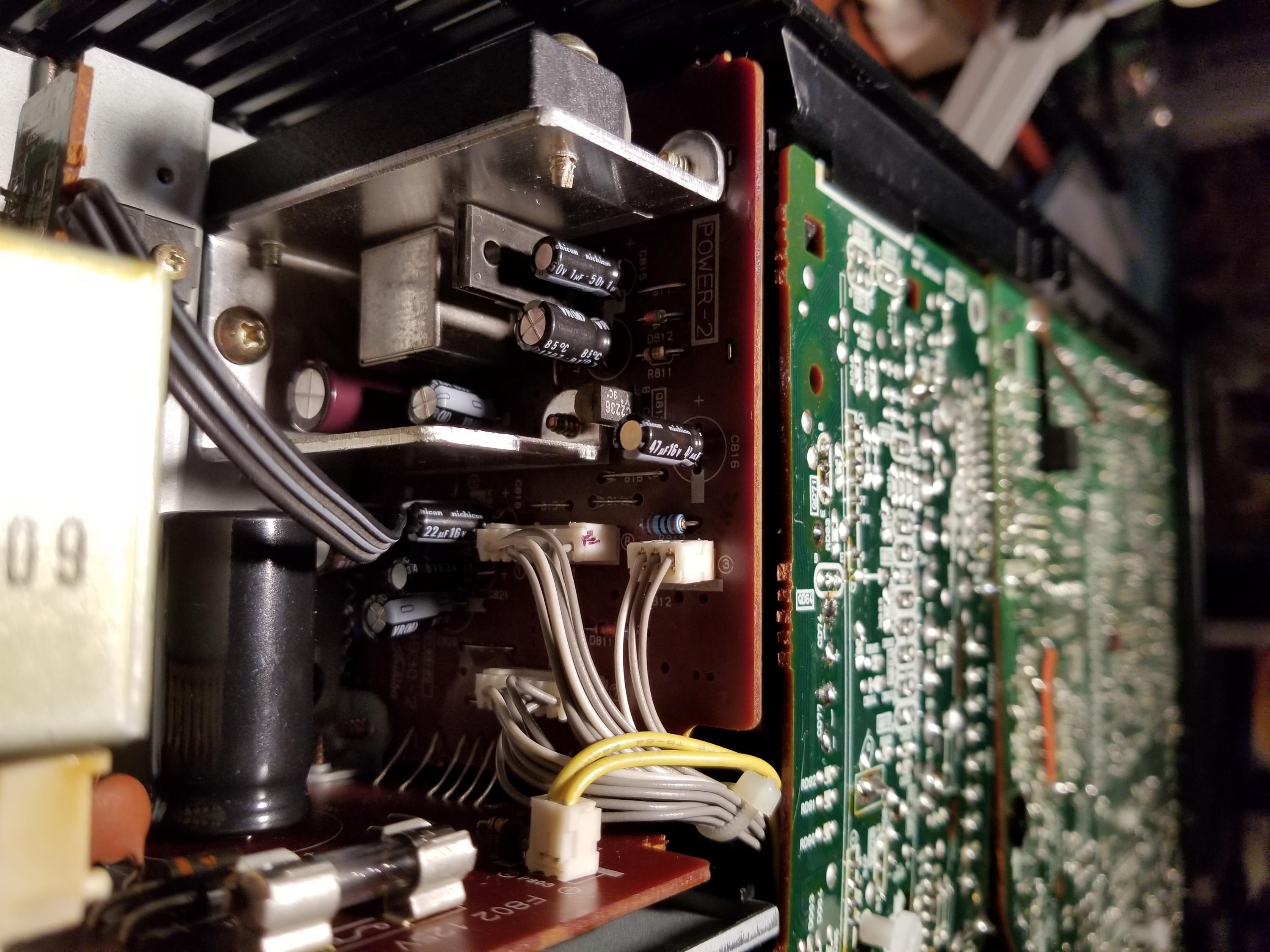

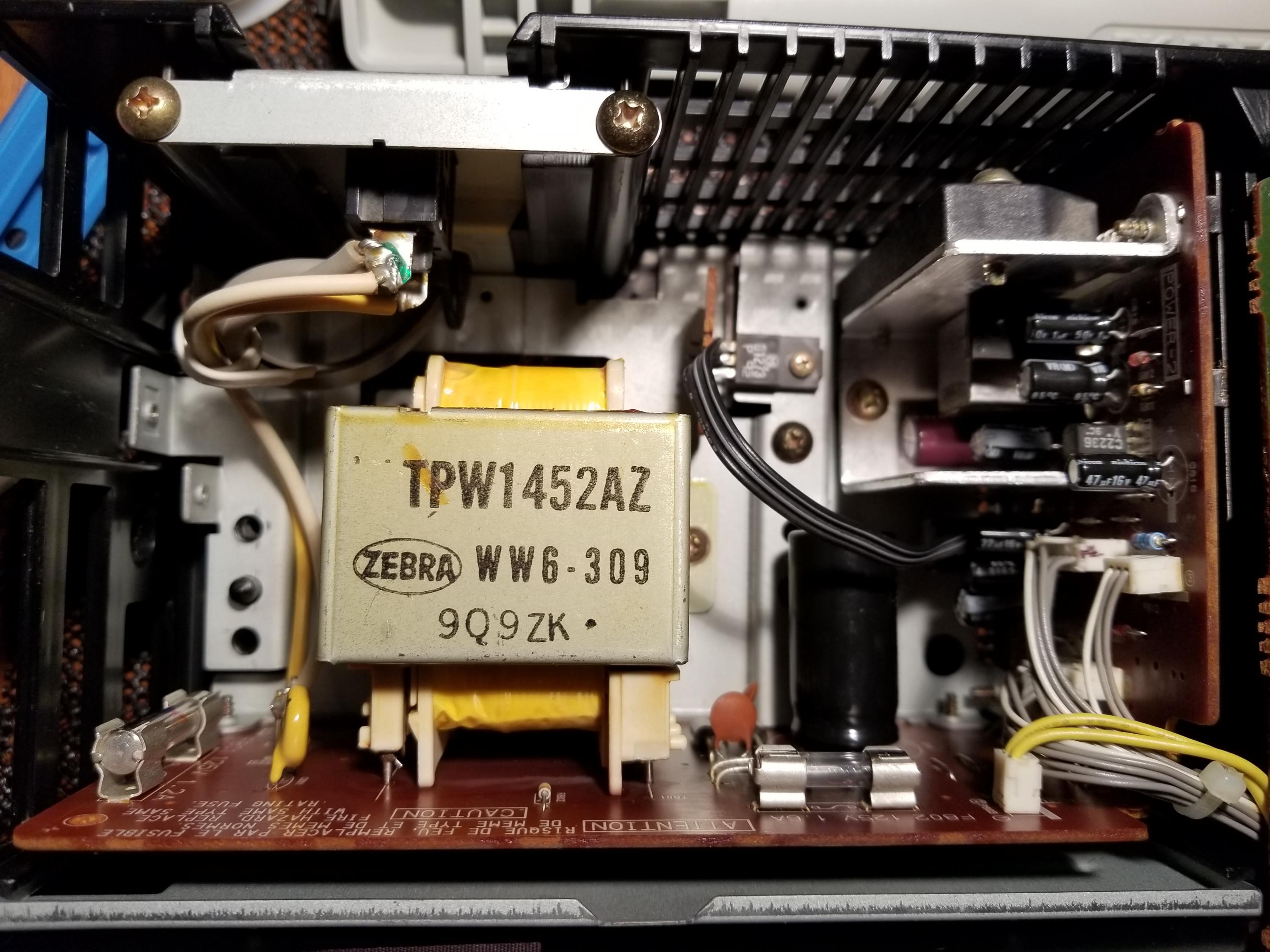

    I've recapped the main power supply with all new nichicon electrolytics but the problem remains. I measured some voltages and the lower voltages seem stable, but the 32 volt rail is jumping around a lot. I measured it with an oscilloscope and some of the rails have as much as 11 Volts peak to peak AC on them, at 60 Hz. The lower voltage rails have something like 4 VAC on them, but they're not sinusoidal waves.
    I can't find the service manual anywhere, I know not many people work on VCR's these days. I'm hoping to get any help I can get with this. I think there's a voltage step up IC somewhere, not sure which one, or how to measure it. Not many of these IC's have data sheets that I can find.

      Hey Dskall, thanks for the reply. Here are some pics and videos.
      https://youtu.be/68BuT-MloW0
      http://vintageelectronics.betamaxcol...delm-9485.html

        Just a thought but with that level of AC and having already changed the capacitors I would think that maybe one of your rectifying diodes may be faulty so I would check all the diodes and bridge rectifiers in the power supply.
        It could also be that one of your supplies is heavily loaded and cannot maintain smoothing of the rectified AC.

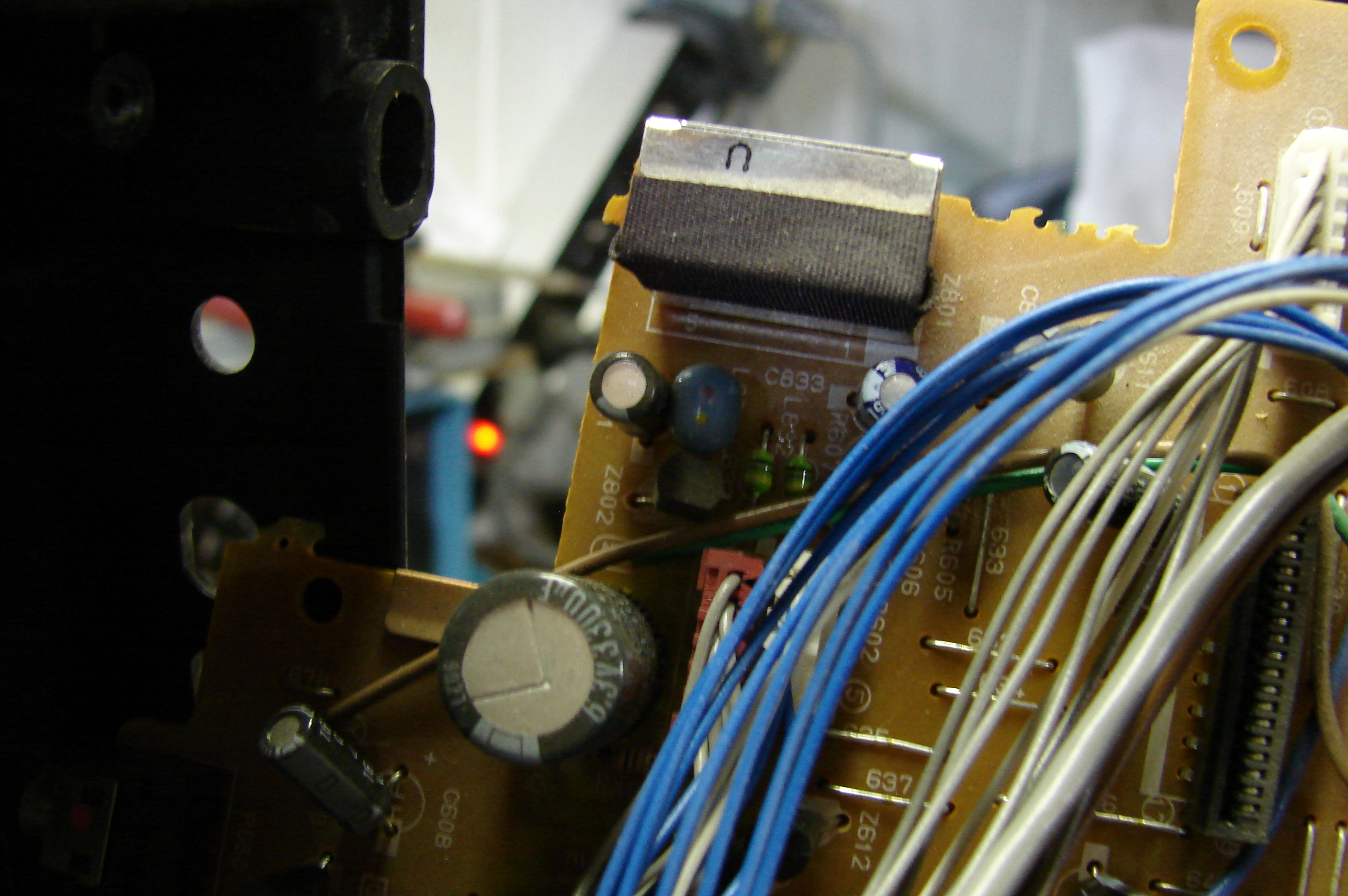

                              So the only problem is low 30 volts for the display?, that usually comes from a small dc-dc converter, usually a couple caps get cooked since its on all the time.
                              On this vcr the dc/dc converter is on the logic/servo board (page 75) It takes the always 6.6 volts and boosts it to 30 volts. You should be able to trace the line back, the converer sometimes looks like a small can 1/2" X 1" and maybe 1/2 inch tall This is for a Toshiba sv-771 I have, the dc/dc converter is in the corner of the board on the botom of the vcr

                                  That 30 volts is low current for the display only, look for that can and there should be a couple caps. next to it, I added a picture of one in my other post

                                      The dc/dc converter is usually its own component and there should be only a couple caps (maybe 100uf) next to it. It should'nt be under any of the shields, maybe post a couple pictures of the boards if you can't identify it. If you are replaceing a lot of capacitors, make sure to check the vcr's operation every so often in case there is a problem that way if there is a new problem you can go back and check what you replaced.

                                        The can I desoldered was from a pcb labled 'power' it has an IC, a lot of transistors and diodes, coils and trim pot. That's where I found a bad 47uF @ 25V it had an ESR of 33 ohms, according to this cheap meter.
                                        There was a 100uF one I replaced too, by another can near by, there's a 10 mH coil bodged onto that can. I'll take a few pictures later on, and test once I get the can back, there's a transistor that uses it as a heat sink.
