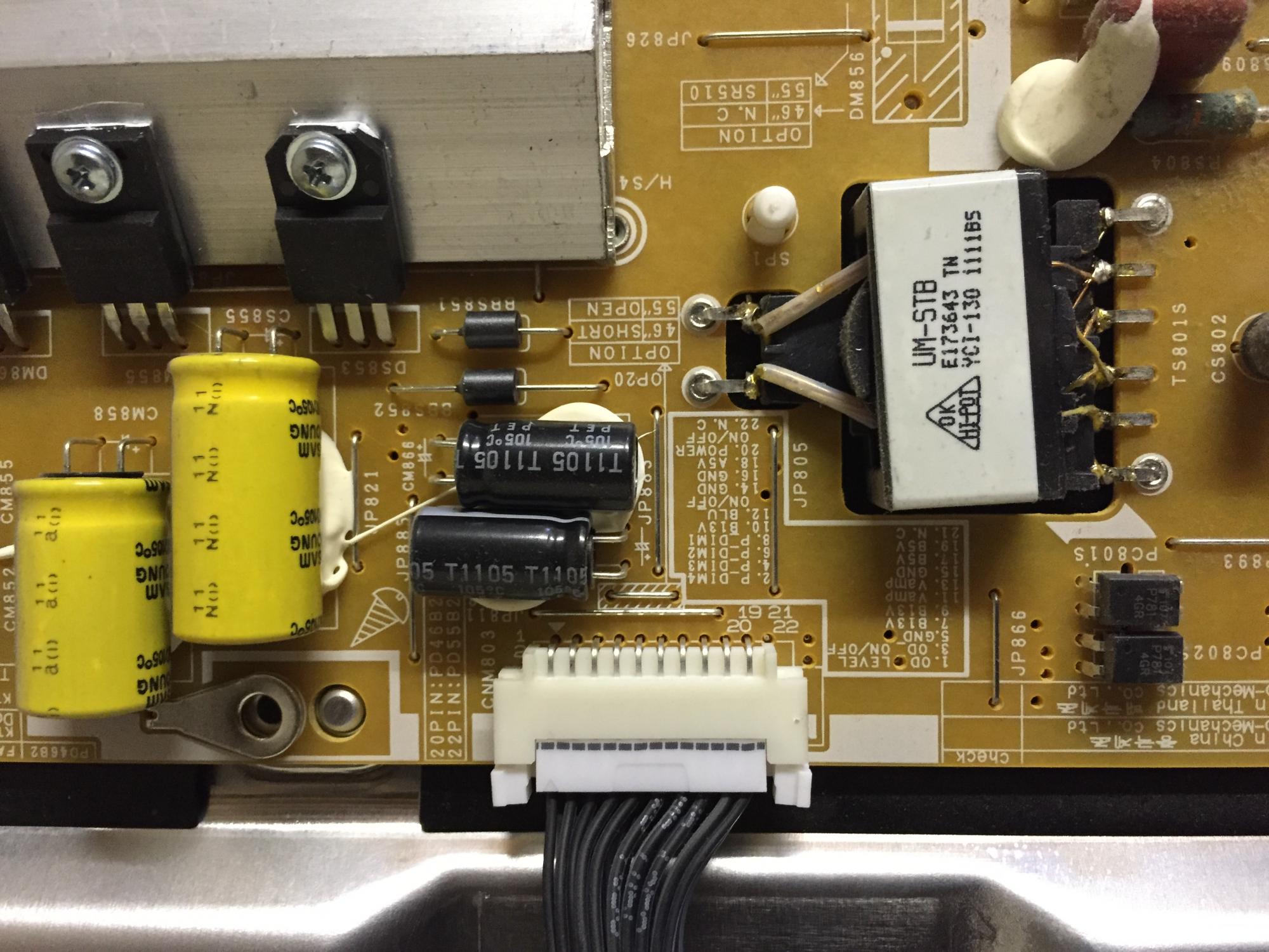

    Need good clear straight on pictures of back of tv with cover off and each board.
    Need voltages from connector that goes from power supply board to main board. Will need pin#- PIN DESCRIPTION -Pin voltage in standby-Pin voltage when pushing power button and picture of connector on power supply board.
    Format:
    Pin# - Pin Description - Pin Voltage standby - Pin voltage power on
    1 - XXXXXXX - XXv - XXXv
    2 - XXXXXXX - XXXv - XXXv
    3 - XXXXXXX - XXXv - XXXv
    4 - etc.

        Hi
        Pin #, reading with backlight on, off, description
        1,, 3.4, 0, od level
        2,, 0.23, 0, p_dim4
        3,, 3.4, 0, Od on/off
        4,, .23, 0, P_dim3
        5,, 0, 0, Gnd
        6,, .23, 0, P_dim2
        7,, 12.7 0, B13v
        8,, .23. 0, P_dim1
        9,, 12.7 0, B13v
        10, 12.7, 0 B13v
        11, 12.7, 0, vamp
        12, 5, 0, BLU on/off
        13, 12.7, 0, vamp
        14, 0, 0, gnd
        15, 0, 0, gnd
        16, 0, 0, gnd
        17, 5.4, 0, b5v
        18, 5.3, 5.3, a5v
        19, 5.4, 0, b5v
        20, 3.3, 0.23, power on/off
        Pictures to follow as to post from phone

                  Could you please remove the cable from the mainboard ( black cable/white connector ) thats going to the power supply.
                  Turn the tv on , does the backlight turn on? You will notice the small round circles on the back of the panel light up.
                  • Astro mike
                    • May 2017
                    • 24
                    • Uk
                    Re: Samsung ue46d6530
                    Removed power cable, afraid there no back light now. Although power supply does click once power connected. No more action afterwards despite several pushes of standby button.

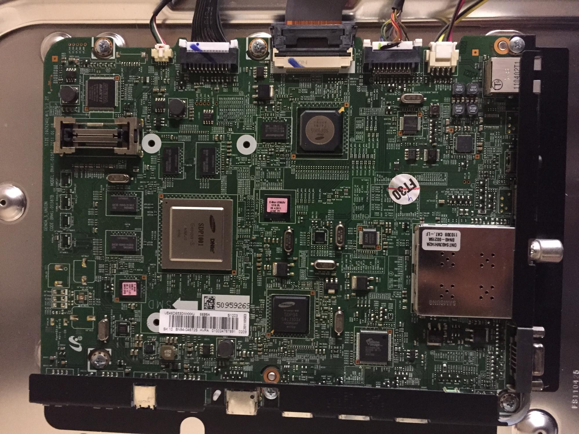

                          Please remove 1 of the ribbon cables from the panel to the T-CON board , thats the small board on picture 2.
                          • Moreno83
                            • Jun 2014
                            • 2008
                            • The Netherlands
                            Please turn off the tv when you are disconnecting the ribbon cables. Start with 1 ribbon cable and turn the tv on , do the same with the other ribbon cable.
                            Looks like you got a short between panel and T-con.

                              Hi, I'm sorry, is the t-con board the small one with only one ribbon cable plz.
                              • Astro mike
                                • May 2017
                                • 24
                                • Uk
                                Ok, disconnected biggest ribbon from smallest board, assume t-con, to the I assume video board. Powers up, back light comes on, no more white line across screen. So screen looks better but no graphics. I have nothing connected to to so unable to tell if anything is working.

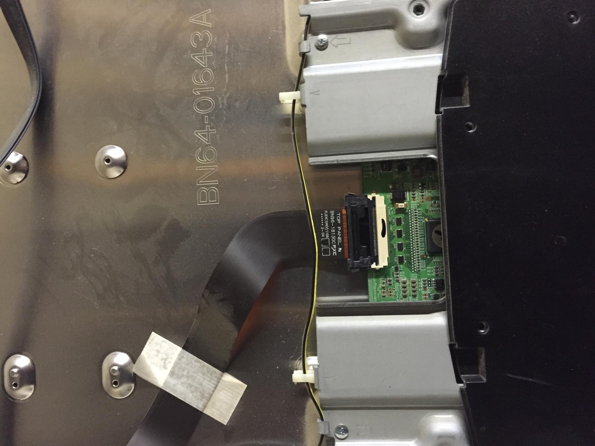

                                    No no , thats is the wrong cable! It won't turn on if you are disconnecting that cable.
                                    The T-CON board is the board on either the TOP or BOTTOM of the tv ( Differs per tv ). A big lvds cable connects the mainboard with the t-con , leave that cable where it is.
                                    On the other side of the T-con there are 2 small ribbon cables that are going to the lcd panel. Try to remove 1 of these ribbon cables and see if you get a picture.
                                    IT looks like this :
                                    http://oi63.tinypic.com/68t3zp.jpg
                                    • Astro mike
                                      • May 2017
                                      • 24
                                      • Uk
                                      Ok, I'm assuming it's the one at the bottom then that's buried under plastic mostly. With the biggest cable running to it. From this I'm guessing there are two or more other cables from that to the screen that I just can't see. Better get my spade out. Thx. 5 mins

                                        Would be nice to have picture of whole back of tv. Looks like t-con is at bottom of tv. You will need to remove covers to expose t-con board and the two ribbon cables.
