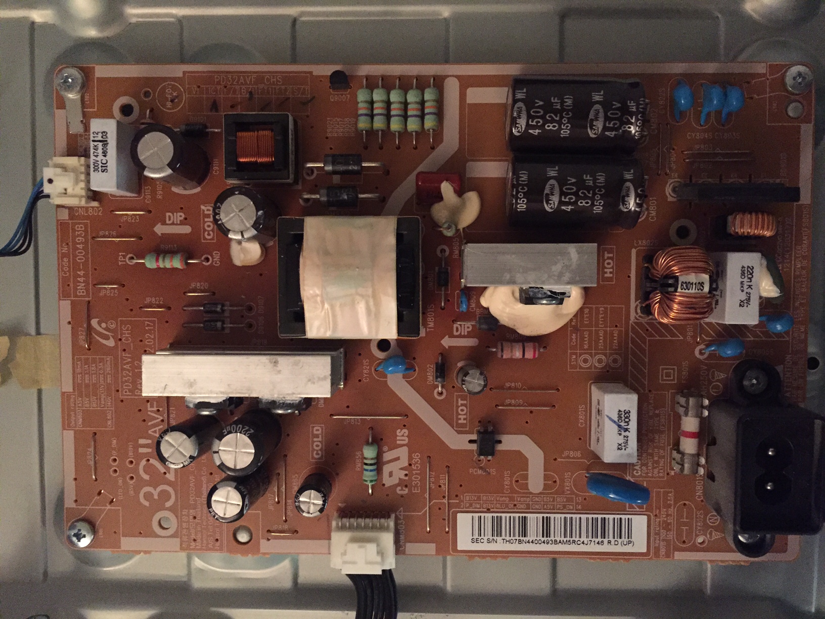

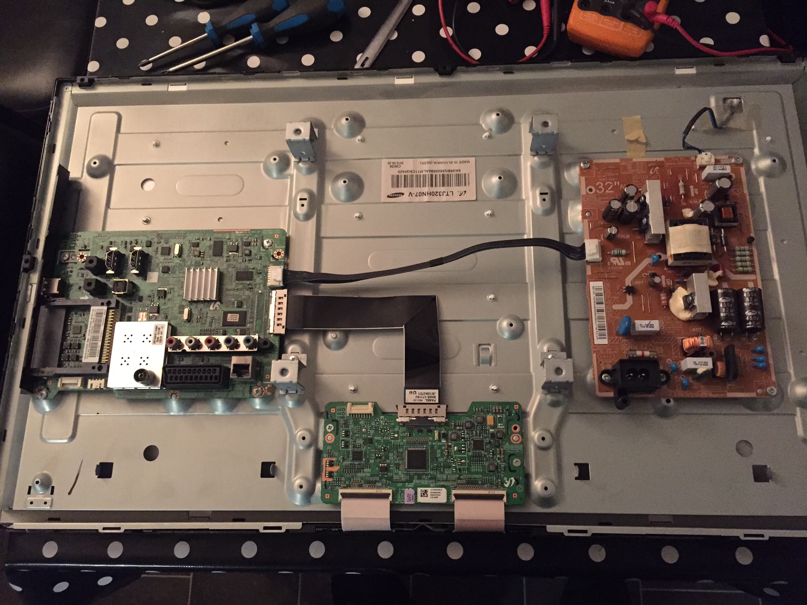

    got this tv last week, as not working, thats all i was told, anyway, pluged it in today to see what the problem is, and it is working apart from the backlights (LED's).
    tv turns on with pic on screen with flash light, so only backlight problem,
    no brief flash at all.
    power board BN44-00493B, only getting 3 volts from the board to the LED plug.
    all led's test ok, but only just glowing with 3volts on each, so must use much more voltage when running,
    think i'll get a board of ebay, and do it the easy way, lol, have'nt realy got the time to mess about with this one unless someone has had the same prob with same model,

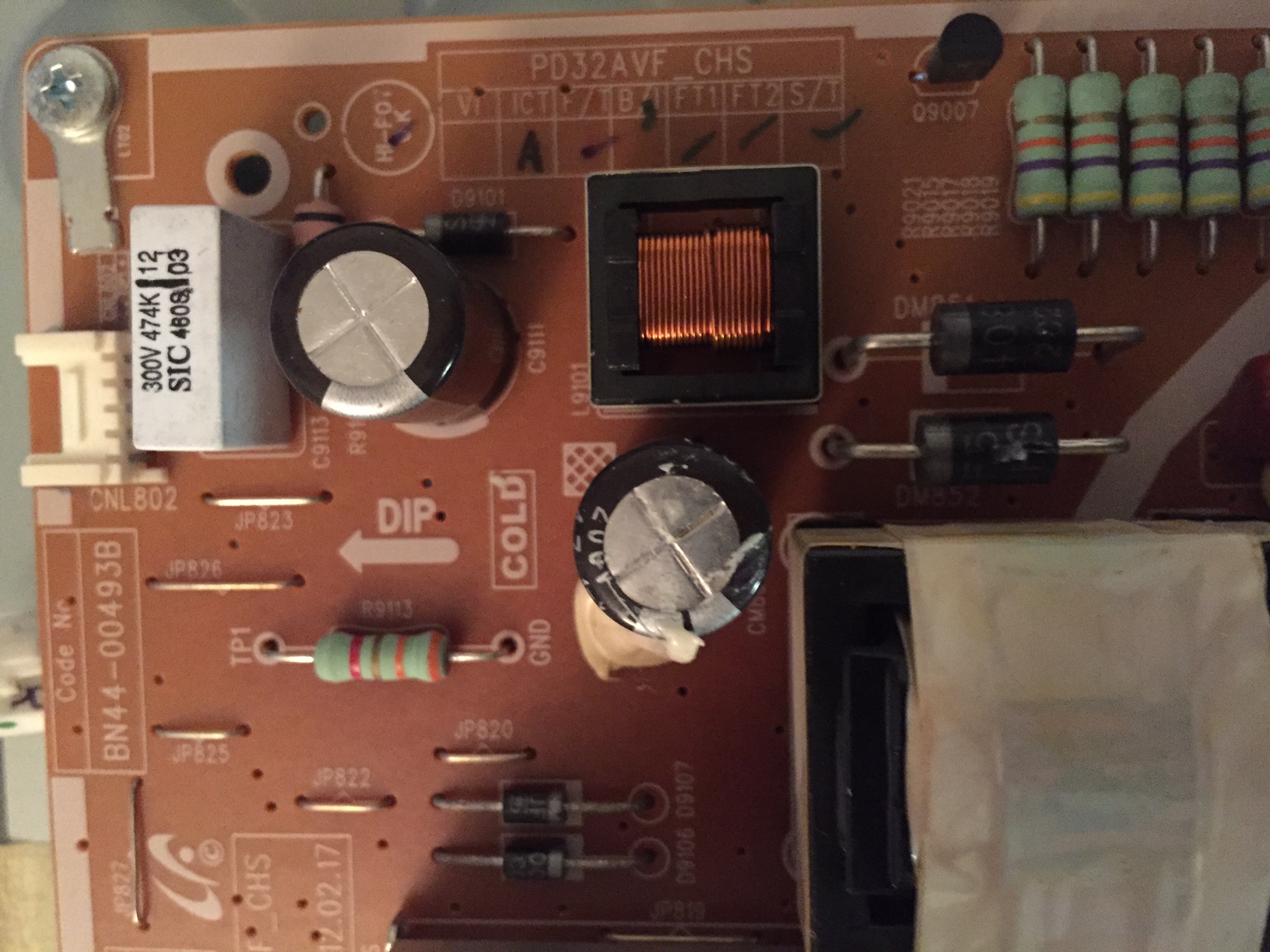

            Problem solved, 3rd picture shows 2 caps, one looks good, but the other looks kind of ok,
            its still flat on top but looks bowed, took it out of circuit to test, and its shit, replaced with another 47uf 200v and bingo, tv now up and running,

              GREAT JOB!!!...I looked at that cap but said Nah... maybe just a shadow or something.
              Wish I could get an easy fix like that..
