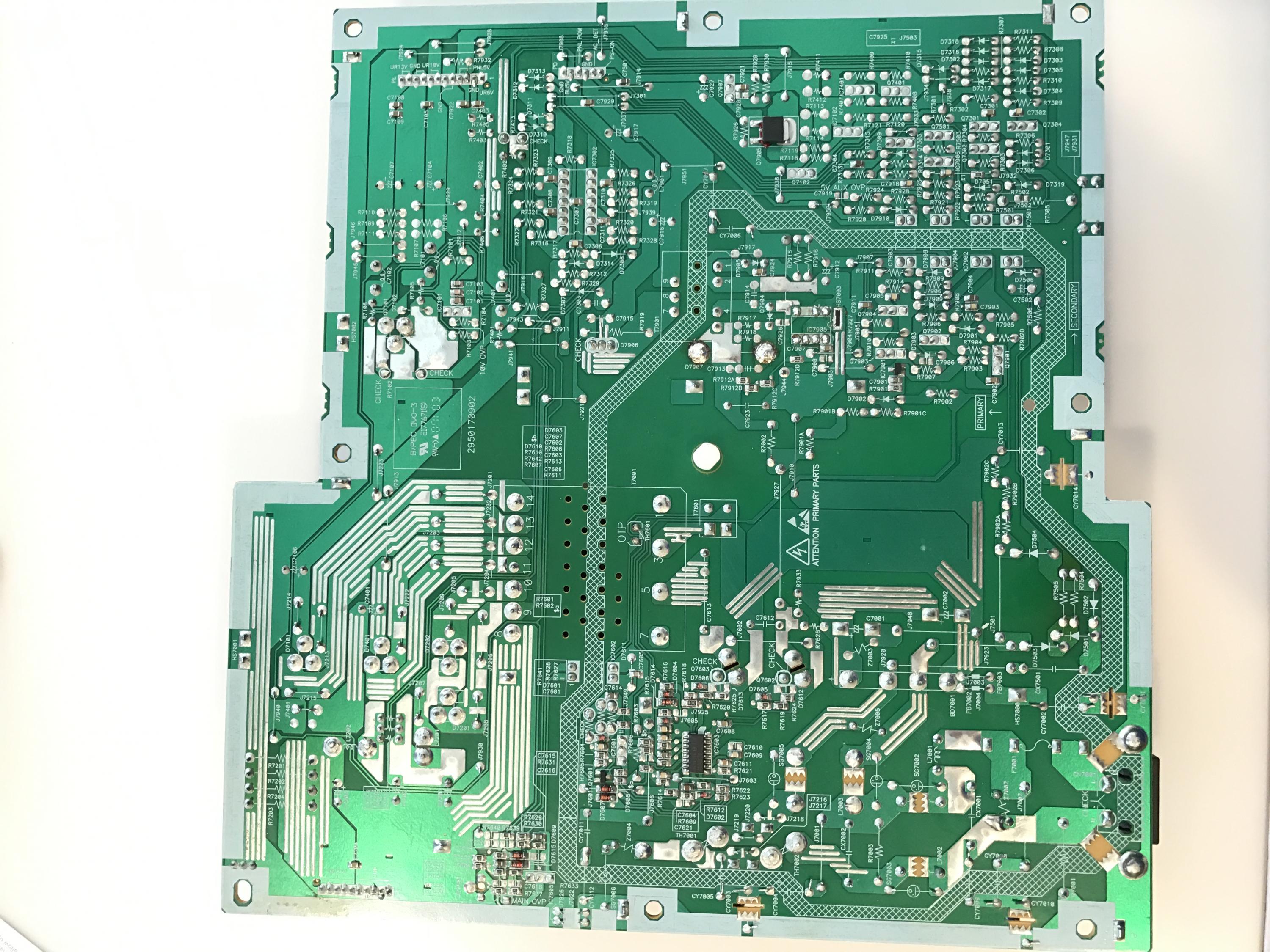

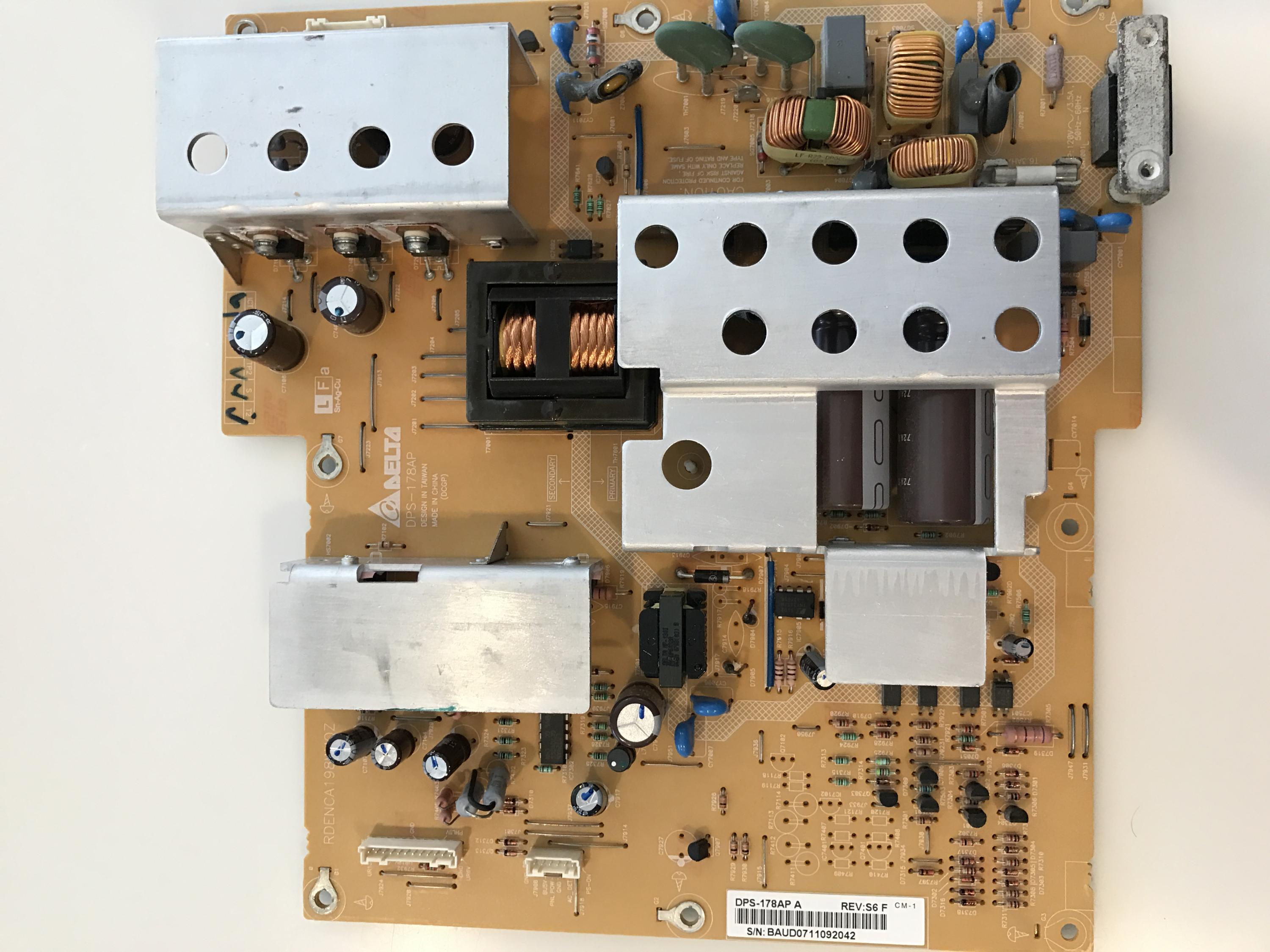

    Sharp lc-c32d42u no standby
    Hi. I have no standby on this power supply in a sharp lc-32d42u. I found D7907 (1N5383B) shorted, so I replaced that and IC7905 (TNY268PN). I have 160vdc on the drain pin of the IC, 0vdc on the source, and 2.2vdc on the EN pin of the IC. I thought maybe the first replacement IC was a bad part, but trying a second one didn't help--still 0v on the 5vdc standby output.
    What else should I be checking?

      Re: Sharp lc-c32d42u no standby
      Thanks. I saw that thread too. I checked D7908 and the other diodes near the photocouplers and they were ok. There could be other problems in that area--I'm not too sure how the photocoupler setup on the secondary side is supposed to work to feedback to the smps IC.
        So D7908 & D7907 both checked out OK.
        What dc voltage do you have between pins 1 & 3
        With the power to the set off what is the resistance of TNY268 between pins 5 and pin 8?
          Yes those diodes checked out ok. I have 3.53vdc between pins 1 and 3 and 4.24kohms between 5 and 8.
              Thanks for your help. I got it working. Looked more carefully and found R7902D open. Replaced that and 5v standby is back and the tv is working.
