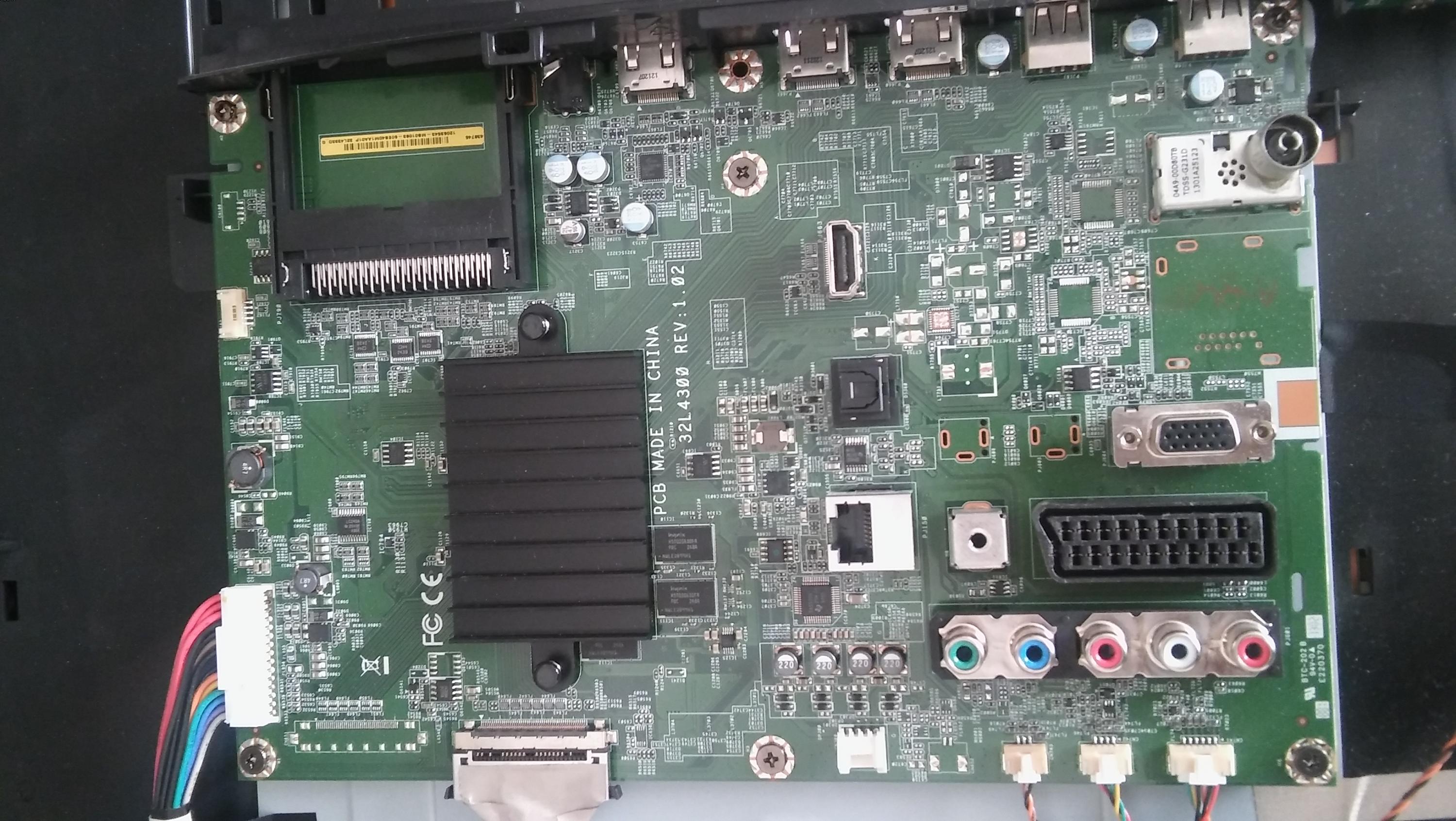

    Hello guys,
    I have a.m. TV trying to find out what is wrong. I am pretty amateur in electronics so I appreciate any help.
    When connected to the AC, powers up straight away instead of going into standby (light on TV goes green straight away), displays the TOSHIBA logo then goes off, then backlight turns off for a sec and then stays on forever showing nothing and TV won't obey neither remote control nor buttons at the sides. So only way to shut it off is pull the plug.

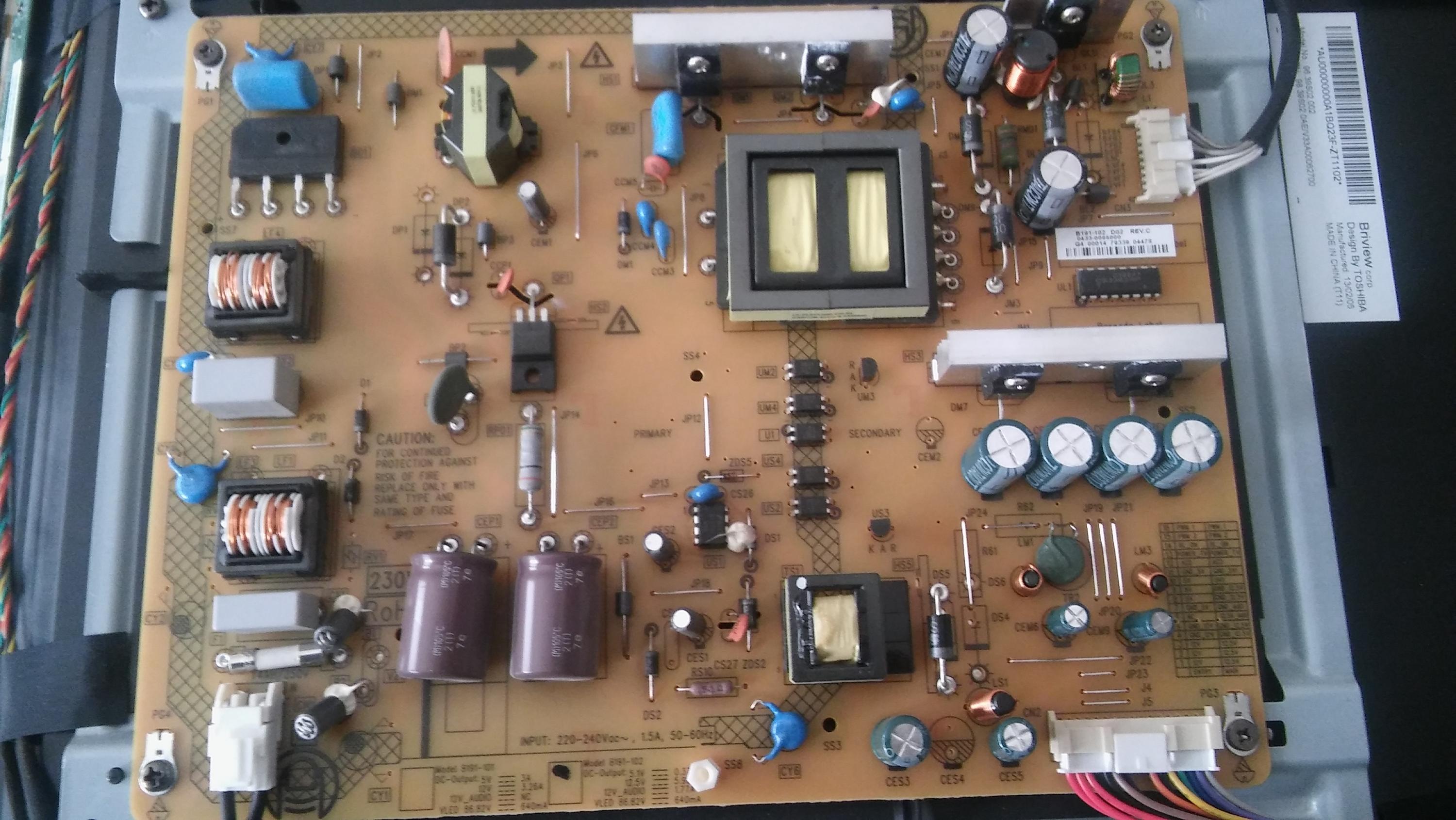

    Now, since I couldn't take the whole TV with me, I pulled out the power supply board. When plugged in power, I measured the outputs that go to the main board and saw only on the 10th pin voltage, jumping from 5.01 to 5.02
    I don't know if the readings are false because the main board is disconnected.
    All caps show in good physical condition. CEM3 to CEM8 show no voltage at the multimeter same as upper right CEM7 and CEL2.
    Any advice where to go next?

    With the power supply isolated from the main board connect CN2 pin 13 (PWR_ON) to pin 10 (5VS) using a 1K resistor and see if the other voltages come up. They should according to what you have said in post #1

      Hello again. Dick_barton thx for your advise, I just preferred to take the whole TV...finally to get things going. So at last hooked TV altogether again and I have these suspicious readings on the multimeter.
      PWM1= 0,47V
      PWM2= 3,28V
      BL_ON= 3,33V
      POWER_TV= 3,25V
      The rest voltages are pins 1,2,3,6= 12,17V
      pin 10= 5,02V

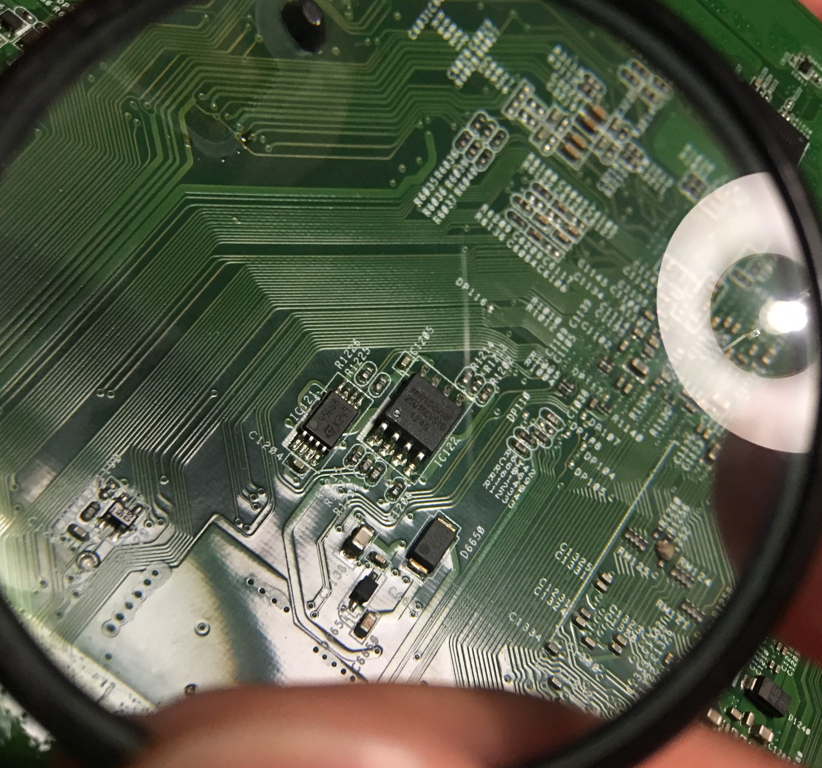

          So, trying a firmware update didn't really do sth. I have the same things going on, only that now the toshiba logo doesn't flash.
          Trying to get a little deeper, I figured out the PSU is actually fine. The voltages are correct just before some little diodes, so it must be sth wrong with the mainboard.

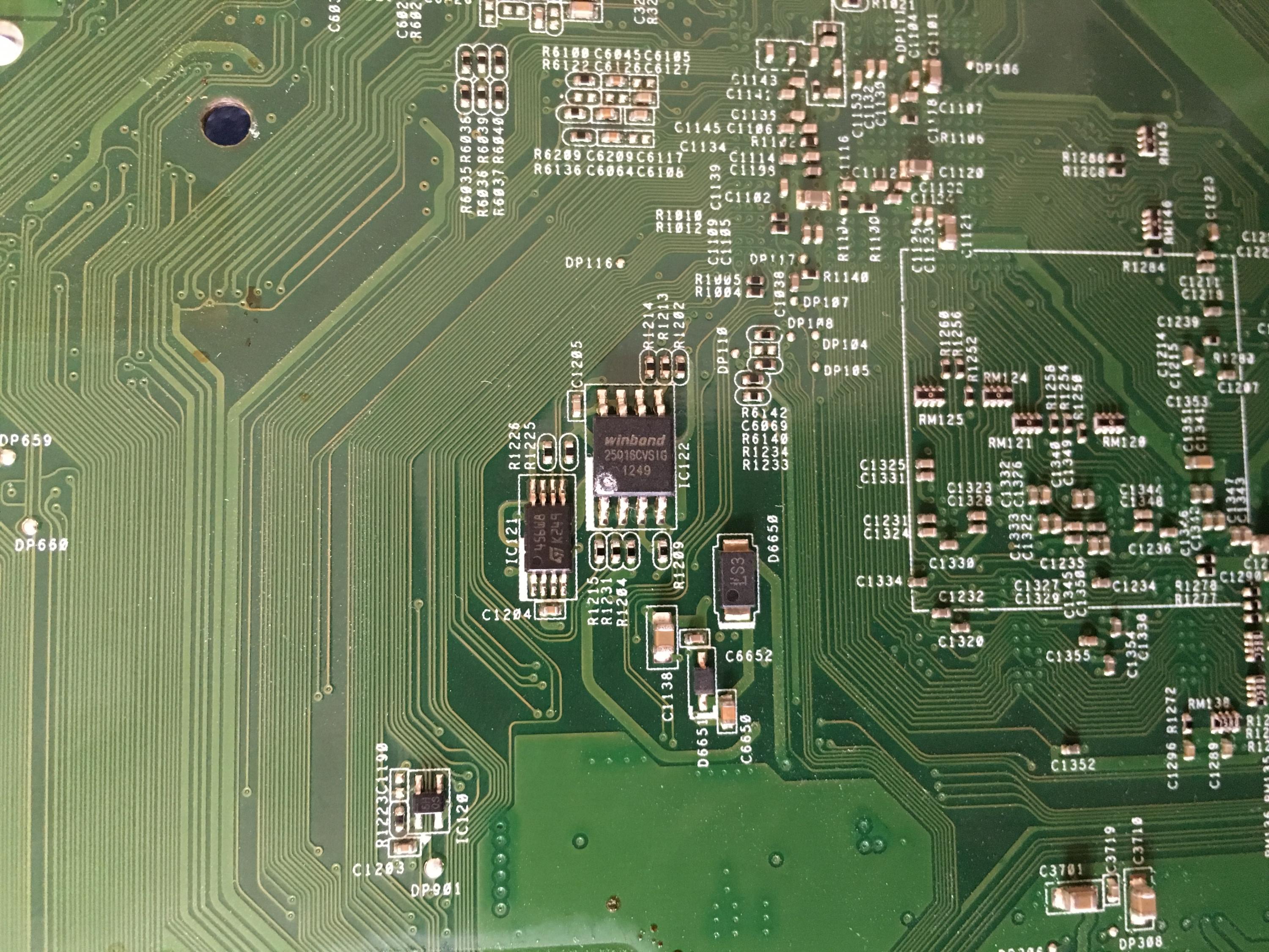

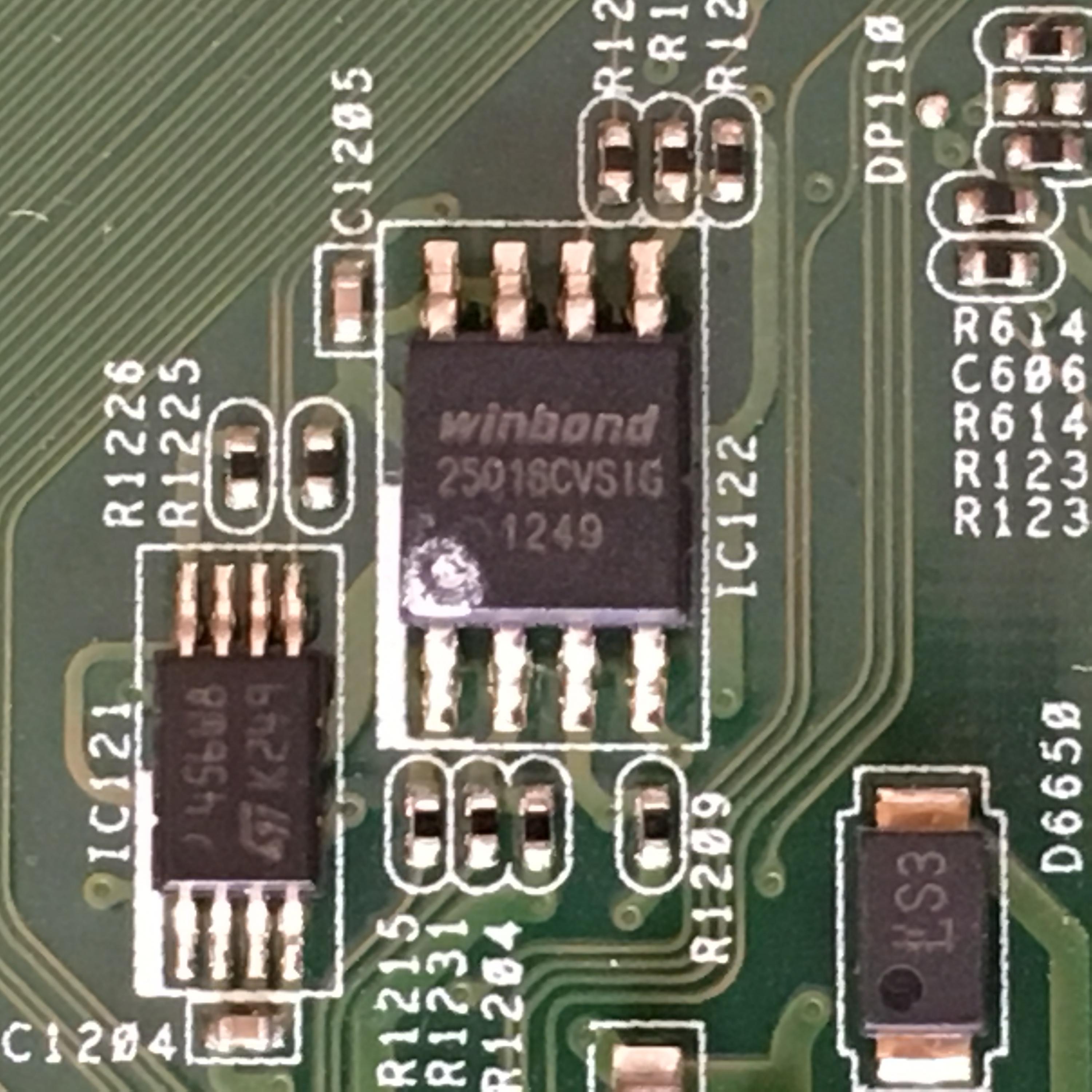

          Trying to physically inspect, I see this component IC122, Winbond 25Q16 (EEPROM?) maybe is broken and leaked?
          In the last picture I scratched a bit the white stuff on it and seems like a hole.

            That indent on the ic is too just identify pin one so the ic is probably fine but it does sound like a firmware issue still

              As vinceroger69 says that's just the EEPROM identification of pin 1.
              Power_On, CN2 pin 13 should go to 0V when in standby and also BL_ON_OFF CN2 pin 14 should also go to 0V when in standby.
              If they don't then it would appear to be a mainboard fault or an EEPROM problem.

                Yes, I understand it's for identification but the white stuff around it got me thinking. Anyway checked it with the multimeter and all fine there.
                Dick you are right. I went through the whole motherboard again with the M/M, and afterall that IC was fine. Where I found a short was in the EEPROM 24C256BN, (IC610). I was like "here you are" but removing and checking it, it was actually fine. What was shorting was a small capacitor near it, like a bad soldering or sth. I don't know if some technician looked through it before I got the TV.
                So... after soldering the IC back and cleaning the short to the little cap, I gave some more tries... but still same things. LED light goes immediately green, and only backlights flash. No buttons, no remote. Tried updating (which I find hard to apply when buttons don't work) nothing. And the voltages are still the same.. Gave it a few cycles of power on/off, nothing. Can it be that this EEPROM needs replacement?

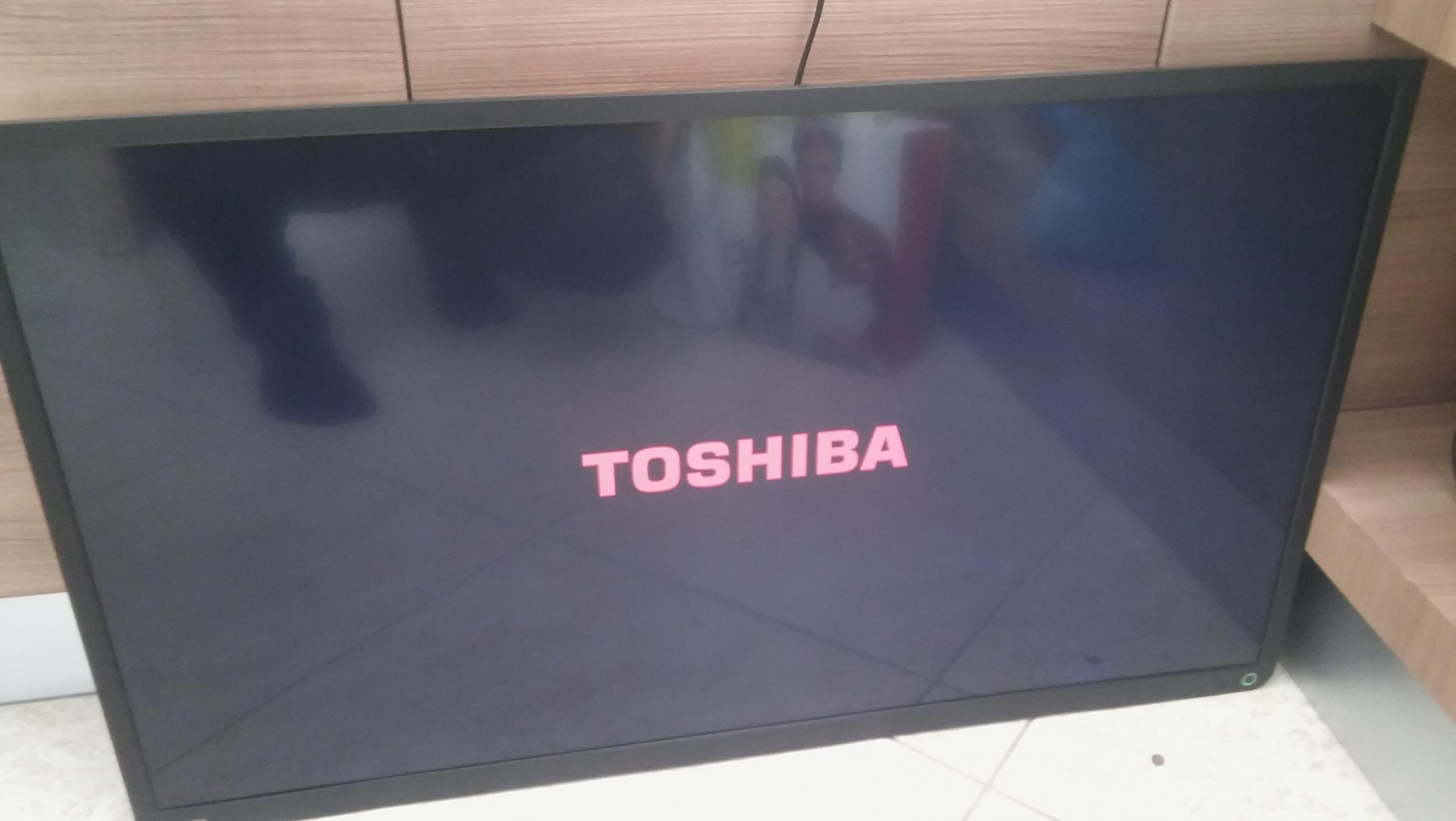

                                You can all say I told you so! :P It was afterall a firmware issue, at least to a point. Pretty unbelievable but with a different USB drive it worked! It was listed in the download instructions but I didn't give much notice. So, the TV LED flashed for 3-4 minutes and then stopped so I guess it was done and now at least the power button on the side works.
                                However in the whole procedure of the firmware update I didn't have and still don't have a picture. Neither the TOSHIBA logo flashes at start

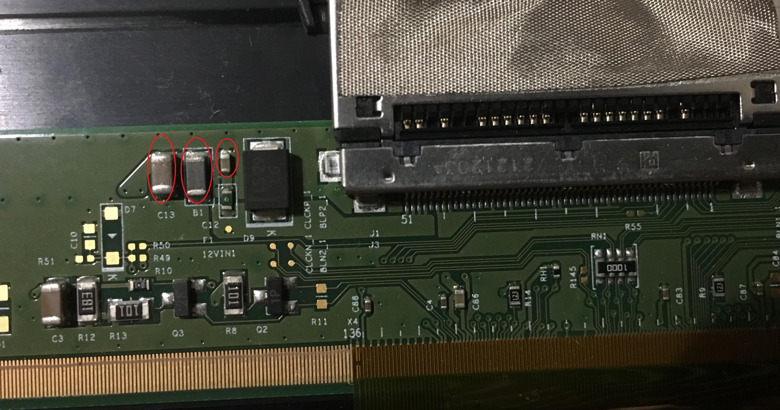

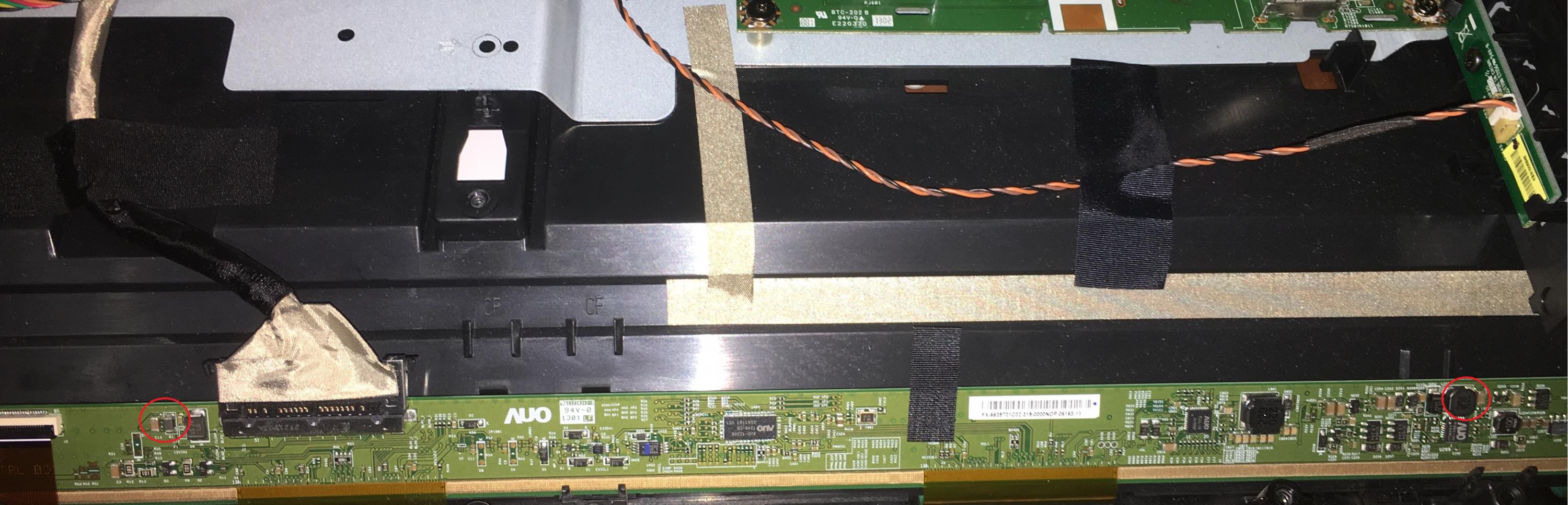

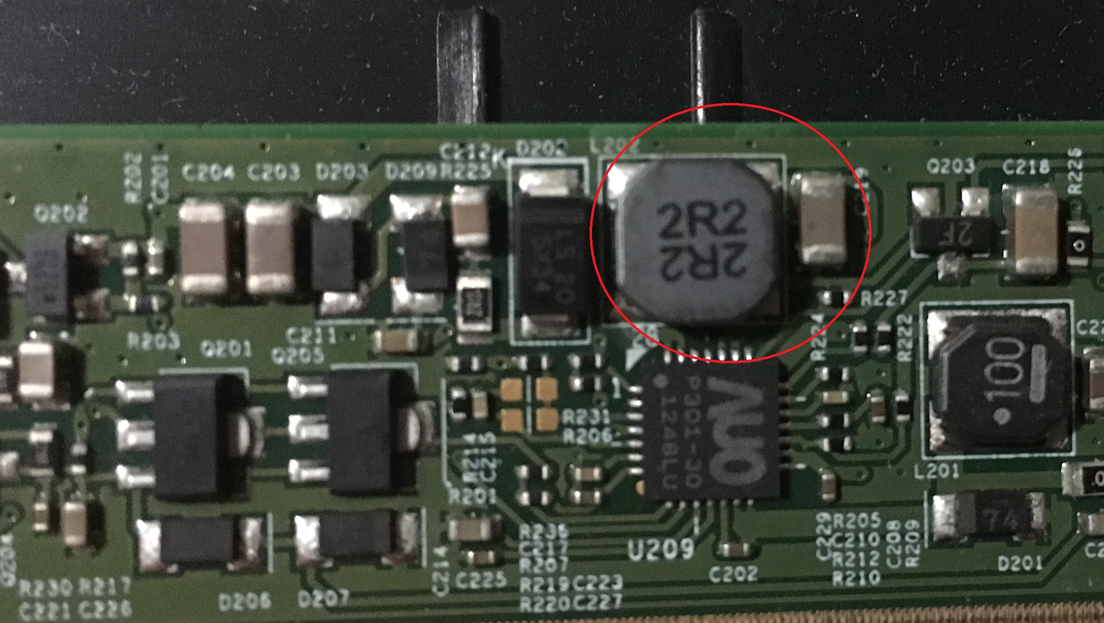

                                      I went a quick MM test on the BL board and found these shorted as shown in the photos. I don't know if the ones except the little caps should be or not.
                                      I am trying to find a schematic but no luck
