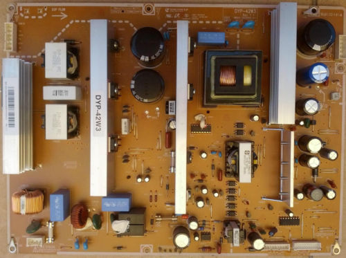

        Re: Samsung Plasma PS42A410C1D Failure to launch
        This is what the model of PSU looks like.
            I've traced the PS_On fluctuating signal across onto the hot side of the board. It travels through the 15 volt regulator (I think that it what it is) and now I'll try to find out why it isn't pulling in the power relay.

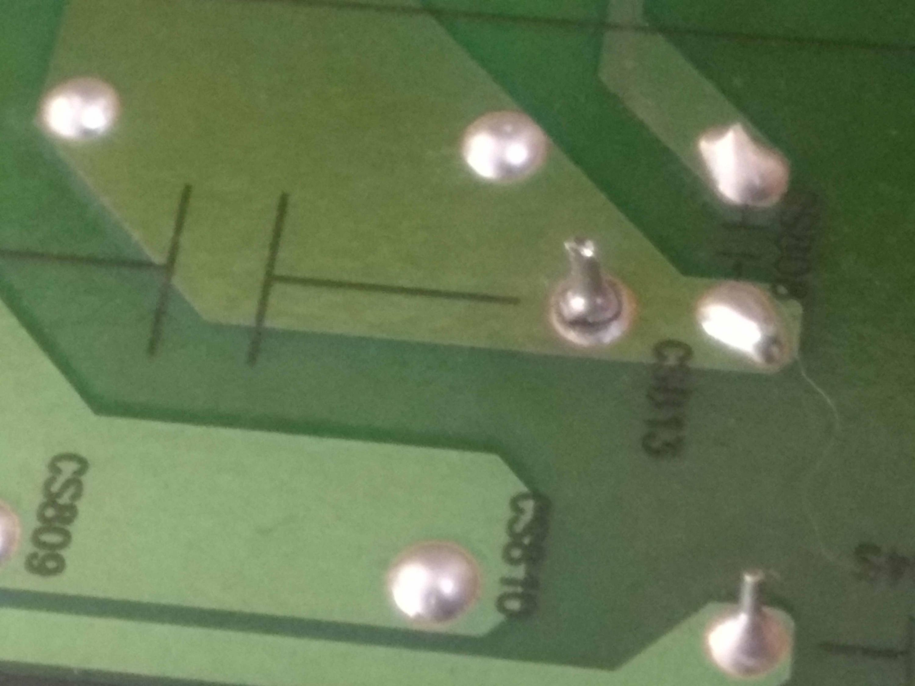

                          Hi Guys,
                          This is probably all finished with your particular faults with this power supply but I've just joined (found this forum whilst searching for info about this) and thought I'd share my findings......
                          My fault.... Power supply won't switch on properly from cold - just get relay(s) kicking on/off every couple seconds.
                          The cure.....Tried all small caps for low ESR as suggested here but this didn't cure the fault. I then found a nice, neat little dry joint on one leg of the 680nF square, blue capacitor CS813. This is a sort of 'ground return' on the primary side of the Va/Vs generation circuit.
                          It did actually look like bad caps to start with as blasting the PSU PCB with a hair-dryer would get the set to work properly.
                          Many thanks to the fella who provided the circuit diagram here, it really spurred me on to chase this fault, I stopped fixing TV's for a living over 10 years ago, I now do it for friends mostly.
