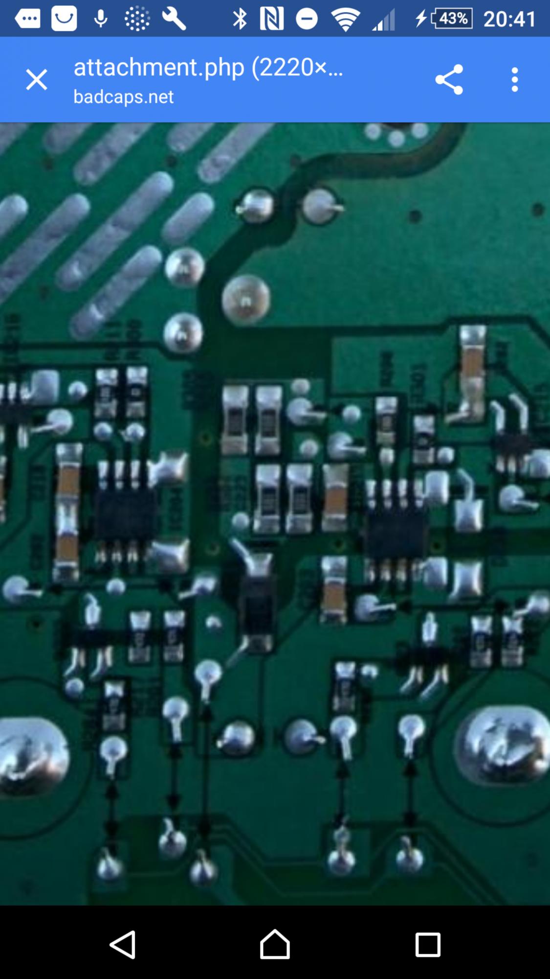

    Re: LG 60v400 display problem
    Both drive ICs located here will need to be replaced or you will blow your replacment IGBTs
      There's 2 or 3 more igbts that need changed out but they are the same part number as the ones I've pointed out.
      After all that make sure you use a 200w lightbulb instead of the fuse. Incase something else has been missed but that's usually it.

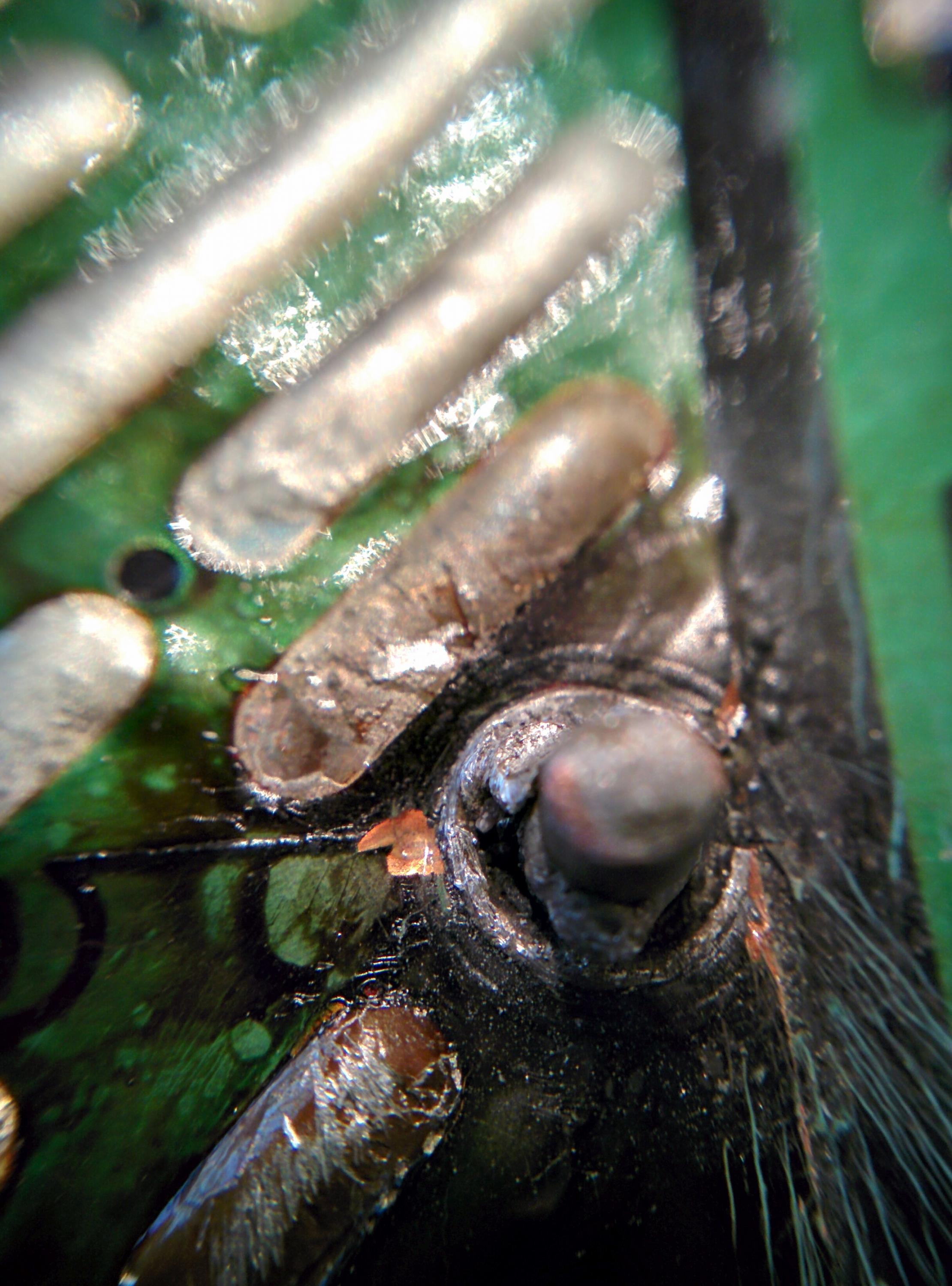

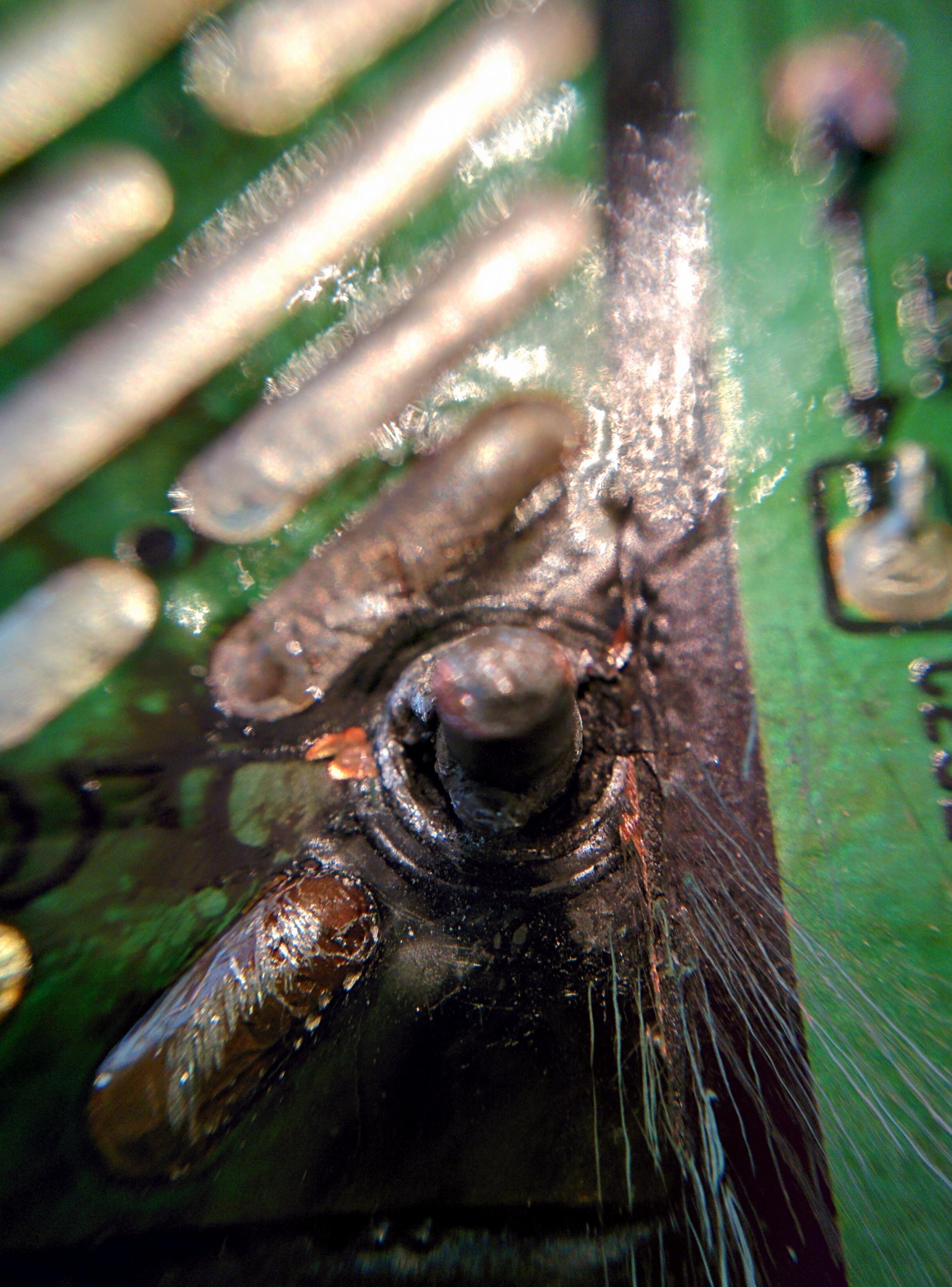

              Is it just me, or do these look really bad? Still repairable?

                    #29
                    That is simply Fucking Shocking that a set-maker can make and sell this shit--And get away with it!
                    Its Pure neglect in the design of that board and using parts that are clearly under rated for the job they are doing.
                    Just look at the charring on that board!!
                    Damned thing is a fire waiting to happen.... Cheap, not so cheerful, Crap.

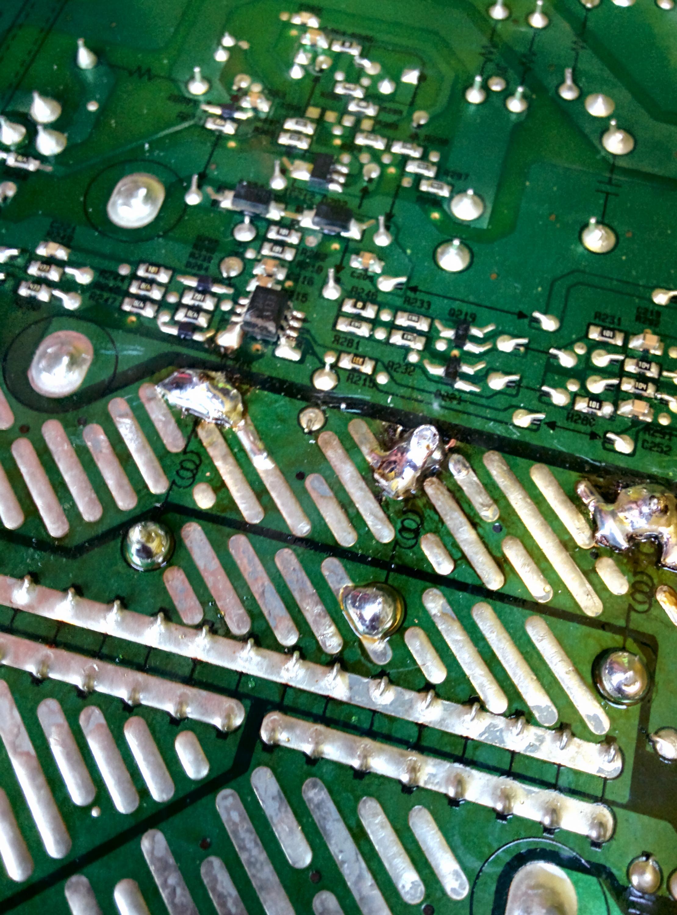

                      Yes it really sucks. Thought this was going to be a quick and simple fix.. Was told today that there's nothing left to solder to. Agree?
                        There's heaps left there to solder onto. Just clean off the burnt solder\soldermask around the hole, and scrape some of the good soldermask back to expose more copper.
                          You don't generally need to replace the entire kit, however there are 2 reasons you should absolutely replace the entire kit.
                          1) The kit provides you with parts that commonly fail. If you only replace some of them, the others will fail soon. The IGBT's and resistors go out due to the cracked solder joints on the inductors, however the 8 pin ic's can go out on there own without any other problems on the board. So why not change them if you can.
                          2) trouble shooting all the parts to know if they are good or not will take you longer than just replacing them, so why not just replace them all.
                          Lastly, if some of the board is burnt and you are not able to find exposed copper, you can go ahead and scratch the board to expose more copper, however you will want to be careful when doing this as I have seen to many people scratch way to much and rip off the copper they were scratching for.
                          Also just a heads up but the belly of those 8 legged IC's are glued to the board.

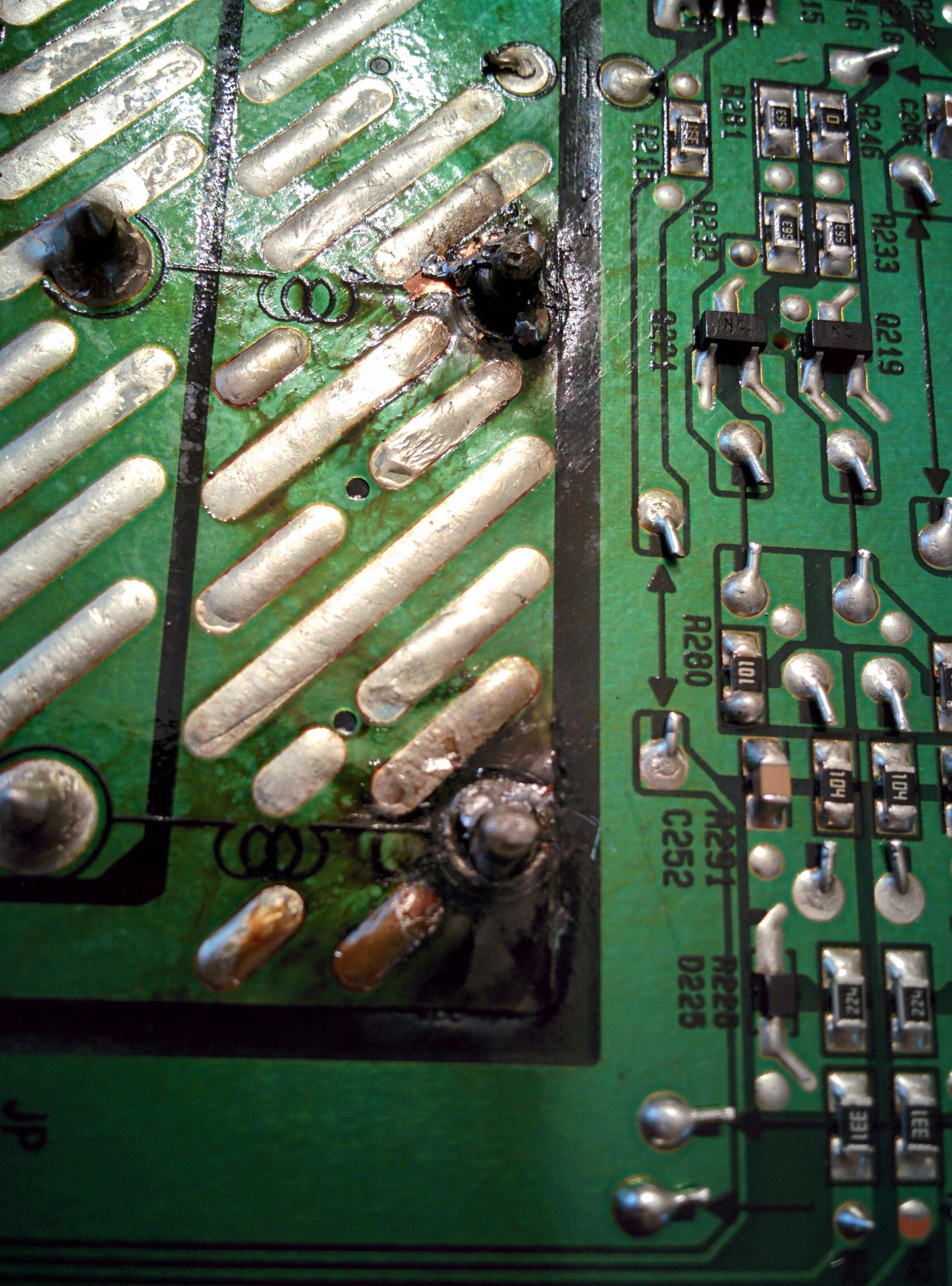

                            Okay now gentlemen, this is what i just had done at the store. Likelihood of this causing an explosion/fire?
                              The reflow of the coils looks fine, however between the legs of the top middle coil and the top left coil there is a small blue capacitors leg that has a crack. reflow that as well. It shares the same pad as those coils so it gets overheated as well.
