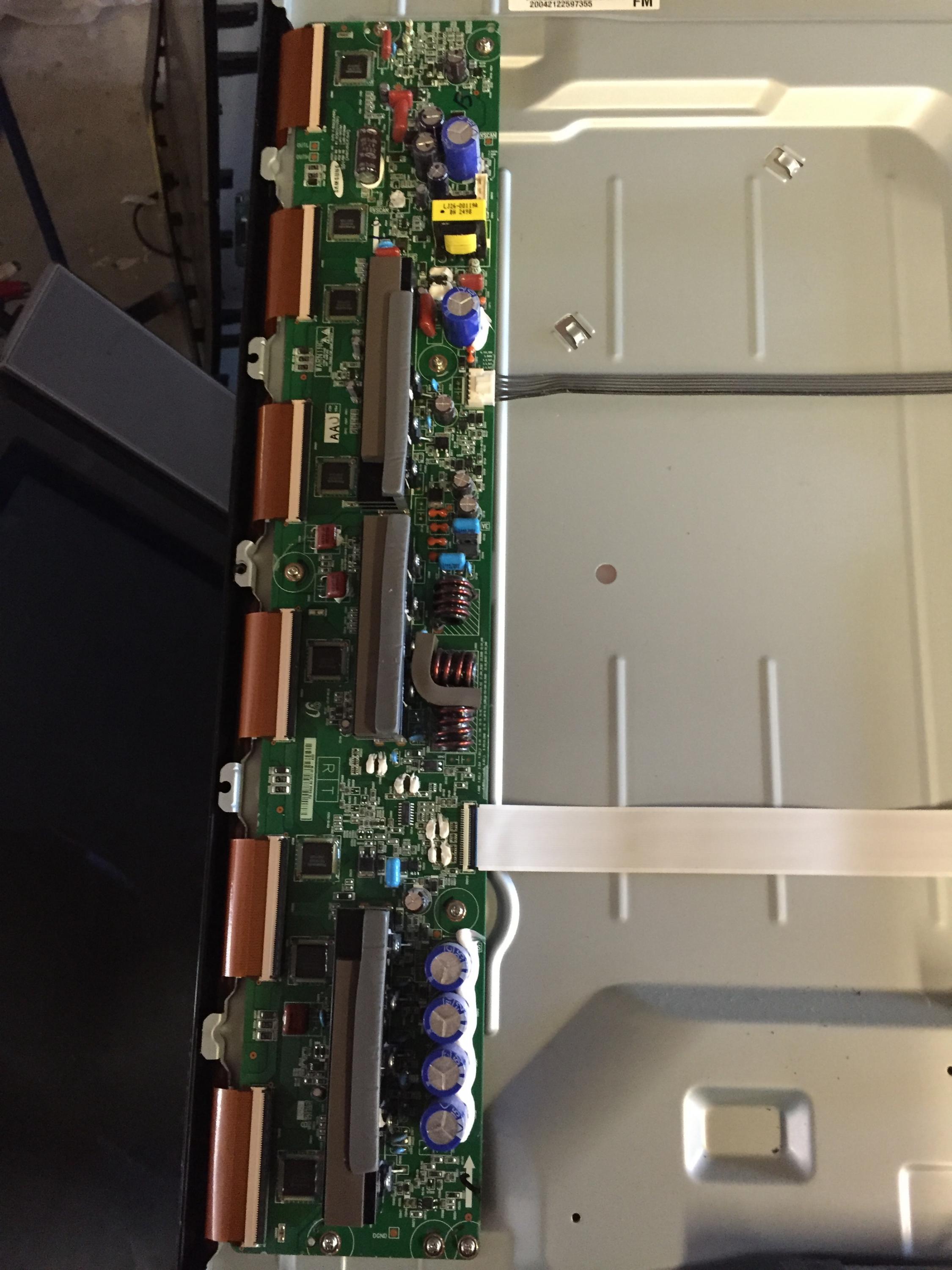

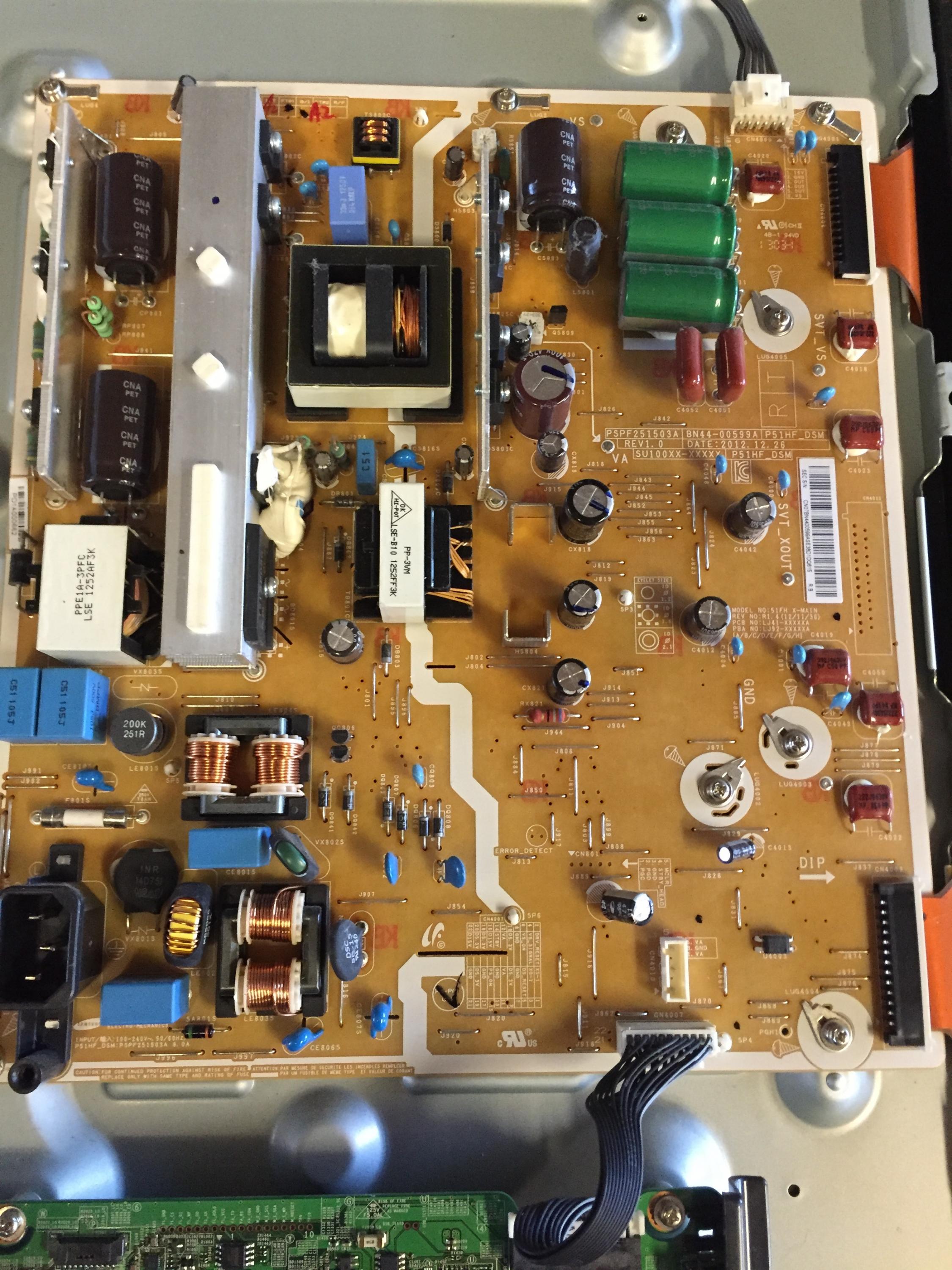

    I have a pn51f4500fxza that has no standby light or will not power up.
    I only get 5.1 volts on standby and 3.6v on ps on. The two main caps each have 171 volts.

    On the power supply whats the voltages measure on VS/VA test points ?

      Re: Samsung PN51f4500fxza
      VS/VA are both 0v.
        Anything else i can test?
