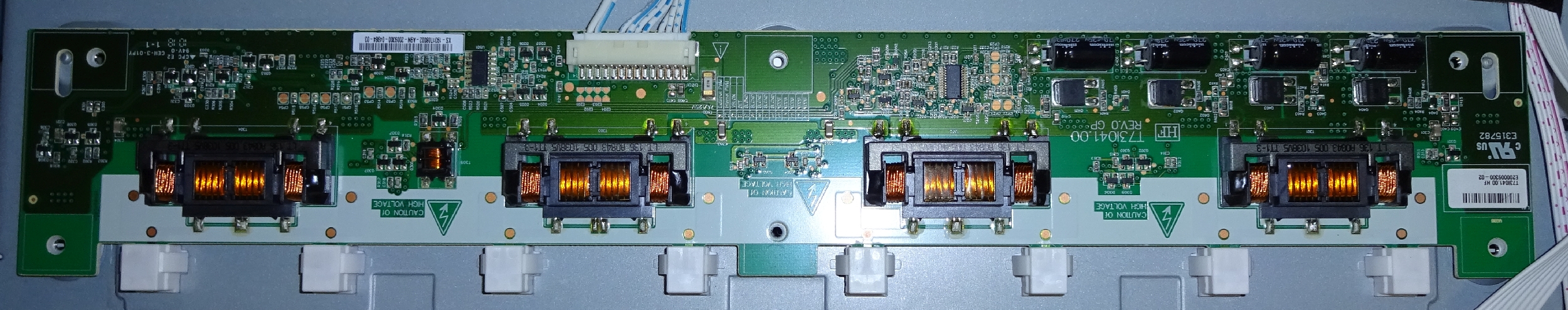

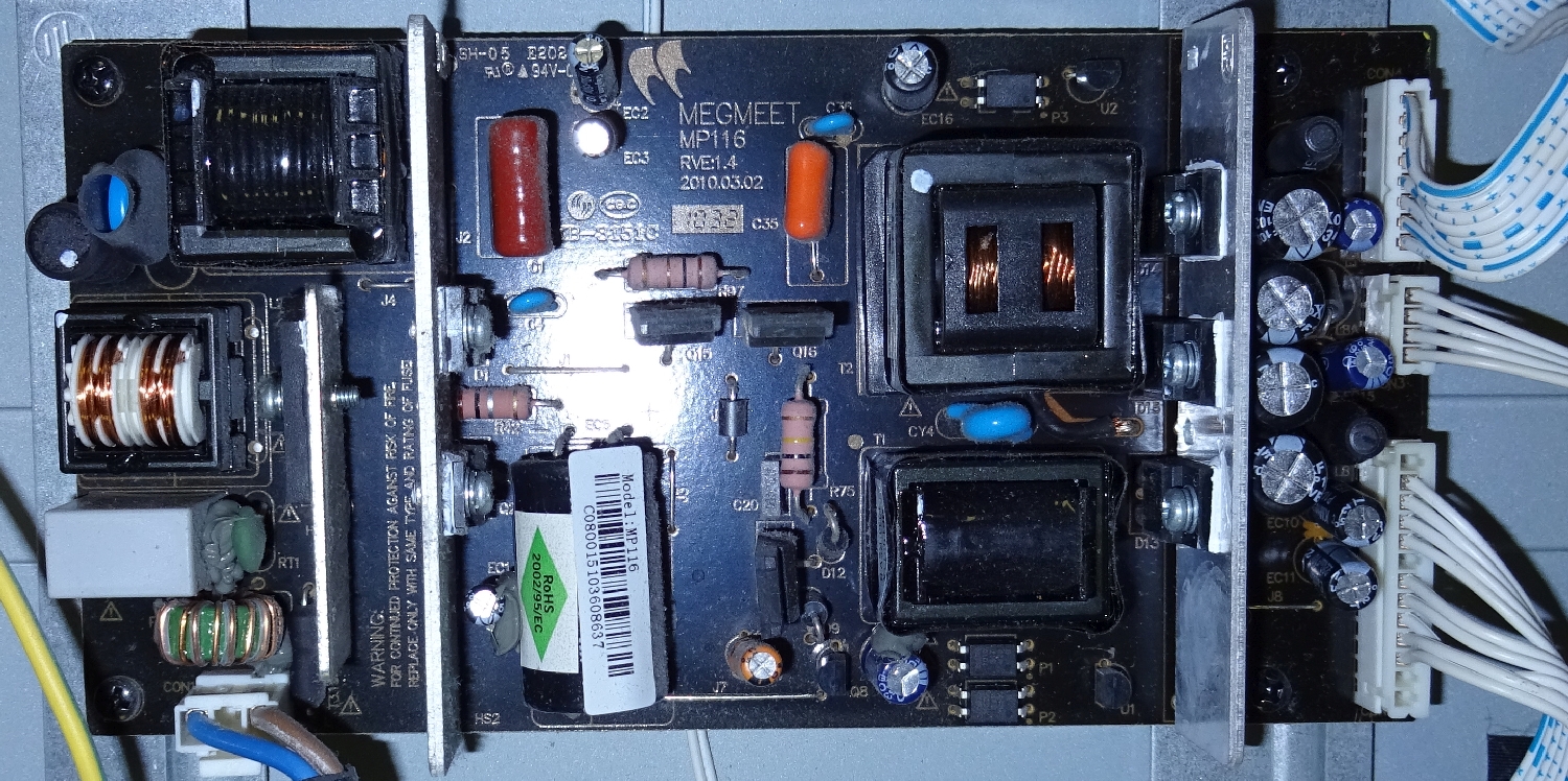

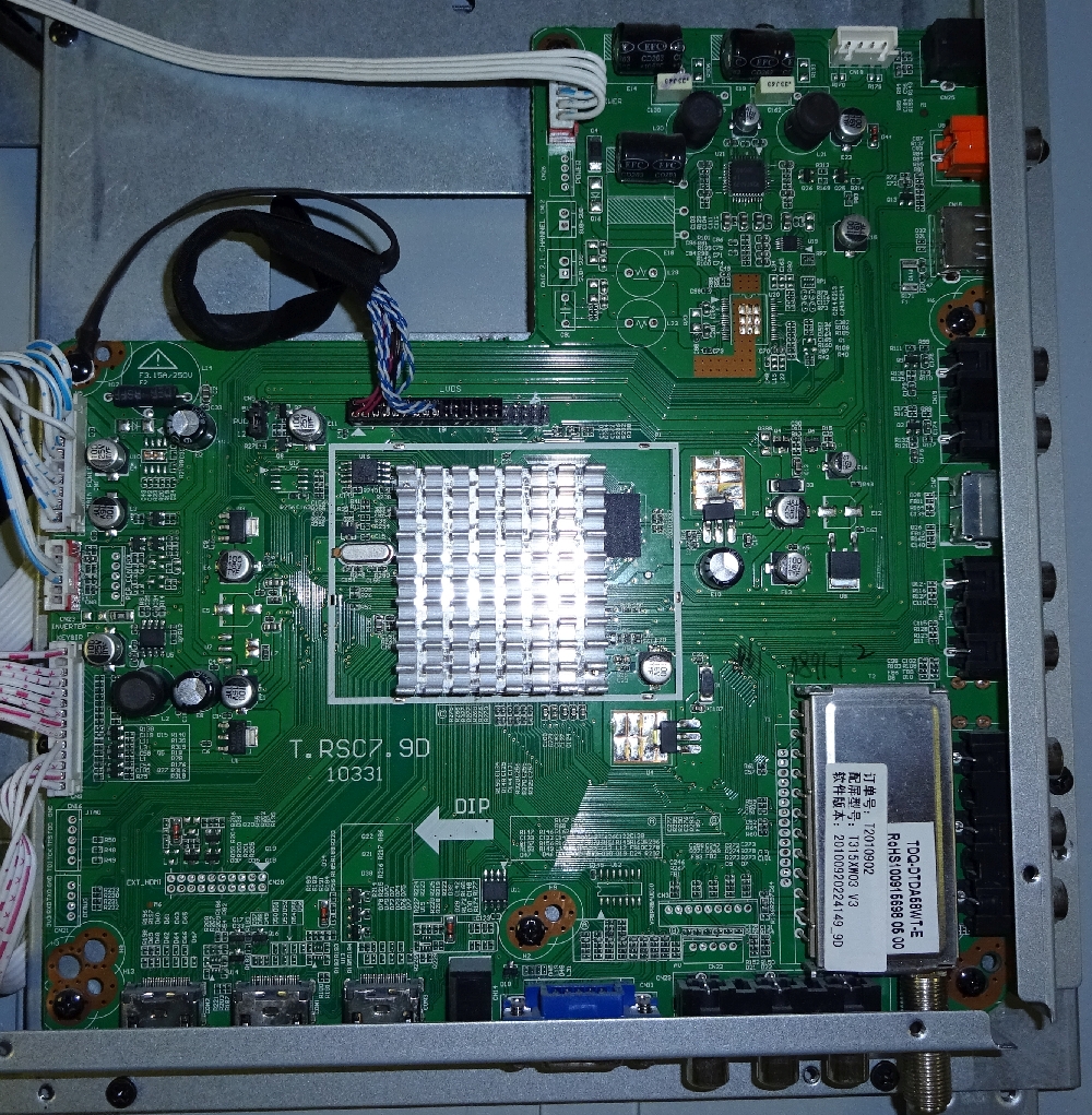

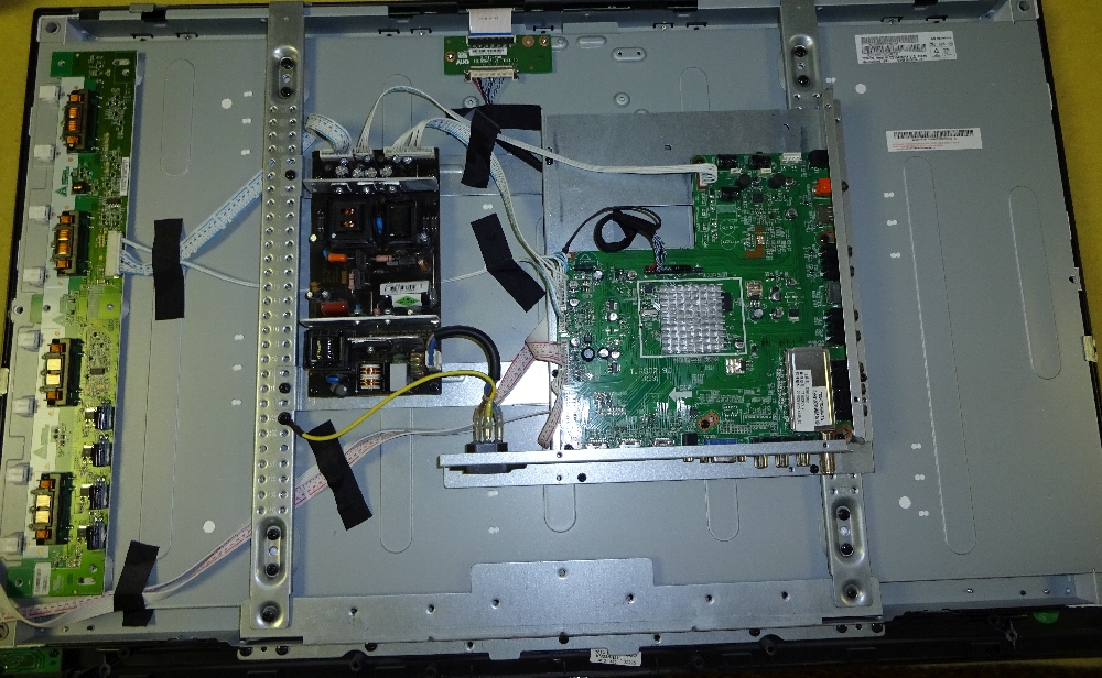

I have yet another x32 with video flashing and and gone through the post here https://www.badcaps.net/forum/showth...ht=sceptre+x32 and came up with the same or close readings. At the end it was never said if the TV was fixed or not and what fixed it. I have the exact same issue and was hoping for some input on what to do next other than toss the tv. Here is a video of the problem. https://drive.google.com/file/d/0B_P...ew?usp=sharing

Is the supply to the inverter board stable. Is there a Backlight Error return and what voltage is on it when working and when turning off.Last edited by dick_barton; 09-08-2016, 11:39 AM.Willing to help but I'm no expert. -

It may be worth checking the capacitors on the power supply that are on the 24V line. Someone else reckons they cured a similar fault but different make of set after replacing them.Willing to help but I'm no expert.Comment
Re: Sceptre X32 Video Flashing
It's a pity you didn't have a chance to compare both psu's to see what the difference was. However as you say it's up and running and that's what counts.Willing to help but I'm no expert.Comment
