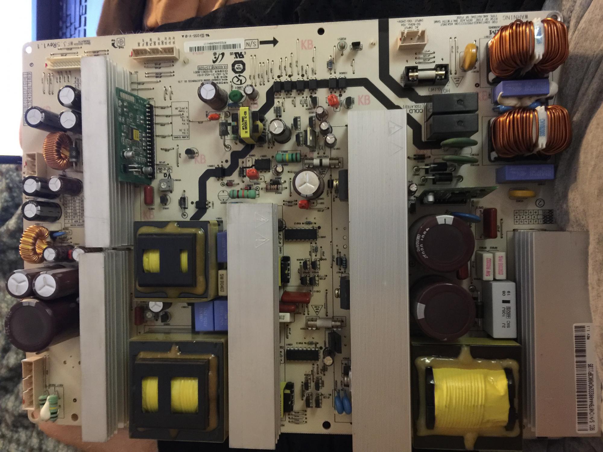

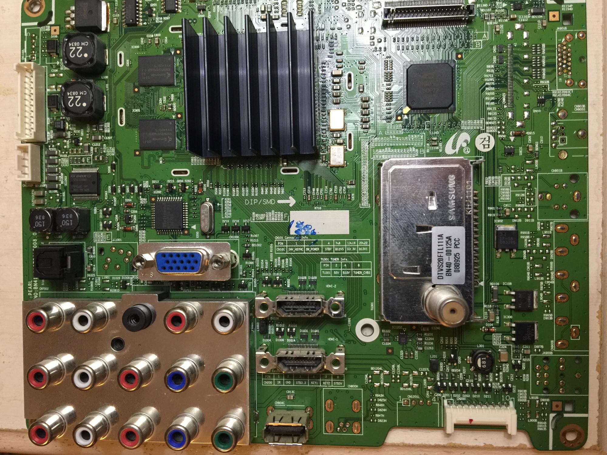

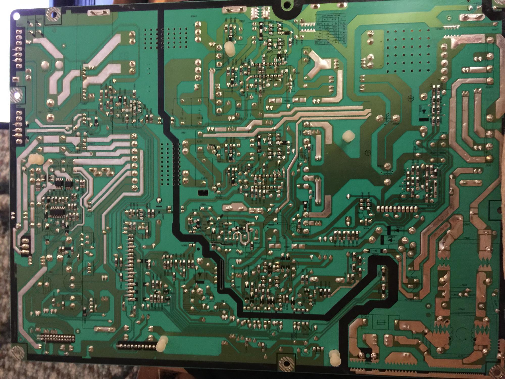

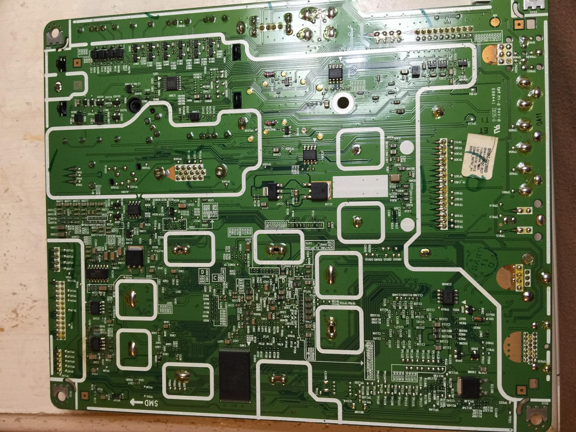

    I have a Samsung plasma that powers on with a relay click and powers down. It starts as soon as its plugged in and doesn't stop until I unplug it. I replaced IC101 and C102 on the main board with no change. I can jump PS-ON to GND to keep it from cycling to get voltage readings.
    VA, VS, -VSC, VE are all good.
    On the harness from the power supply to main board with ps-on jumped I get these voltages:
    nc___________ps-on
    gnd__________stby- 5.1v
    gnd__________gnd
    18v- 18.1v____18v- 17.9
    gnd__________gnd
    5.3v- 5.1v____5.3v- 5.2v
    gnd__________gnd
    gnd__________12v- 12.1v
    12v- 12.1v____12v- 12.1v
    nc___________nc
    Harness to logic board
    gnd
    vson- 3.1v
    gnd
    pson- .3v
    gnd
    5.3v- 5.2v
    gnd
    5.3v- 5.2v
    5.3v- 5.2v
    5.3v- 5.2v

    Power board

      Power board

        Main board

          Main board bottom
