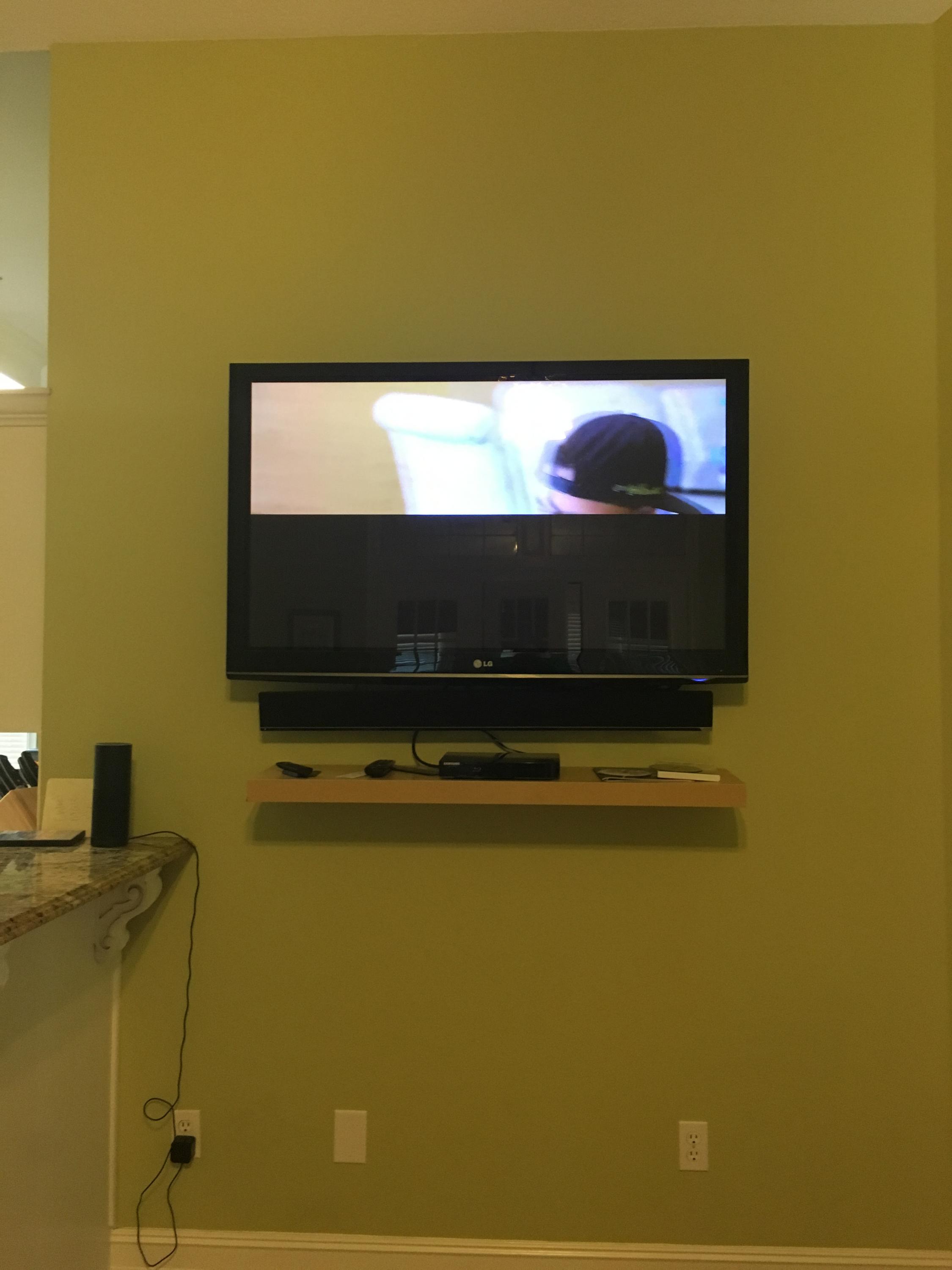

    This morning my 50 inch LG 50PS11-UB plasma tv started experiencing an issue with the display. Only the top half of the screen is working and other fifty percent of the image is missing. I've attached a photo. The image is clear and it does't flicker just half of it is missing.
    Switching to different HDMI inputs does not help.
    Could this be a relatively simple board replacement? Switching to different HDMI inputs does not help.

    Ysus issue same as PS3000 replace the Ysus.

      more like faulty lower buffer board

        Read the threads on the Ysus for this set also used in PS3000.

          I thought if it were the YSUS, the image would be vertically compressed to the top half of the display - that is what it looks like with the PS3000.
          My display is only showing the upper top portion of the image and the rest is blacked out.
          I ordered a new YSUS board and also ordered a remanufactured bottom buffer board ( a new one was not available). Hopefully, one or the other is the culprit and replacing both will solve my issue. I'll post the results in a few weeks once the parts are received.
