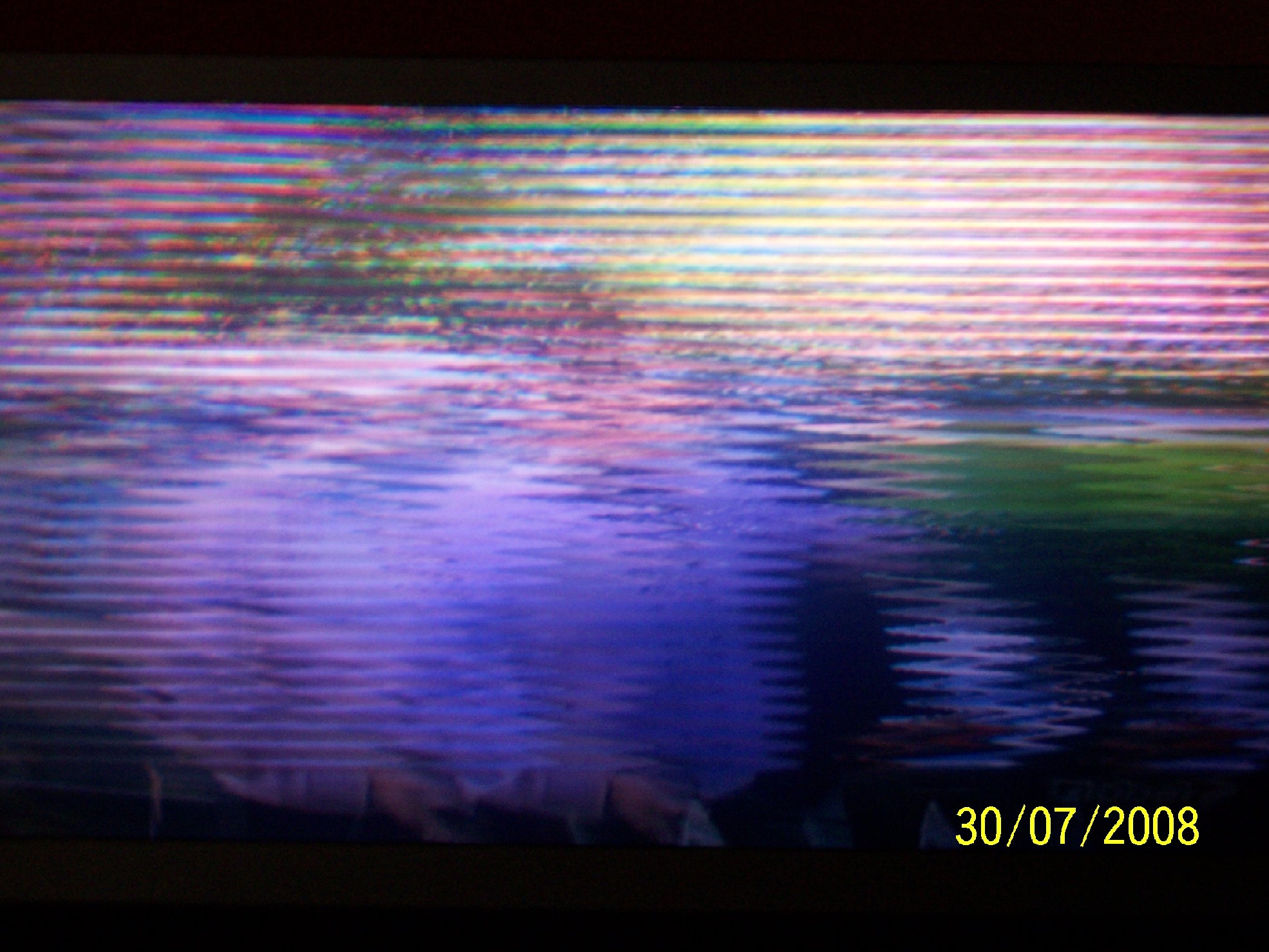

    Hi
    i've got an toshiba model 42H82 who's only 5 years old.
    i've got a troble like the guy whos just post a couples of day ago for is
    toshiba 42H83.
    i was reading the thread problem with my 42H83...
    just want to know if the new ic's(stk 392-160'e) fit in the 42H82 ?
    did i have to change capacitors and metal 2w 1.8 ohm resitors.
    help will be very appreciated
    thanks

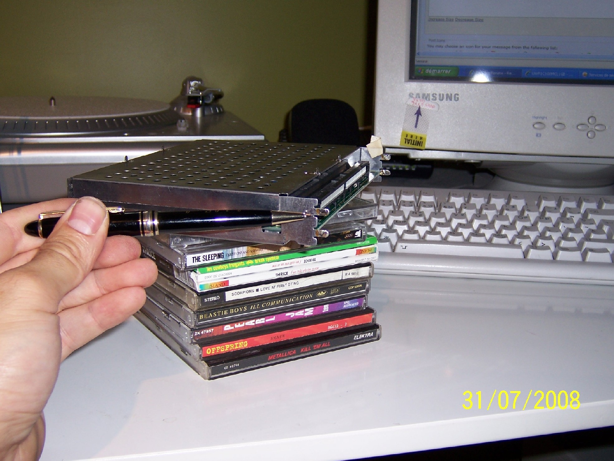

    Re: toshiba 42H82 convergence problem
    The problem you show in the picture is a problem with the hyper module and NOT the STK convergence ICs.
    If your problem is wavy picture replace all of the 10uf SMT caps on the hyper module.
    The hyper module is the component hooked into a socket on the signal board.
    It is incased in a metal box and it towards the back of the board.
          i've just removed the specific part, but there was no solder on the 4 pins who
          are attached to the pc board.
          (did'nt have to removed the whole pc board!)
          i just want to know if it's can be problematic.
          maybe those 4 pins are connected to ground?
          this tv was gave to me by a friend and he said that he paid 500$ last year
          to repair it!
          look like the trouble's back !?
          maybe the tech forgot to resolder those pins?
          any opinion?
          thanks
          Standis

            • Krankshaft
              • Jan 2007
              • 2328
              The pins of that case are to prevent stray RFI from getting into the module and yes they do connect to ground.
              Resoldering may be worth a try if the symptoms persist however you will need to open the metal case and replace the caps.
