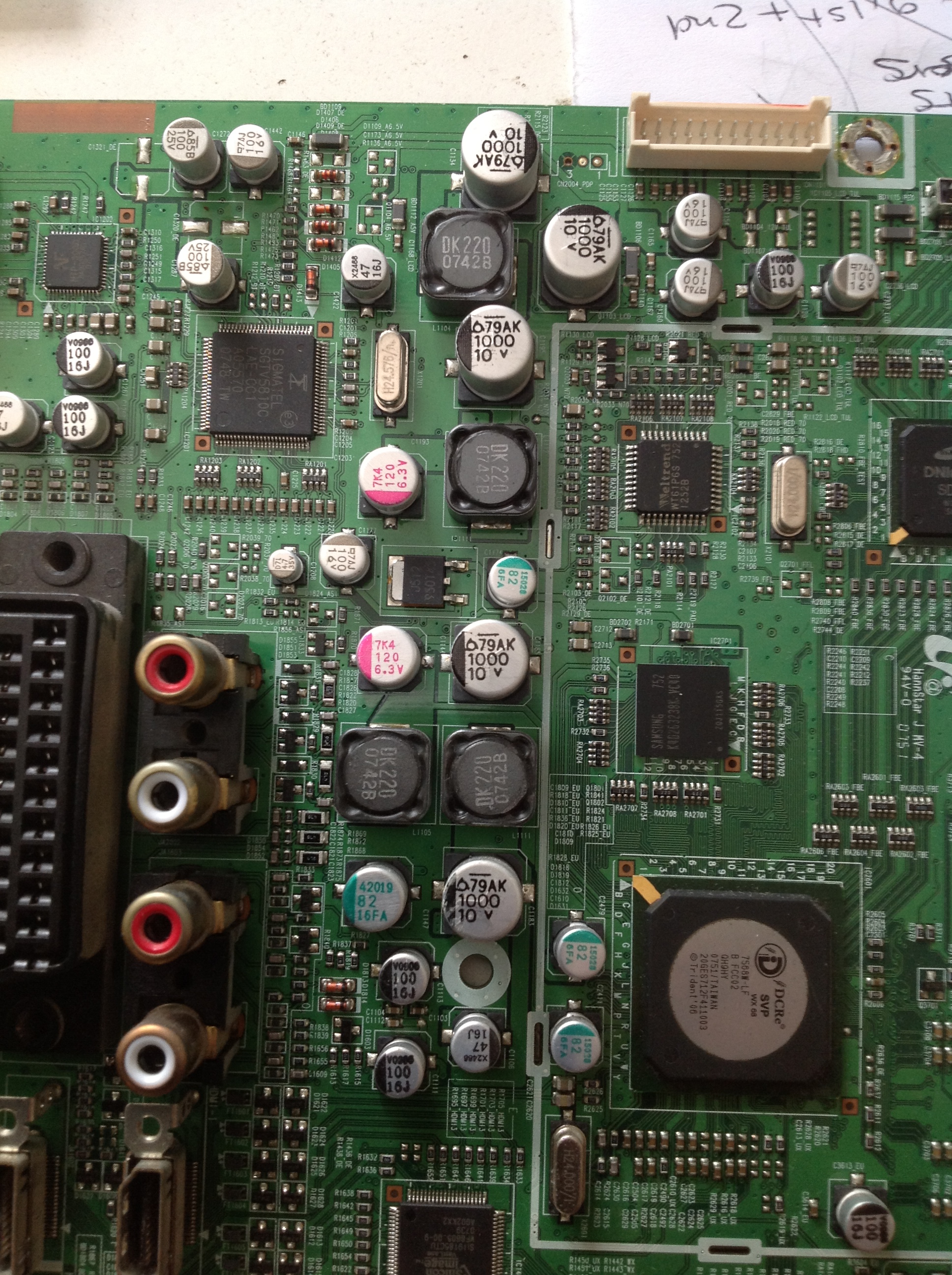

    I have a Small Signal Board from a Samsung LE46F86 and i want to change the 10v 1000uf SMD caps but i cannot find a datasheet.
    Looking on the Sam Young site at another Solid Polymer datasheet (which i have attached) shows me that 79 is the Lot number and AK is the series but i cant find any info, even on the discontinued products sheet.
    So can anybody recommend a series to use, with all my through hole work i have always used Pannys so would like to stay with them if possible.

    A through hole can work. Just watch the polarity when soldering in. 1000uf 16V Low ESR can work.

      I'll give that a go to get the set up and running but the board will be for sale so i would like it to look normal
