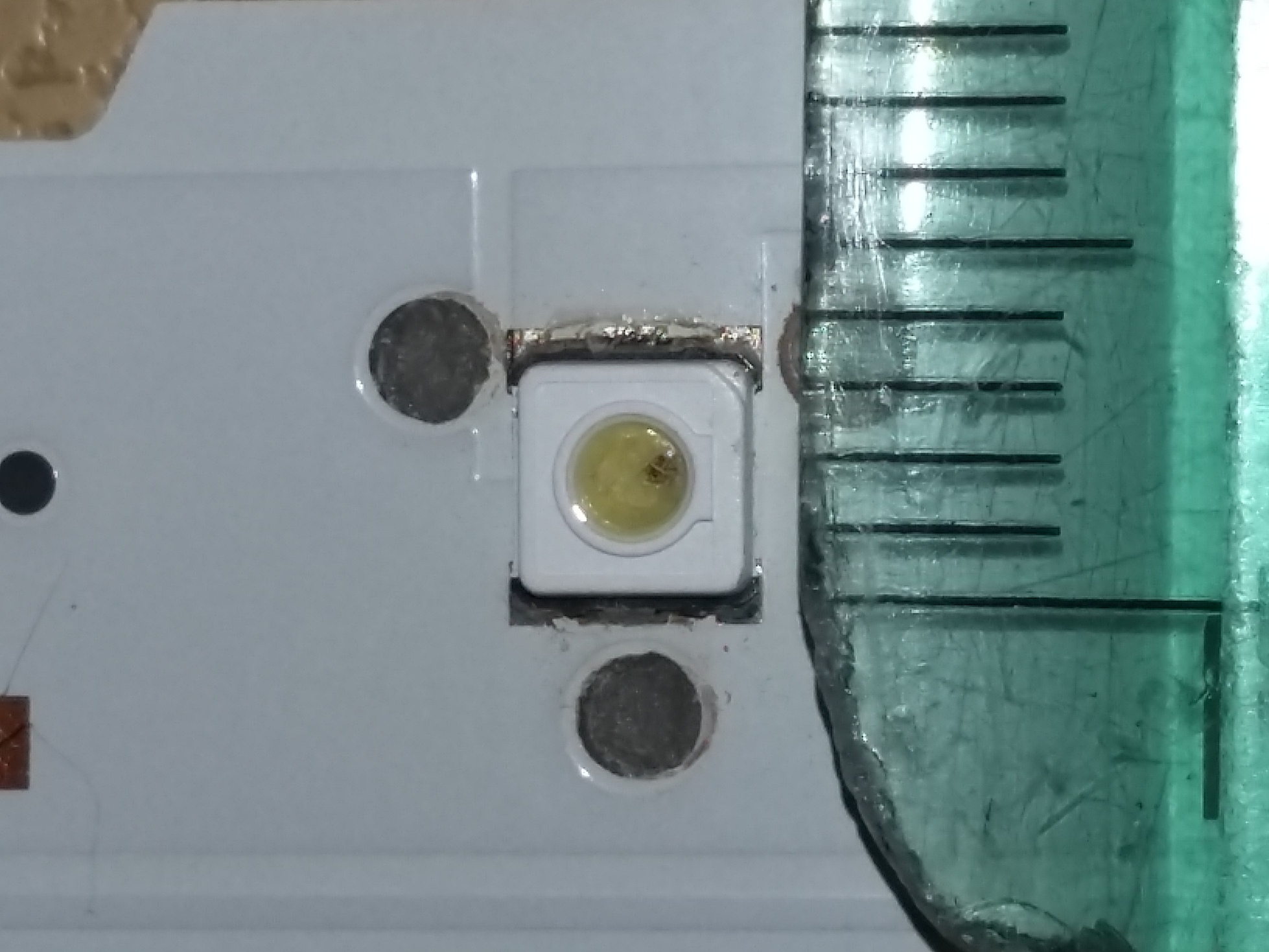

    I have a Samsung Led smart TV with shadows on some areas.
    I discovered a stripe leds that is not working. I tested and found one led is burned.
    The code of stripe led is: BN96-25305A.
    I have two questions:
    1- Can I replace the smd leds with a smd led 3528? Is it same voltage and power? (picture LedBurned.jpg).

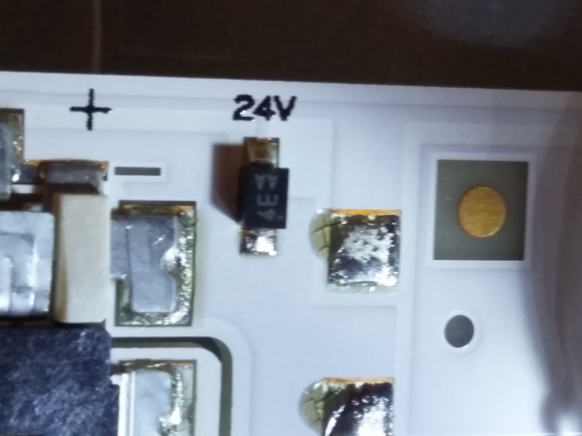

    2- In the same stripe there is another component burned. I upload the image from the other good stripe leds (picture ComponentBurnedInBadStripeLeds.jpg). It has written 4E AA. What is it?

    Ahh more led junk, yes you can use the type listed. Also here are the specs of that other burned device which is a diode:
    https://cdn.badcaps-static.com/pdfs/...f2b0fb30f4.pdf

      Here in Argentine I can buy leds 3528 but it is very difficult to get that kind of schottky diode.
      Is it posible to replace it? A stupid question: what happens if I dont put anything?
