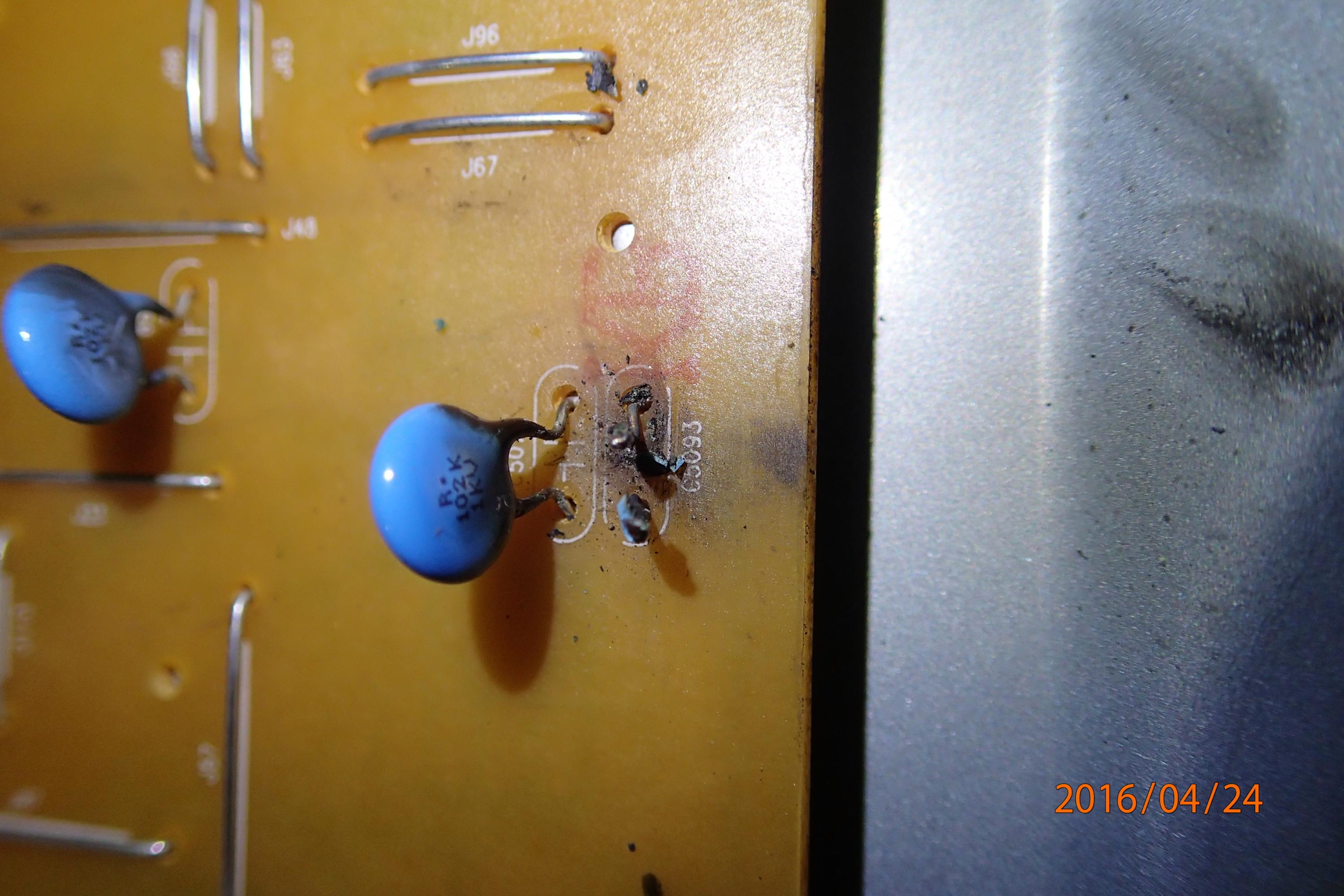

    Samsung PN43E450A1F identify CAP help
    I really need help identifying this cap it was burnt right off the board
    thanks in advance

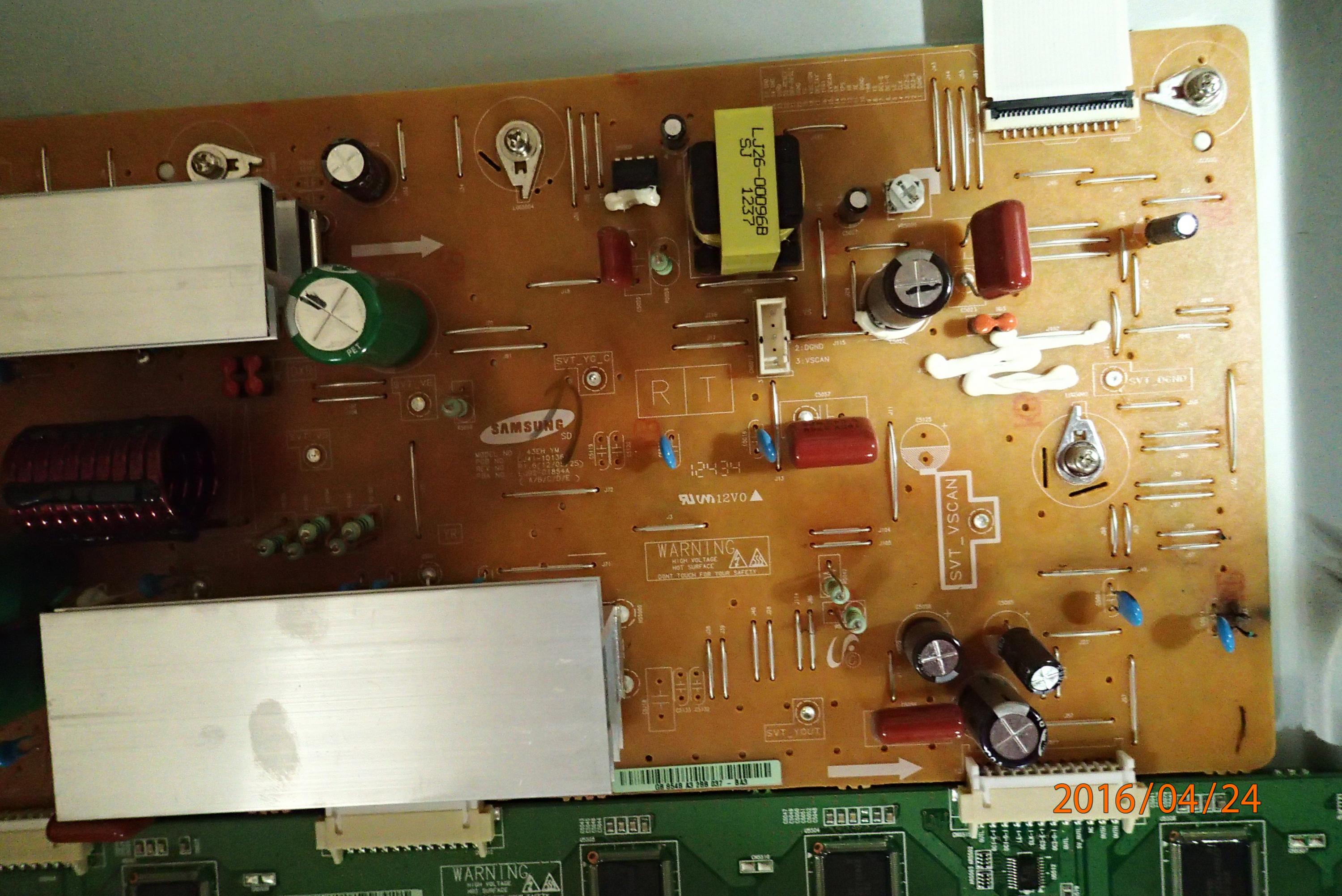

    Re: Samsung PN43E450A1F identify CAP help
    Its a 102k 1kv ballast cap. You probably have some shorted fets, have you checked the fets on the heatsinks and under the board for S/C ?
      No I have not yet but I will thanks for the help
