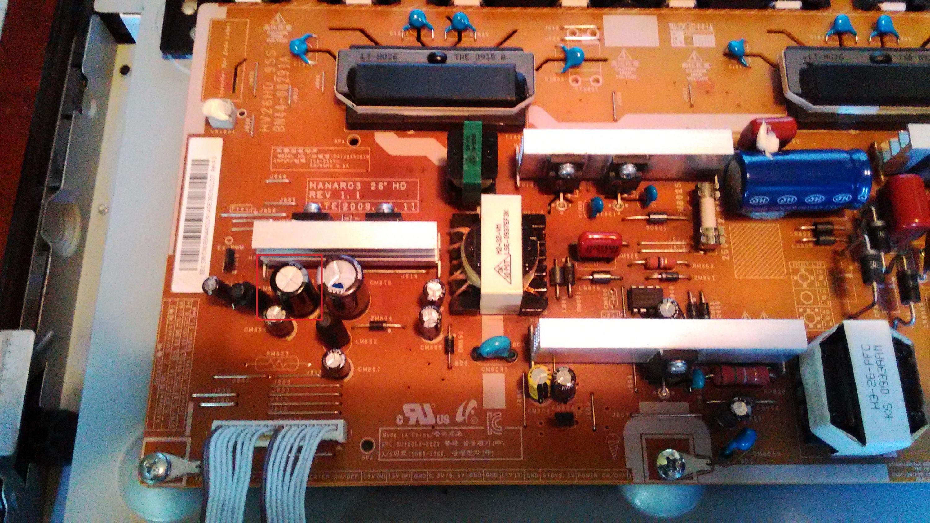

    Hello guys,
    i have le-26b350f1w with bad 10/1200 cap marked in the picture...
    There was no standby cause that part leads to logic board...
    I changed it with 10/2200... i found in the junk and it booted right up.
    So my question is can i leave it like this or do i need to find exact 10/1200?
    Thx.

    Well... we need more info on the cap you took out and the one you replaced it with.
    Manufacturer, Series, temp rating...
    If you replaced a 105C temp rating with an 85C one, not good. You didn't use low ESR caps, not good... etc...

      Ok thx for the reply... so the original one is...
      Sam Young NXE (M)105 C 10/1200
      CapXon KM 105 C C248 VENT 10/2200 <<< replacement
