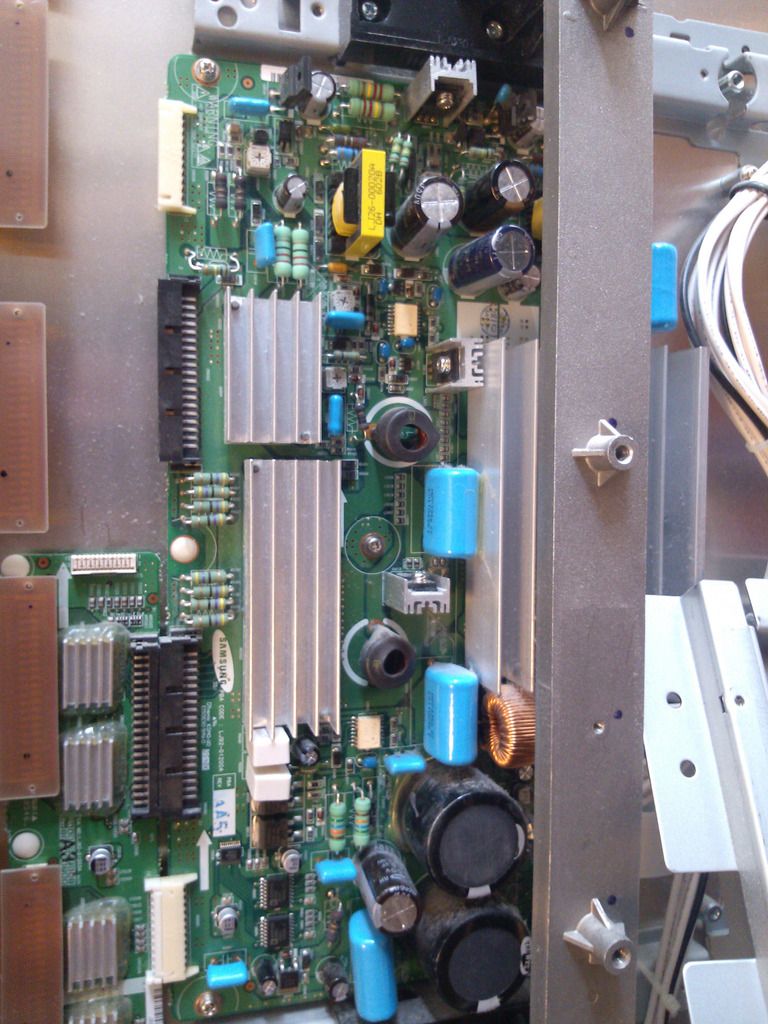

                Looks to me like a Ymain buffer ram Ic's (NOT THE Y BUFFER BOARDS EITHER THE BUFFER RAM CHIPS ON THE YMAIN) are at fault. The Ymain isnt loading the panel properly and is sending incorrect signals to the buffers. I have a Ps50Q97Hd with similar glitches the fault is with the Ymain. Btw your buffer boards are fine you should see some resistance. Have you an image of the Ymain ?

                  Here is the image I have that was part of the gallery link I posted:
                  Samsung LJ92-01200A Y-Main (Y-sustain) (direct link)
                  (Upper Y-buffer board was removed at time of photo.)
                  I've pulled the board out of the TV just now in preparation for replacing the one swollen capacitor (the only obvious visible fault I could find in the entire TV). There actually seems to be very little physical logic in the path between the video input and output stages of this board. While it's entirely possible that a fault on this board could cause erroneous data to get sent to the screen, I'm not seeing much that could affect this in a way that almost purely repeats one line of image data over and over. Once I get that capacitor replaced I'll be more certain of what I'm dealing with. I'll post another photo of the board tomorrow now that it's been removed and will provide an unobstructed view.
                  The primary reason I'm suspicious of the main logic board is that applying the test-mode jumper doesn't yield the solid white screen expected, nor does it seem to have any effect at all. Video will get from the external connections via the input switcher to the screen but it is a garbled mess. You can tell there is motion going on but there is no valid image. If my original Y-buffers are actually good then I'll end up with a spare pair, which definitely isn't a bad move.
                  Keep in mind that the screen won't show anything at all if the original upper Y-buffer is present, which suggests multiple points of failure. This makes it harder to test properly. Thankfully the power supply seems to be operating perfectly to spec. Do you have any suggestions on how I can test further in order to isolate the problem?

                    I've added the full image of the Y-Main removed from the TV:
                    The swollen electrolytic capacitor is the one in the upper right of the photo, nearest the big blue component.
