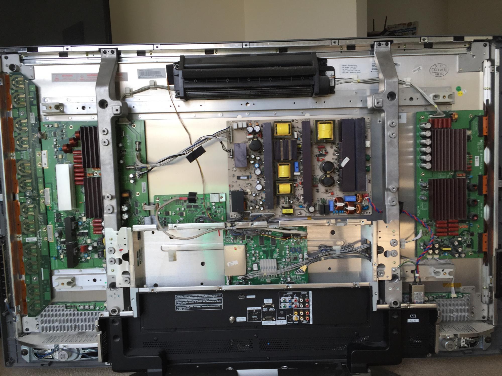

    I bought this tv for $25. Previous owner said he heard a pop and the picture went out.
    I got it home and it wouldn't power on. Took the back off an saw a few bulging/leaking caps. I had a forum member replace the bad caps, the tv turns on now, I get static sound but no picture.
    There is no osd, nothing. I can mute the static, turn it up and down.
    When I change the channel the static responds as if it was changing.
    Here is a video of the screen when it's on. http://sendvid.com/0p8mvz7p

    I also noticed the fan doesn't come on.

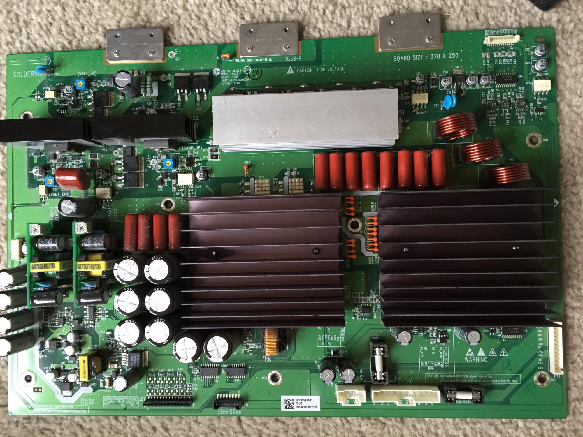

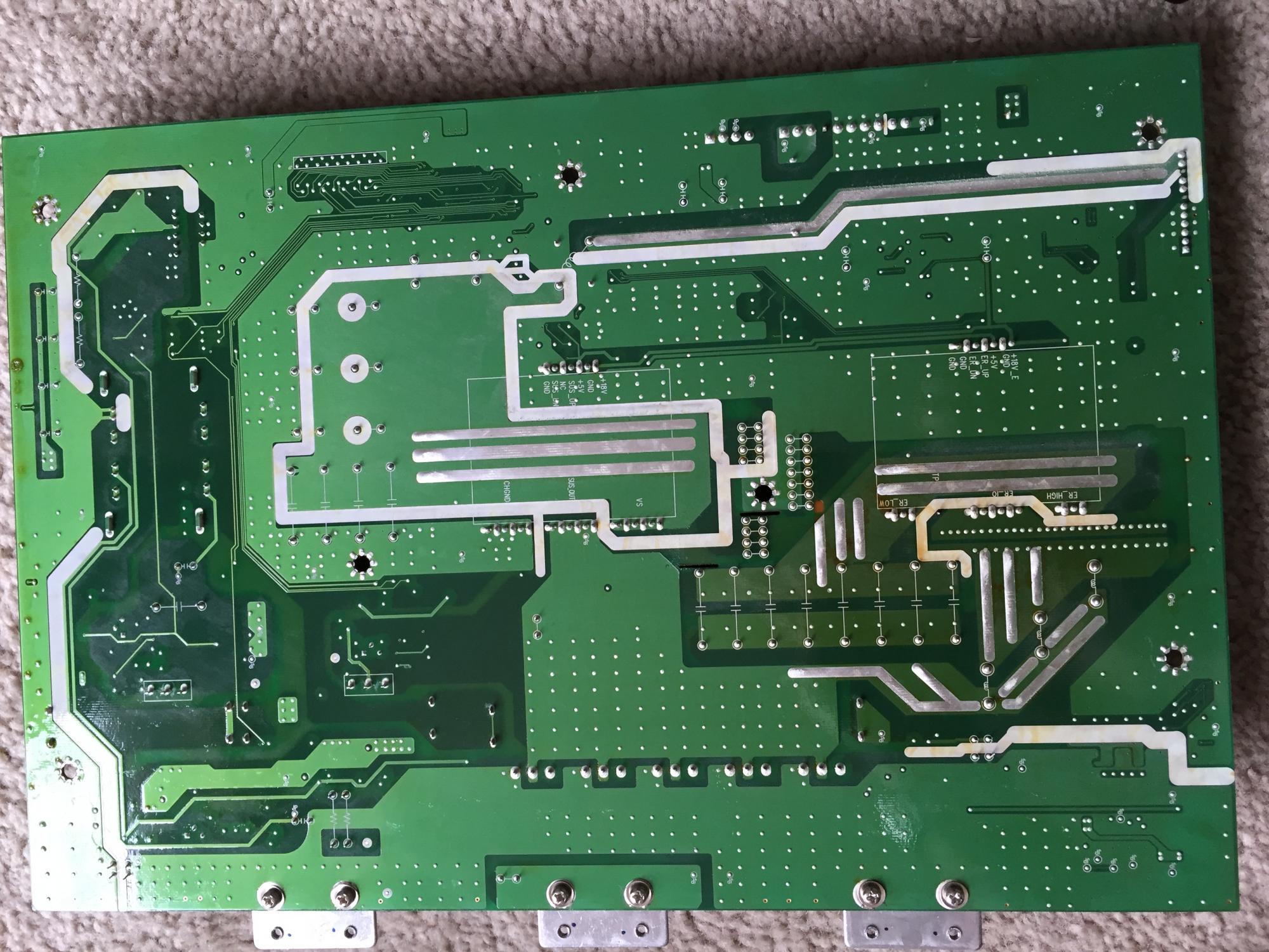

                      Fuses ok on the Ysus. I don't see any on the Zsus
                      Here is the back of the Ysus.
                      • Malachi
                        • Dec 2015
                        • 1077
                        • Usa
                        Re: Lg 50pc3d no video.
                        Front

                          Re: Lg 50pc5d no video.
                          Integrated Power Module. Two, under the large heatsinks.
                            The black heatsinks? How do I test them? Are they hard to replace?
                            • cliff_hootarski
                              • Jul 2006
                              • 411
                              Coppell TV Blog:
                              http://blog.coppelltvrepair.com/2011...s-ipm-for.html
                              and
                              http://blog.coppelltvrepair.com/2012...r-defects.html
                              Very difficult to replace without the correct tools. Desoldering gun, high powered soldering iron.
