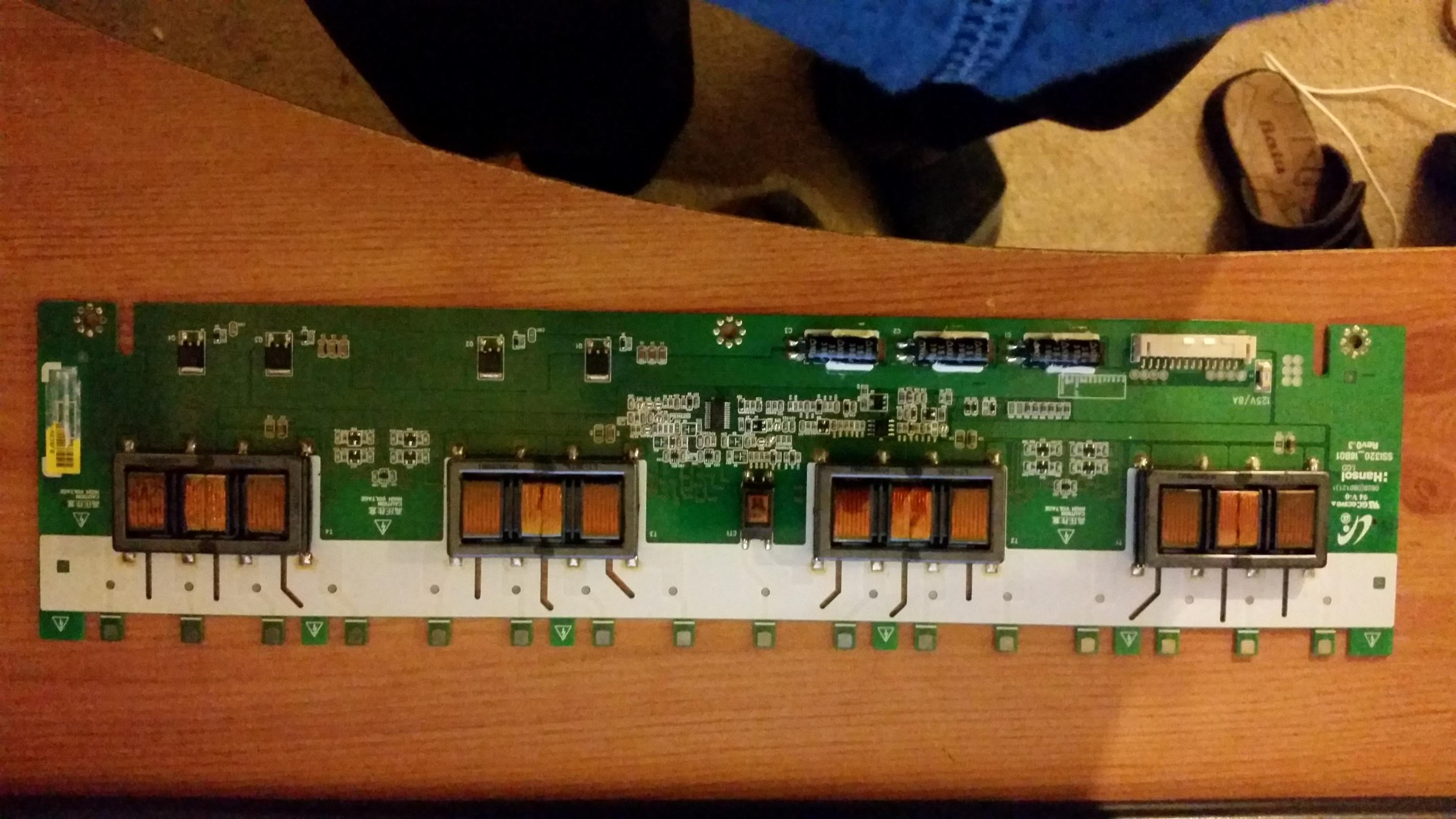

    Hi
    Tv: Samsung le32a886p1f Inverter board: Hansol ssi320_16b01
    I had 2 seconds to black sometime even 20 minuets to black with sound
    So I replaced the inverter board (SSI320_16B01) which has solved the problem.
    I am testing the old inverter board to figure out what has failed.
    I have checked the primaries and secondaries on the 4 transformers and all seem fine however there are 4 mosfets and one (Q3) is not giving the same reading on leg 2 as the other 3 mosfets, is it safe to assume that is the faulty component.
    Regards

    Re: Samsung le32a886p1f ssi320_16b01
    Them mosfets are fine you shouldn't get a reding between the legs, you need to really be checking you Backlight on signal and 24v supply to the inverter make sure they are present.
