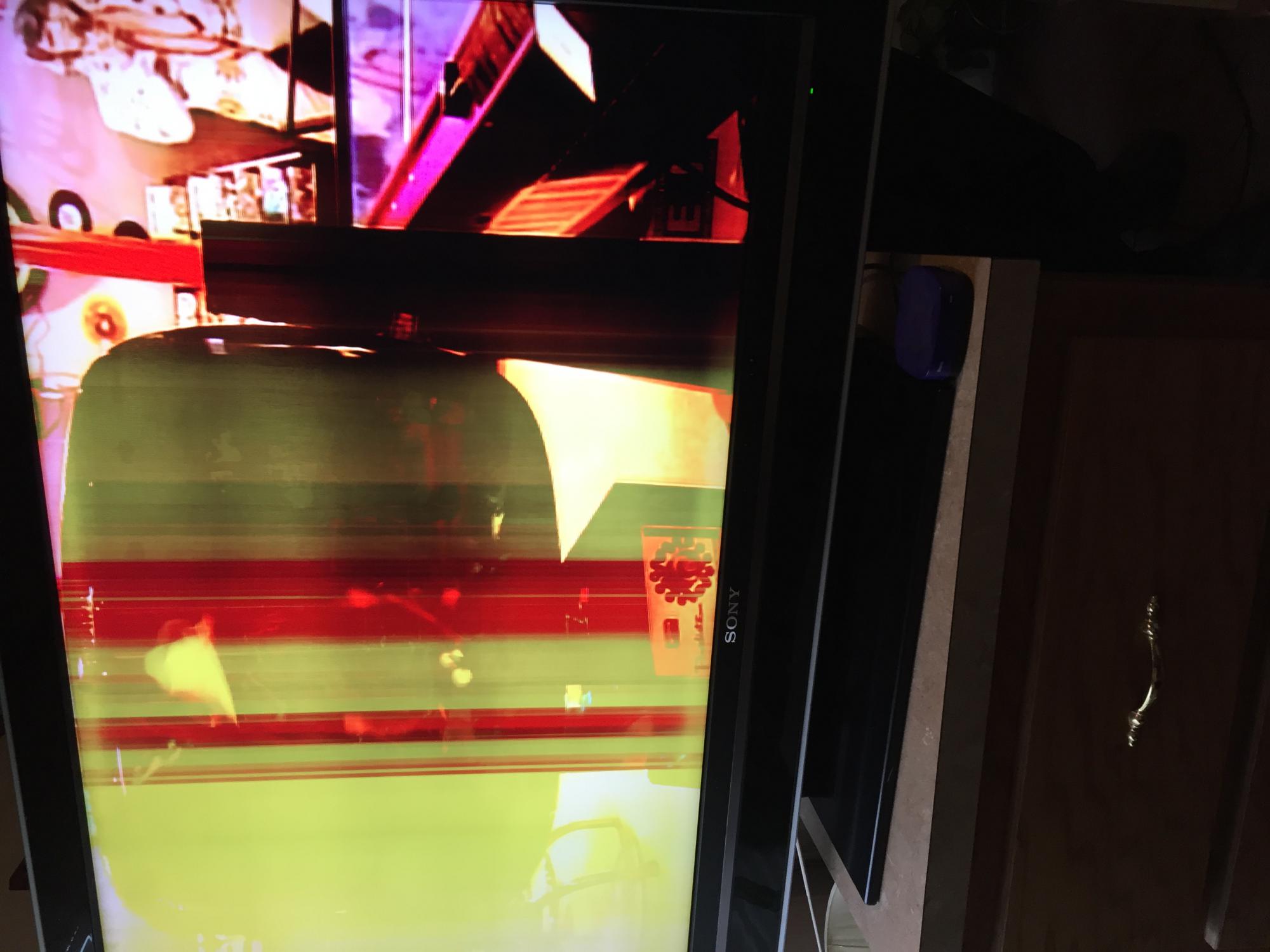

sony kdl-46vl130 Blurry and color picture problems

    I have read and looked at YouTube vids about taking it apart and pressing on ribbon cables that lead to screen and I've tried that with no luck.
    Any ideas what to look for would greatly be appreciated.

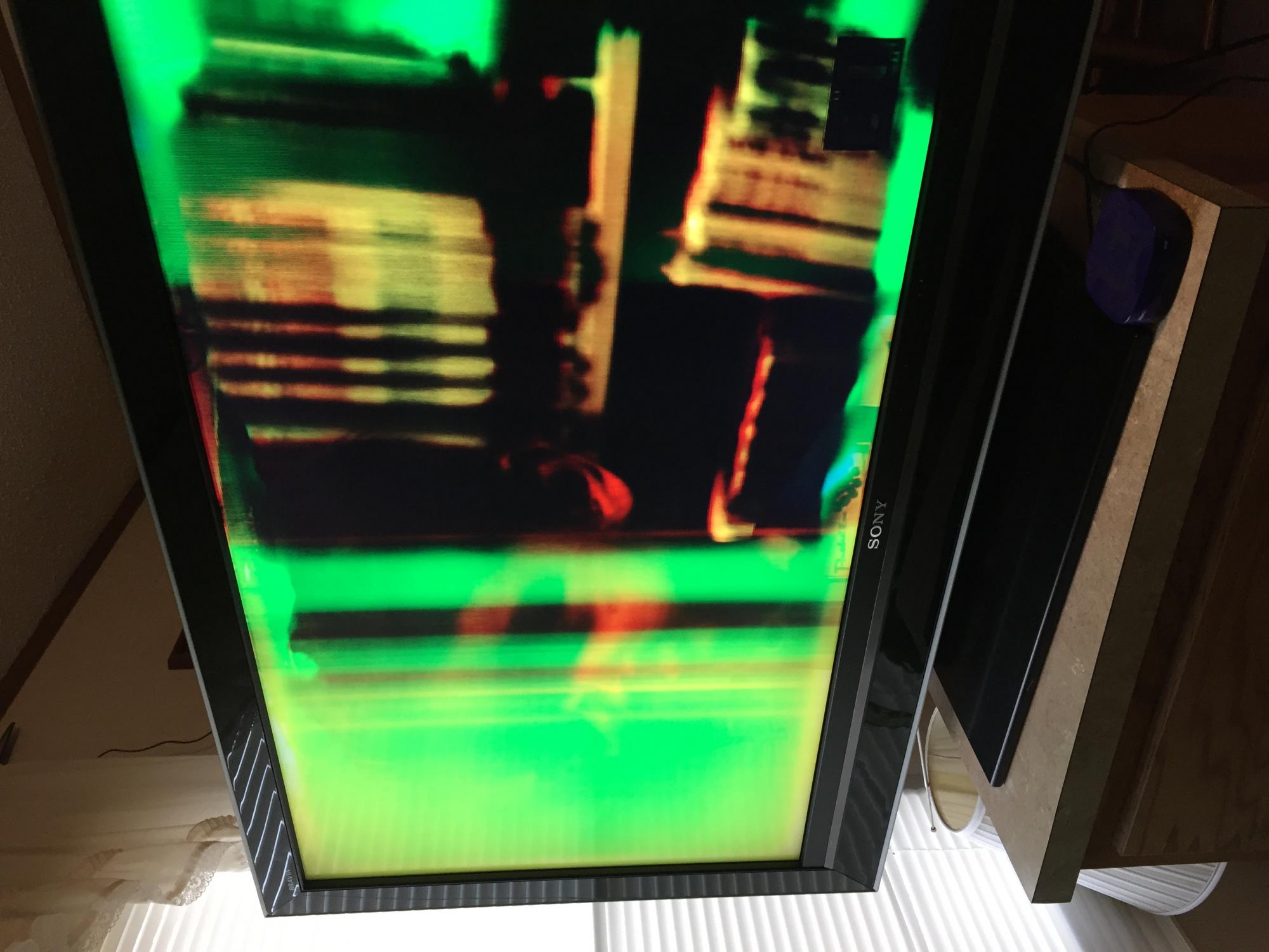

    Re: sony kdl-46vl130 Blurry and color picture problems
    Here's another pic
      Well , this is either a t-con problem or panel. Since you already checked the tabs I'm thinking this is a t-con problem , especially with the pink/negative colours.
      When you touched the tabs , did you see anything change?
        No nothing changed at all.I also reseated the t-cons ribbon cables still no change.
          I ordered a tcon board waiting for it to ship.will post results
            I got new t-con and installed but same blurry picture.
            Is it possible there's a problem with the main video board?
