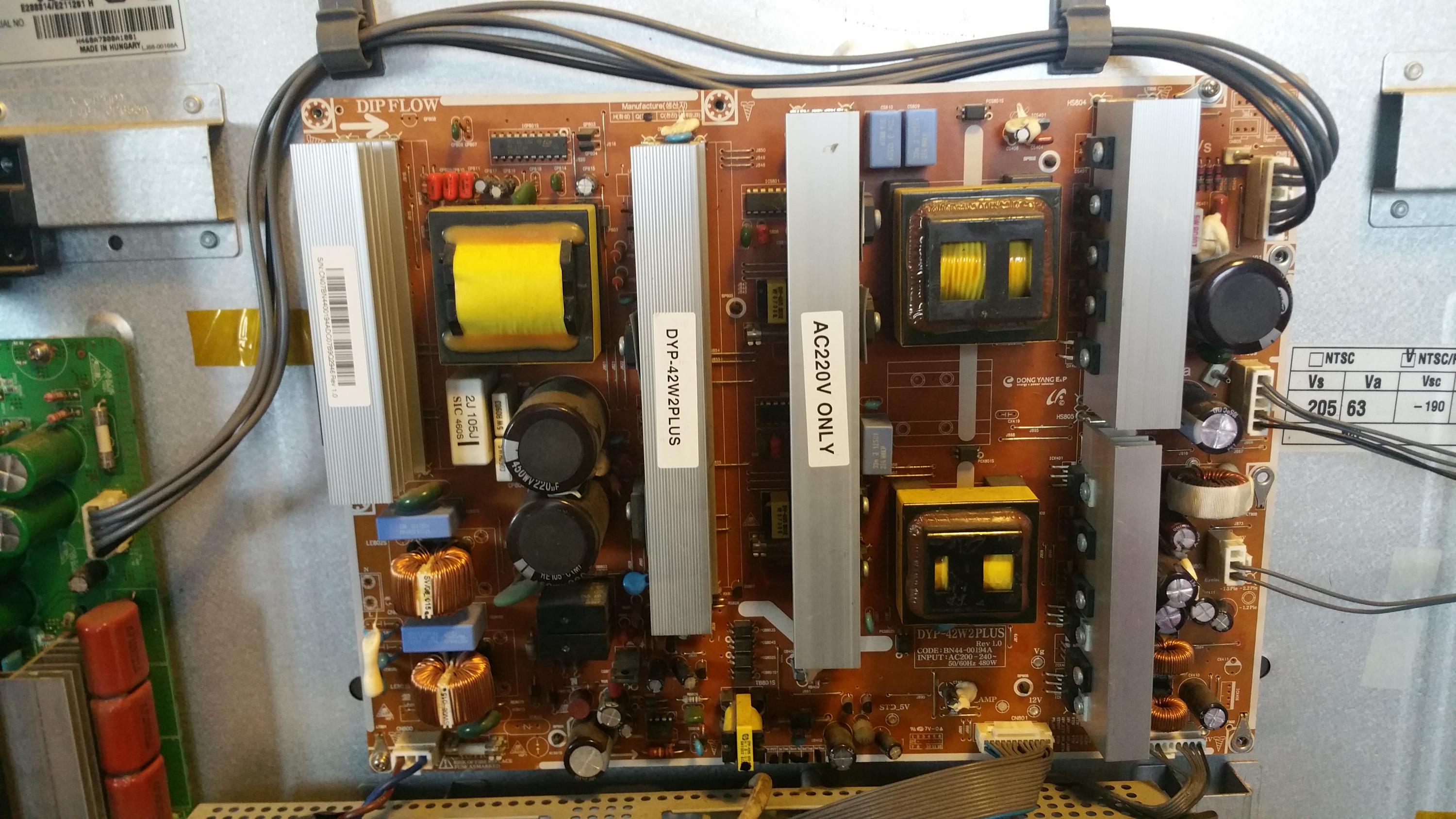

    My Samsung plasma keeps turning it's self of with in a mini and back on and off then just clicks theirs no bulge caps resoilder where the heat sinks are and still no luck's=205 va=63 and vg=9 so while TV is working VS and VA voltage are ok vg a bit high at 9v shold be about 5.3v when TV go's of no voltage

      Check for cold solder joints on the power supply

        done that already

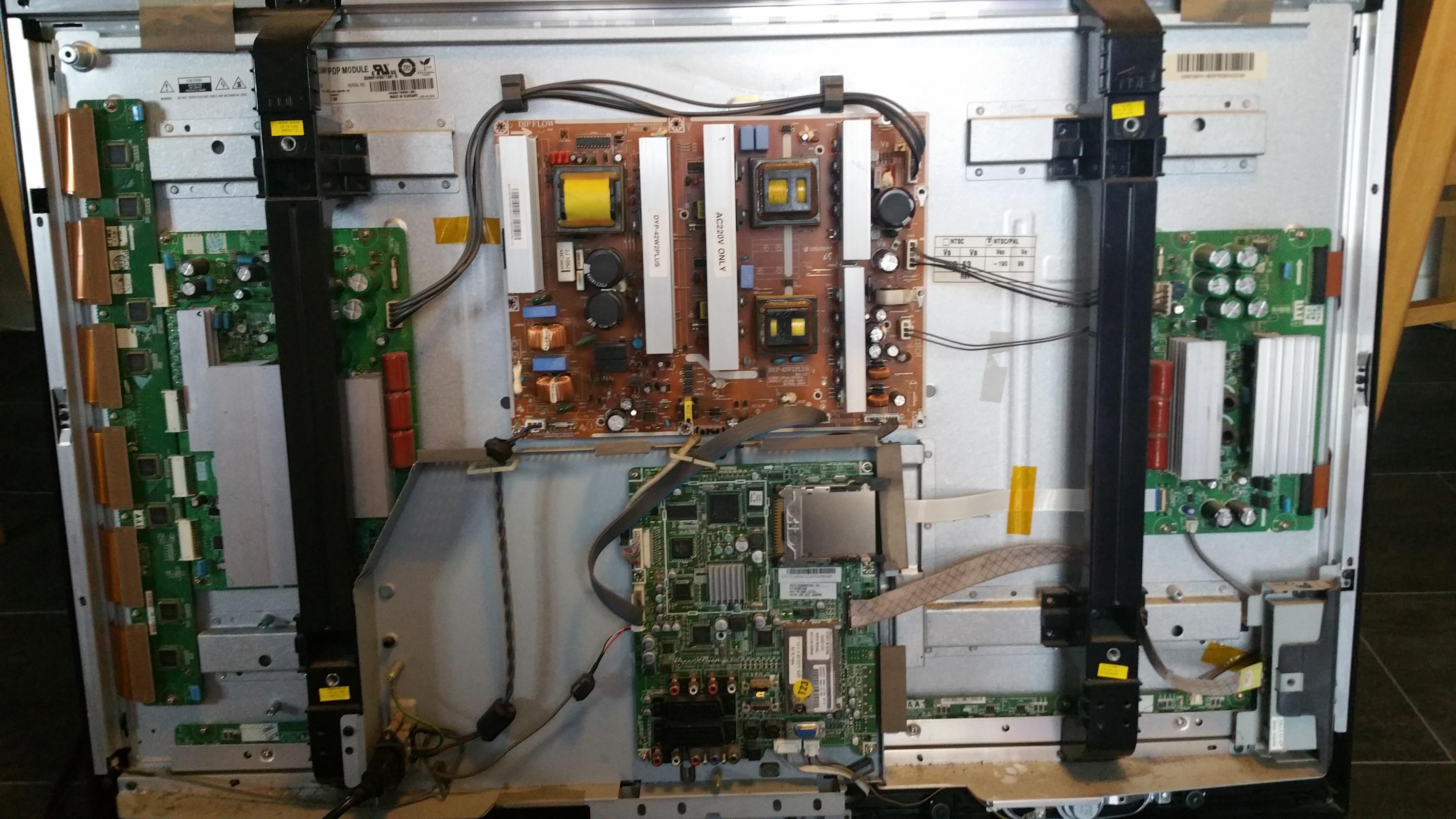

          it was the main board that was faulty working with a replacement mainboard
