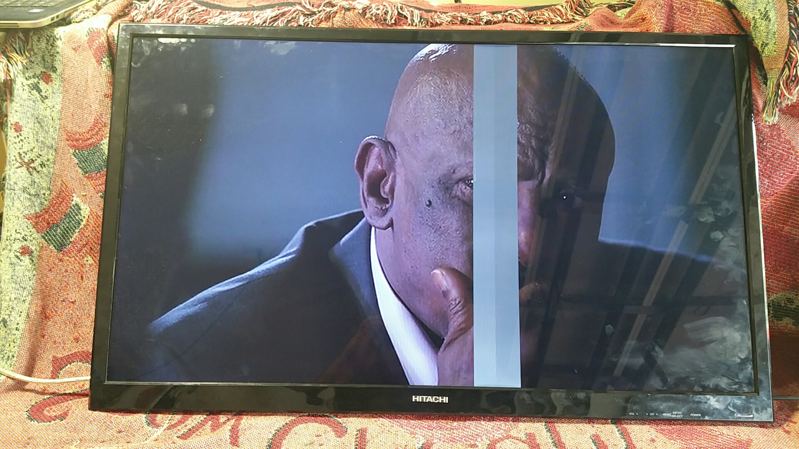

    HELLO TO ALL. I have this led tv that suddenly is showing a transparent line. i clean all the ribbon but still not able to get rid of it. Did a reset and nothing happen. Any idea. Love this forum, it is awesome.

    Not fixable, the tab bond driver Ic has failed. Needs a new Lcd screen.

      even when i can still see the picture behind the white line?

        Yeah, thats means the horizontal rows are being scanned but vertical rows aren't due to a failed tab bond.

          i think i am going to play with tab to see what happen. nothing to loose. appreciate your help. if something good happen i will let you know. once again thank you.
