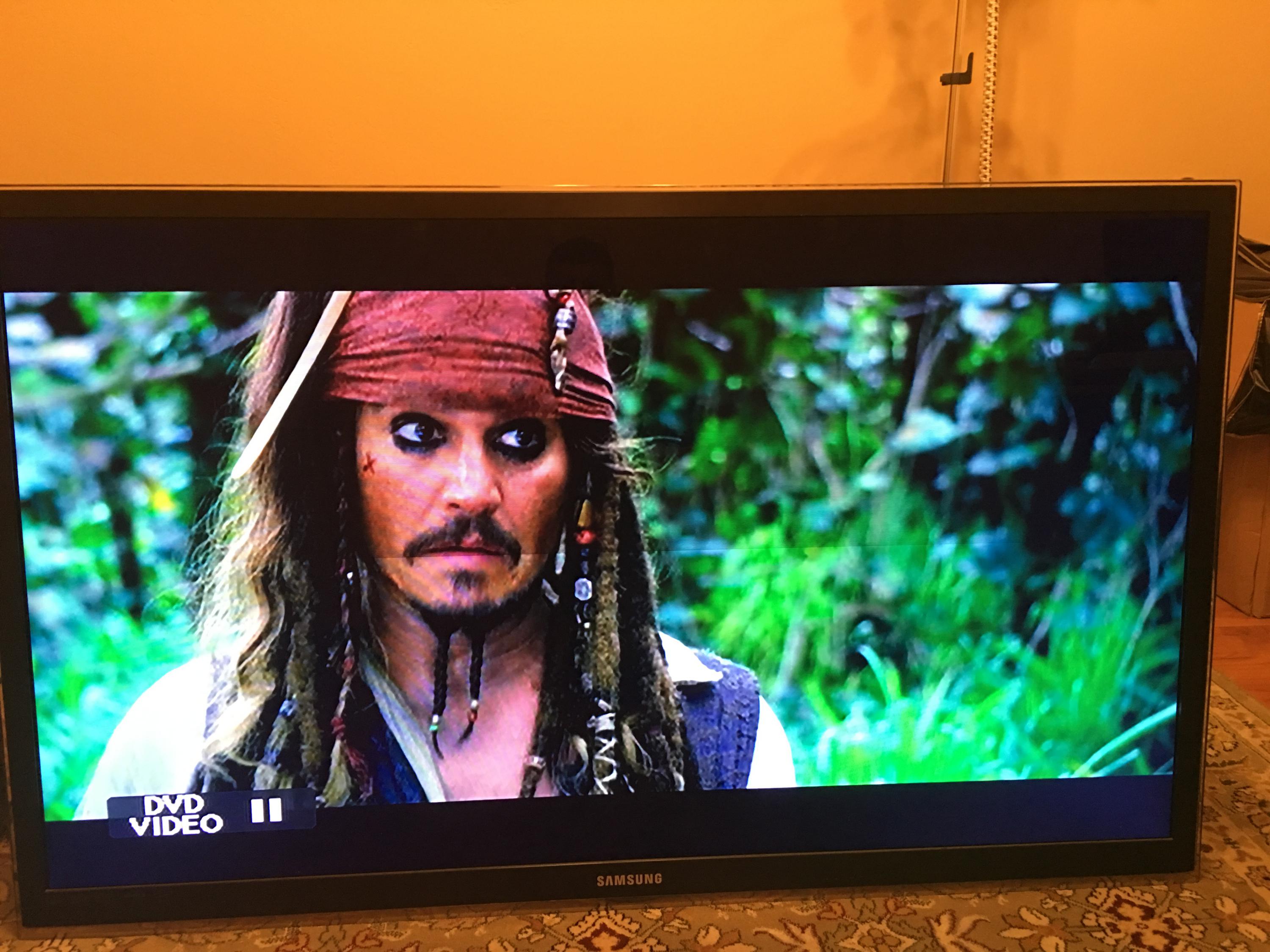

    Hello, I have this strange problem on this TV. To try and best describe the problem, imagine the screen divided into 4 horizontal sections (each representing 25% of the display). Sometimes the top 25% section will be dim. At other times, the top section will be fine but the second 25% section will have fine horizontal lines through it and the top half of the display will look good aside from the horizontal lines while the bottom half kind of looks like a compressed jpg image. Not terribly bad but not quite right. I have replaced the T-con board as well as the main board with the exact same result. Is it possible that the problem be the power supply board?
    I have attached the best image I could take. It's hard to see the lines but you can look at Jack Sparrow's lips and you will see one horizontal line
    Thank you for any help. I really appreciate it!!

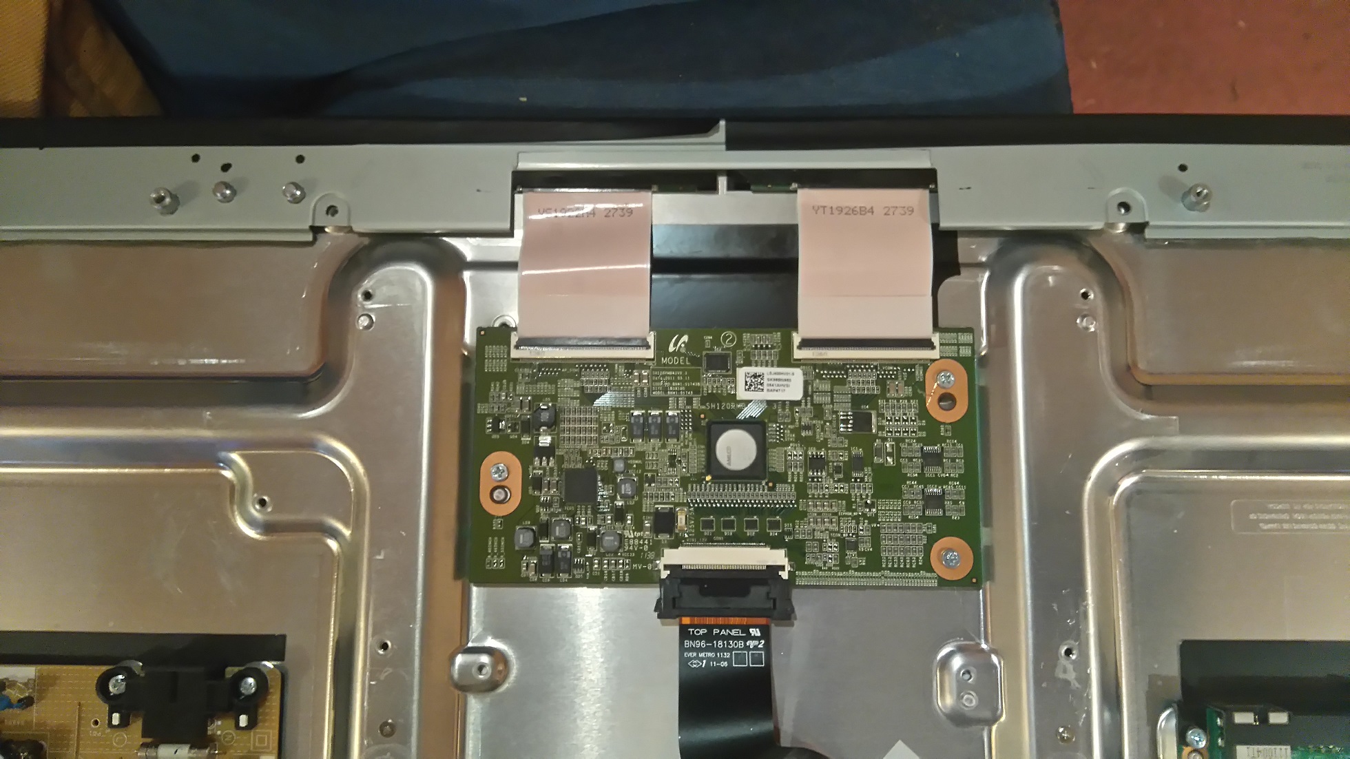

      Re: Samsung UN55C6500VF strange display problem
      There are only two ribbons on the bottom of the panel and those two are connected to he T-CON board. I did flex as well as clean those cables to no avail. Not even a flicker or anything when flexing them. I also did the same with the other ribbon cable that goes from the T-CON to the main board. Same result.
      Is it possible that the power supply board (with built in LED power section) can be supplying maybe weak voltage or something to the main board?

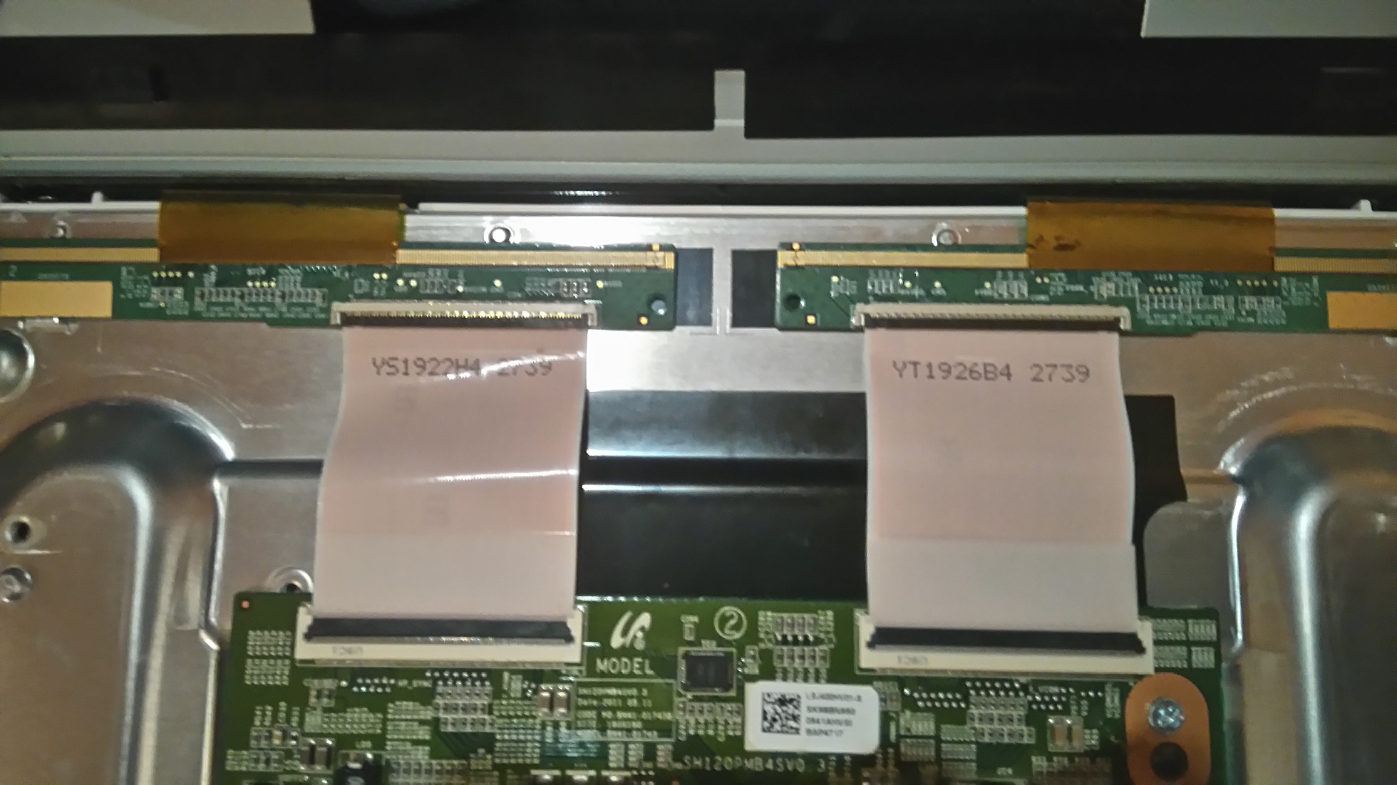

        Ok the ribbon cables im talking about are underneath the metal shield inside the panel you cannot see them unless you remove the metal frame that surrounds the panel that you'll see these ribbons going from those boards which are the top boards or the bottom boards of the panel and those cables connect into the panel itself there's about 10 to 15 of them.
        • Brighton Mike
          • Nov 2015
          • 10
          • England
          freakaftr8 is correct, you need to trace the 2 output ribbons from the t-con which go under a metal cover. Unscrew the cover and you should find 2 long pcb's with 3 or 4 ribbons coming of each board feeding the display. I have photo's but are too large to upload to site
            Ok I understand what you gentlemen are talking about now. Question, which screws do I need to remove to take the back metal shield off? I have the bezel and all boards off right now but I don't want to go removing unnecessary screws if I can avoid it.
              Samsung UE40D6530WK photos but principal is the same, the screws could be very small countersunk crosspoint.

                You guys are the BEST!! Thank you for freely sharing your knowledge. I see exactly what you are talking about. Unfortunately I am unable to do a live test right now because earlier I made a stupid mistake and fried my power supply board. So now I'm going to try and find a new one.
                I did however see the 4 ribbon cables adhered to the two long boards you mentioned as well as where the T-Con ribbon cables are connected. As I see it with the cables at least, there are 6 potential trouble points. The two cables connected to the T-con board are fairly simple because they have connectors. I'm hoping those may just need re-seating or cleaning. However if it's one of the other 4, those are somehow adhered to the boards. Is there anyway to re-adhere them if needed? Like maybe a heat trick or something?
                Mike: Thank you for the photos. They saved my butt!
